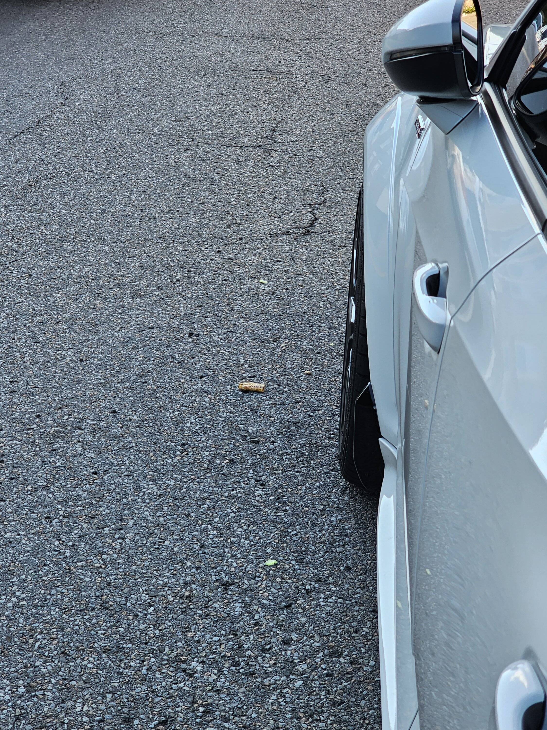

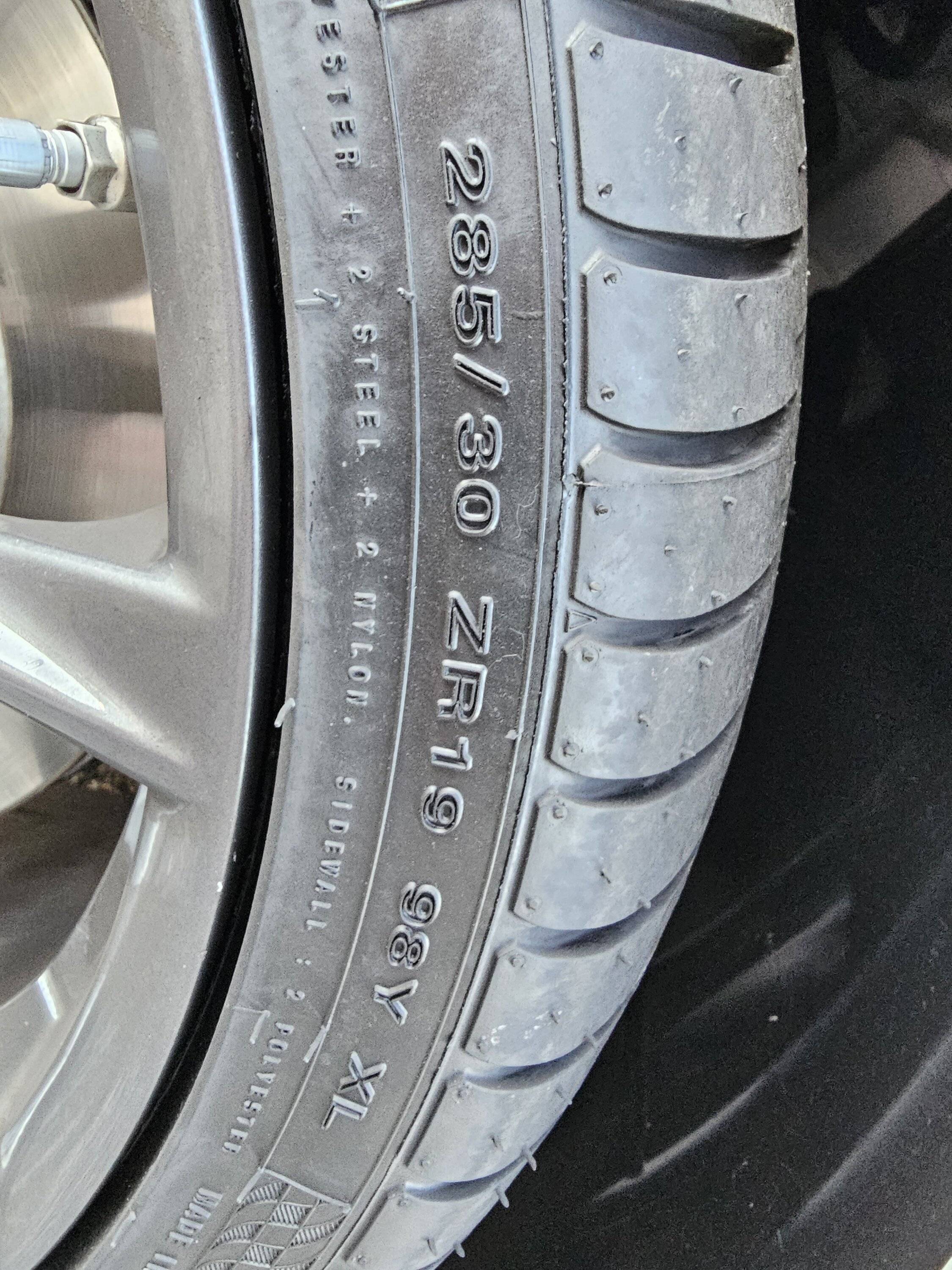

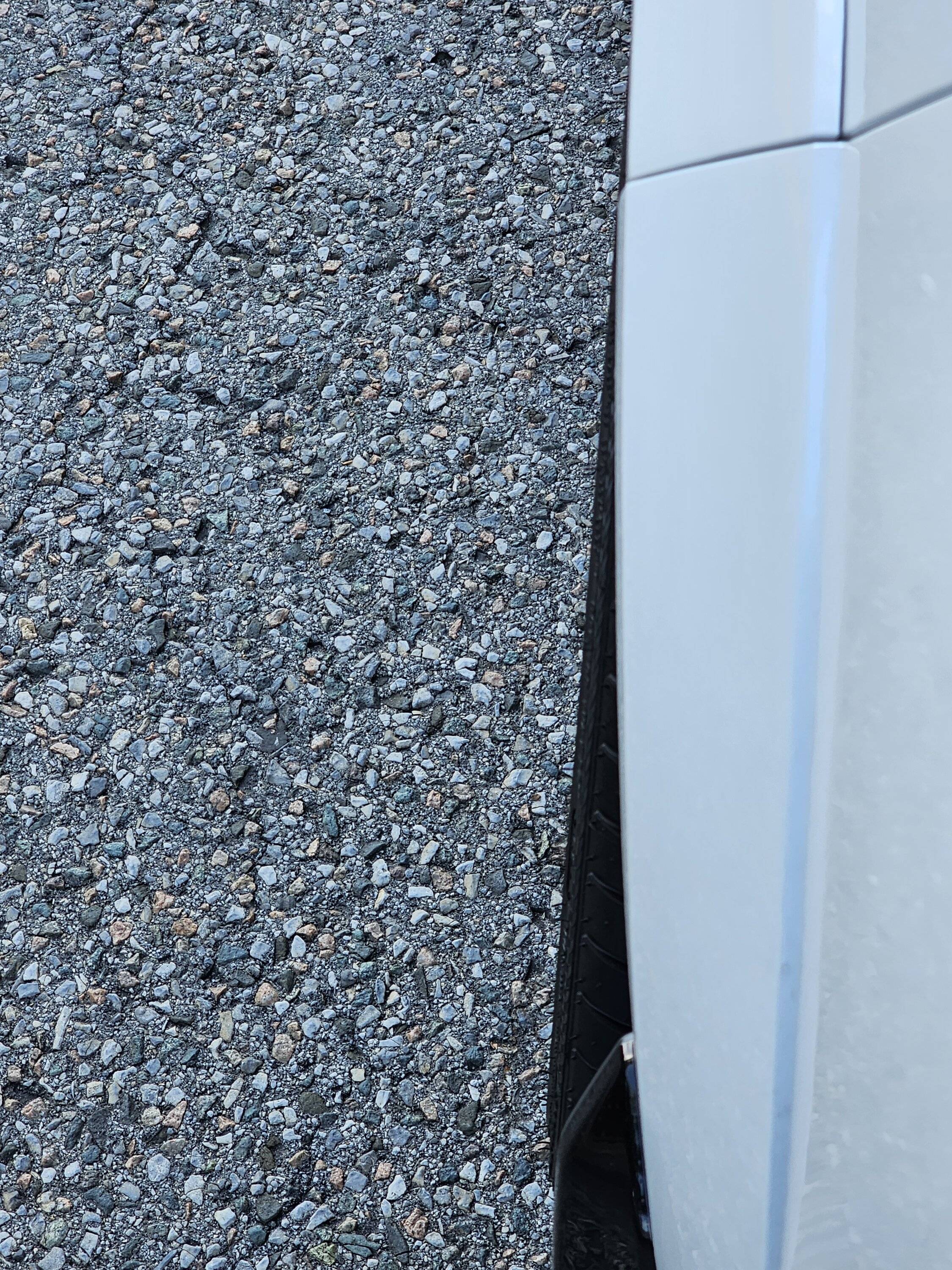

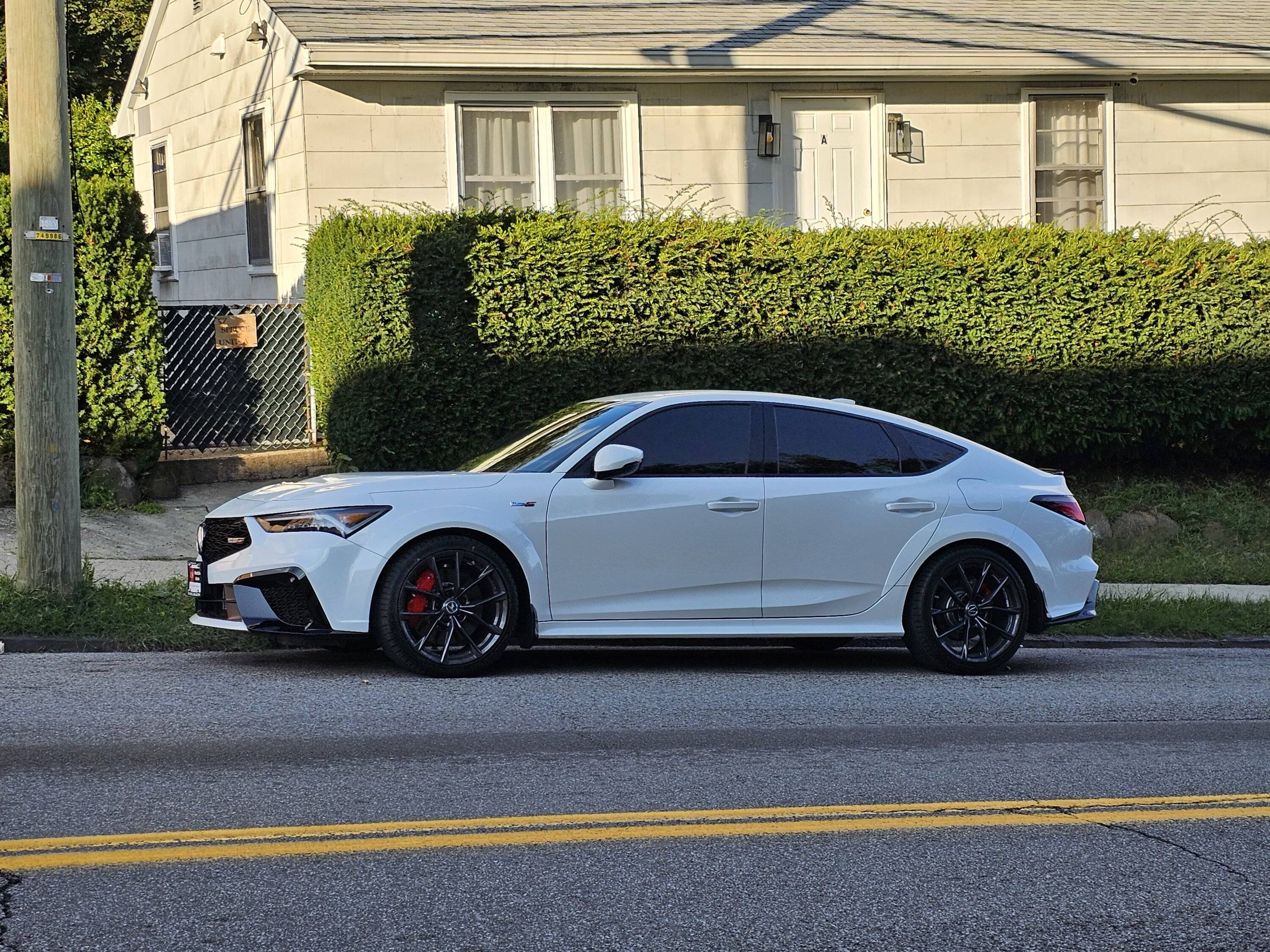

Installed 285 30 19 A/S tires on stock 19x9.5 wheels. Stock tires for sale with less than 500 miles on them. Installed mud flaps (everyone should get them), makes the car a bit more aggressive and helps protect. spacers 15mm 20mm. Also Installed rear cargo area protection and of course good old weathertech.
NO RUBBING, NO VIBRATIONS AND I HAVE A LITTLE BIT MORE SIDE WALL INSTEAD OF RUBBER BANDS.
If you want a little more flush look then do 20mm 25mm. That's the max.

Now I'm wishing I went 285 instead of 275

U can go 295 30 19, bc the side wall still looks stretched, I'm after a squared look and bc there's enough room from the top of the tire to the underside of the strut tire. imho ijs

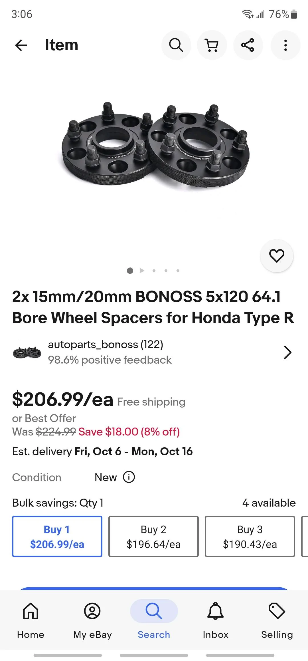

I assume you did 15mm front and 20mm rear? Just double checking.
Also, what brand of spacers? Eibach? I'm guessing I should be shopping for "Civic Type R" spacers?
Where did you purchase the spacers?
lastly, they are bolt on, then bolt the wheels to the studs on the spacers? Is there enough room on the back of the wheel so you don't need to modify the stock rims in any way?

Thanks for the link, saw the answers to my questions on another thread. Ordered!
