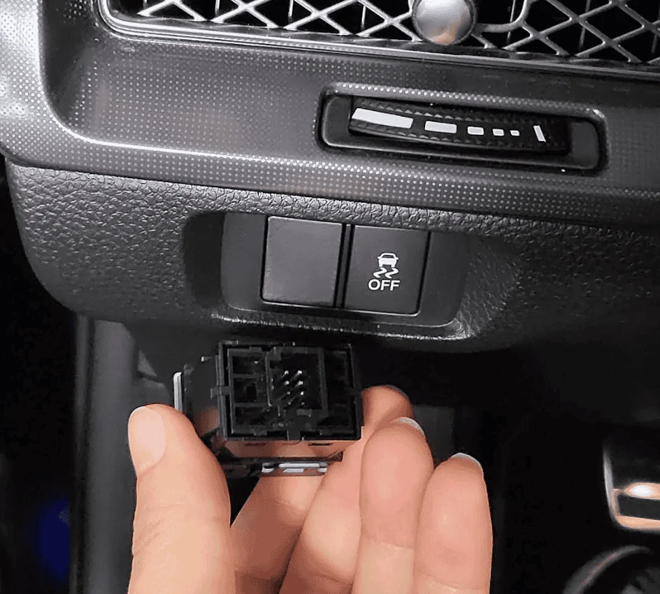

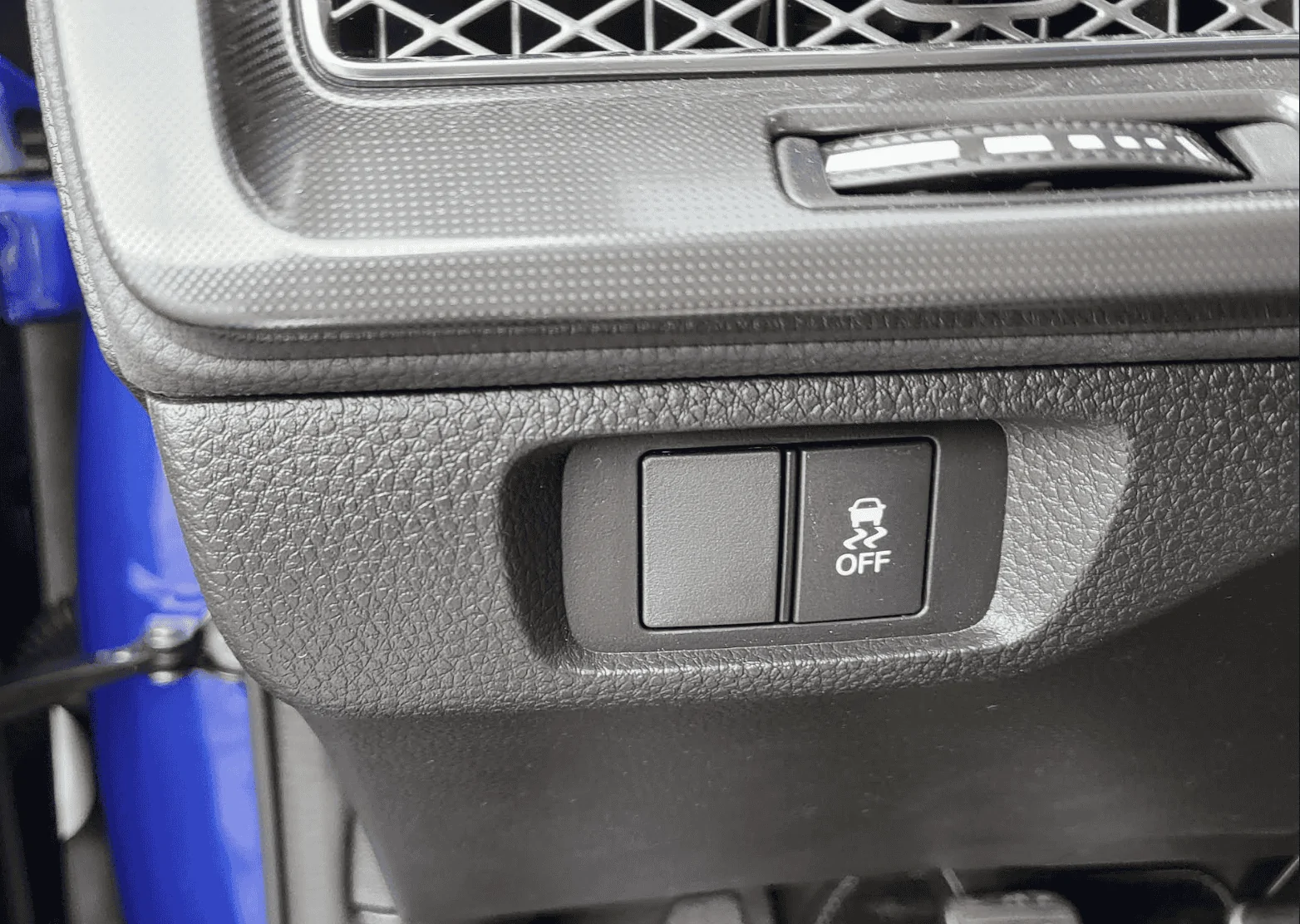

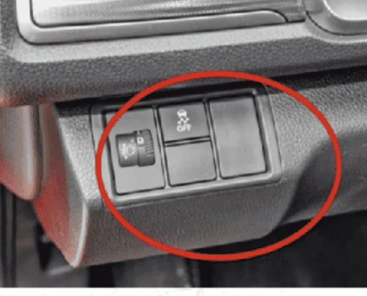

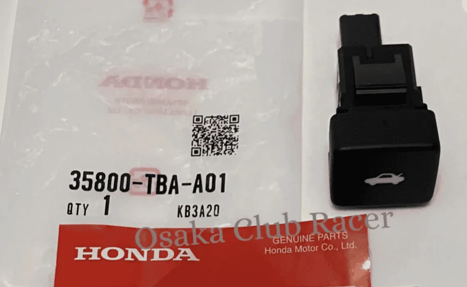

1. I should have checked this in the pictures but there is no place to put the trunk release button in the Integra. In the civic, there are several blank buttons to the left. (see screenshot of the instructions). In the Integra, there isn't as many blank spaces and the button that is included in the package means you have to either choose traction control or the trunk release button. I may try to rip apart the buttons to rewire them in the future but the button that they sent me is not compatible with the Integra interior
Manual picture:
Acura Integra Not recommended: Installed the Power tailgate kit from Mikstore 1715614838268-l
Integra interior:

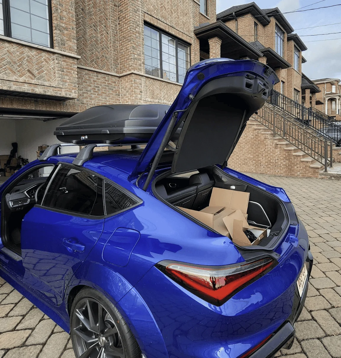

3. The angle that the trunk opens is really steep. My spoiler is less than an inch away from touching the ceiling of my garage. Because the kit was made for the Civic hatchback and I'm guessing that the civic trunk has a steeper angle than the Integras, it opens up way more than necessary. Supposedly the kit comes with a height adjustment but I couldn't get it to work. It pauses at the position I want it to stop and then keeps going to its full range afterwards.
Acura Integra Not recommended: Installed the Power tailgate kit from Mikstore 1715615531590-sm
Overall, this was a pretty big waste of money and time. The kit sort of works but not really. The only thing I gained was that when I press the trunk release button, it powers up and when I press the close trunk button, it comes down under power. But I really wanted the trunk button on the key to work and that doesn't seem to work.

Your pictures of why you can only have one button at a time don't really convey why that is the case. There's a switch hole with a cover in each picture. I would expect that is where the power tailgate switch would be installed. That said, the FL5 installation directions mention pressing the central unlock button 3 times if there is no front button installed. In either case, I wonder if a power tailgate button from another Honda/Acura would allow you to have both buttons.

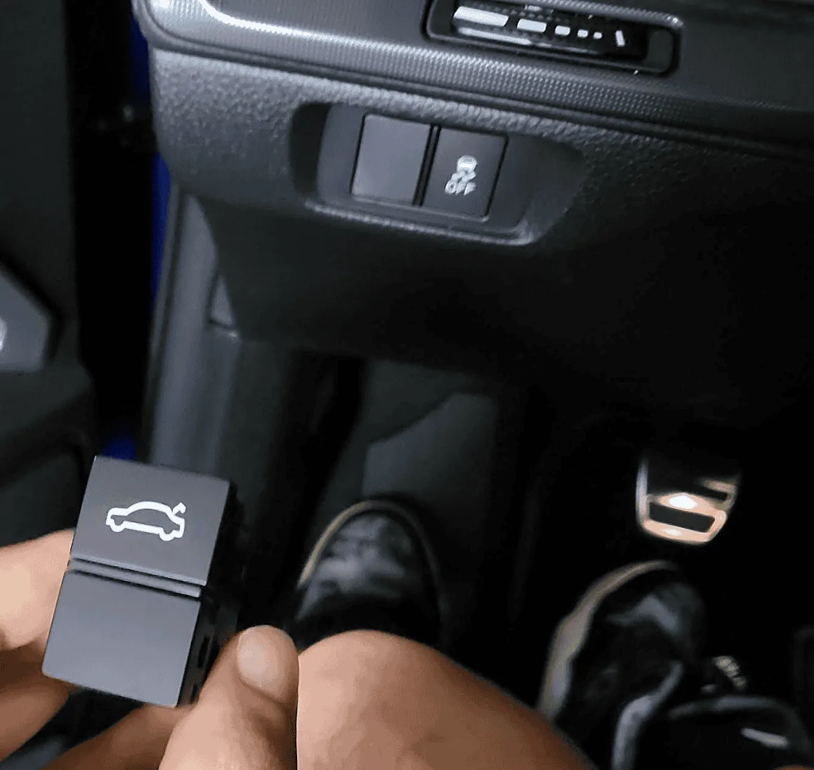

I'll have to take a picture later but the button that they gave me would completely replace the traction control button. I might take the button apart and try to integrate it with what's already in the Integra later but as of now, its not a plug and play.

For anyone curious, I took some pictures of the button that was included in the package.
Acura Integra Not recommended: Installed the Power tailgate kit from Mikstore 1715954246169-p8
Acura Integra Not recommended: Installed the Power tailgate kit from Mikstore 1715954278847-hq
If it's only use one of the two buttons I'm sure you could find one that fits our bezel and swap the pins over to the other style connector.
Yup! That's what I was thinking of doing if I have some time. Although pressing unlock 3 times to open and close the trunk works so I might just leave it for now.
