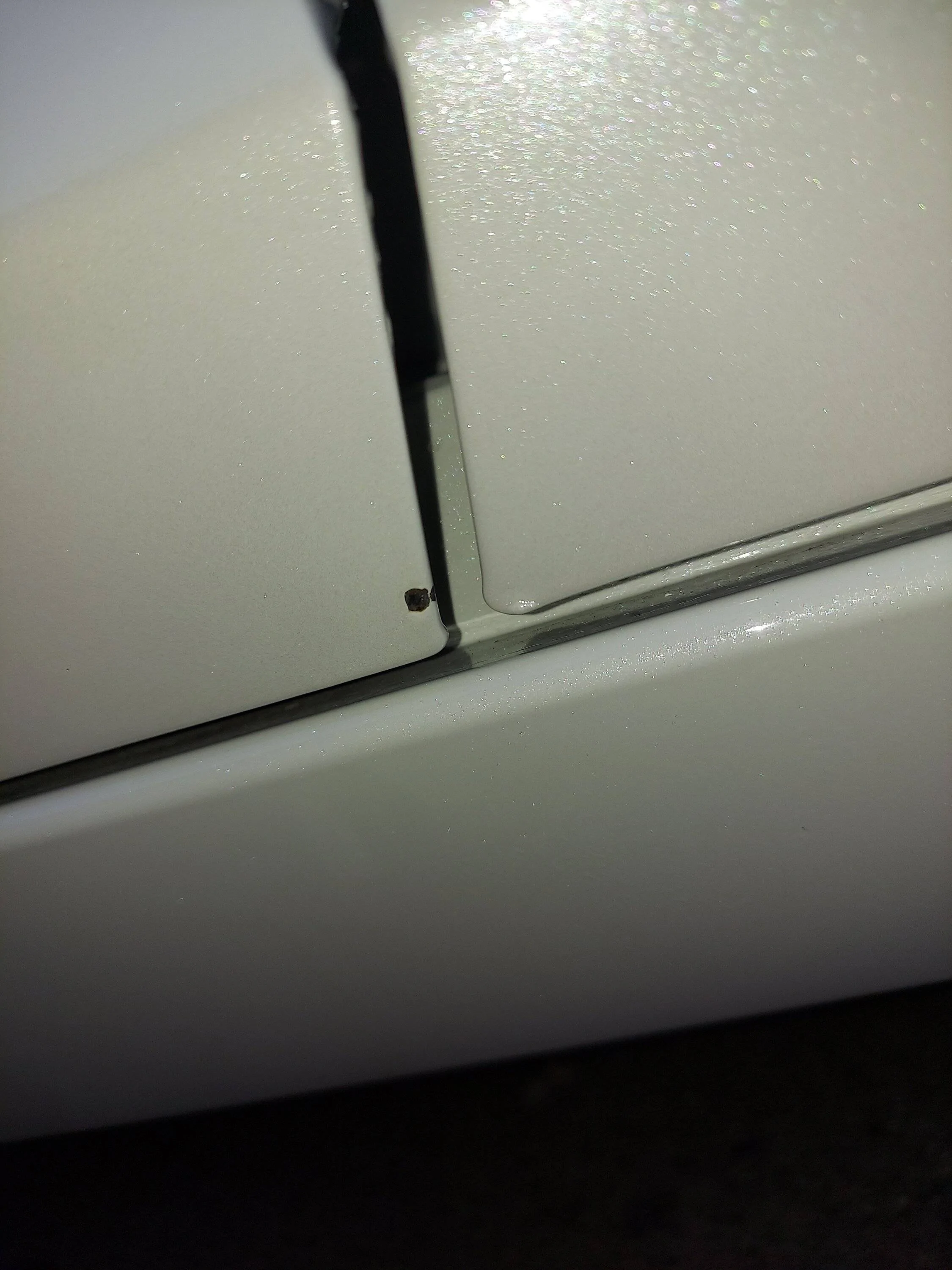

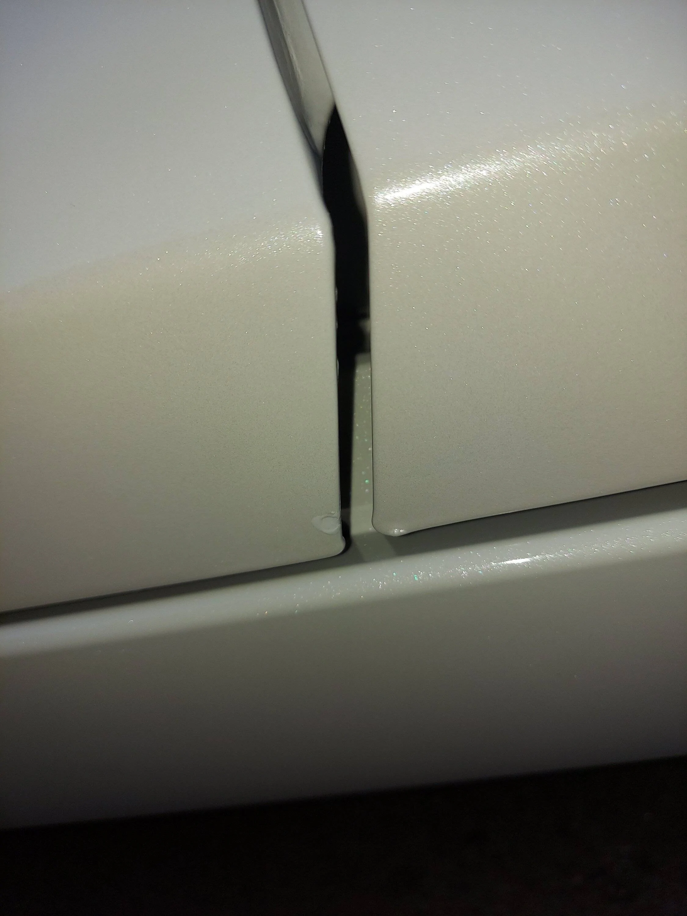

Well, first time detailing the car after the month at the dealer and there a a chip in the rear door that was not there before I took it to the dealer. Already was rusting so it must gave been there for a while.
Here's the before/after using the Acura PWP touch up kit per instructions. Luckily, it's in an inconspicuous location and relatively small...

I just did 1 layer. It was 36 degrees today and the sun was setting. Didn't want it to not cure. The rust was my main concern. The pic is also without the clear. It was dark by the time the clear dried so it may match a little better.
