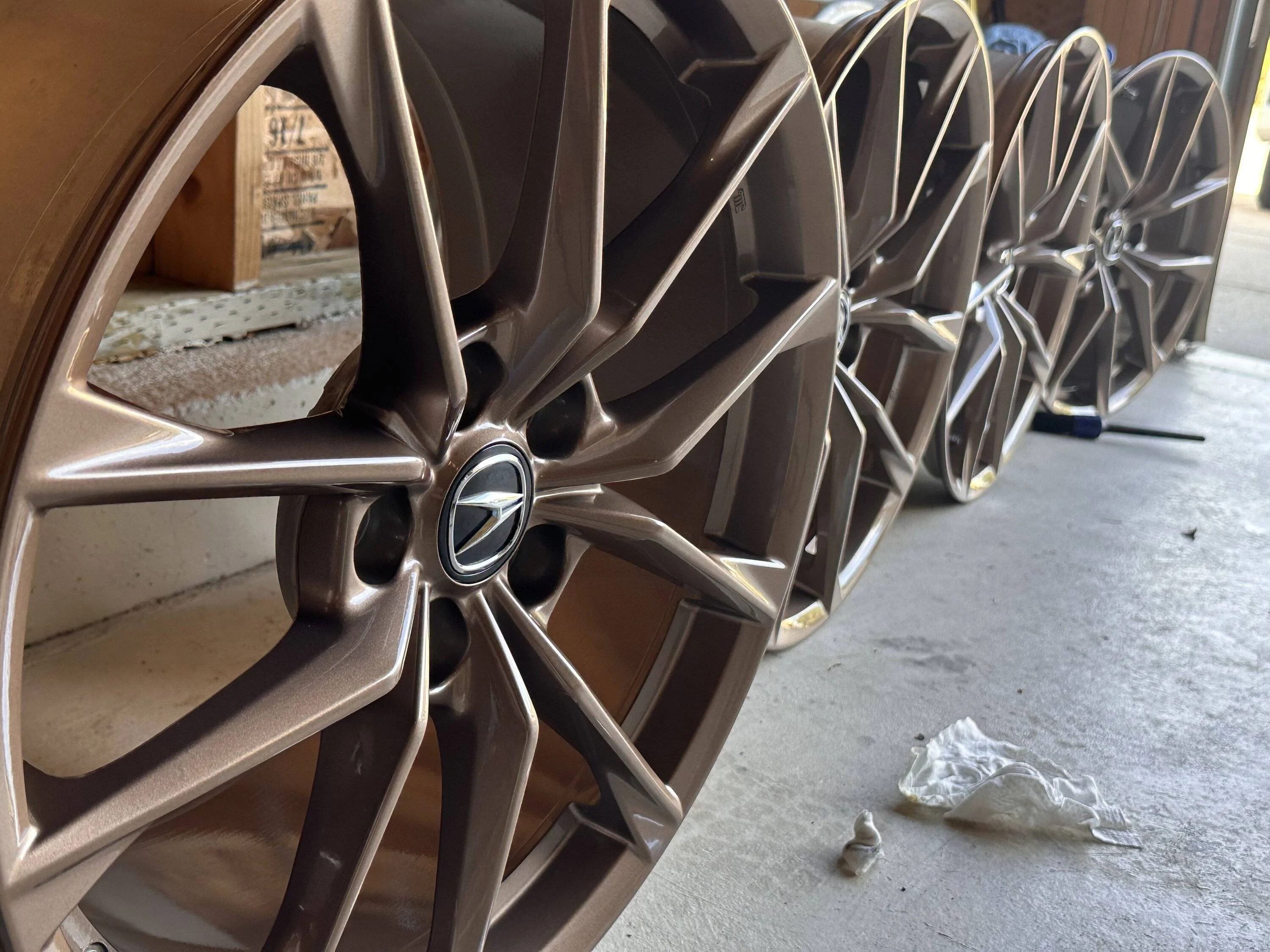

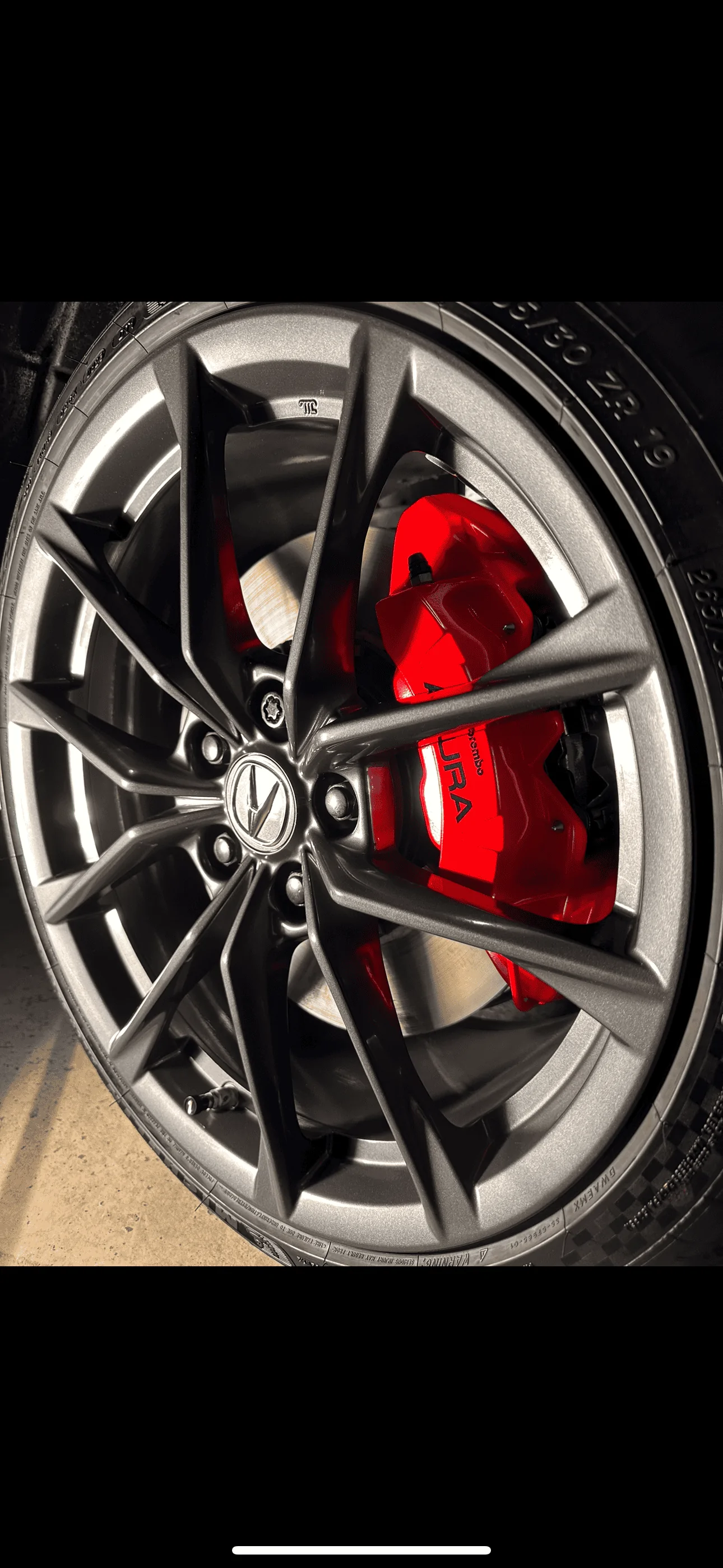

Reporting in. Two layers of Gtechniq wheel armor ceramic coat applied on both sets of wheels. Applicator pad and double wipe method with microfiber to eliminate high spots. Two hours wait between each layer. 18 hours to cure:
Acura Integra Ceramic Coating for Wheels F51B0B9C-AE4D-4618-B7FD-2A608BD6C3F1
Acura Integra Ceramic Coating for Wheels 74C173CF-75AE-4921-8219-9C6DA863CC4A
Acura Integra Ceramic Coating for Wheels E7B1F8DD-7002-4A7B-B08F-2C52D3FE210D
next. Drove family around and unfortunately a rainstorm poured before we could make it home. Shot a quick video and it looks like the ceramic coat held up extremely well:
Was hoping the wheels would get 3 days of curing before water contact but since it was already too late I decided to put water to the test:
Water beading was impressive as everything glided straight off. Proceeded to light rinse to wash minerals off from the rainstorm. I will update in a month and again after 3 months, 6 months.
the process was fairly simple. Took about a total of 5-6 hours. Most of the time spent jacking up the ITS, removing the wheels to do a full scrub down, decon and surface prep. Maybe about an hour total to apply the ceramic coating. Let me know if there are any questions, happy to help anyone consider this project.
