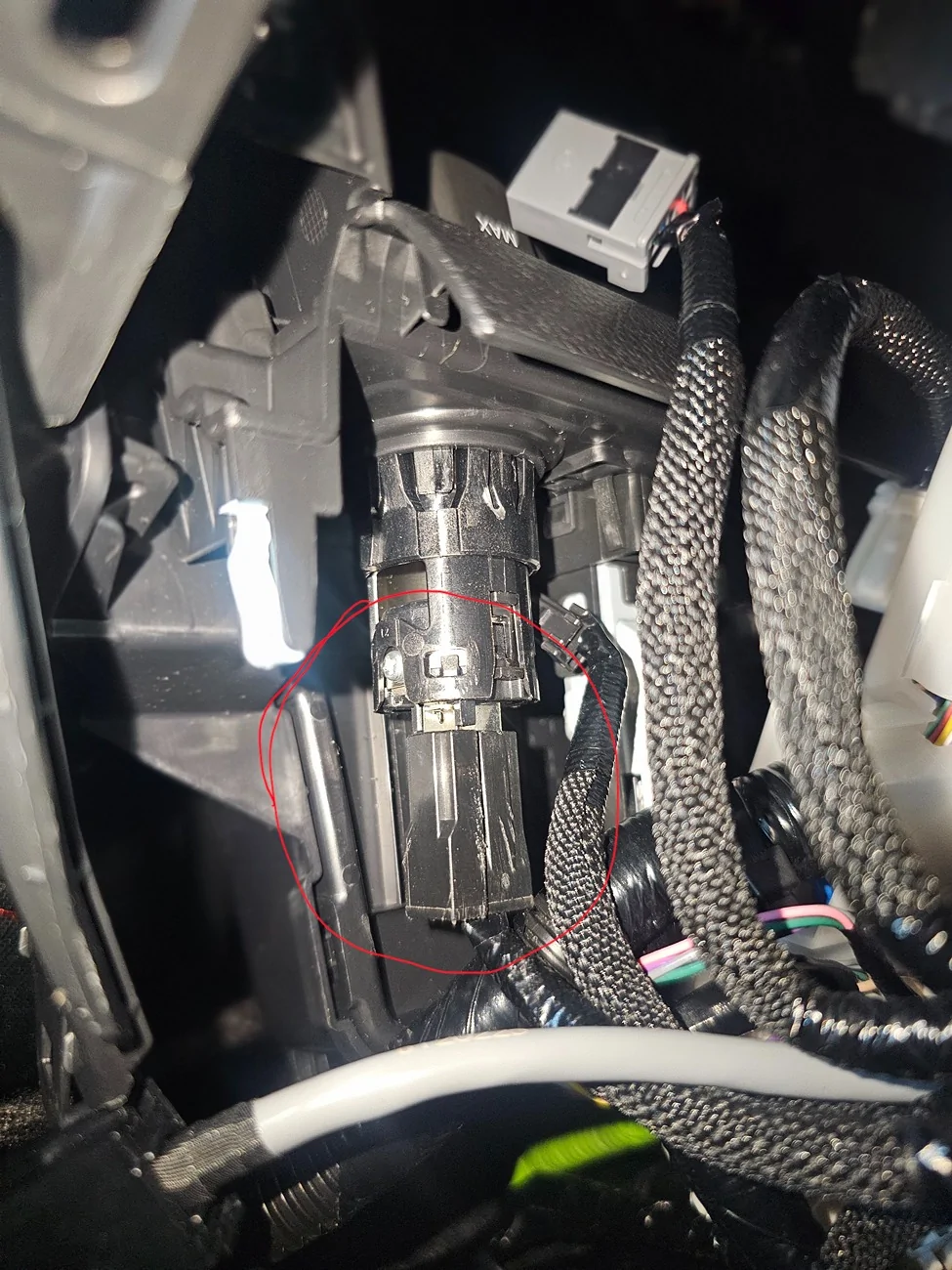

mek Member First Name Mekkham Joined Feb 10, 2026 Threads 8 Messages 47 Reaction score 5 Location San Diego Car(s) 2026 Acura Integra Type-S Mar 7, 2026 Thread starter #1 I know it sounds stupid but how the heck do you take off the cigarette lighter plug from the back? I dont see any push type style clips!! I dont want to yank it and mess something up! Sponsored

OP OP mek Member First Name Mekkham Joined Feb 10, 2026 Threads 8 Messages 47 Reaction score 5 Location San Diego Car(s) 2026 Acura Integra Type-S Mar 7, 2026 Thread starter #3 I dont see any tabs to push. When I try pull on it, it feels like its stuck or attached to something.

UWU-mancer Senior Member First Name UWU Joined Jul 17, 2025 Threads 3 Messages 420 Reaction score 265 Location colorado Car(s) type s Mar 7, 2026 #4 mek said: I dont see any tabs to push. When I try pull on it, it feels like its stuck or attached to something. Click to expand... Oh U need a tiny flathead. The one the snapon dealers give U for free is perfect for this. U gotta push those tabs in I think?

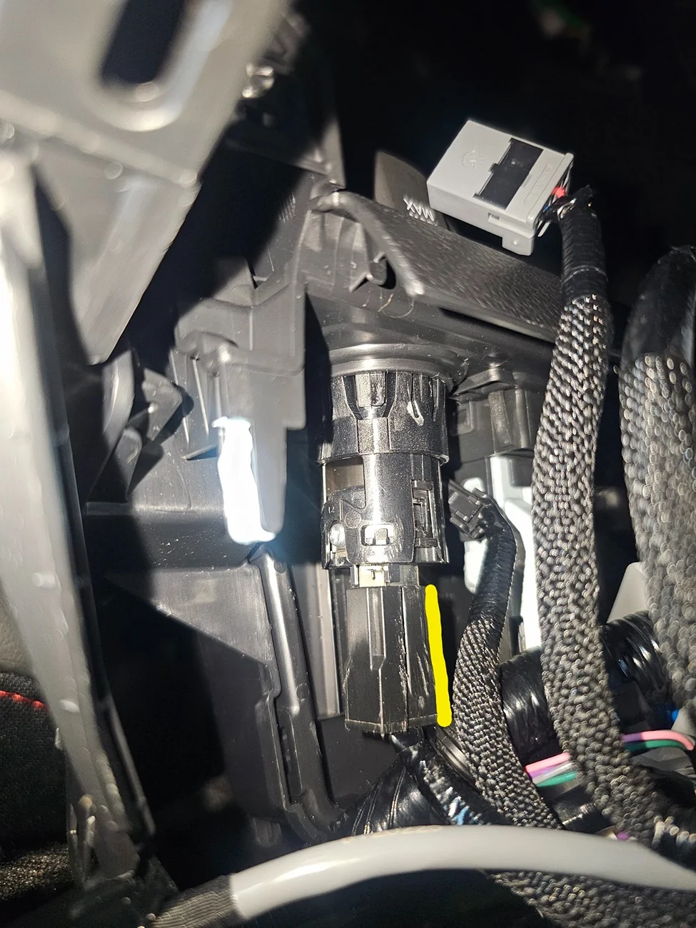

OP OP mek Member First Name Mekkham Joined Feb 10, 2026 Threads 8 Messages 47 Reaction score 5 Location San Diego Car(s) 2026 Acura Integra Type-S Mar 7, 2026 Thread starter #5 Nevermind figured it out. There is a push tab. Hidden but its there.
ABPDE5 Senior Member Joined Jun 24, 2023 Threads 9 Messages 676 Reaction score 536 Location ME Car(s) 2024 Integra Type S Mar 8, 2026 #6 Can you advise where? I struggled with this last time... couldn't figure it out -- just left it attached and pushed it to the side.

OP OP mek Member First Name Mekkham Joined Feb 10, 2026 Threads 8 Messages 47 Reaction score 5 Location San Diego Car(s) 2026 Acura Integra Type-S Mar 8, 2026 Thread starter #7 ABPDE5 said: Can you advise where? I struggled with this last time... couldn't figure it out -- just left it attached and pushed it to the side. Click to expand... Its a flushed type of push tab. At first i couldnt find it because theres no grooves. I marked it with a yellow on the picture. Sponsored
