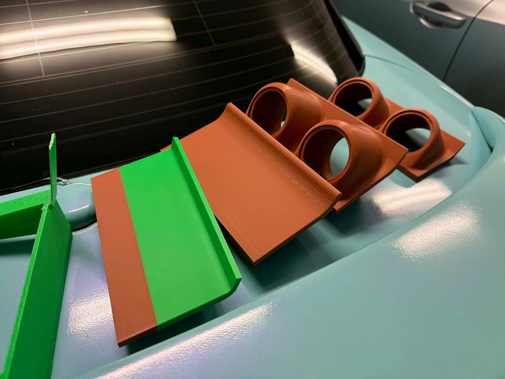

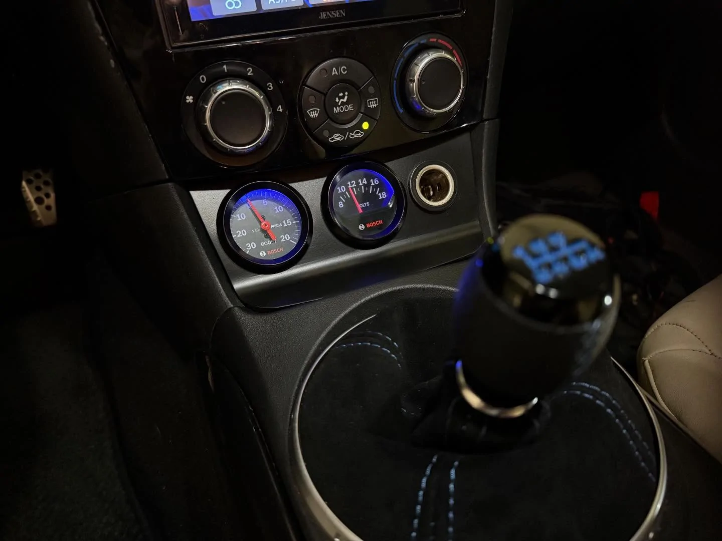

Recently, I added gauges to my weekend car — a 2006 RX-8 — and ended up designing a custom pod that holds two 52 mm gauges while still retaining the factory cigarette lighter (the location was originally an ashtray).

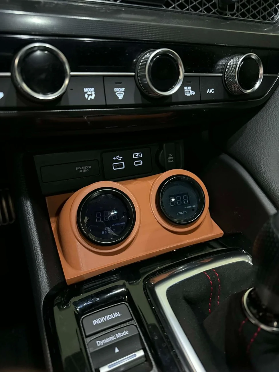

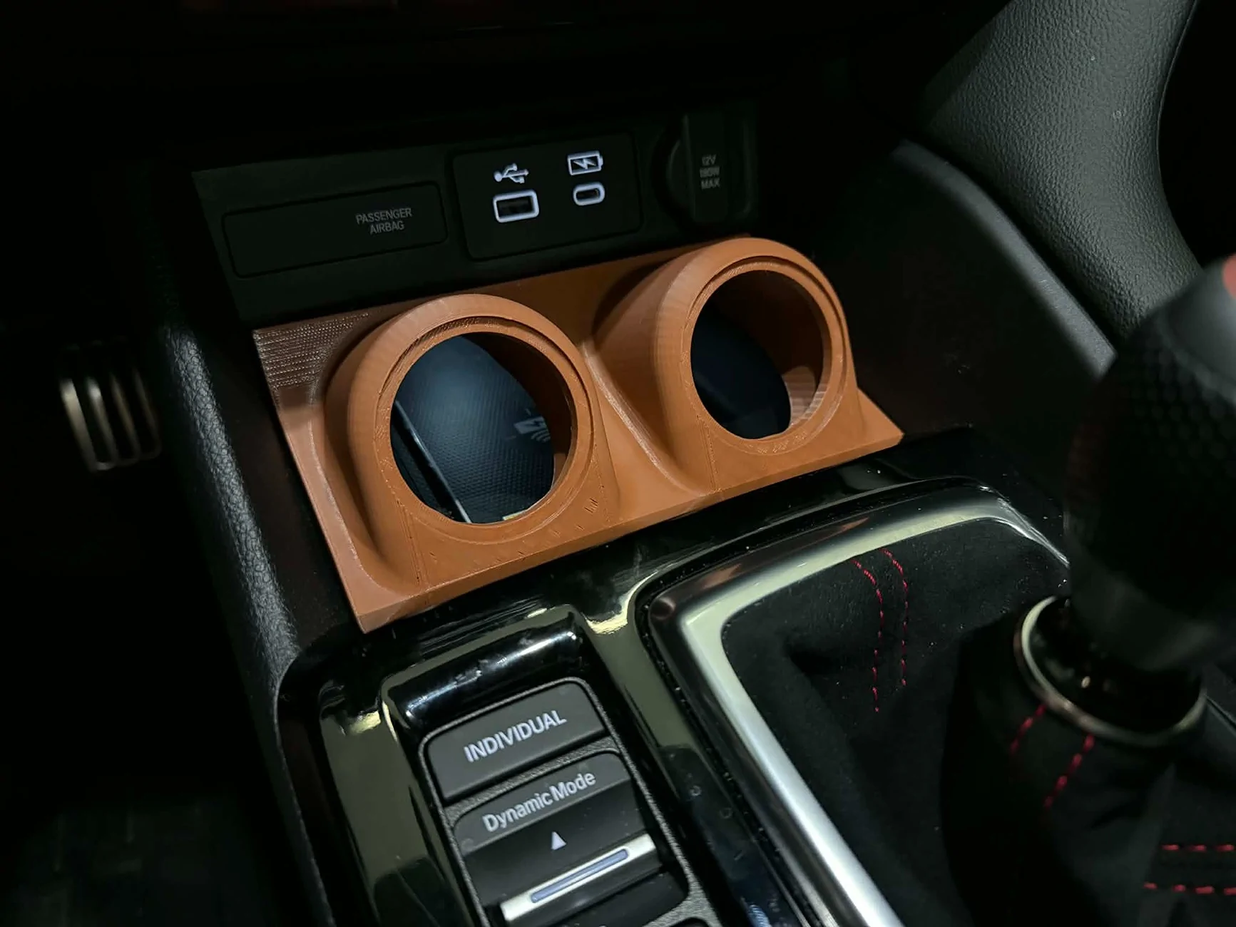

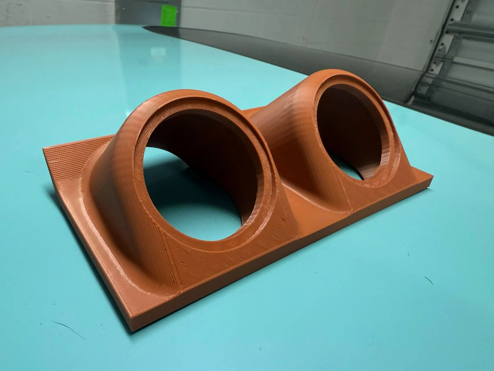

I present: Integra Type-S Gauge Pod v10-c
It’s not perfect yet, but it’s getting very close.
The final version will be printed in PETG, then sanded, primed, sanded again, and finished in satin black so it blends seamlessly with the interior.
You will not be able to tell it is a 3d printed part, and the materials are very durable and can withstand the Florida sun.

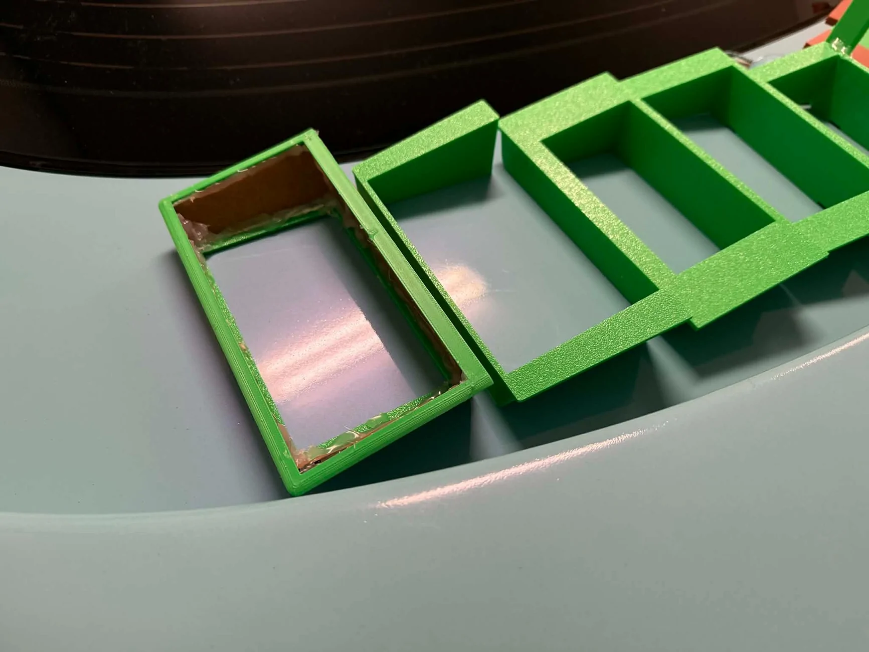

Acura Integra Custom Made Gauge Pod! b7b62ca2-0593-442d-8106-35a6832c4186
(Ugly brown done on purpose to see imperfections, seams, and lines during prototyping).
Acura Integra Custom Made Gauge Pod! 178d956f-e93a-4094-892d-fc31bde52447
Video of current draft showing the "click in" and that once its set there is no movement at all.
It has two primary points of contact and a flat plane.
I don’t currently have any plans to sell these — this is just a personal project I wanted to share. I doubt there would be much interest anyways. If there is, i will, but It would have to be a group buy with Forum Mod approval. I think this will fit the A-Spec as well, but i need to test it. Luckily, my girlfriend has a 2024 Integra A-Spec. I’m still deciding whether to connect the two gauges into a single housing or keep them independent, as well as whether to keep the current straight orientation, or angle the gauges slightly (~10°) toward the driver for better visibility.
I have two 52 mm gauges arriving this Thursday, so I’ll be doing a test fit shortly. My goal is to have this revision finalized (sanded, primed, sanded, painted, wired, and installed) by this weekend.
Thanks for checking it out — more updates soon!

Good Afternoon Everyone!
I have an awesome update to share. After 14 revisions, its FINALLY DONE!
The overall design came out great, and it fits even better than before.
I mocked up gauges, and everything fits with plenty of room for wiring to be retained. Nothing from the car has to be removed to put in the gauge, aside from any wires you have to run (depending on the gauges you put in). Run the wires, put your gauges in the pod, plug in your gauges, and push the gauge pod into place.
Also, I received Moderator Approval to sell a limited run of them!
I will make one more post on this thread, linking the thread for a group buy. I'm thinking ~10 spots, as I am an everyday guy that doesn't want to spend days and days printing and shipping lol. This isnt a business venture to make hundreds of gauge pods, just share my mod with the community :) I have to run my costs for supplies and shipping, but i think they will only be like $50 each. Will probably also do black, white, or dark blue.
