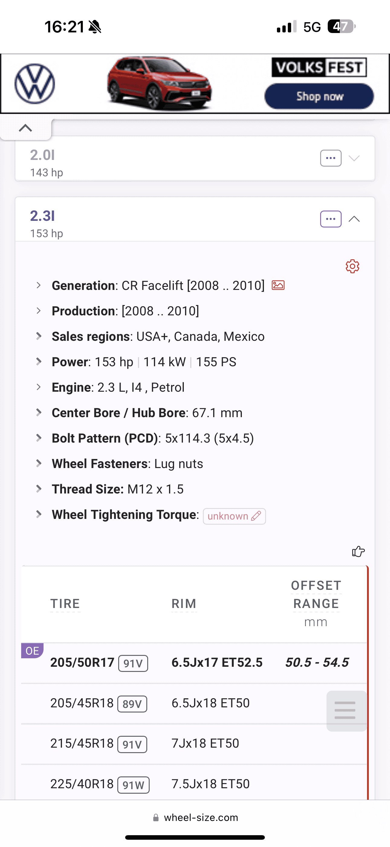

Thought my old 16" winters from my 2017 Accord would fit, but they don't, either rim size or offset. Found a guy selling 215/50R17s from a 2009 Mazda 5 (tires are not 14 years old, just the rims). I think they are 40-45 offset, but I am not sure, nor is the seller. I think my 235/40R18s are 42-50 offset, please correct me if I am wrong.
Killing me trying to figure out what offset I need and what offset tire/rim packages for sale are. Decent rims and 80% tread tires for $500 seem a WAY better deal to me than the $2,500 package the dealer is pushing on me.

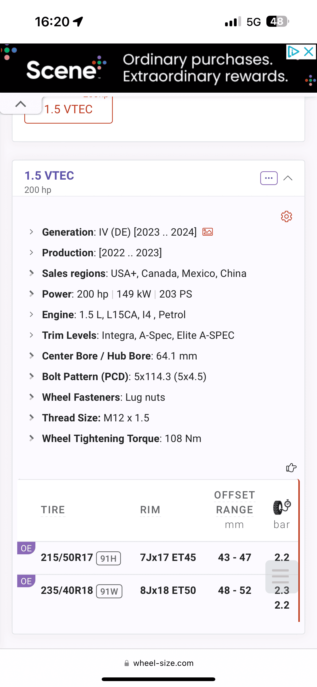

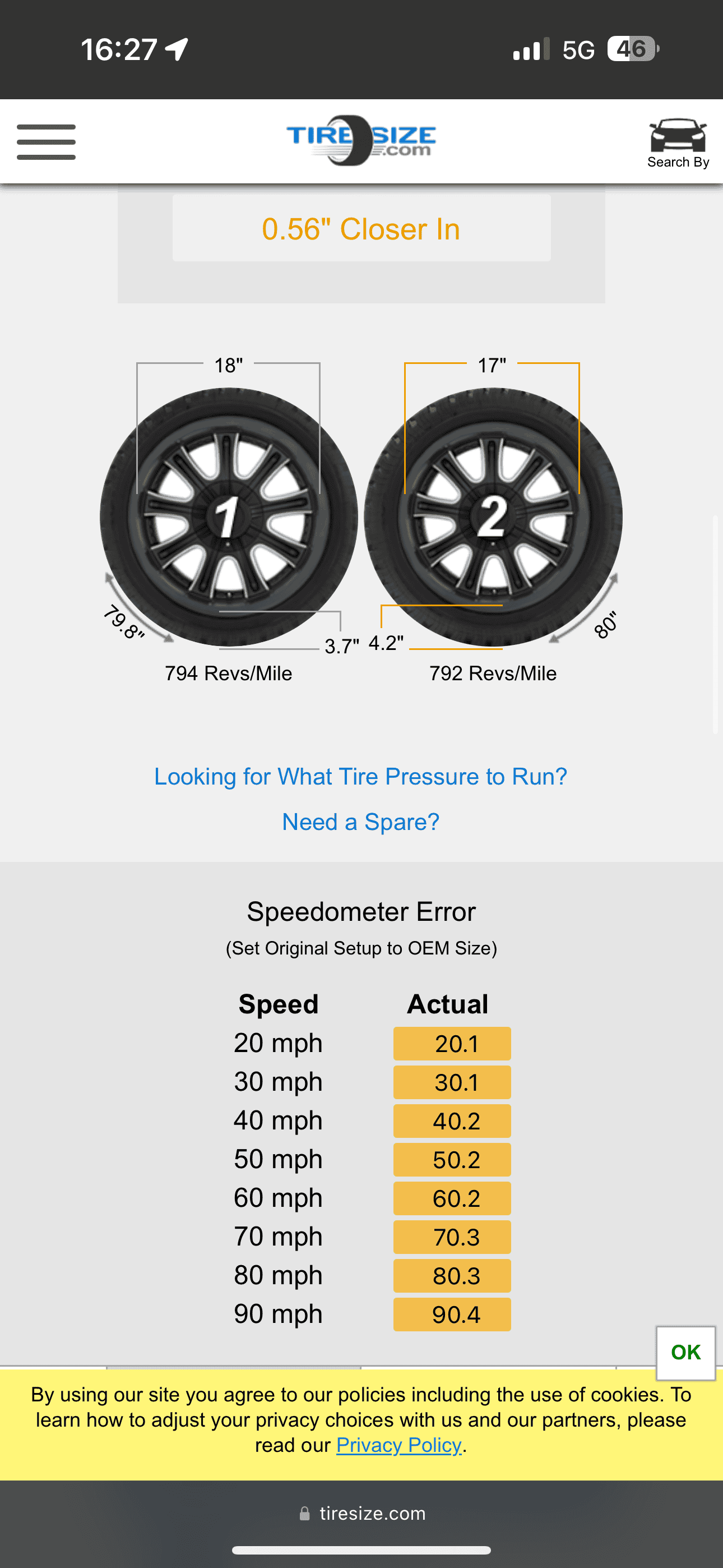

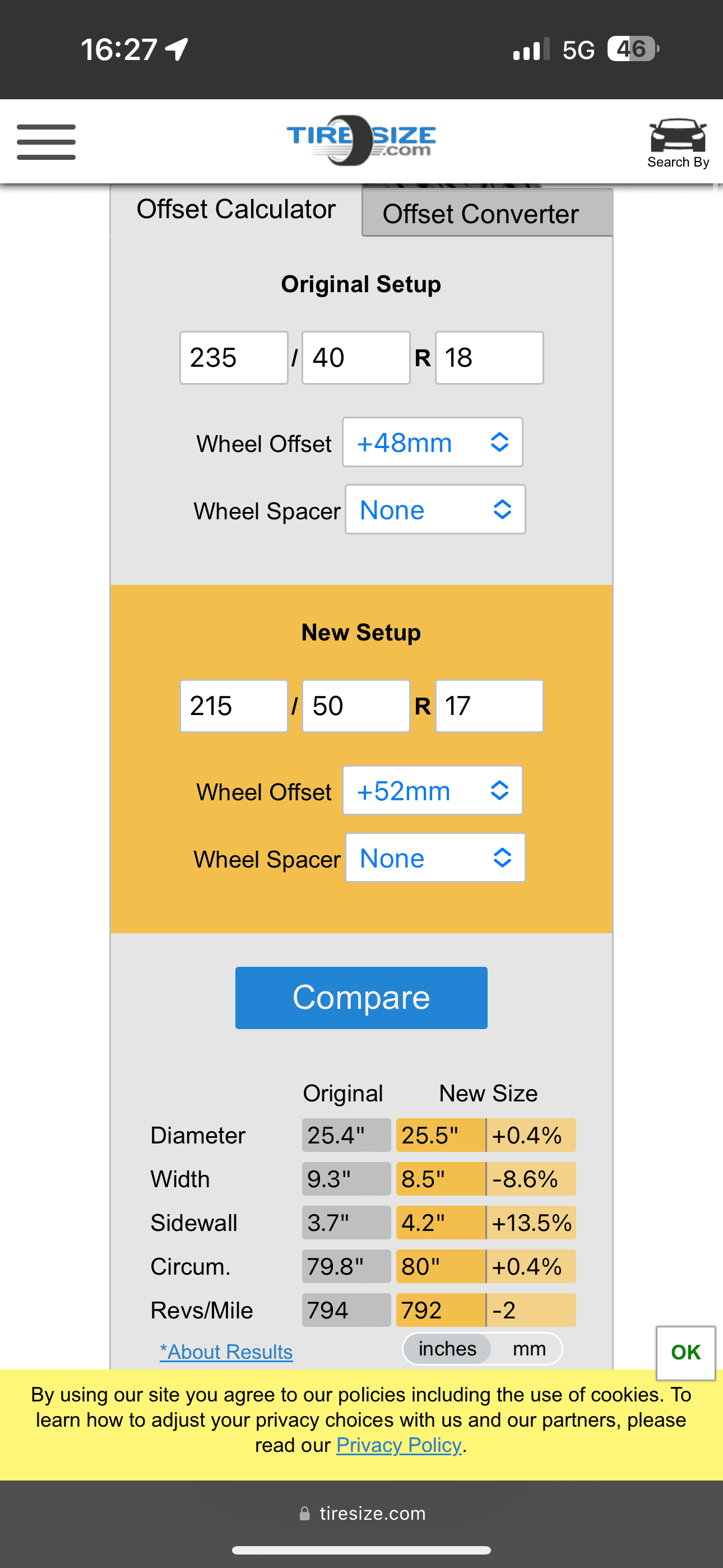

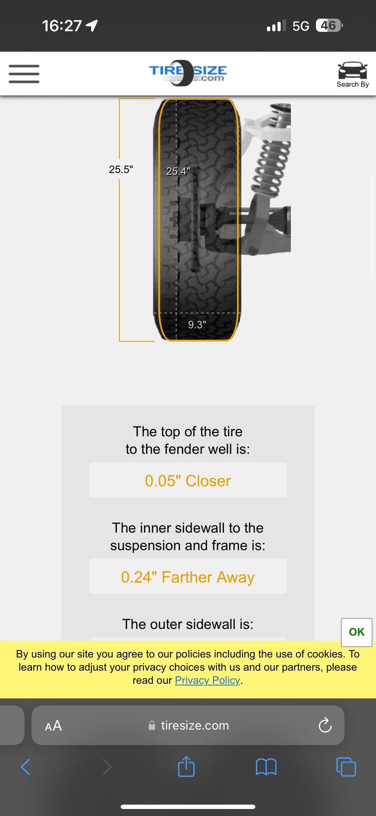

This set is a good deal. But I am just not feeling comfortable enough. I bugged some dealers and tire shops and it seems like this is what I am looking at:
Acura current wheels:
Rims: 18x8
Tires: 235/40 R18
Offset: +50
Centre bore: 64.1mm
The winters:
Rims 17x6
Tires: 215/50 R17
Offset: +52
Centre bore: 67.1mm
According to tiresize.com everything should be fine, but I am not sure what the larger centre bore means.
Probably smarter to just pay a bit more for something from Honda/Acura.
401
258
You'll have to use a centering ring so the bore of the wheel is adapted to the bore on the car.
