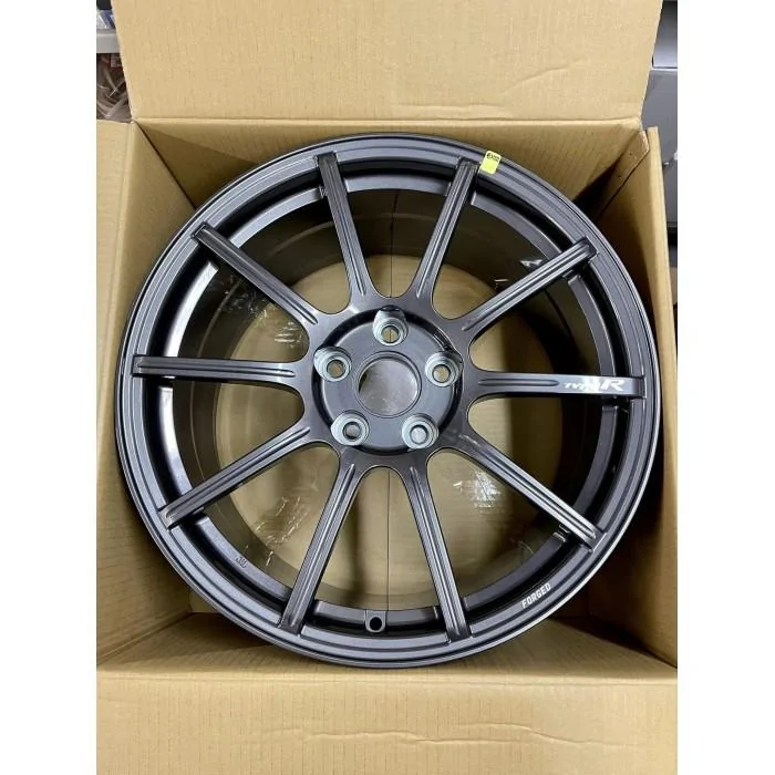

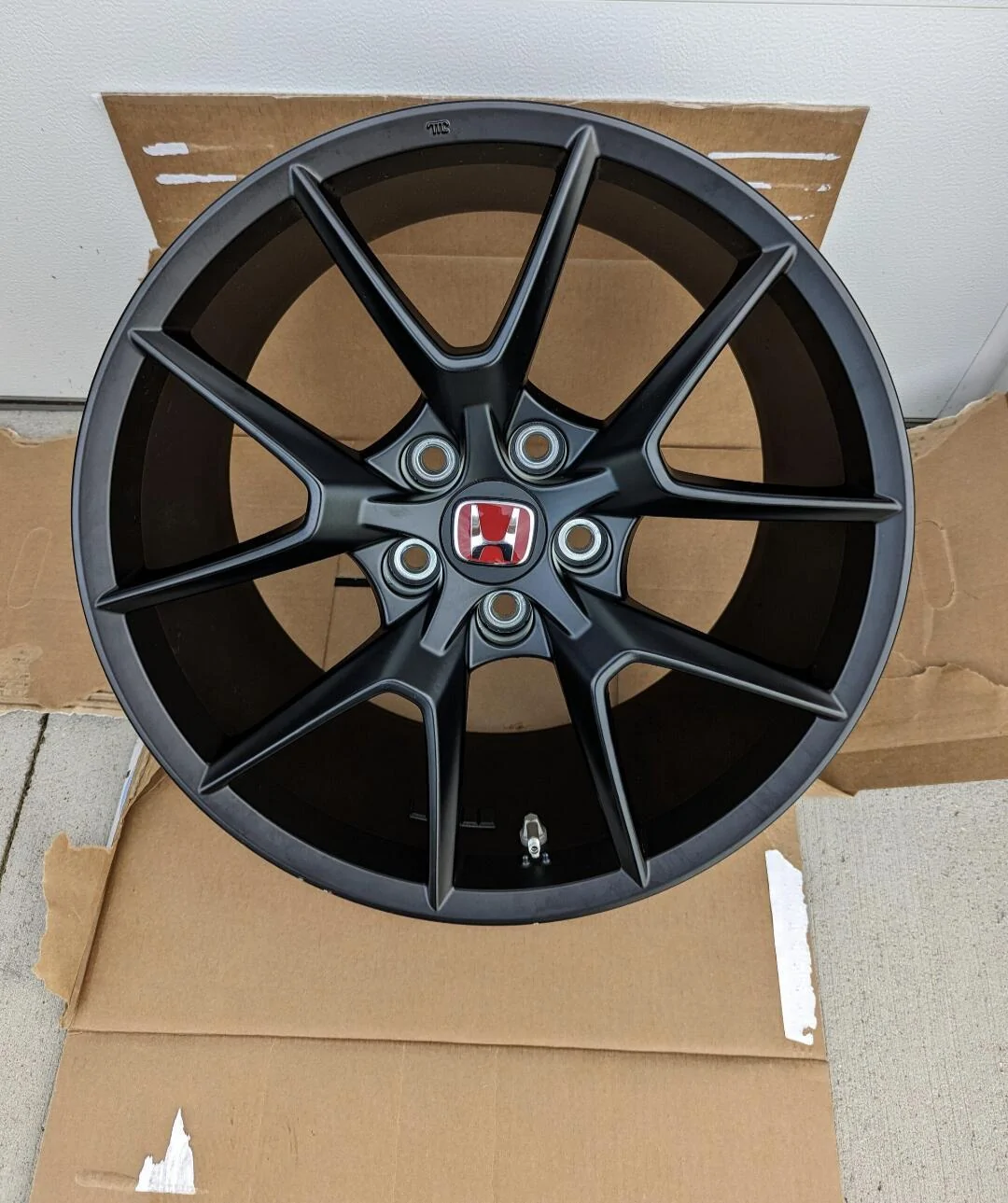

So your saying we can use the TPMS from our OEM DE5 wheels? I have a set of these forged wheels coming and most posts refer to the cast FL5 wheels with the 90 degree bend. The forged wheels have a straight hole so I assume I swap over the TPMS.

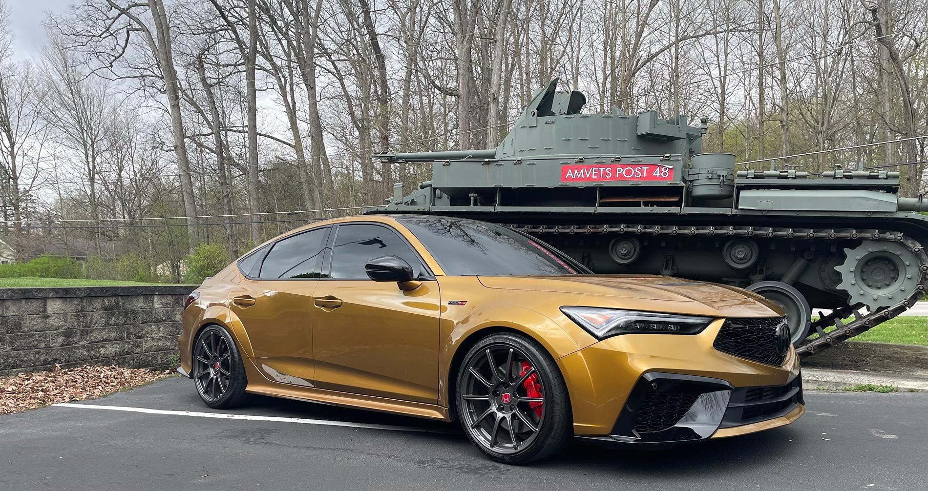

As an update, I had the new FL5 forged wheels installed today. No issue with TPMS. Used the ones from my DE5 OEM wheels without issue.

God that looks great! Did the Acura wheel badge thingies not fit the forged wheels?
man I want those wheels!
The center caps from the OEM wheels are too small, even though both wheels have the same bore size. These forged wheels have a larger chamfer in the bore at the face of the wheel. I read somewhere that one of the other Acura vehicles has a larger center cap that fits. For now I like the red, but I’ll hunt down Acura ones that fit.
