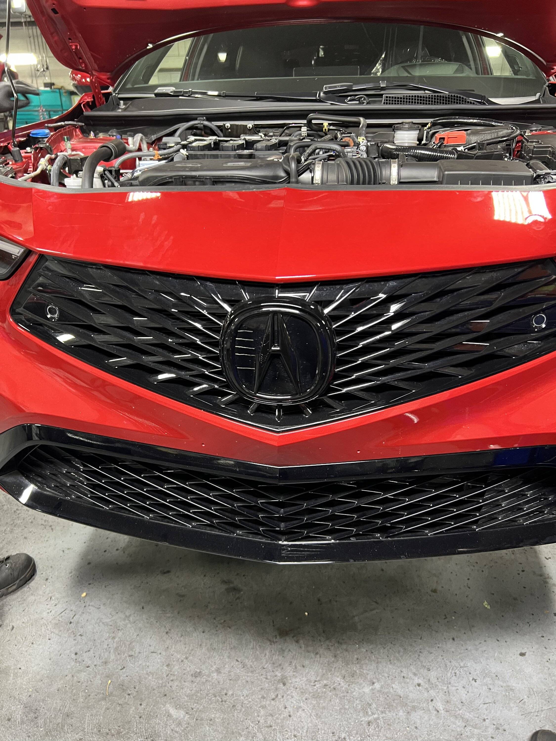

Has any one removed their front bumper for the illuminated emblem or a grill replacement? Unfortunately, I must due the later. The auto body shop mentioned, once the bumper is removed and the sensors are disconnected, the entire system has to be recalibrated.
Any truth to that?

I haven’t read anything about that. There is a pigtail central plug just behind the Acura badge that allows the entire bumper to come off without needing to remove or unplug each individual sensor. I can’t see a reason it would need to be recalibrated. Sounds like they want to create a line item charge for labor that they won’t really be doing.

When I removed my front bumper to do the black A emblem, I didn’t have to re calibrate anything. It was a simple remove bumper unplug sensors and swap emblem then drove of with no issues.

They’re available from the dealer.
Had the top and bottom replaced at a body shop for $750, including labor. No sensor calibration required. Still waiting on the license plate mount which is back ordered.
