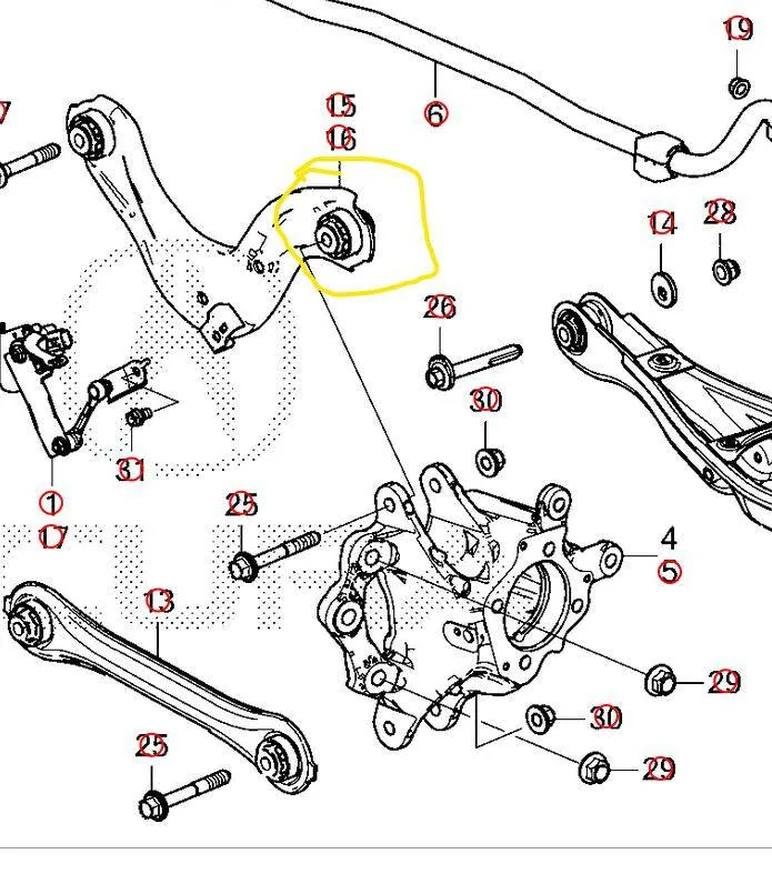

I've had the same, slight clunking noise develop roughly at your mileage (I'm at 14k miles now). I'm still trying to consistently replicate the noise and diagnose the issue myself. It's mostly noticeable at lower speeds, the noise is akin to the clunking you get from a worn strut and *seems* to originate from the rear driver's side. I did bring it to the dealer for a multi-point inspection and they reported no unusual findings; they determined it was noise from my H&R lowering springs but I've been running the springs for close to 10k miles with no issues prior.
My most recent mod was the PRL RMM and while I was under there I did notice the front pipe from my MBRP exhaust was touching the aluminum under body tray. It's possible that's where the noise is coming from but I've had the exhaust on since almost new without issues. Plus I would think that sound would be more metallic and tinny vs clunky. I really should have inspected the car more thoroughly while I was under there but honestly just didn't have it in me after the RMM install.
Some notes:
When reinstalling and torquing the rear driver's side wheel a couple of months ago, I noticed some axial movement from the camber arm below. I should have taken that opportunity to test out the other side for play but laziness got the better of me because I didn't want to jack up the other side of the car at the time. I figured I could bring it in to the dealer to have them check it out since I was going in for the steering recall anyway. Which brings us to their findings above.
