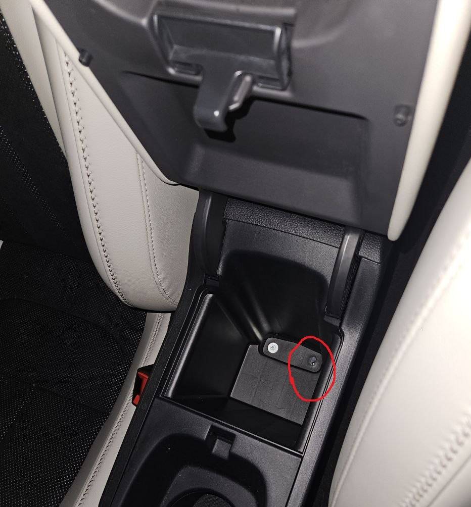

Long story short, I stripped the factory screw that secures the center console (see picture). Does anyone know the screw size and thread pattern? I need to find an appropriate tap the repair the threads and a replacement bolt.
Thanks in advance
Acura Integra ITS Center Console Screw Size? photo_2024-09-17_21-12-45

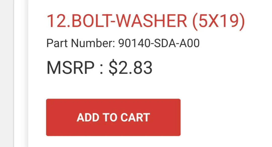

Here ya go. I believe it's an M5. Not sure on thread pitch but you could always take it to an auto parts store to check.
Acura Integra ITS Center Console Screw Size? Screenshot_20240917-222945
