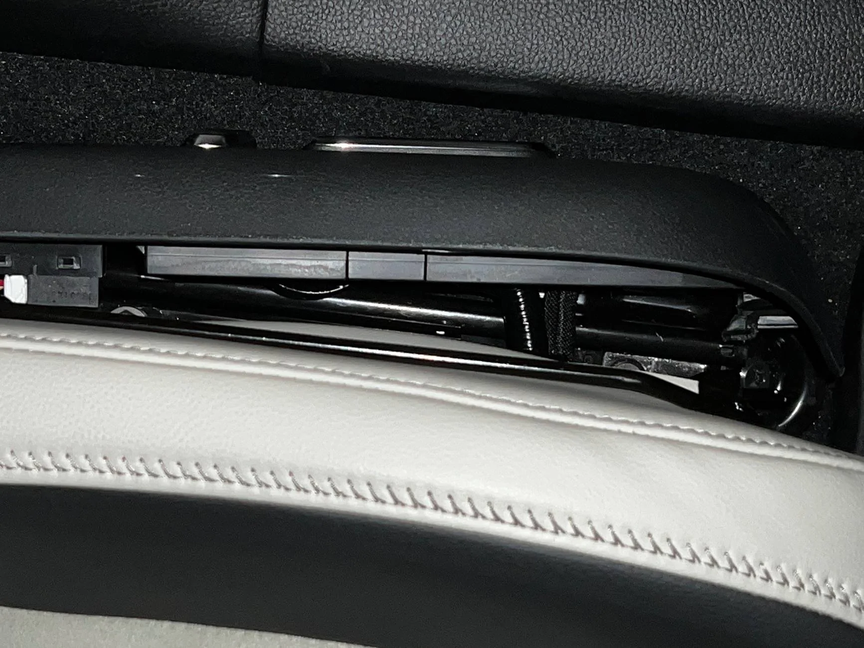

Has anyone had this issue with the piece that has the seat switches? I've tried to press it into place, but no luck.

I've taken mine off before - at the front there's a metal tab that goes into a slot in the plastic. Once that's in, the top of the trim should snap in along the metal rail in a few spots.

THANK YOU! There are a couple of tabs on the top of the trim. They were defeating me. I hung those over the rail and it's all good.
Thanks again!
