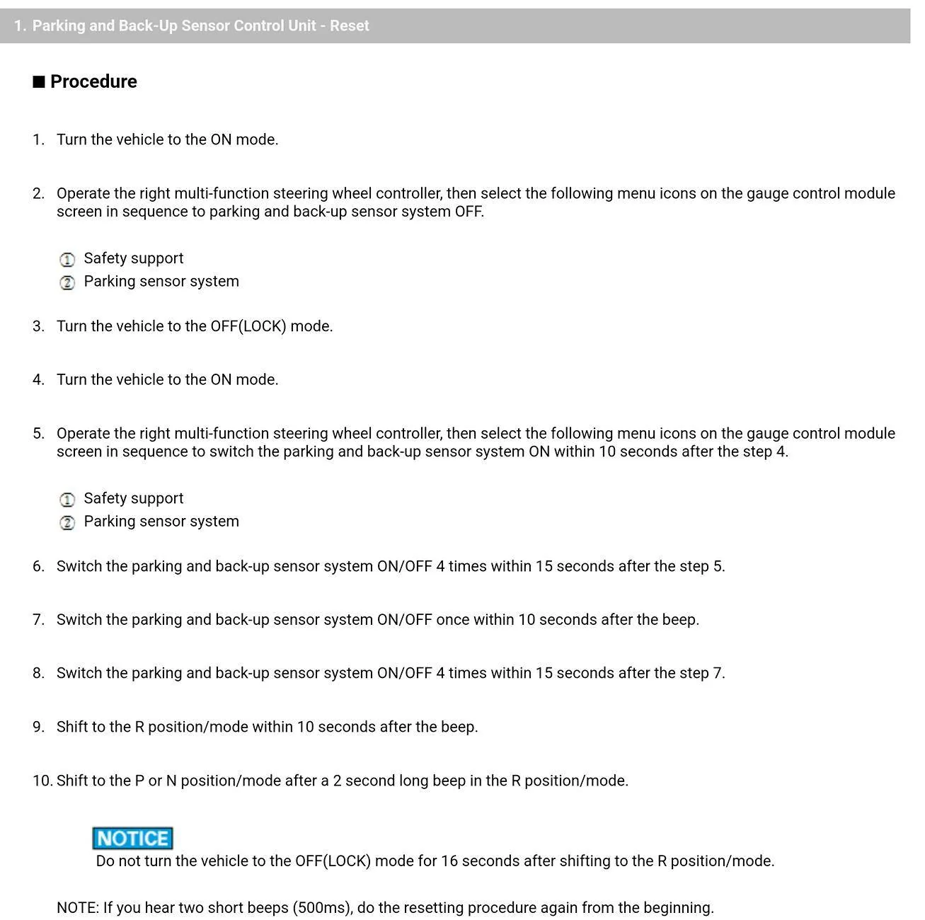

I have replaced a broken parking sensor and with the new sensor they're still not working. Is anyone aware of a PS reset for the integra? Seems easy on Acura's with the parking sensor on off button but in our vehicles that doesn't exist. Thanks for any help offered up.

Hate to ask, but have you tried disconnecting the battery?

Here is the procedure
Thanks for the help. I'm not able to select the parking sensor system as it's in red and isn't selectable. More troubleshooting I guess. Getting an odd code on the scanner.
