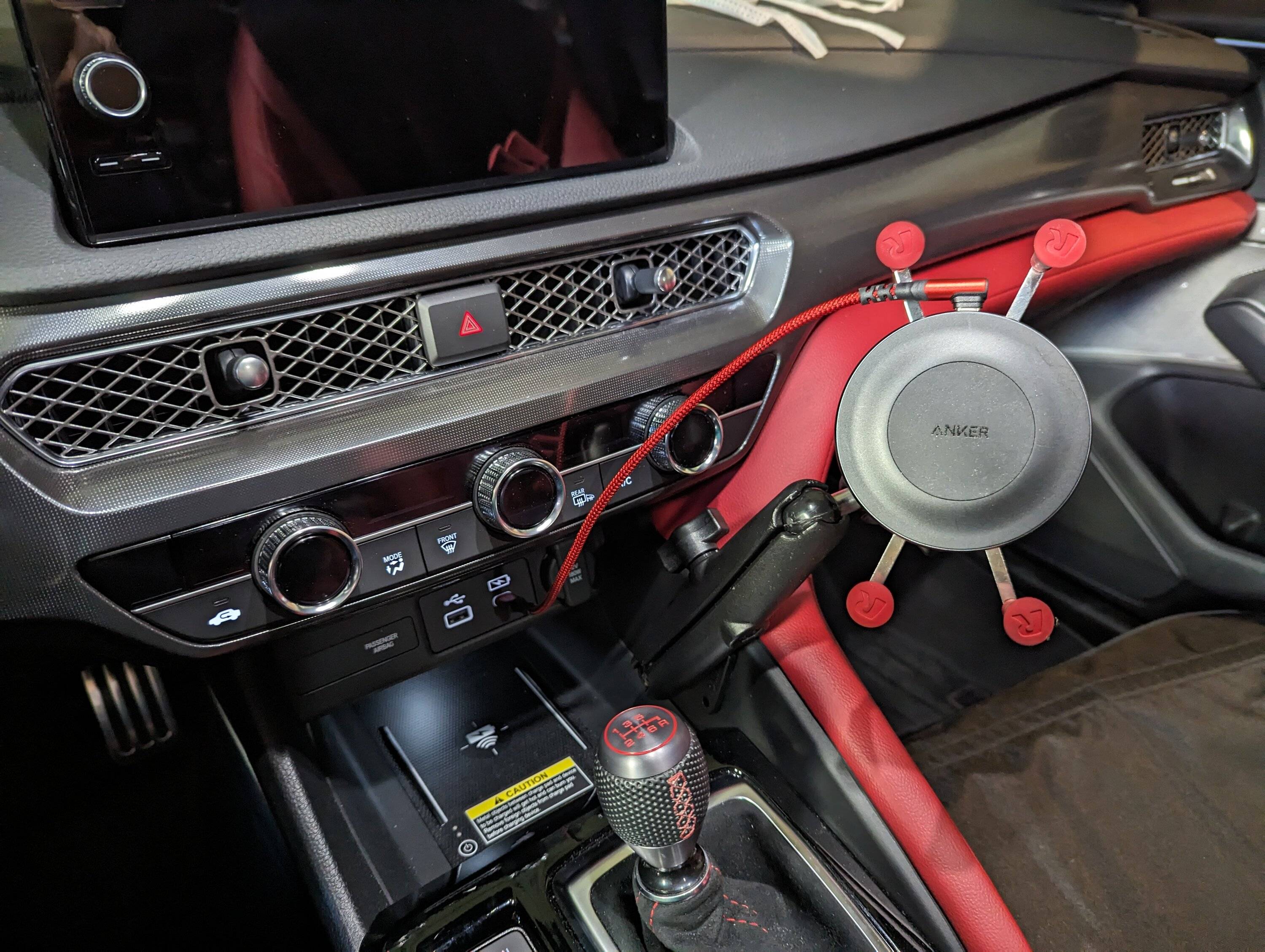

I temporarily put a RAM mount 1-inch ball plate on the side of the center console to the right of the charging tray using some 3M VHB double-sided adhesive tape. i then mounted a long RAM arm and a short arm via a connector piece to ultimately mount my X-grip phone mount that i added a charging plate. i needed the extra length on the mount otherwise it gets in the way of shifting. the solution looked good until i found the mounting plate came off the adhesive a few hours later
Acura Integra Phone mount PXL_20231119_163618359

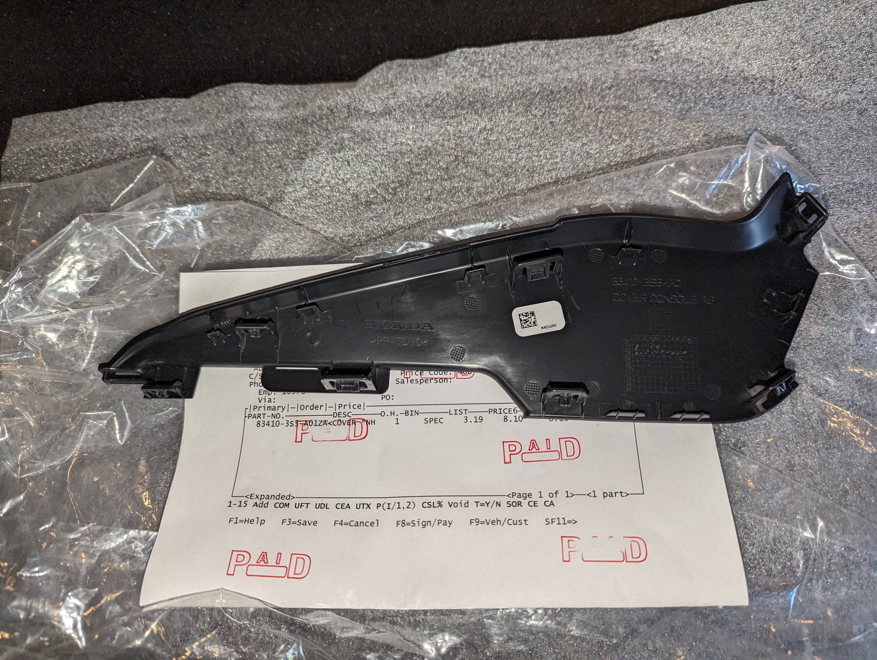

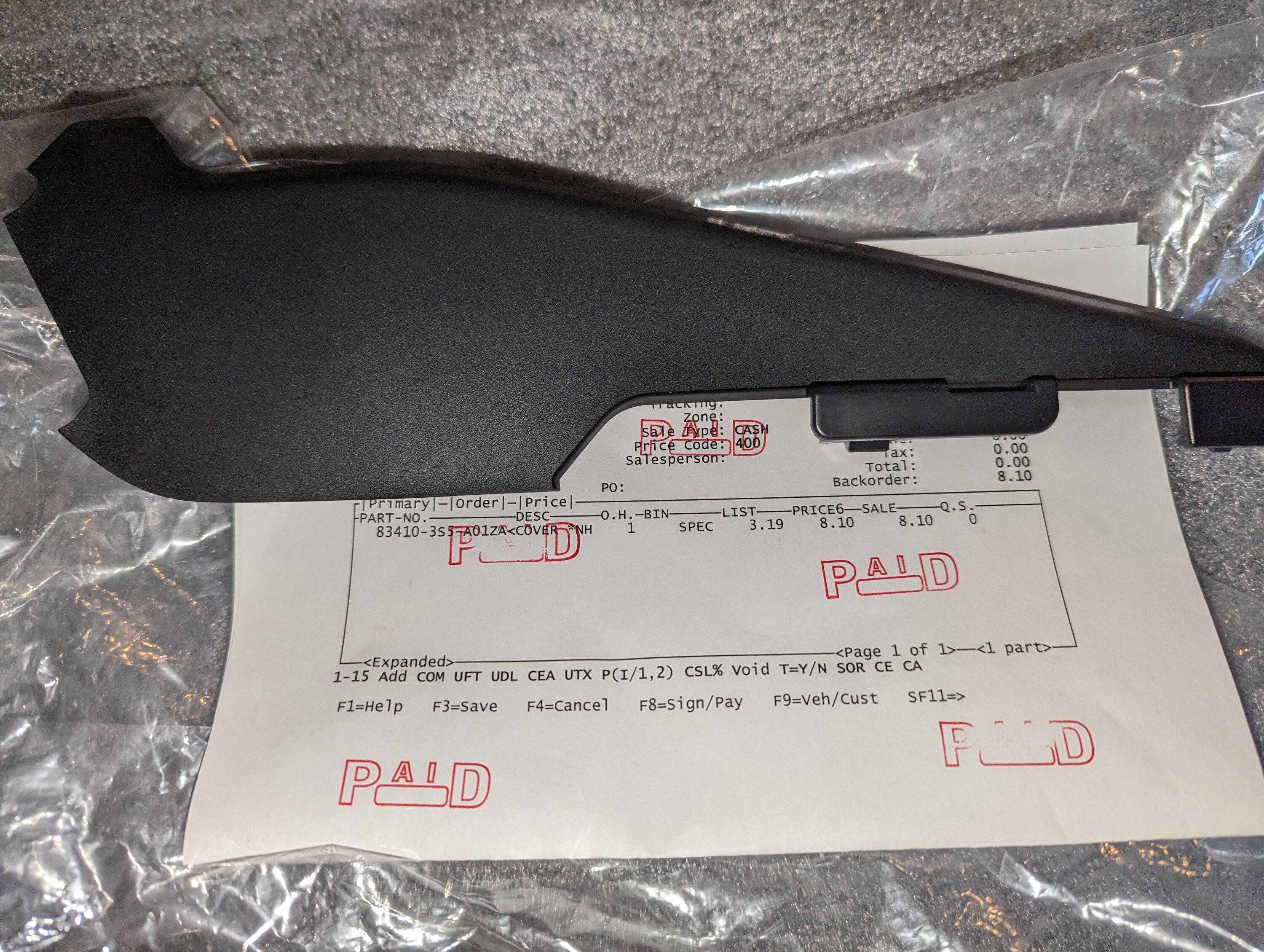

i had already ordered that plastic trim piece. ultimately i want to drill some holes and fasten the ball mount directly as double sided adhesive is clearly not strong enough. i'm just not sure how to take apart that trim piece. i imagine i'll have to remove the center console and the leather trim above the passenger's knees. i saw there's a video/tutorial on the center console trim removal, but i haven't seen anything for the leather piece nor the side piece that i purchased. i would love some help/guidance before i start the endeavor.
Acura Integra Phone mount PXL_20231119_163733350
Acura Integra Phone mount PXL_20231119_163752909

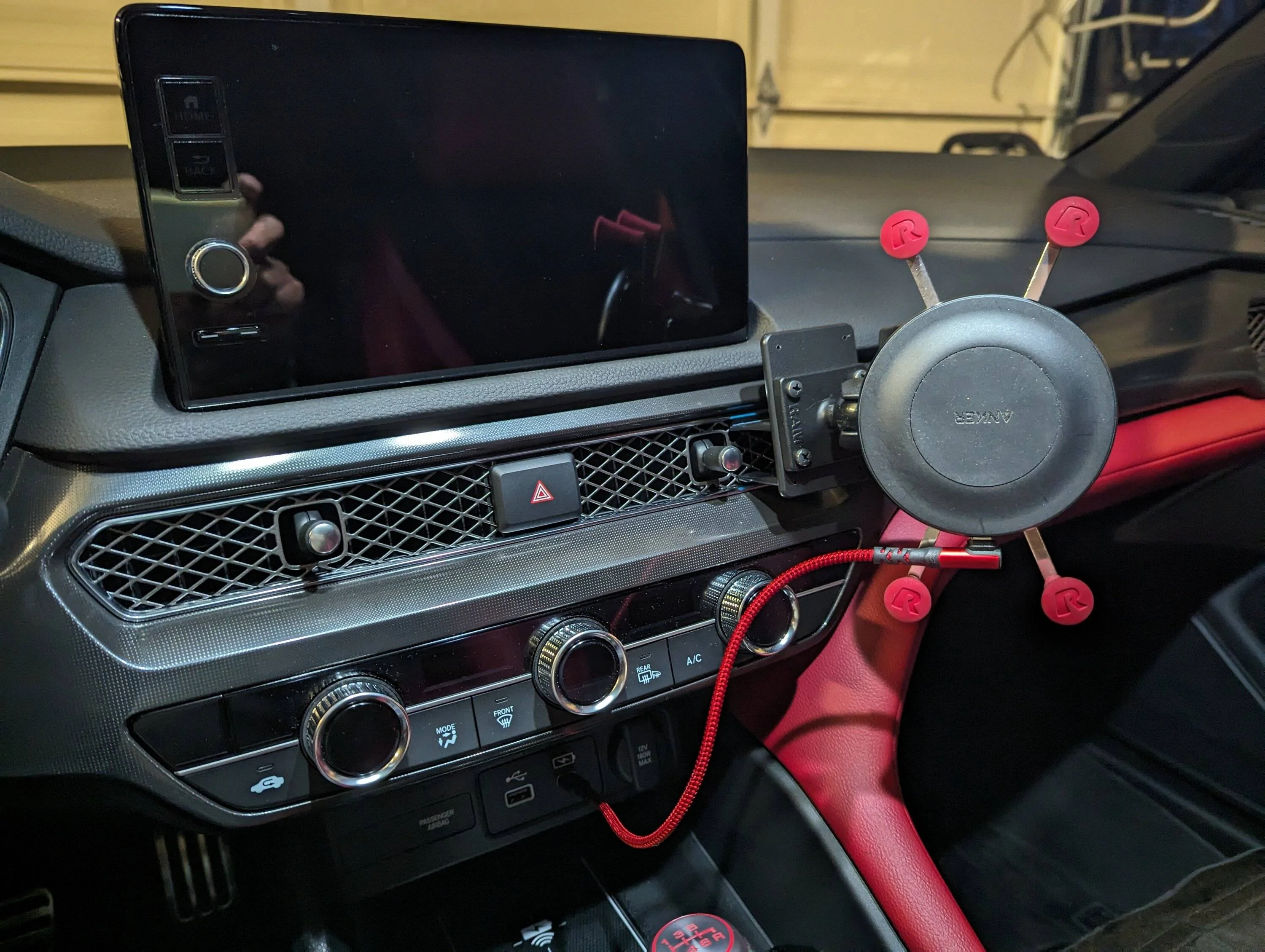

My order arrived from ProClip and I cobbled together my own setup.
I had ordered the angle mount/base, 15 degree wedge, and the universal holder compatible with my Pixel 7.
I was quite surprised by the sturdiness of the mount since it is essentially held in place by tension and two small lips that tuck between the surrounding vent trim and the mesh itself, which was hard to engage at first. I didn't use the adhesive back either. As for the holder itself I didn't really like the way it held my phone.
I drilled a new set of holes for my AMPS plate as the existing pilot holes seem to line up with the plastic posts of the mount itself. The screws and nuts included in the wedge plate were perfect for fastening my AMPS RAM 1" ball plate. I then used a short socket adapter to connect my XGrip. This far, remarkably sturdy, but does have some jiggle with vibration. I may consider switching to a smaller profile SnapLink ball that RAM has.
Acura Integra Phone mount PXL_20231211_074533182
