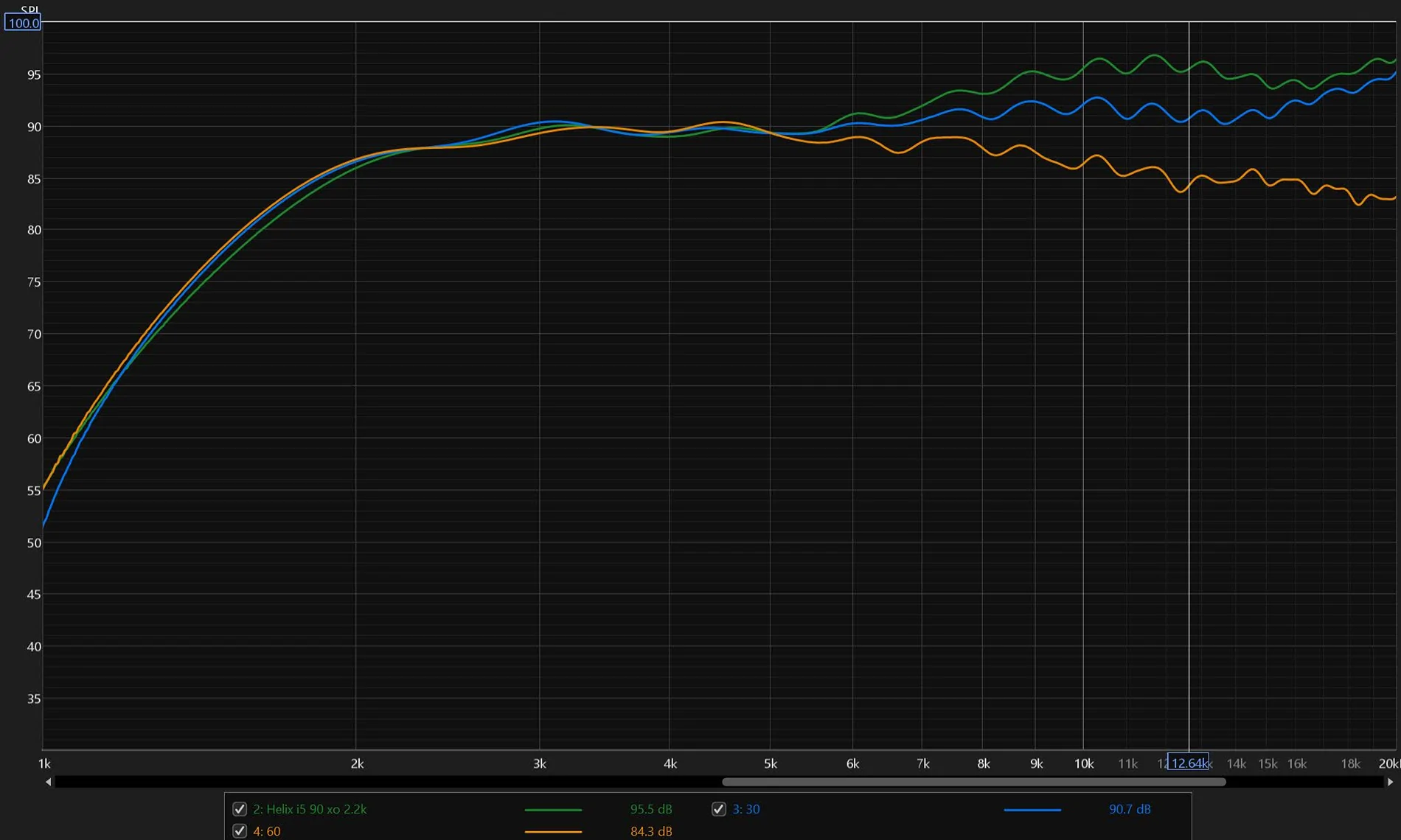

Thanks to Raw-Cat on youtube, I was able to download calibrated MDAT files for all of my finalist tweeters: The Scan-Speak D3004/602006, Seas 27TFFNC/G, Musway MG6.2T, and Helix Ci5.
This data helped me eliminate the Seas and Musway for distortion and dispersion issues, and reconsider the Helix Ci5 which is a remarkable performer. To top it off, it's tiny and comes with various custom mounts in the box. It's likely my final choice but I'm still debating the Scan-Speak a little because of my love for the brand.
That said, the Helix has better off axis response and surprisingly better distortion than the much more expensive Scan-Speak. And it's WAY smaller. So it will be hard to beat.

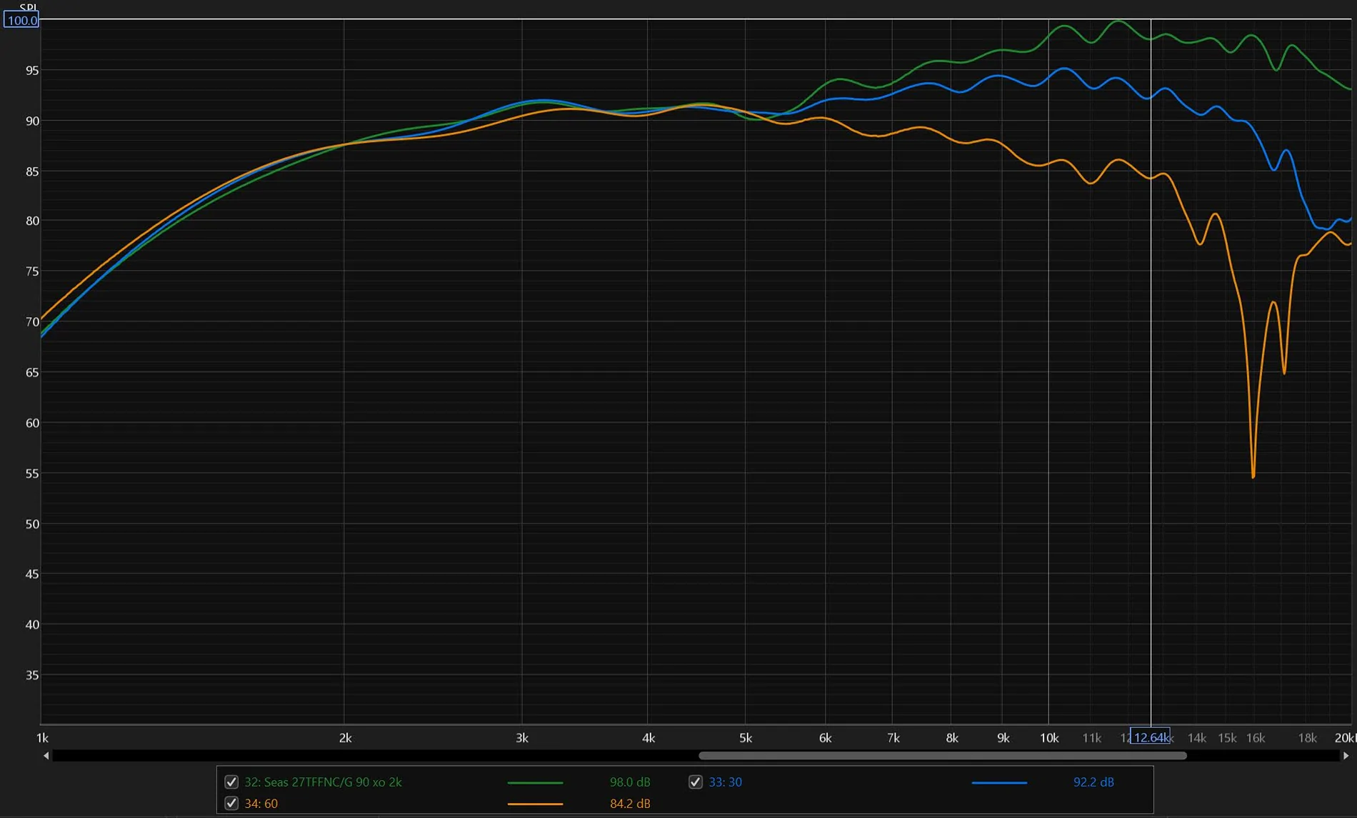

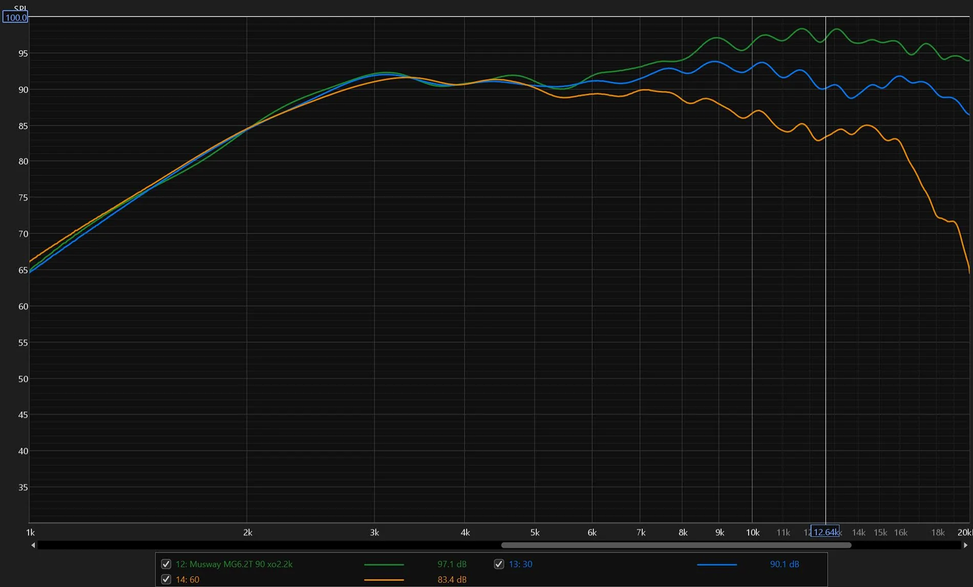

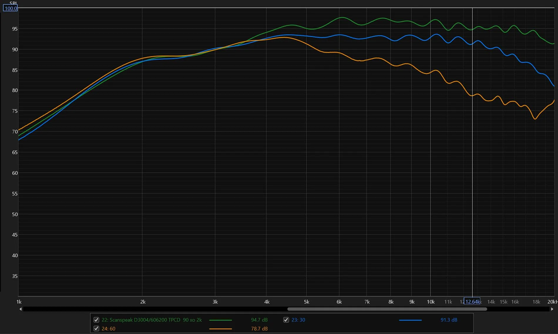

Here are some screenshots from REW showing the 0, 30 and 60 degree farfield responses:
Scan-Speak:
Acura Integra I'm building a fully-integrated digital source solution for Acura Integra ELS / Honda Civic Bose (new thread title) 1767460076014-a2
Helix:
Acura Integra I'm building a fully-integrated digital source solution for Acura Integra ELS / Honda Civic Bose (new thread title) 1767460085749-68
Musway:
Acura Integra I'm building a fully-integrated digital source solution for Acura Integra ELS / Honda Civic Bose (new thread title) 1767460094049-yi
Seas:
Acura Integra I'm building a fully-integrated digital source solution for Acura Integra ELS / Honda Civic Bose (new thread title) 1767460102612-sn
As you can see, the Musway has a rapid fall off on the extreme off axis response in the highest registers, and the Seas has a weird diffraction effect of some sort. Those aren't that important because it's at the limit of human hearing. I'm more interested in how consistent the 0, 30 and 60 degree curves are from about 5 to 10kHz. Keeping this spread as tight and "similarly shaped" as possible leads to a much more stable soundstage with varying head position. The Helix does need a little EQ up top to tame some brightness, but that's absolutely not an issue and it's always better to have to take some signal out than put some in.
Some might warn that you should not use a metal dome if you don't like harshness, but it's critical to distinguish between brightness and harshness as they are not the same thing. Brightness is caused by extra sound energy, which can be tamed, while harshness is caused by distortion which cannot be EQ'ed out. That's why you need to look at response (SPL) and distortion to know whether a speaker is a good choice. As you'll see in the next post, the Helix has the lowest distortion between the measured speakers. it won't sound harsh at all in fact it will sound the cleanest.
What the Scan-Speak has going for it is authoritative lower-frequency extension. It's just a beast, and can play loud and low all day. It's the reason I'm considering it, but I think it's probably not worth the trade-offs (worse dispersion, top end response, and distortion).

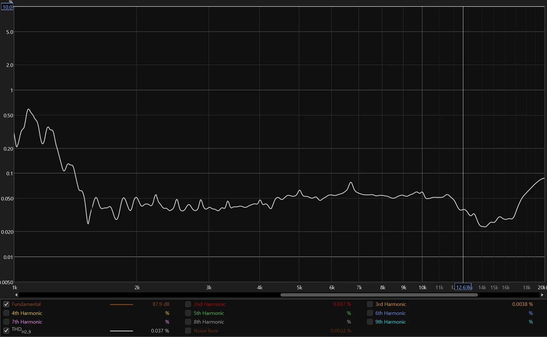

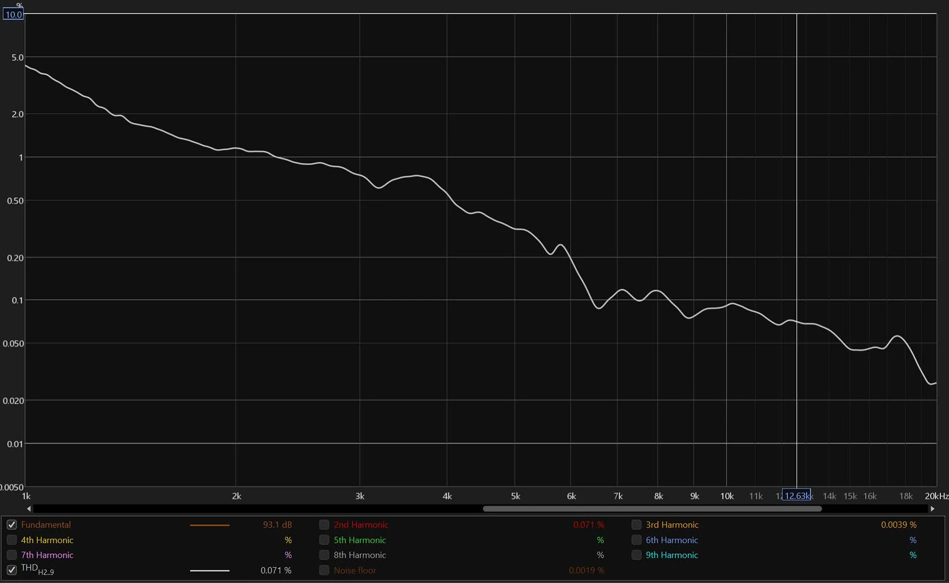

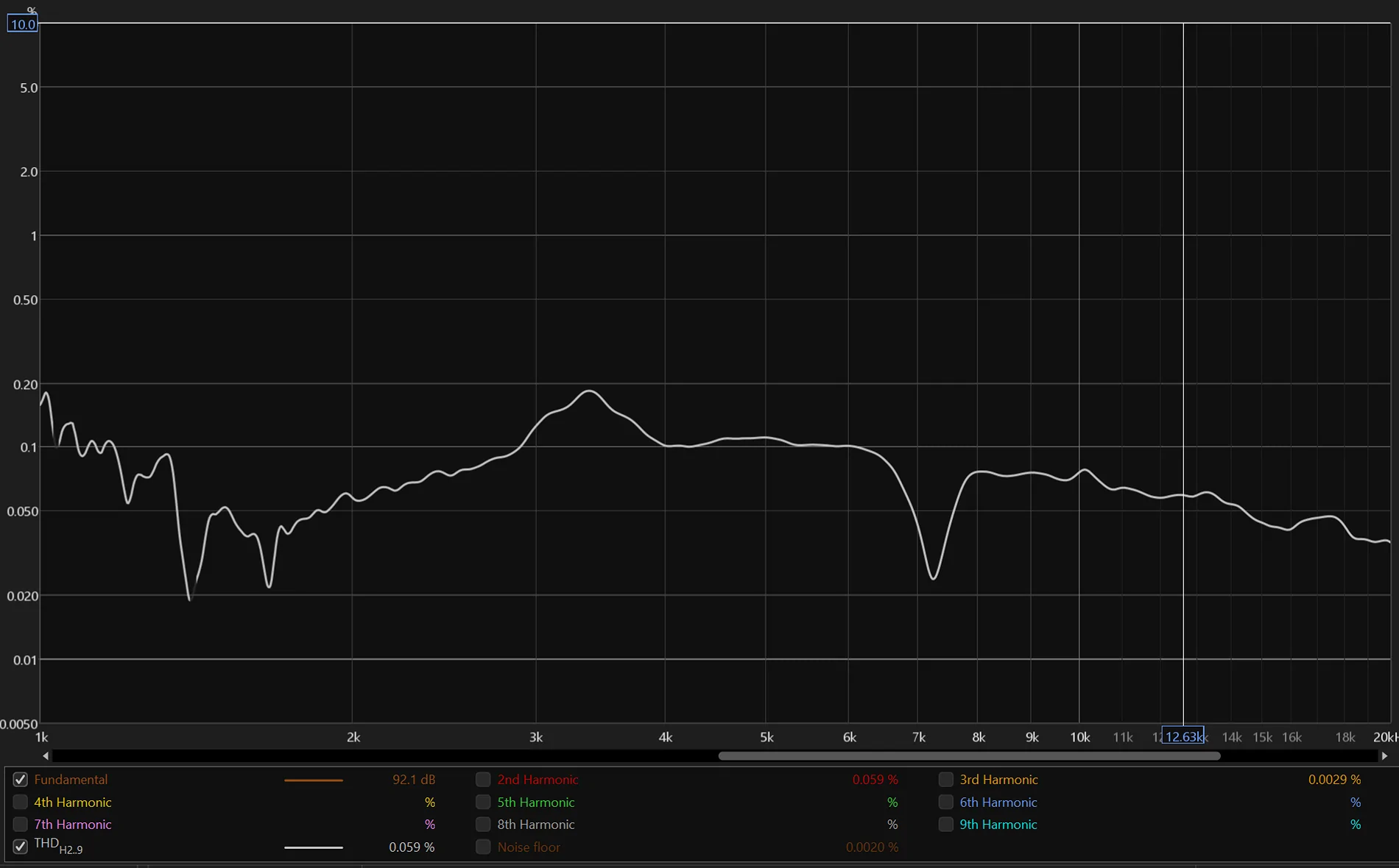

Nearfield THD for the Helix:
Acura Integra I'm building a fully-integrated digital source solution for Acura Integra ELS / Honda Civic Bose (new thread title) 1767460215554-t
And the Scan-Speak:
Acura Integra I'm building a fully-integrated digital source solution for Acura Integra ELS / Honda Civic Bose (new thread title) 1767460247061-lj
The Seas is bad:
Acura Integra I'm building a fully-integrated digital source solution for Acura Integra ELS / Honda Civic Bose (new thread title) 1767487491099-rm
And finally the Musway is quite good:
Acura Integra I'm building a fully-integrated digital source solution for Acura Integra ELS / Honda Civic Bose (new thread title) 1767487540612-j

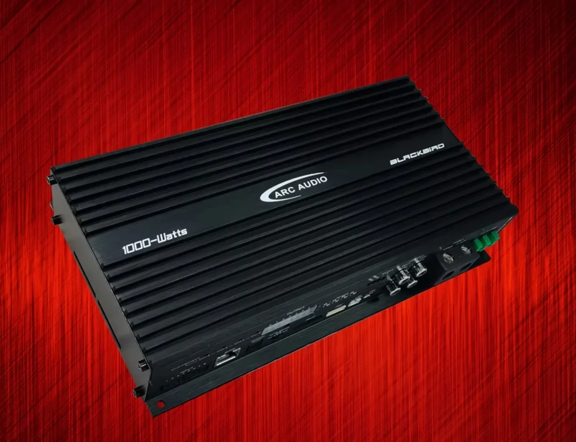

I have chosen the Arc Audio Blackbird. This is an 8-channel amplifier with 12 channels of DSP. I will bridge channels 7+8 to drive the subwoofer. I selected this amplifier due to brand reputation for stellar performance and client service. It's a class D amp so it's small for its output (75W x 8). This amplifier will easily power all my speakers including the subwoofer beyond my target buffer of 100dB.
Finalist amplifiers I considered:​
Arc Audio X2 800.8 (not enough power)​
Audison AF C8.14 bit (not enough power and software/hardware inferior to Arc)​
Audison AF M8.14 bit (software/hardware inferior to Arc)​
JL Audio VX800/8i (not enough power and hardware inferior to Arc)​

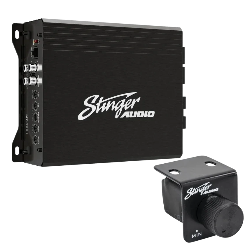

Edit: I decided to purchase a Stinger MT700.1 mono subwoofer amplifier for my sub. The sub I chose can be wired for a 1 ohm load, which will allow the Stinger amp to deliver a full 700 watts at 1% THD certified.

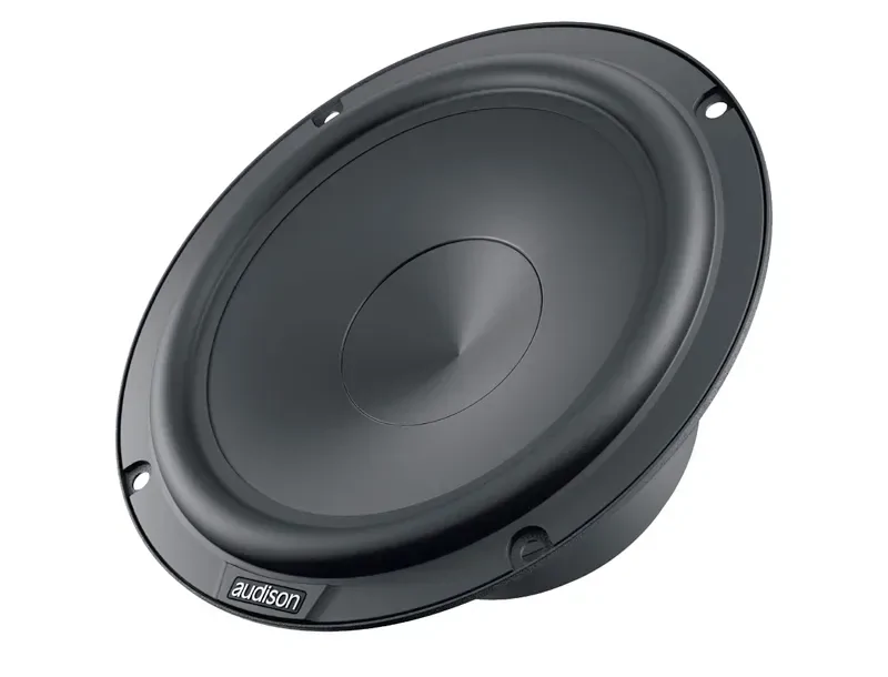

Front Midbass Selection
Originally I was set on (and purchased) the brutal "SQL" class Stereo Integrity TM65 mkIV. Unfortunately, I did not realize how small the door cutout is in our cars - too small to fit the girthy SI midbass, so I had to sell it. The replacement, which performs similar to the SI just with a lower max SPL capability (but still hits my 100dB target) is a set of Audison AP 6.5P midbasses. This speaker measures excellently and has shorting rings, and has a large Xmax compared to other "big brand" speakers. This means they will be very low distortion electro-mechanically. The treated paper cone means there will be little to no cone breakup within the passband. And since I am crossing these over at around 250-300Hz, any breakup is far beyond the cutoff and won't be audible.
Finalist midbasses I considered (other than the TM65):​
Hertz C165L (close to Audison performance but slightly less Xmax)​

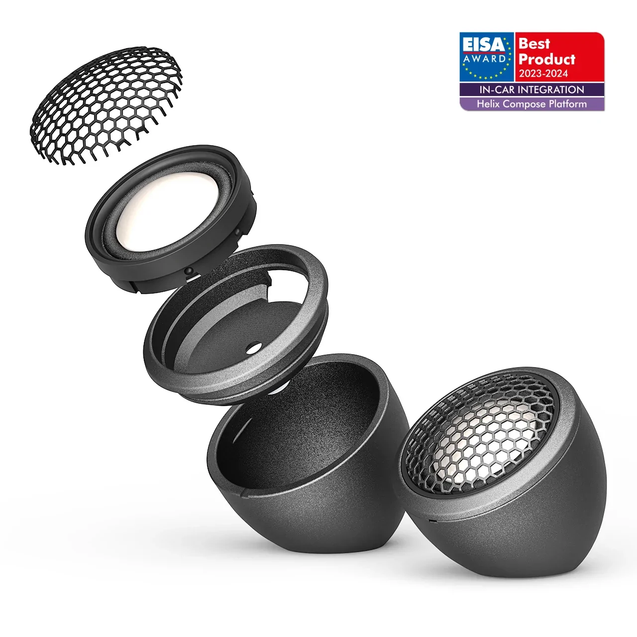

Front Tweeter Selection
Again, this was a very large list to consider. I evaluated hundreds of tweeters and ultimately chose the one with the combination of: the best dispersion pattern after beaming, a high beaming point, a low crossover point, and low distortion. Many of the tweeters I evaluated met a lot of these criteria, but only one met all of them. I went with the Helix Ci5 T25FM-CA which is shockingly good for its diminutive stature. This was another reason it tipped the scales: it will be much easier to install covertly.
Finalist tweeters:​
Audio Ace Club 1 (almost bought this one, but the smaller Helix tipped the scales)​
Musway MG6.2T (couldn't compare to the Helix in top end dispersion)​
Seas Prestige 27TFFNC/G (higher distortion; poor top-end dispersion)​

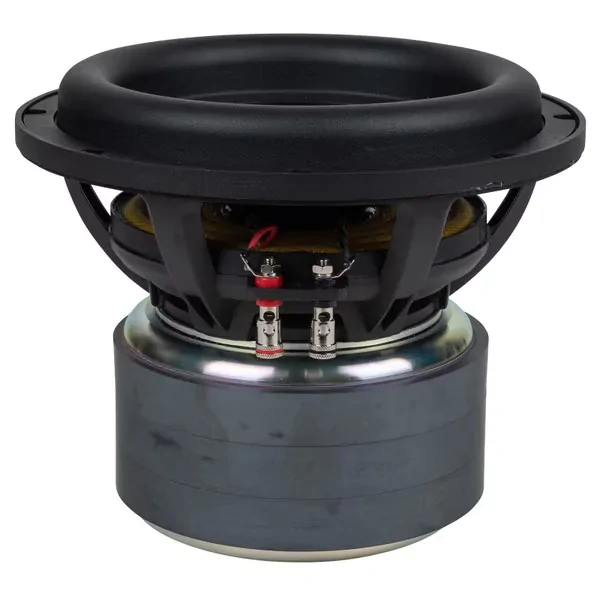

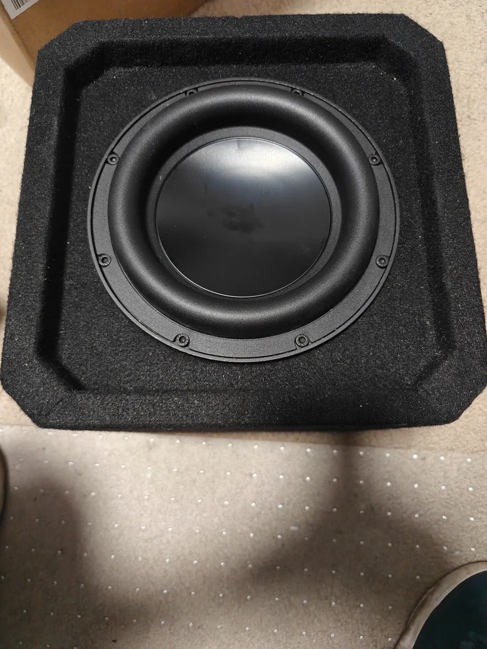

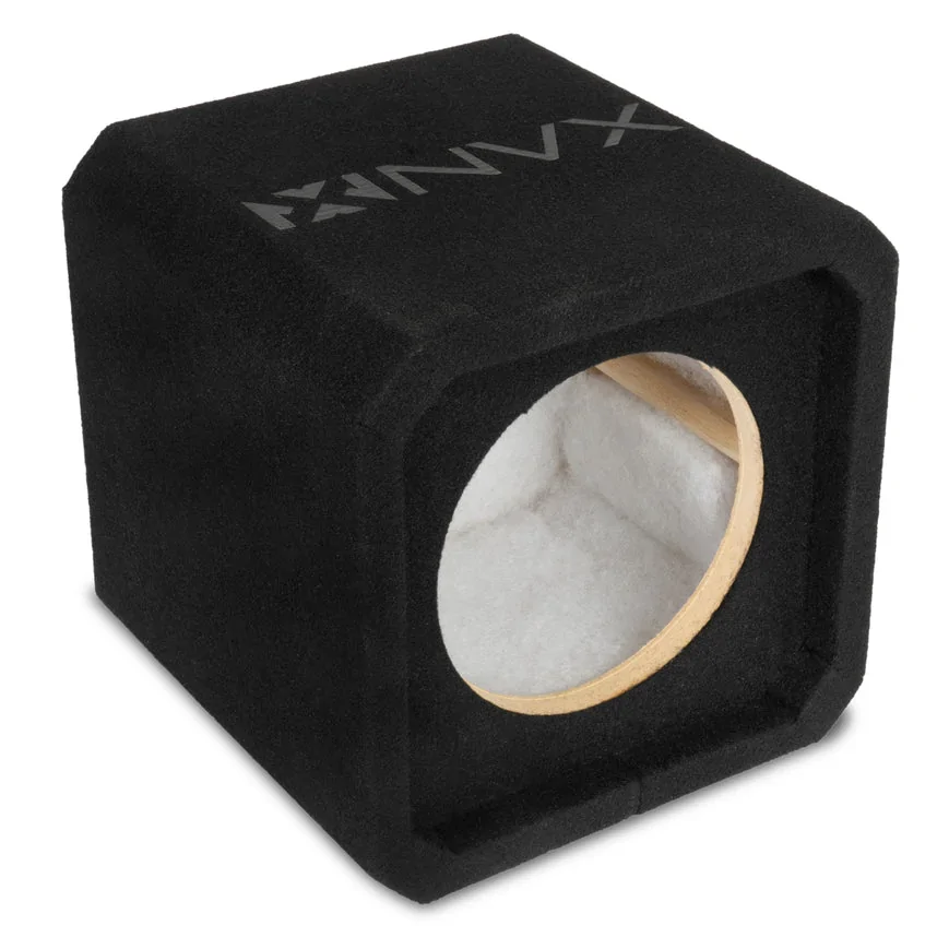

Subwoofer Selection
This was tough. I tried really really hard to find a subwoofer that would work for the factory enclosure, and there are a lot that will. In fact, I would recommend many of them to most people as they will perform very well. But I am aiming for perfect frequency response and extreme sub-bass depth and SPL capability. In the end I conceded that I'd need to use a separate enclosure, and since I didn't want to spend a lot of money on custom fabrication, I searched for an optimal pre-fab enclosure at a good price and high build quality. My constraints now became: as small an enclosure as possible, effortless extension to 20Hz, huge Xmax (for linearity and SPL), low distortion, capability to drive +10dB transients above the front stage. This combination was no easy feat. Almost every 8" subwoofer failed to meet the criteria and I nearly went with a 10", but I did one final search on Parts Express and found a miracle sub: the Dayton Audio SS8-22 which will happily perform in a tiny 0.45 cu-ft enclosure by NVX.
Finalist Subwoofers:​
Dayton Audio SS10-22 (this was choice #2, but when I found I could meet my SPL target with an 8" sub I went with the smaller version of this driver)​
Dayton RSS265HF-4 (poor cone control, larger enclosure, low max SPL)​
Dayton RSS265HO-44 (larger enclosure)​
Dayton Audio UMII10-22 (larger enclosure)​
Dayton Audio UMII8-22 (larger enclosure)​
Dayton RSS265HO-4 (larger enclosure)​
Dayton RSS210HO-4 (low max SPL)​
Dayton RSS210HF-4 (law max SPL)​
GRS 8SW-4HE (poor distortion, low SPL, large enclosure)​
GRS 10SW-4HE (poor distortion, very large enclosure)​

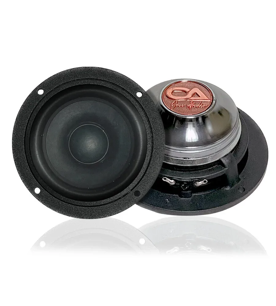

As mentioned in the intro, I decided to use some 4" CDT Audio drivers I had lying around as rear fill, time delayed and band passed. The idea is to mimic distant rear wall reflections of an auditorium/concert hall for a live music effect. I will have the option to tune this out if I don't like the effect.

Whew! Sorry for the long post! Pics of all the components below.
Acura Integra I'm building a fully-integrated digital source solution for Acura Integra ELS / Honda Civic Bose (new thread title) 1769404340038-vm
Acura Integra I'm building a fully-integrated digital source solution for Acura Integra ELS / Honda Civic Bose (new thread title) 1769404350173-u5
Acura Integra I'm building a fully-integrated digital source solution for Acura Integra ELS / Honda Civic Bose (new thread title) 1769404358914-k
Acura Integra I'm building a fully-integrated digital source solution for Acura Integra ELS / Honda Civic Bose (new thread title) 1769404367785-qj
Acura Integra I'm building a fully-integrated digital source solution for Acura Integra ELS / Honda Civic Bose (new thread title) 1770174133604-v
Acura Integra I'm building a fully-integrated digital source solution for Acura Integra ELS / Honda Civic Bose (new thread title) 1769404374458-7q
Acura Integra I'm building a fully-integrated digital source solution for Acura Integra ELS / Honda Civic Bose (new thread title) 1769404380349-v

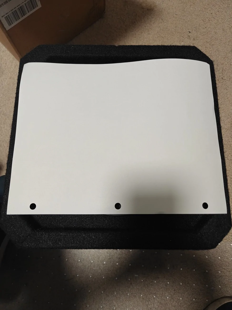

8.5x11 letter sized paper on top for scale. It's TINY.

ashmostro
ashmostro
Aug 19, 2025
584
483
Northern VA
2025 ITS
No, it won't fit there. It'll just be in the trunk, hence my desire for the smallest possible loss of utility.
