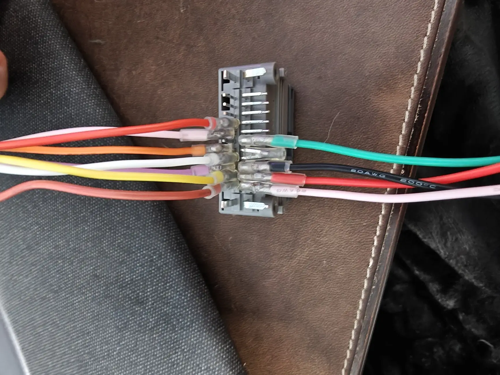

Progress is being made! I have started building the custom connector to inject signal to the factory speaker wiring harness. Tomorrow, I'll start on the input side. Next will be the proprietary volume signal converter, then power wiring for the amps, mounting the amps, then the speakers and sound deadening.

I'm curious - who here would be interested in a complete T harness for full system integration (specifically analog speaker level input, not pure digital conversion like I'm doing)? This harness would enable intercepting every independent OEM channel into your DSP/amplifier.
Building the harness is a pretty involved procedure since the output plug on the ELS amplifier is so new that there is only a board-mount connector available, rather than the much easier to assemble cable-style plug.
