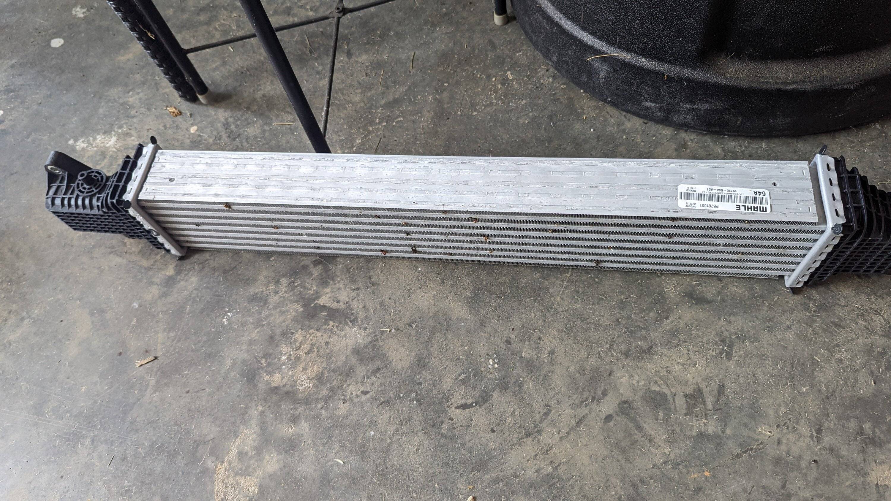

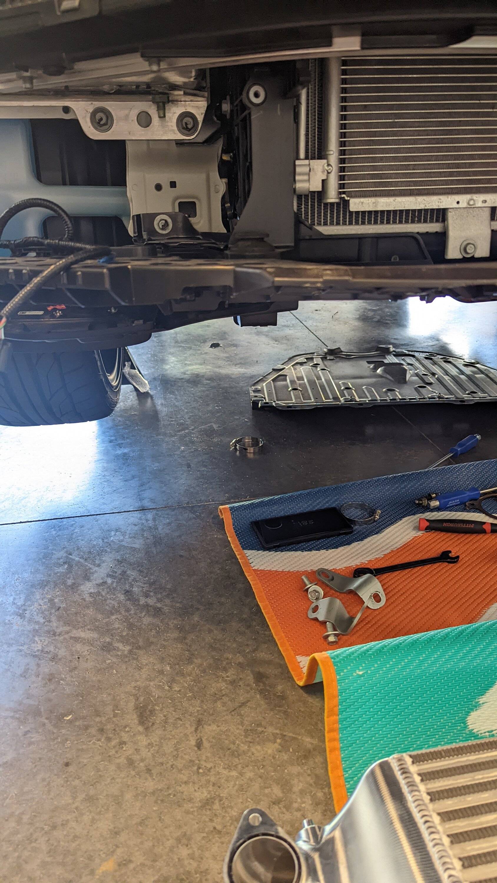

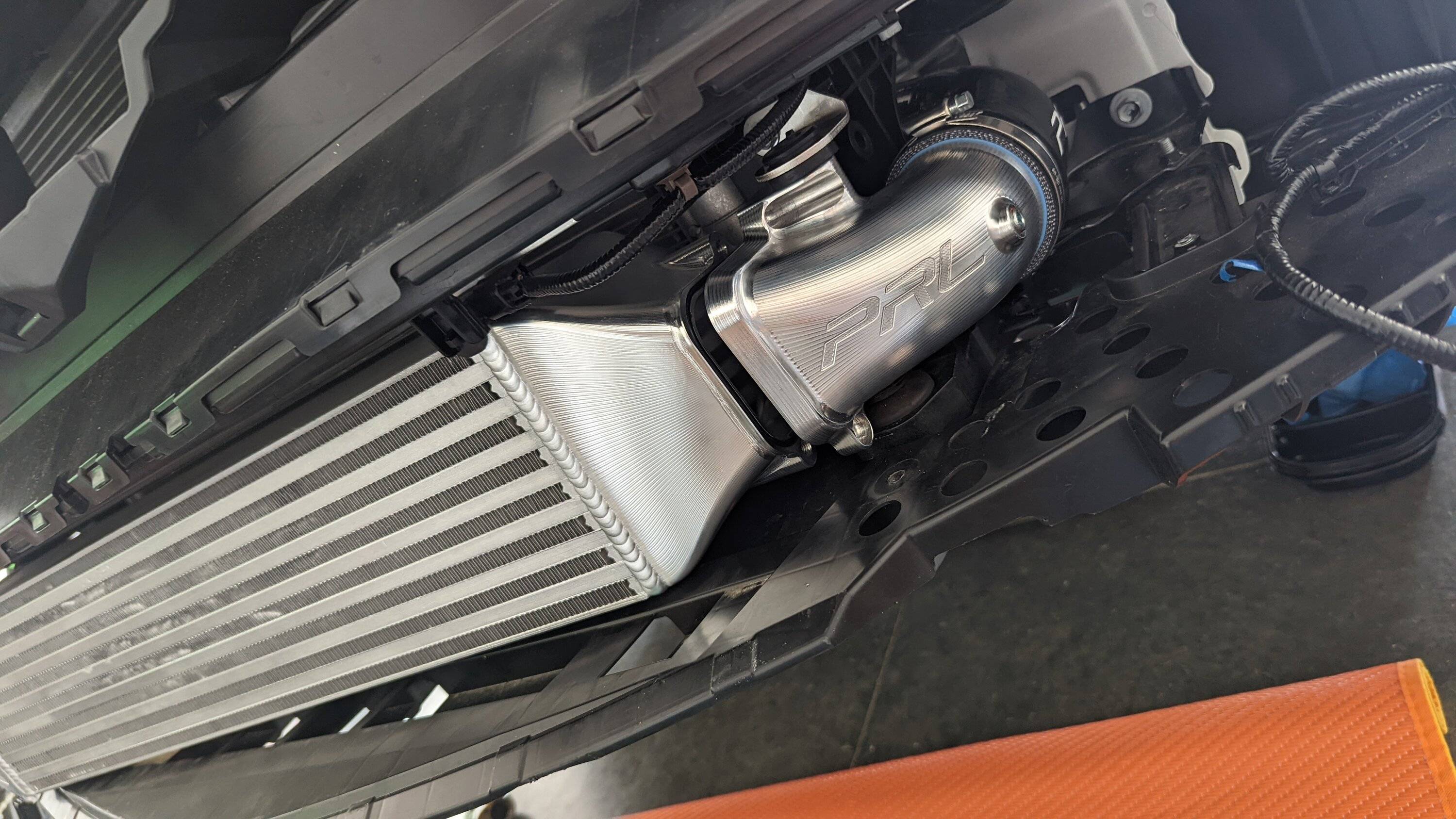

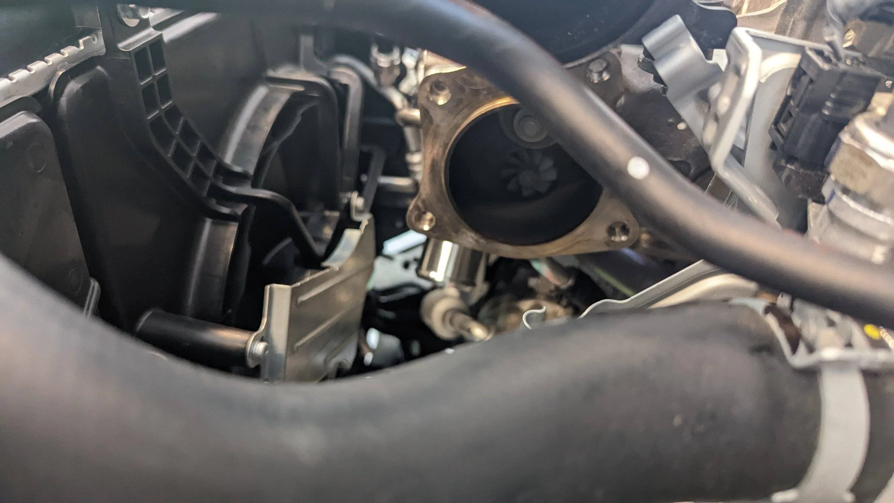

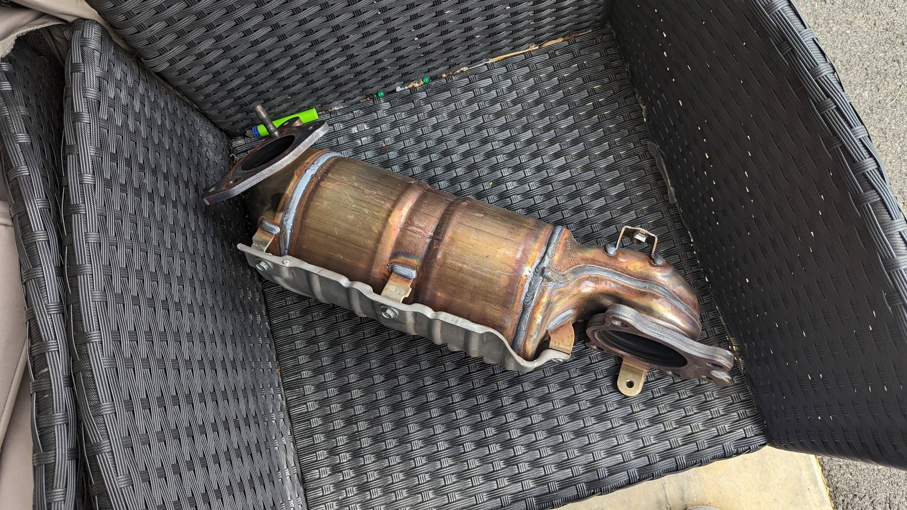

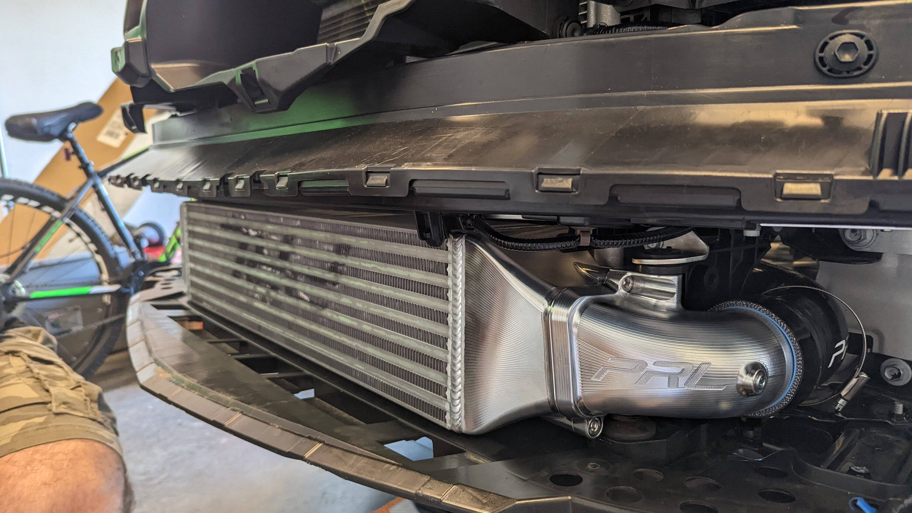

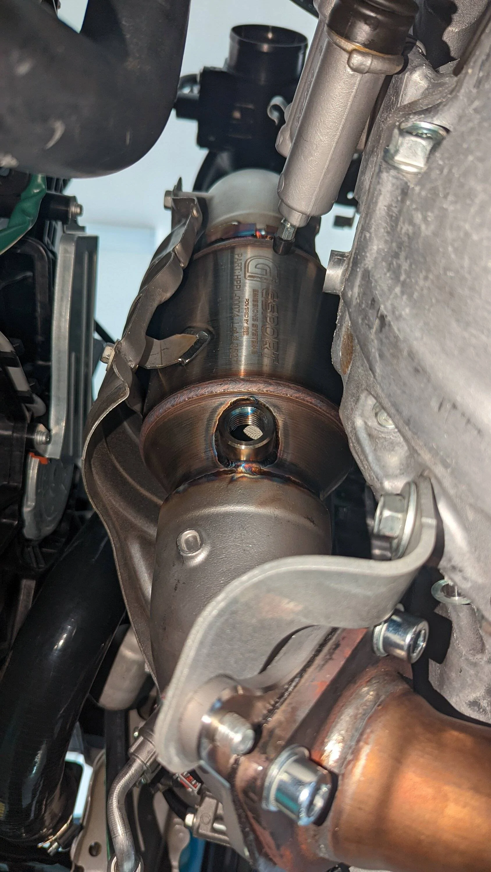

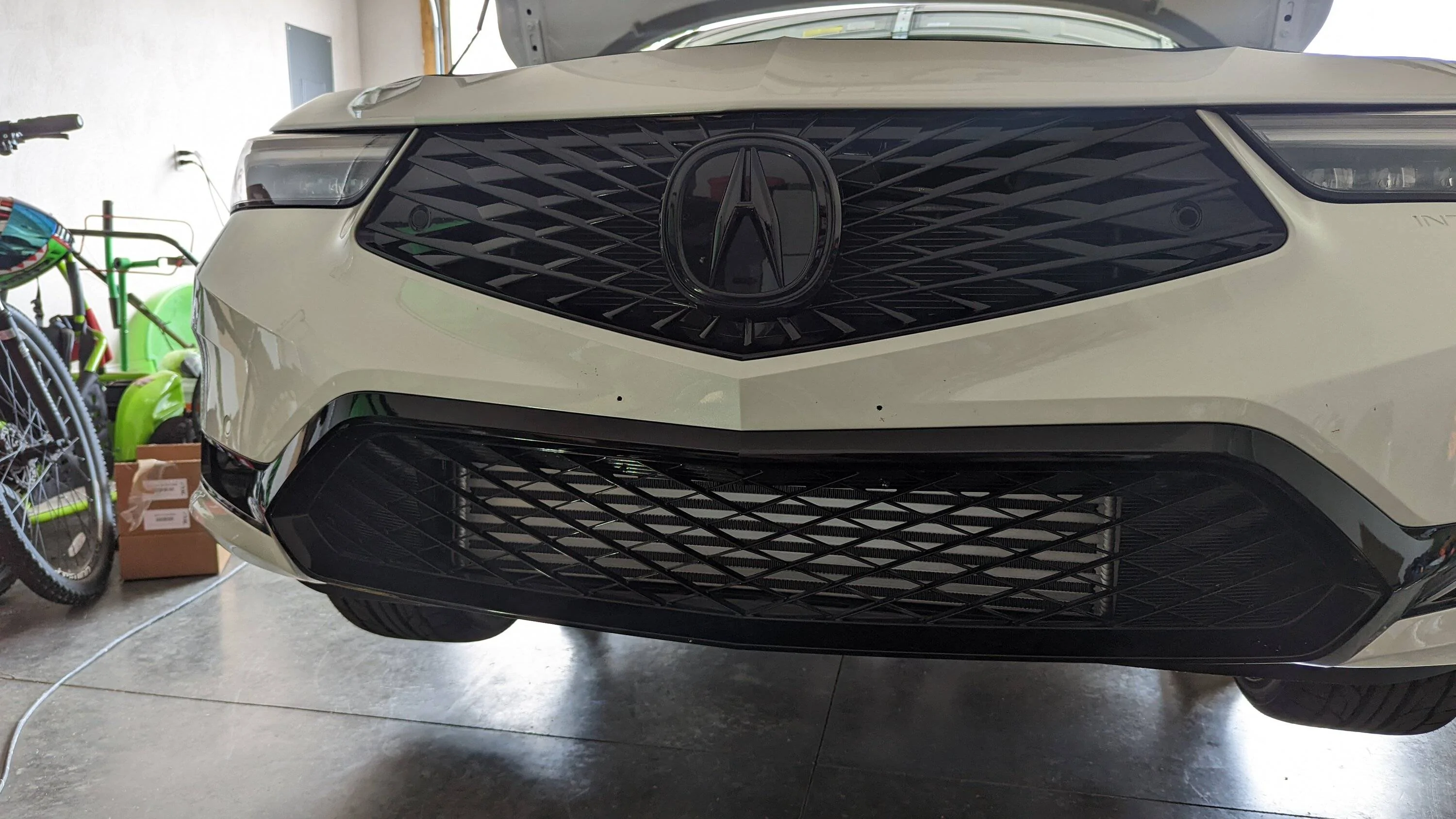

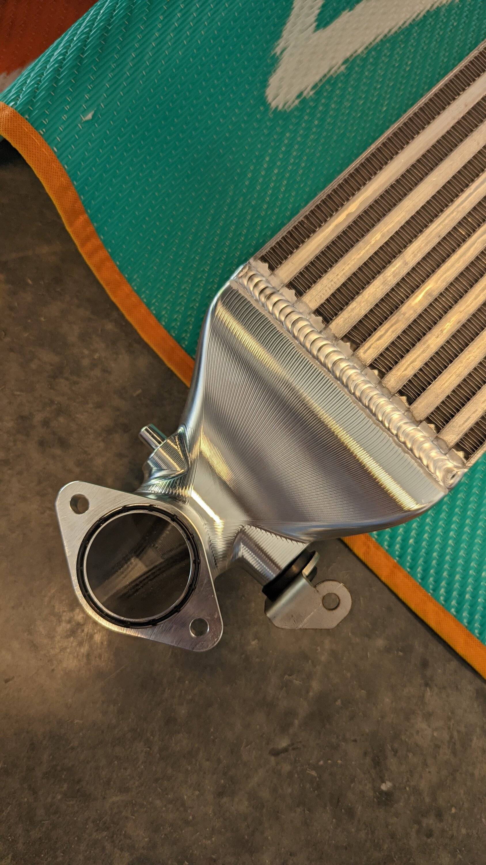

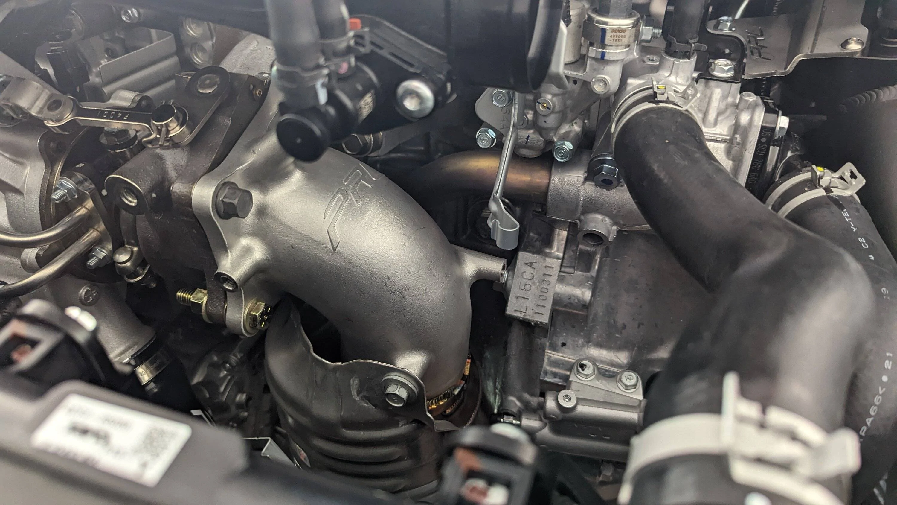

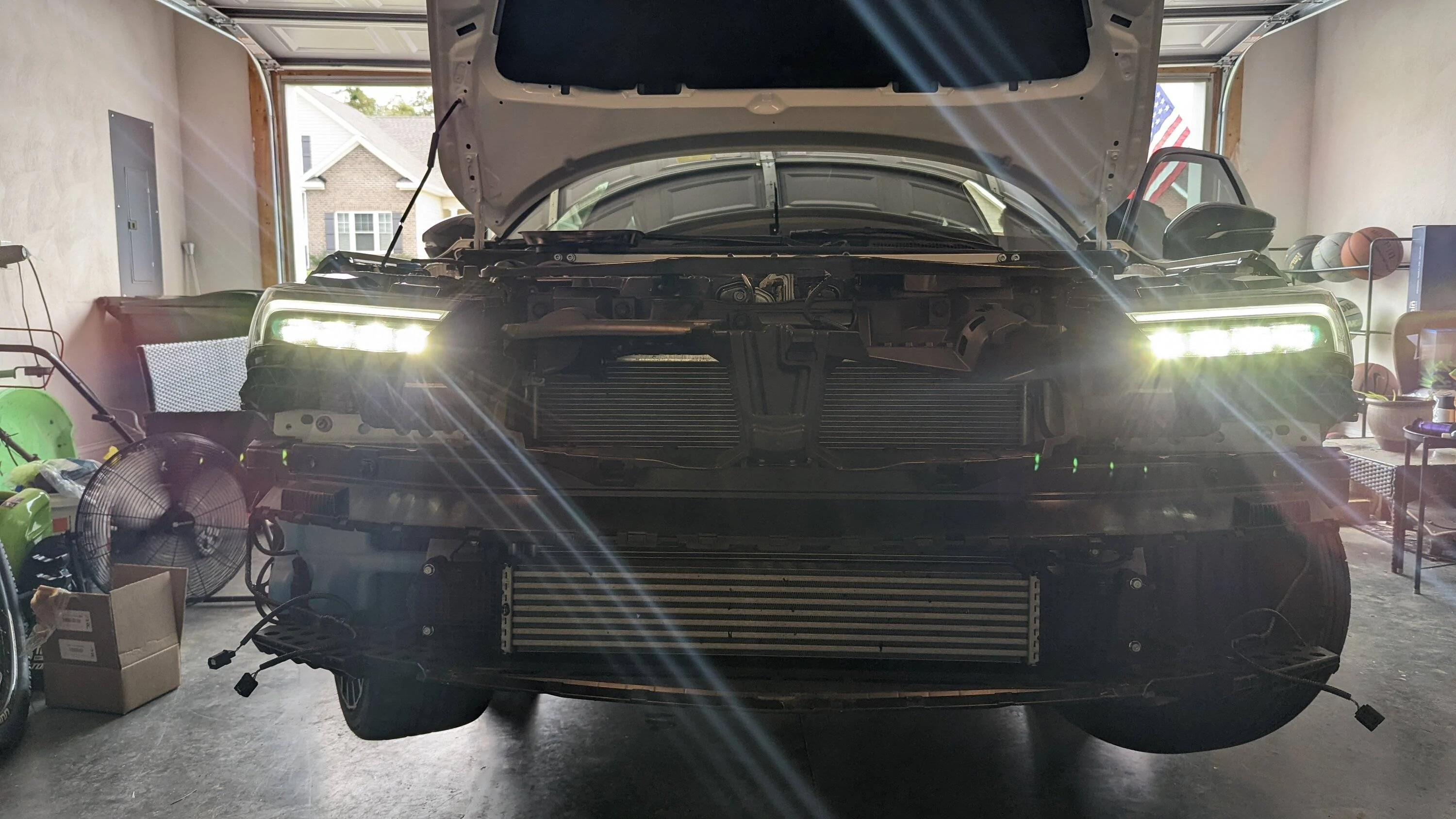

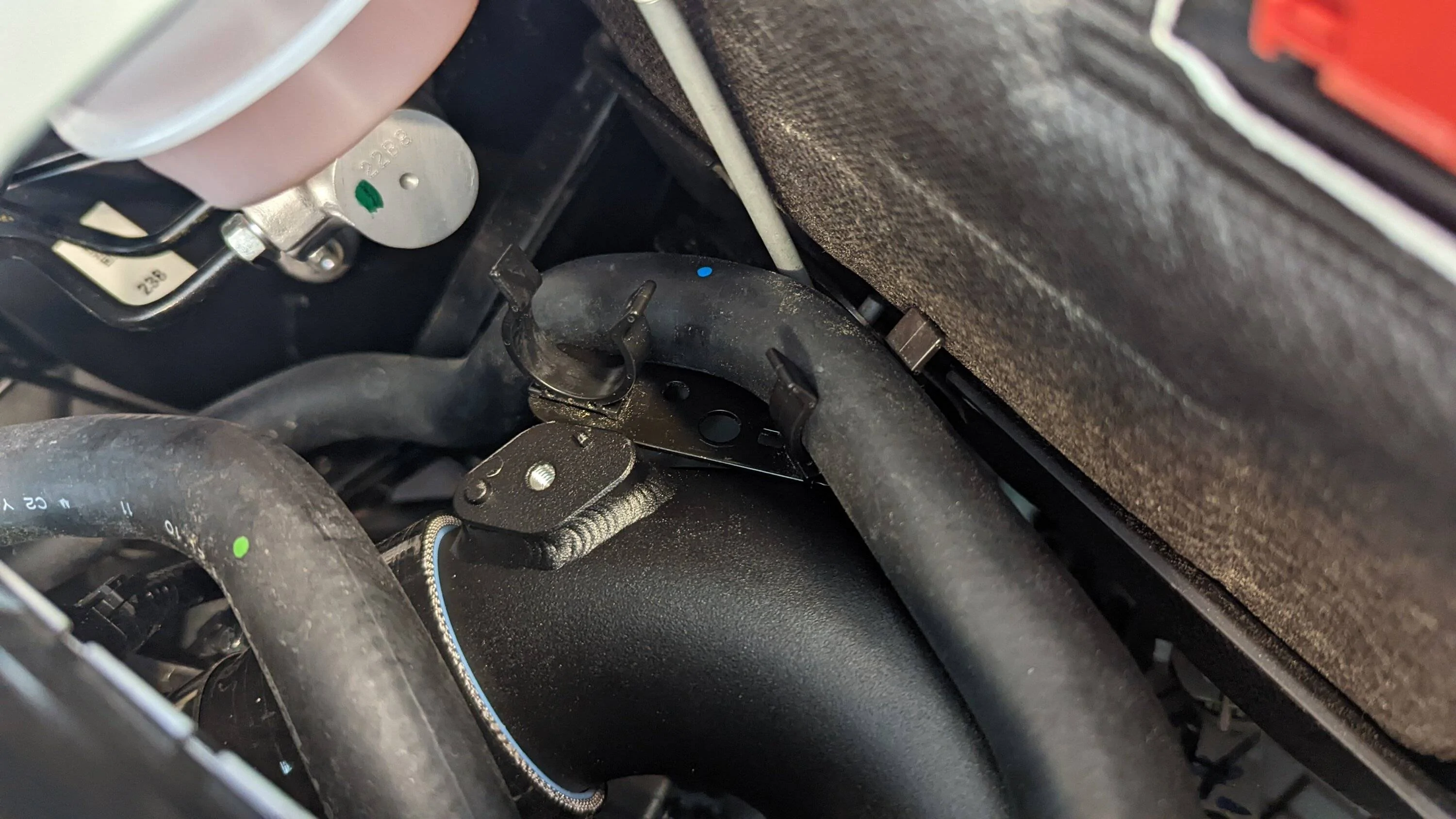

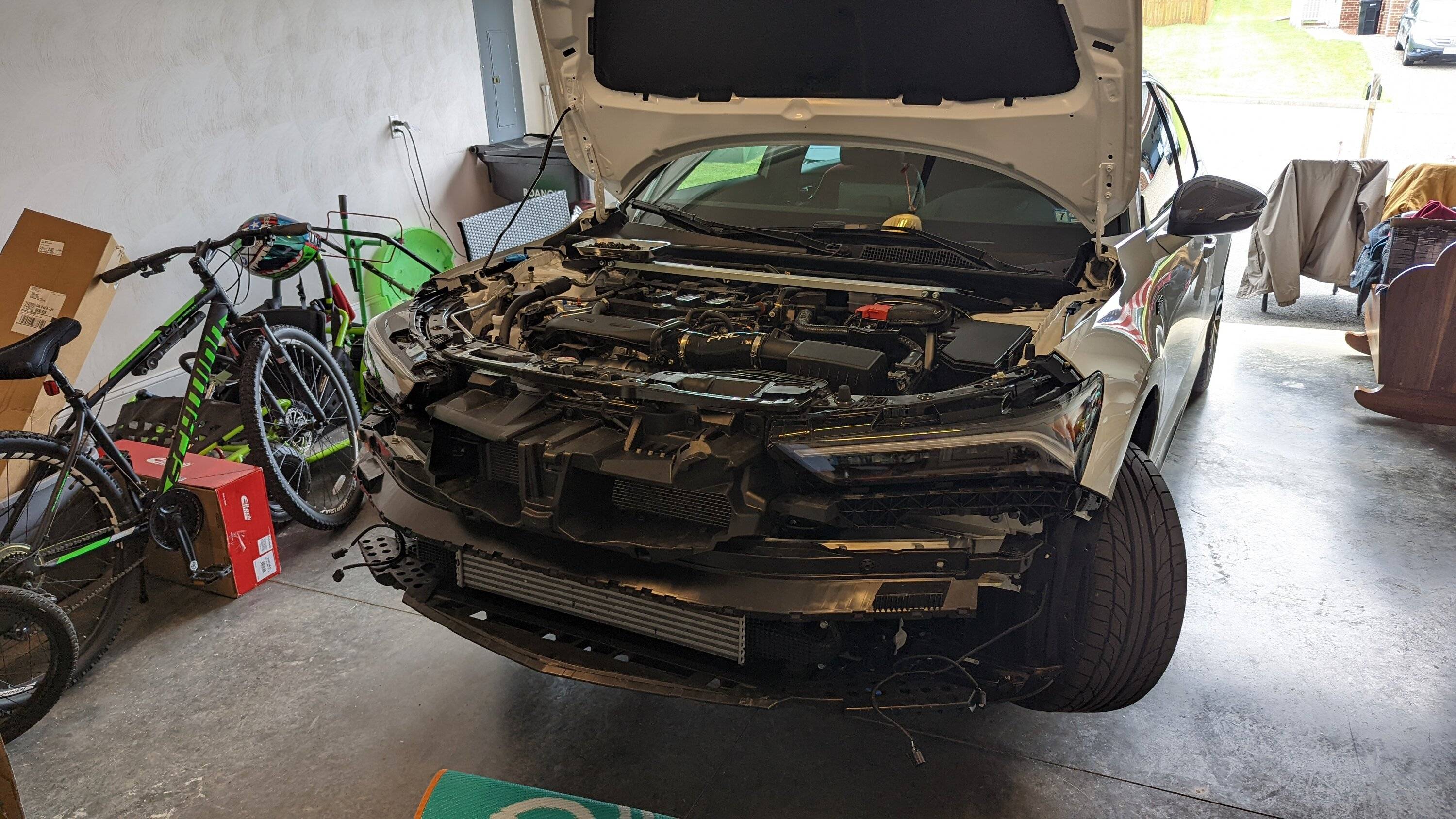

Thanks to Aaron Chernok from PRLmotorsports and Michael Hinton at axion industries for the quick delivery of the parts. Added the PRL intercooler, charge pipe upgrade, and down pipe . I'm extremely happy with the performance and sound. The factory exhaust has come alive as well as the motor. I still need to install the hasport motor mount. Paired with the springs and wheels and the sticky nitto 555 tries it feels great!

Any check engine lights with the new down pipe and high flow cat?

I had a CEL with the down pipe with the o2 sensor extension. I fished the sensor connector around and zip tied to another spot so I wouldn't use the extension and it cleared right up
