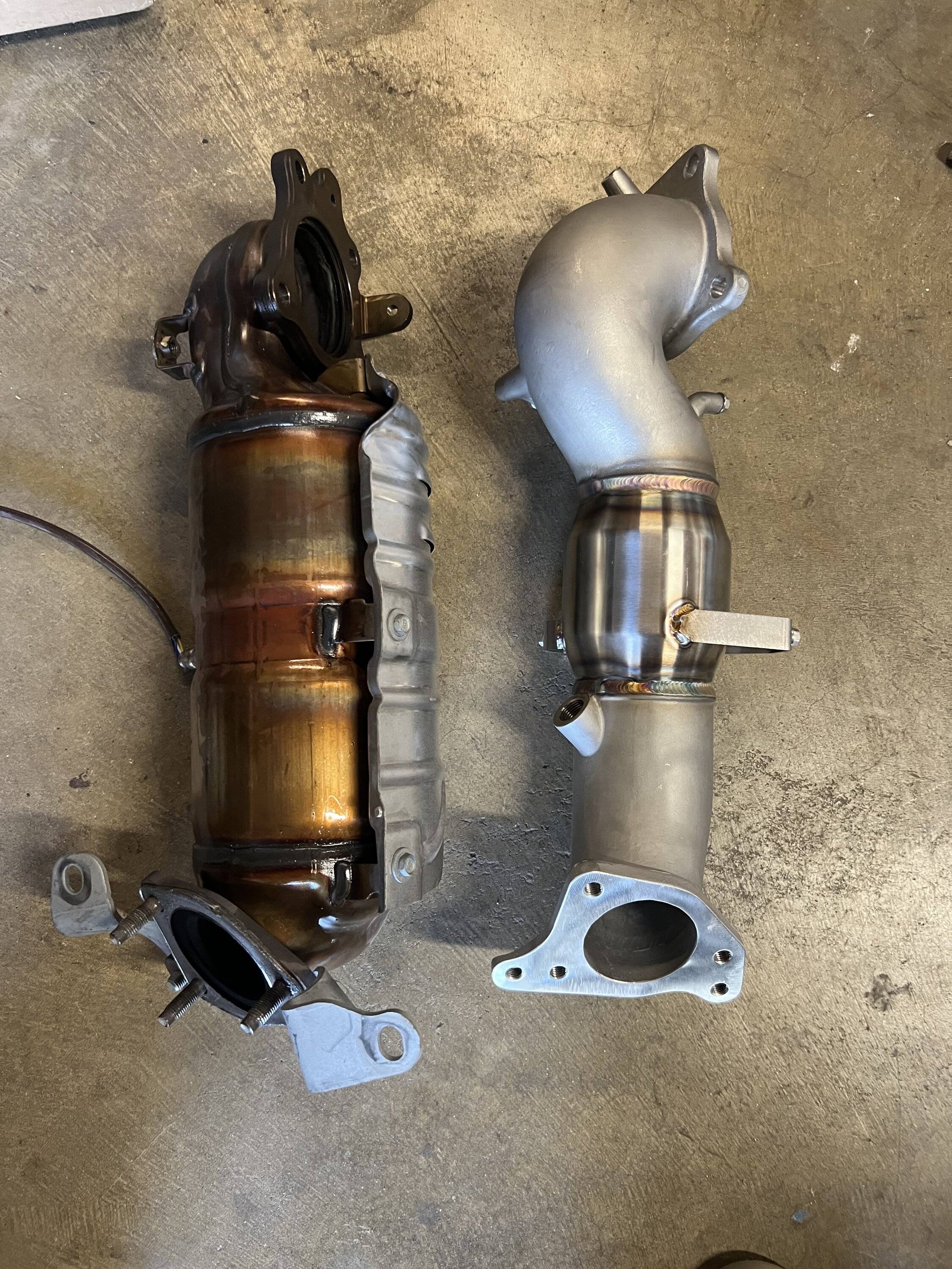

last night I did the 27Won down-pipe and did a revised Phearable Tune since I added a front pipe, DP and Front Mount.
-So far I have a prl
Intake , Down pipe and front pipe and the car sounds so good with OEM muffler, no exhaust needed now, my car growls almost as if I had an exhaust and at high speeds sound great with no rasp

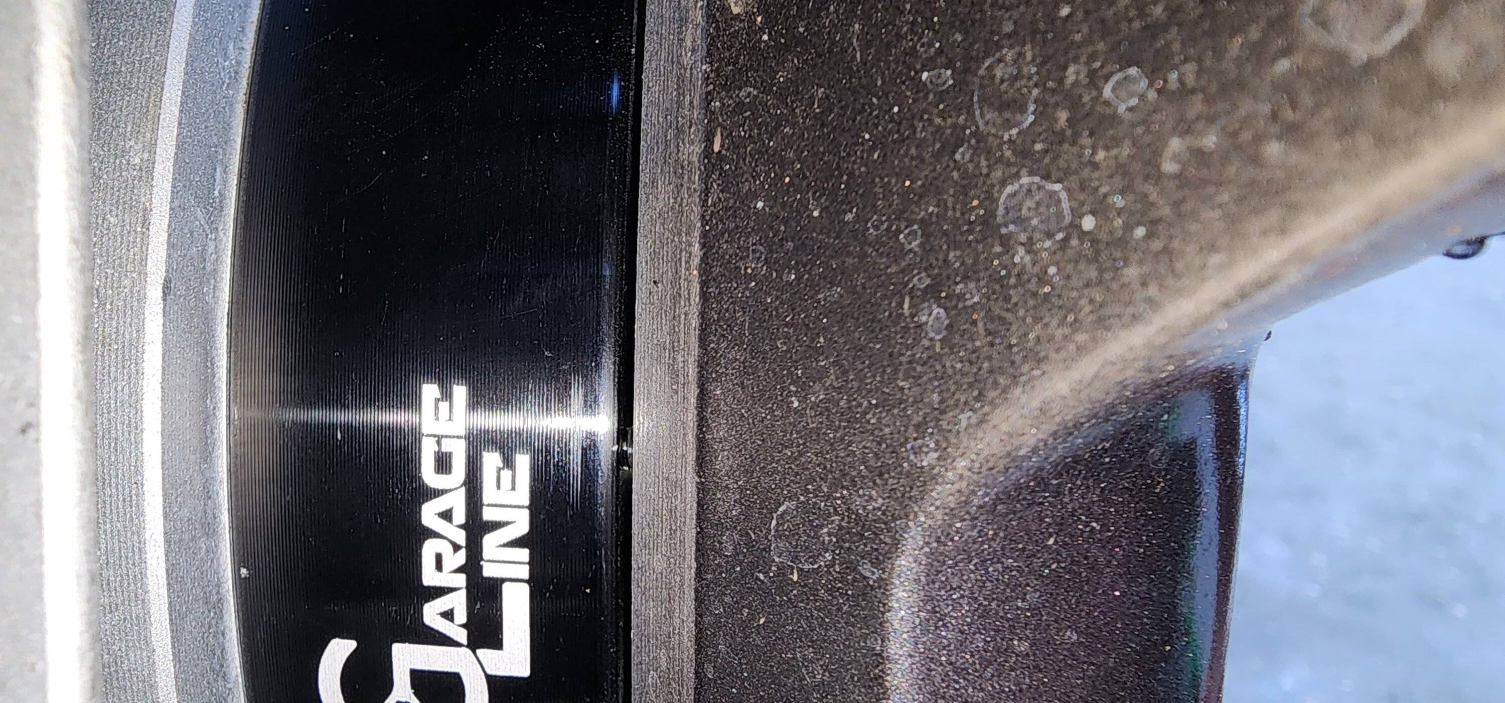

I have a 24 A-Spec Tech. When I put on the front spacer to test, the lugnuts stuck out further than the spacer itself. You can see a slight space between the spacer and the rim. Same part number except for all 25mm. Additionally, the lugnut itself isn't fully threaded. Did you need to purchase a different lugnut?
I didn’t have this issue, nor did I swap out lug nuts besides added the oem wheel locks… I doubt anything on the studs or lugnut changes from 2023 to 2024 so not sure if it’s an error on garage line part or a different issue.

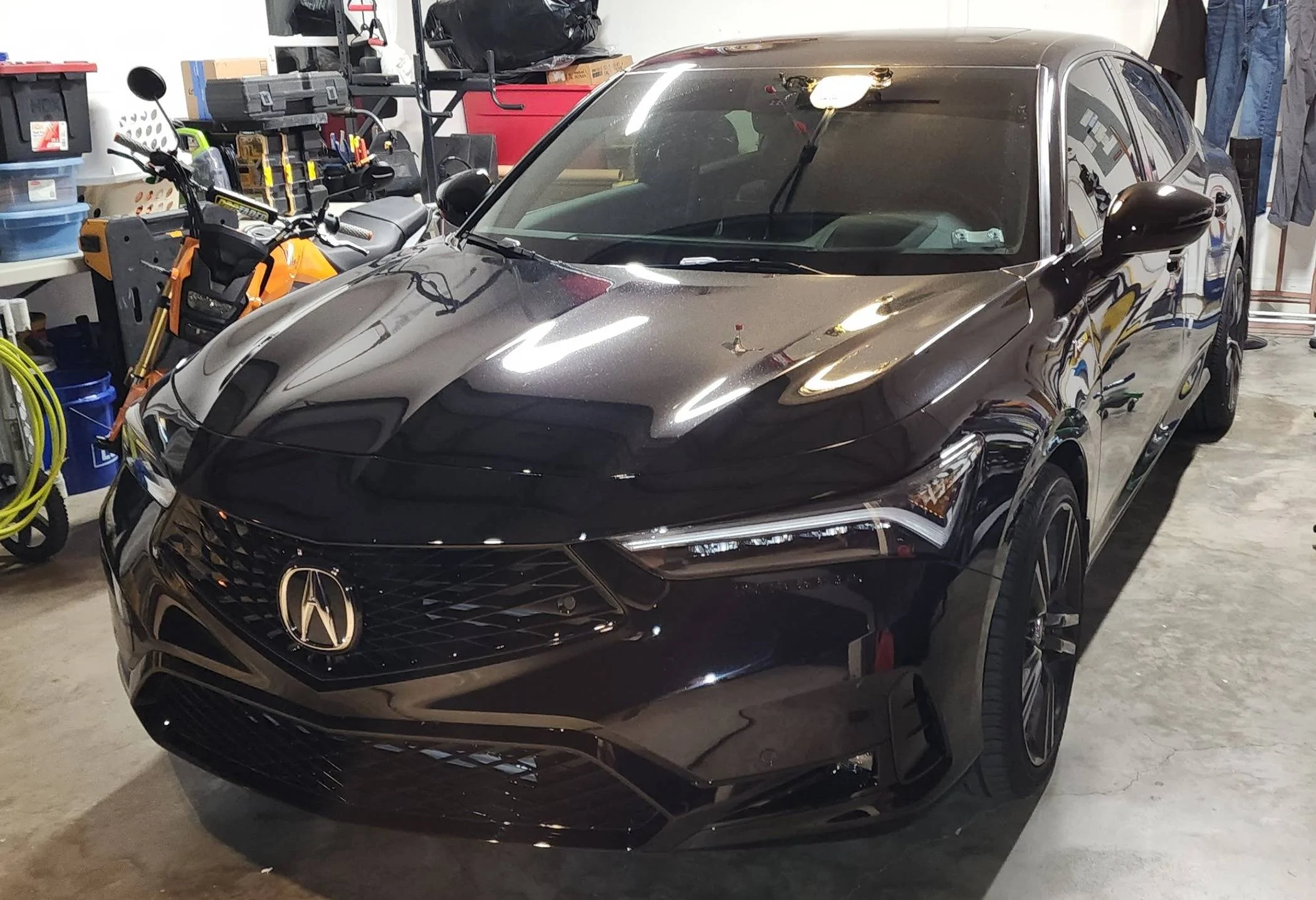

*Edited 4/10/24
Thought I should update. Reached out to Garageline. They sent new spacers with the same part number but a deeper recess. Their response is an A+ for customer service. These spacers fit perfectly with no issues from the lug nuts or studs. 25mm all around. Not the best photo and please ignore the cluttered garage.

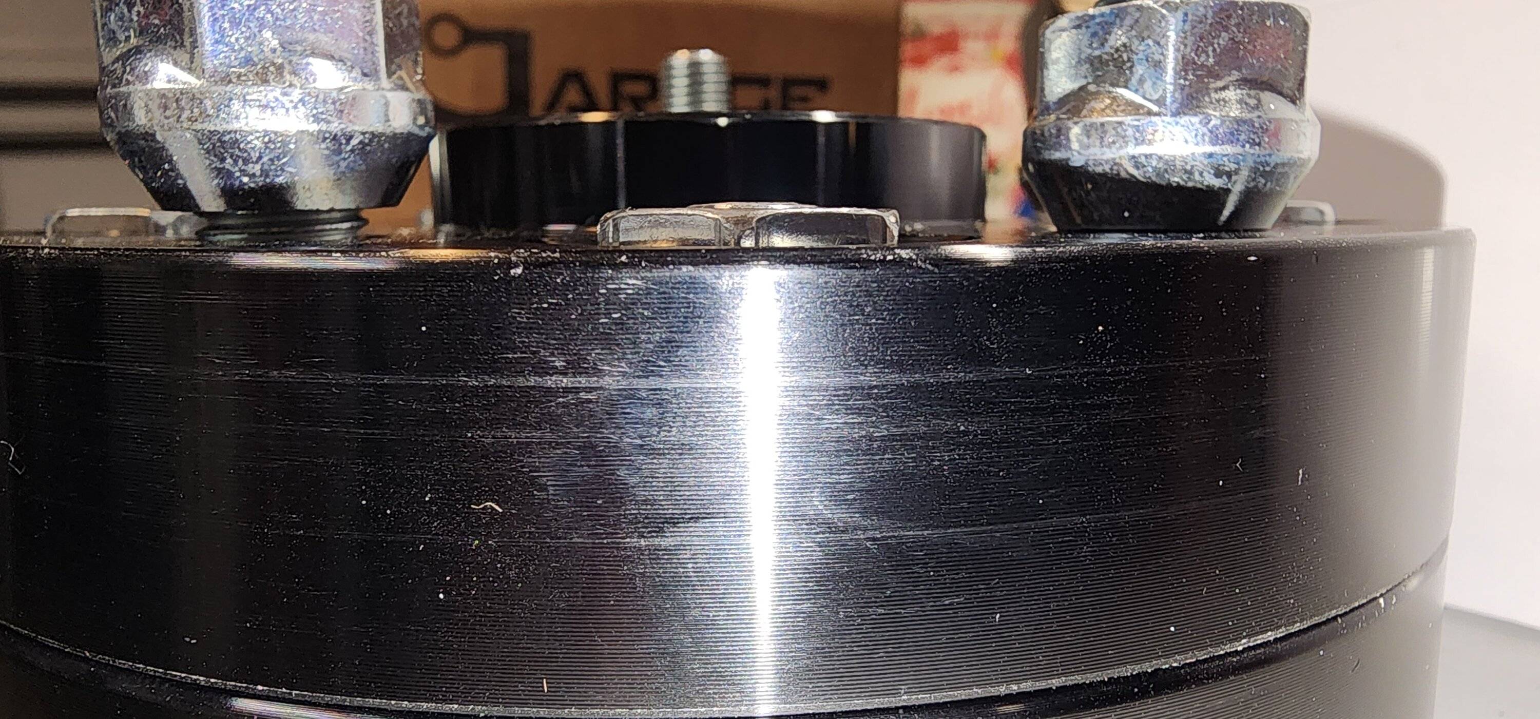

Appreciate the reply. I agree, they probably didn't change anything on the studs or lugnuts. I was hoping they'd fit correctly. I used their filter on the website, same part number as you posted. Throwing another pic up where you can see how raised the lug is. That's causing the space between rim and tire. Can't say that I'd be comfortable driving like that.
I've seen some posts where people have mentioned fitment issues. I may have misunderstood but I thought they were referring to the stud. On this setup, the stud isn't a problem. Oh well, buy and learn, then buy again.

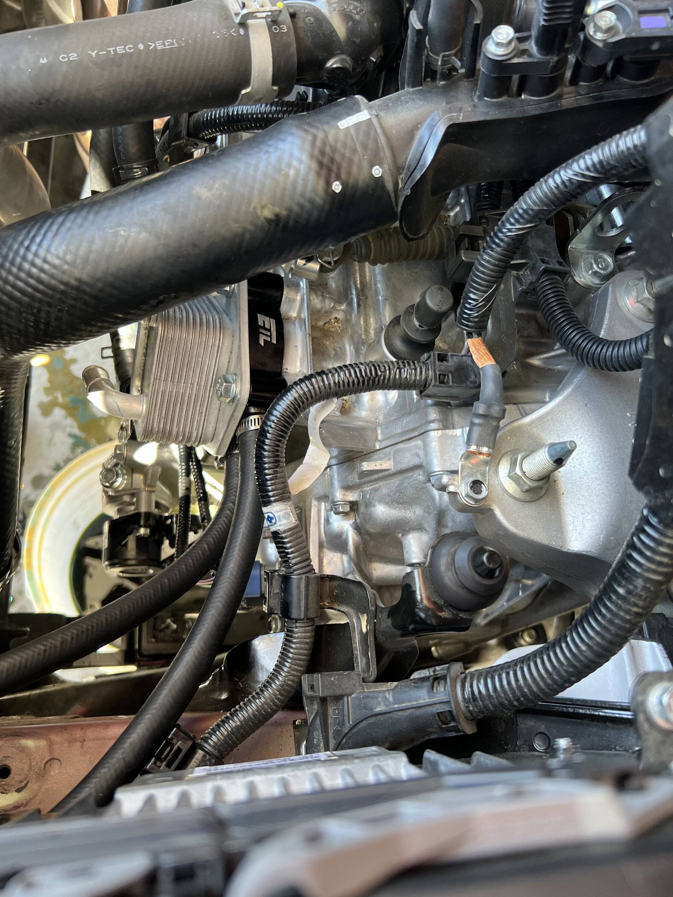

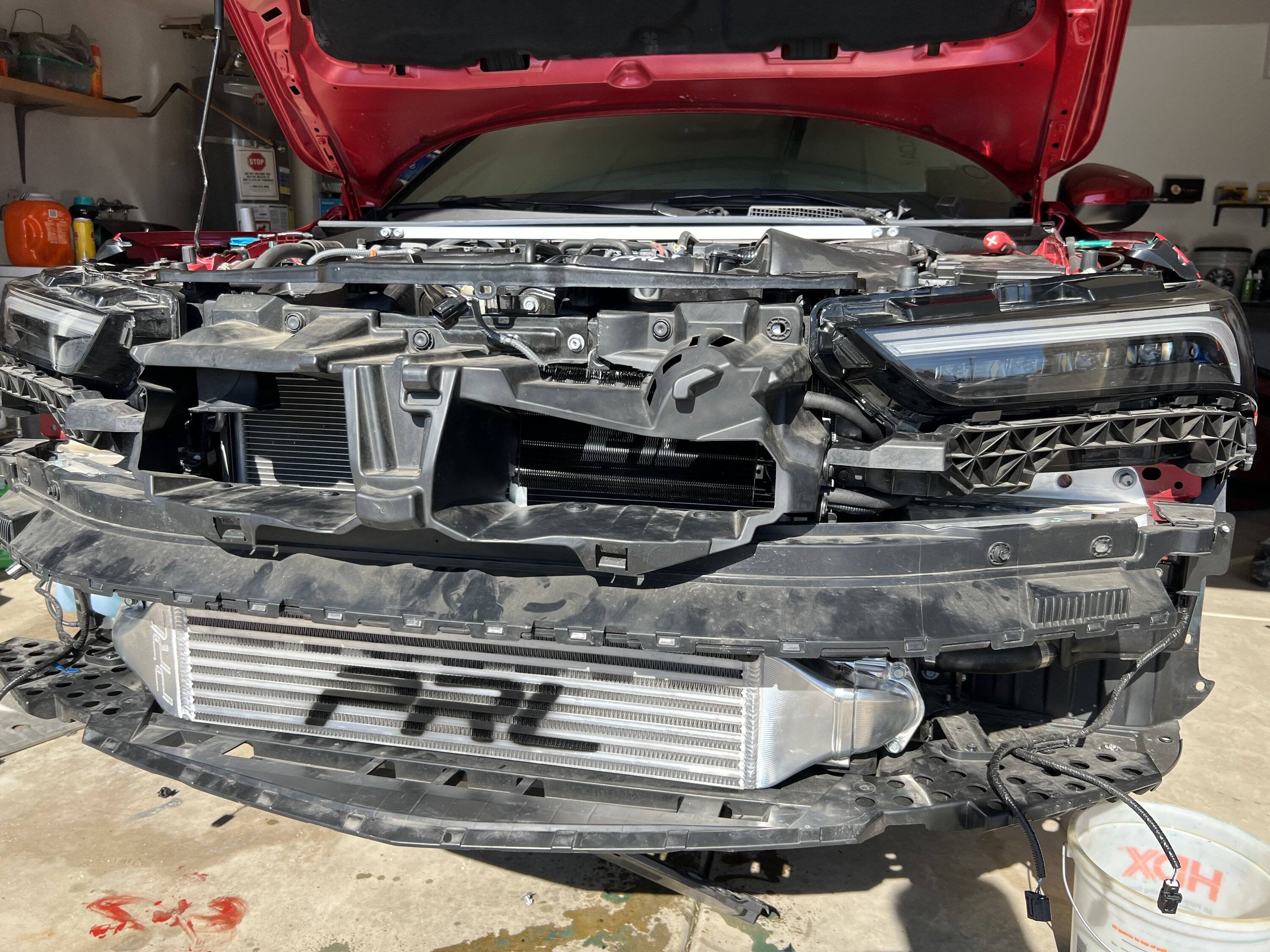

So today I did the PRL front mount intercooler and I tested a product I wasn’t sure would work for our vehicle …. But it work !!!!
I got the ETL trans Cvt oil cooler kit off a civic and was able to make it work for the integra … the job took longer than expected but I got it done in less than a day.
Did you have to alter the adapter in any way??? Or did you just bolt it on ?
