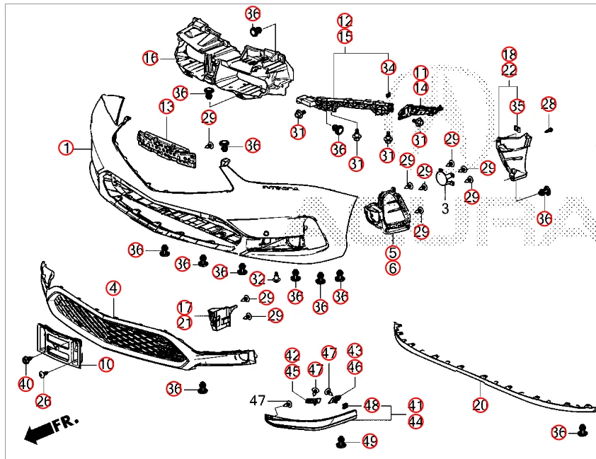

Anybody try the front splitter on an early model year yet?
It also looks like the side skirts have the same part numbers as the previous version so still not sure how to make sure I am getting the 2026.

Yes a few people on the FB group have done the front lip pieces. Apparently its a pain because you have to remove the front bumper, and there are 6 clips AND 6 screws. Luckily on the inside of the bumper the place where they go is already marked.

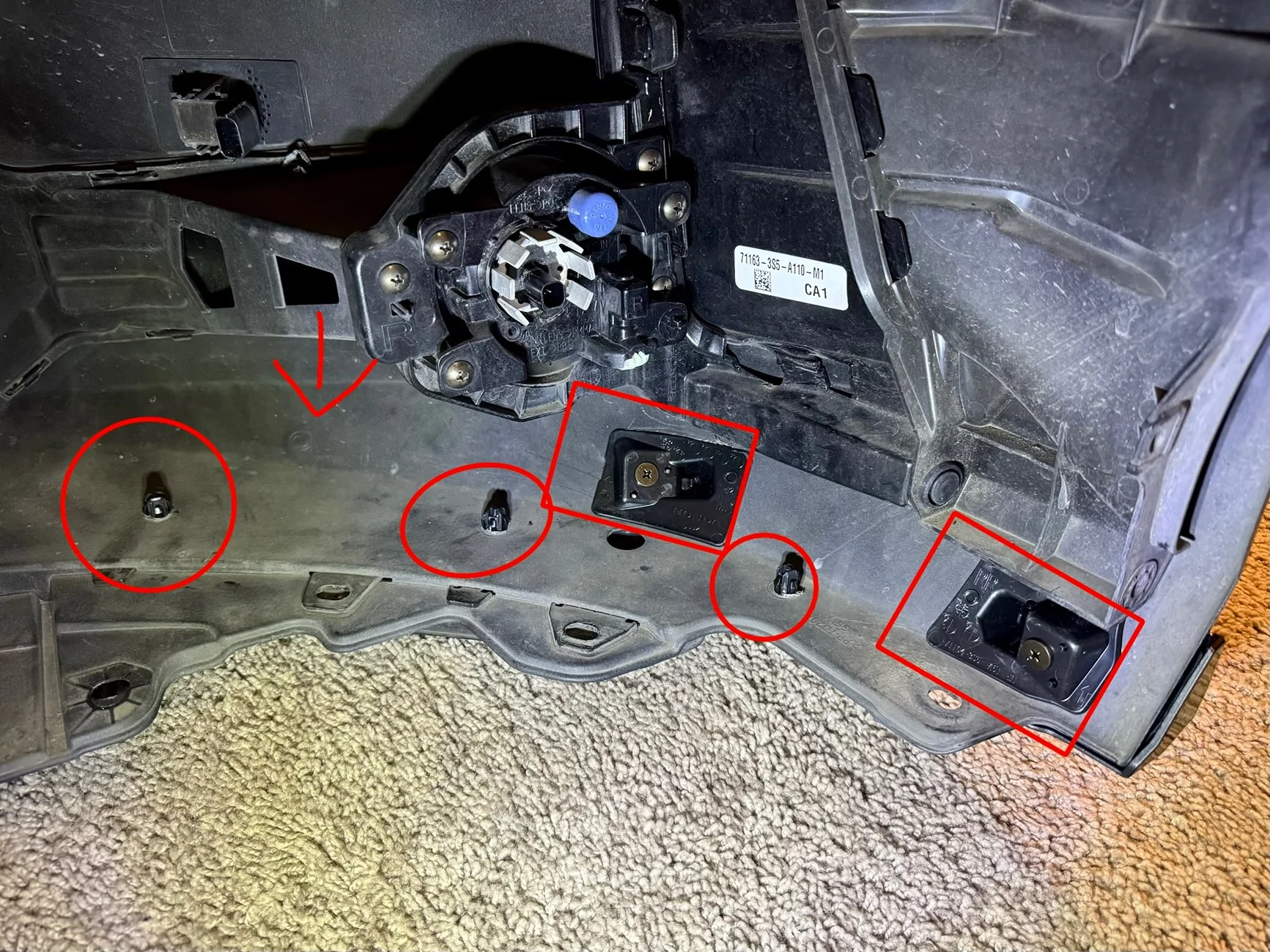

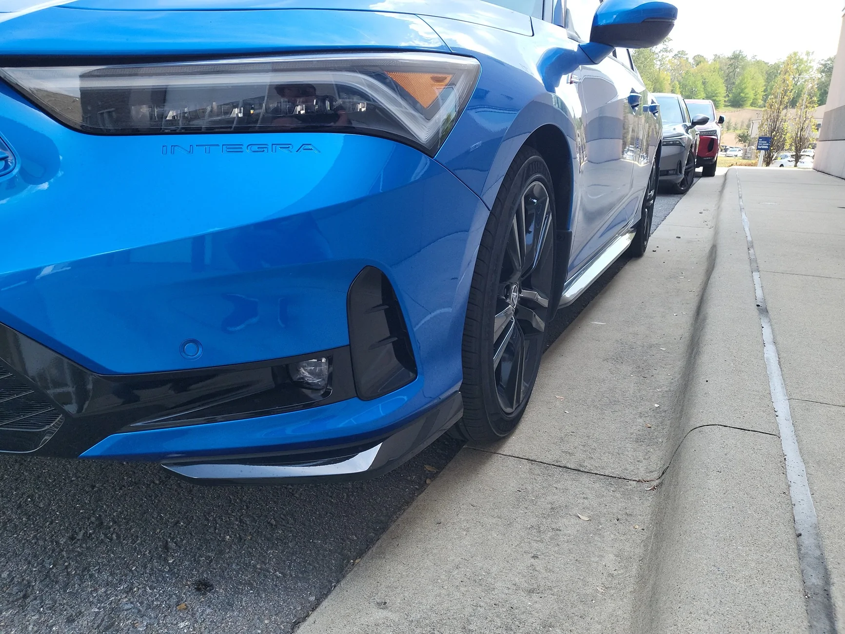

I wanted to post this in case someone is like me and was looking for more info on installing these. I haven’t seen a full breakdown of the process for the front splitter so I thought I’d take a shot at it. It’s very straightforward if you buy the correct parts. Shout out to Chuck Brady, I used his YouTube video to source everything.
First off you should absolutely remove the bumper(I’m sure you can do it bumper on but it saved me many a headache and I was removing it anyways). There’s a few good videos on removing the bumper on YouTube.
The places you need to cut out and place holes are marked on the bumper. Didn’t take a picture of before but there’s a picture after everything is installed so you get an idea. I used a dremel with a small saw attachment and a box cutter to cut the larger holes out (the angles were weird for the dremel to get everything) and a hole making drill bit for the clip holes. For the clip holes I poked through the center of the marker with a push pin then drilled from the outside cause there are things in the way inside the bumper. You want to make sure you’re following the guide especially for the larger holes cause if you cut too big the splitter can’t cover it, particularly the middle hole. Theres also a third smaller marker for a screw (where the arrow is pointing) that I drilled later. Screws were self tapping so I didn’t need to pre drill
Parts I highly recommend other than the splitter itself are the mounting brackets (there are 4 in total, each a different part number), and the screws. Again check out Chuck Brady’s video for every part number. You also need the clips but you can get a lot more for cheap on Amazon or something which I recommend cause those clips crumble like cookies sometimes especially if you’re removing the bumper.
It took maybe an 1-2 hours after figuring it out.
