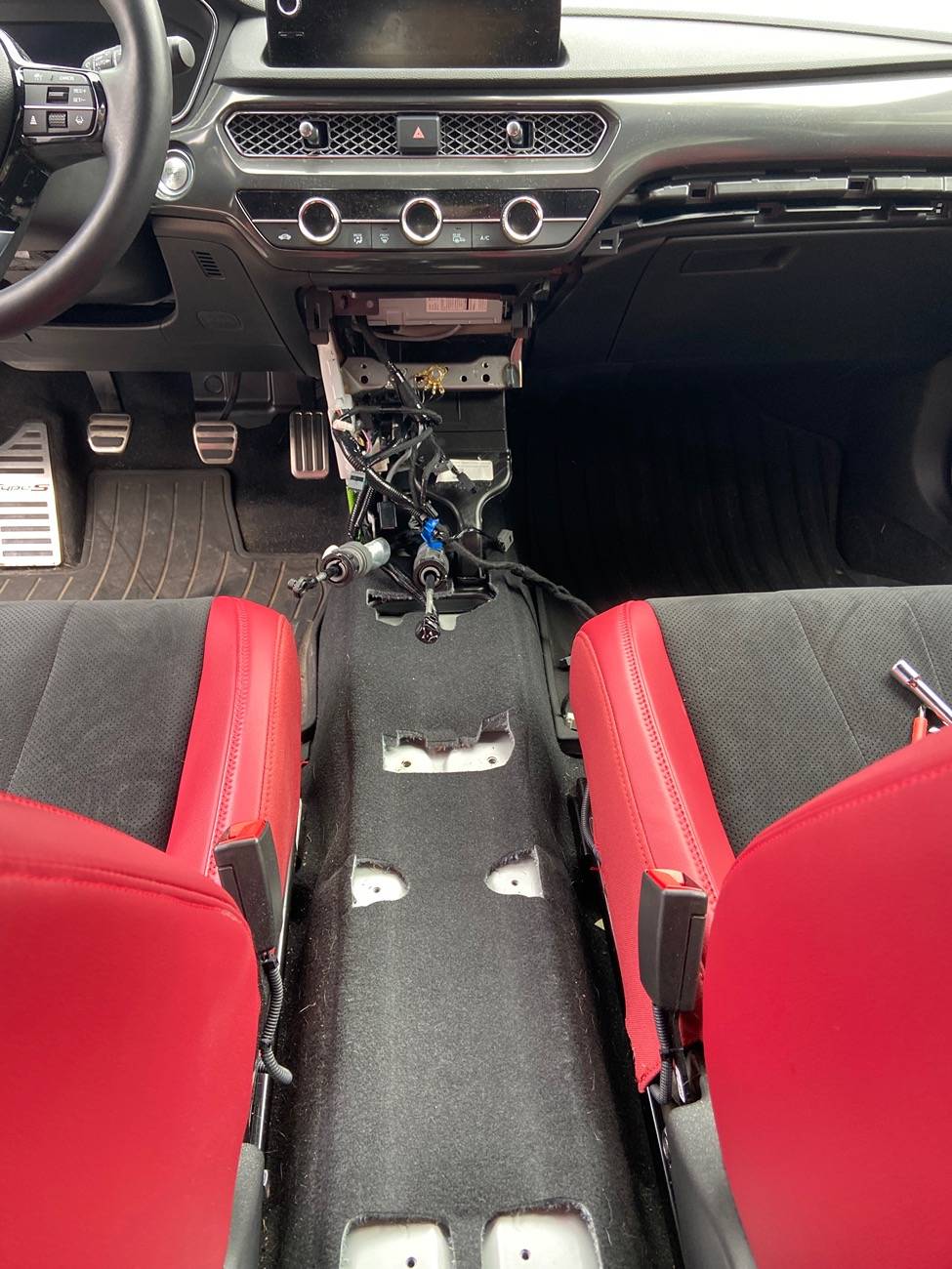

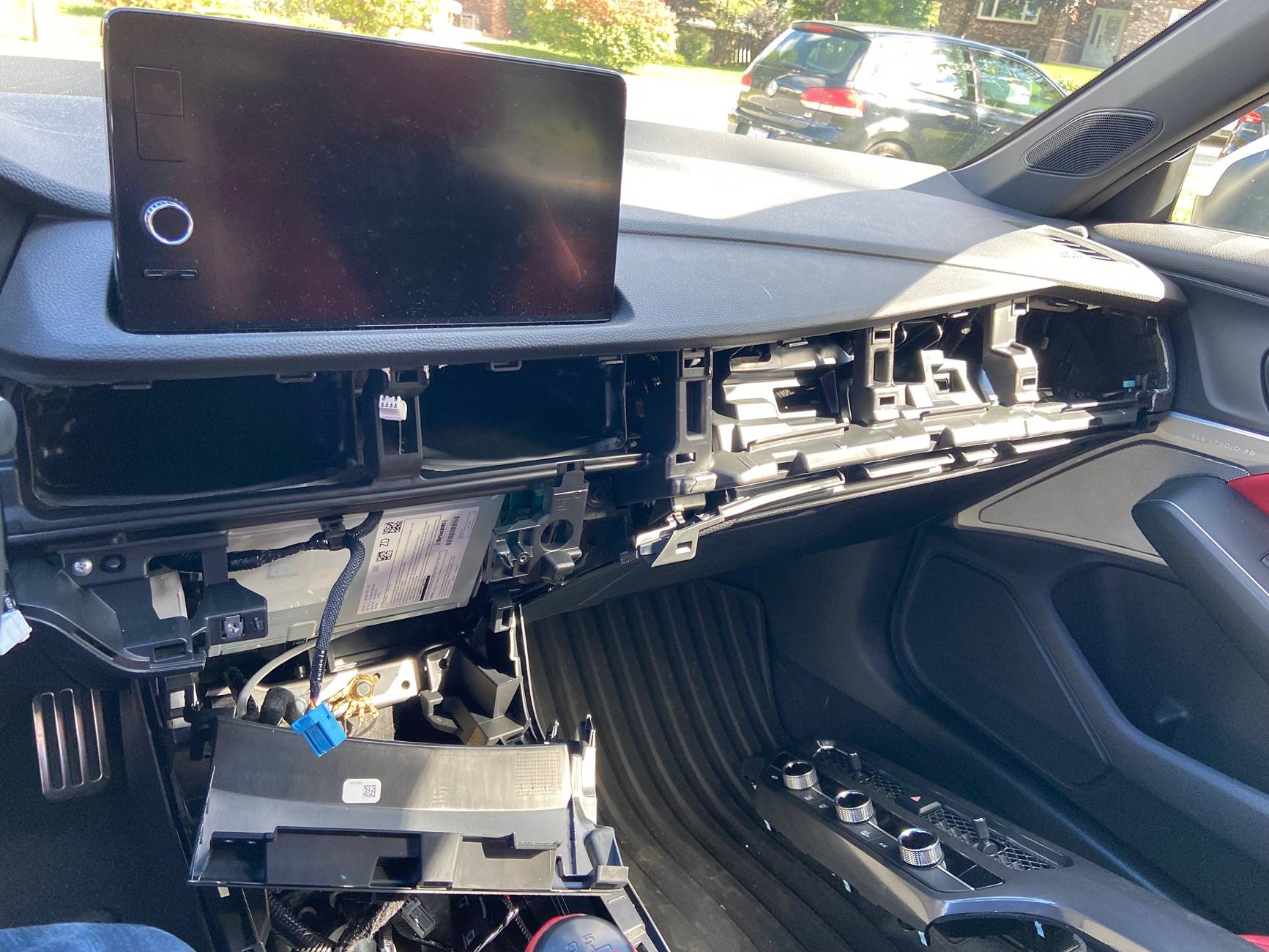

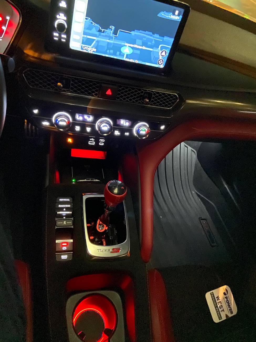

The pictures show as far as you need to go, the head unit stayed. I followed the loosely translated instructions for a RHD CTR here.
https://www.civicxi.com/forum/attachments/cupholder-lighting-instructions-pdf.244036/
I was doing a bunch of things at the same time the Hybrid Racing shifter and FL5 shift knob, Overland designs console, Mikstore rear vents/USB kit, CTR console box and armrest, adding some foam tape to eliminate the chance of any rattles, red LED above the wireless charger, as well as the Honda Access console and cup holder lighting. I’m still playing with the setup of the shifter before I put the shift boot back on.
To do just the lights you alone was really easy once everything was disassembled. Drill 6 holes, routing and taping wires around the console box and cup holders, run wire up towards the hazard plug and maybe 12-14 zip ties. Pretty happy with the outcome.
