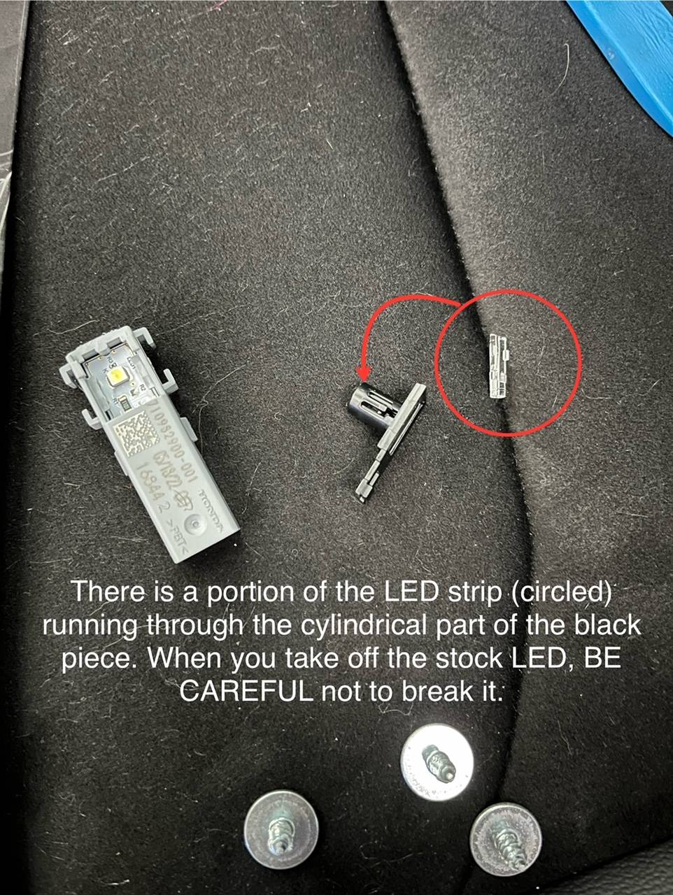

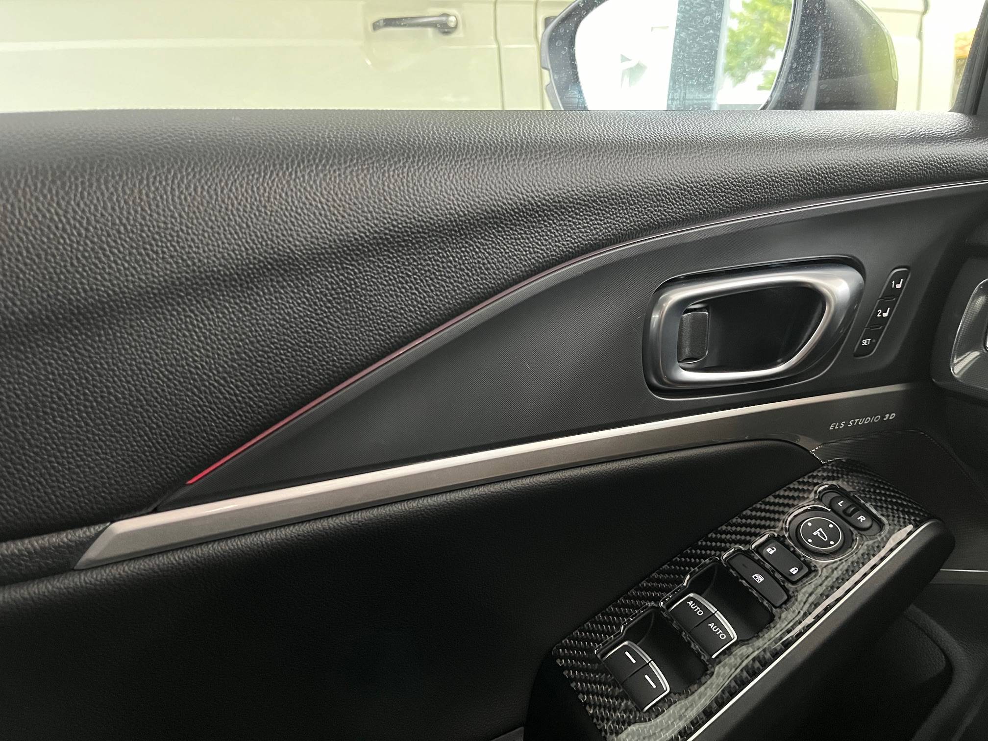

The part number I ordered was correct and I had the car running when I tested the lights. I found the problem...
When you pull out the stock LED, there is a black piece attached to it that you have to remove and install on the new, red LED in order to guide the tail end of the LED strip directly up to the LED. When I removed the stock LED, I broke off this small piece of plastic INSIDE of the black piece. I had to completely remove the door panel and pry open that LED mechanism so I could superglue that piece back on. Once I had done this (with extreme difficulty), everything worked beautifully!
Hopefully this helps someone in the future! Below is the piece in question and the before (broken install) and after (superglued and fixed install). I LOVE them.

Glad you figured it out. One of my doors was very easy to do. The other side, the clear stick piece you speak about was sticking out a bit. It made it hard to slide out the cover that needs to be transferred over. Had to bend it a tad to slide it out.
In the end, great mod that brings the interior to life. Highly recommended to everyone.

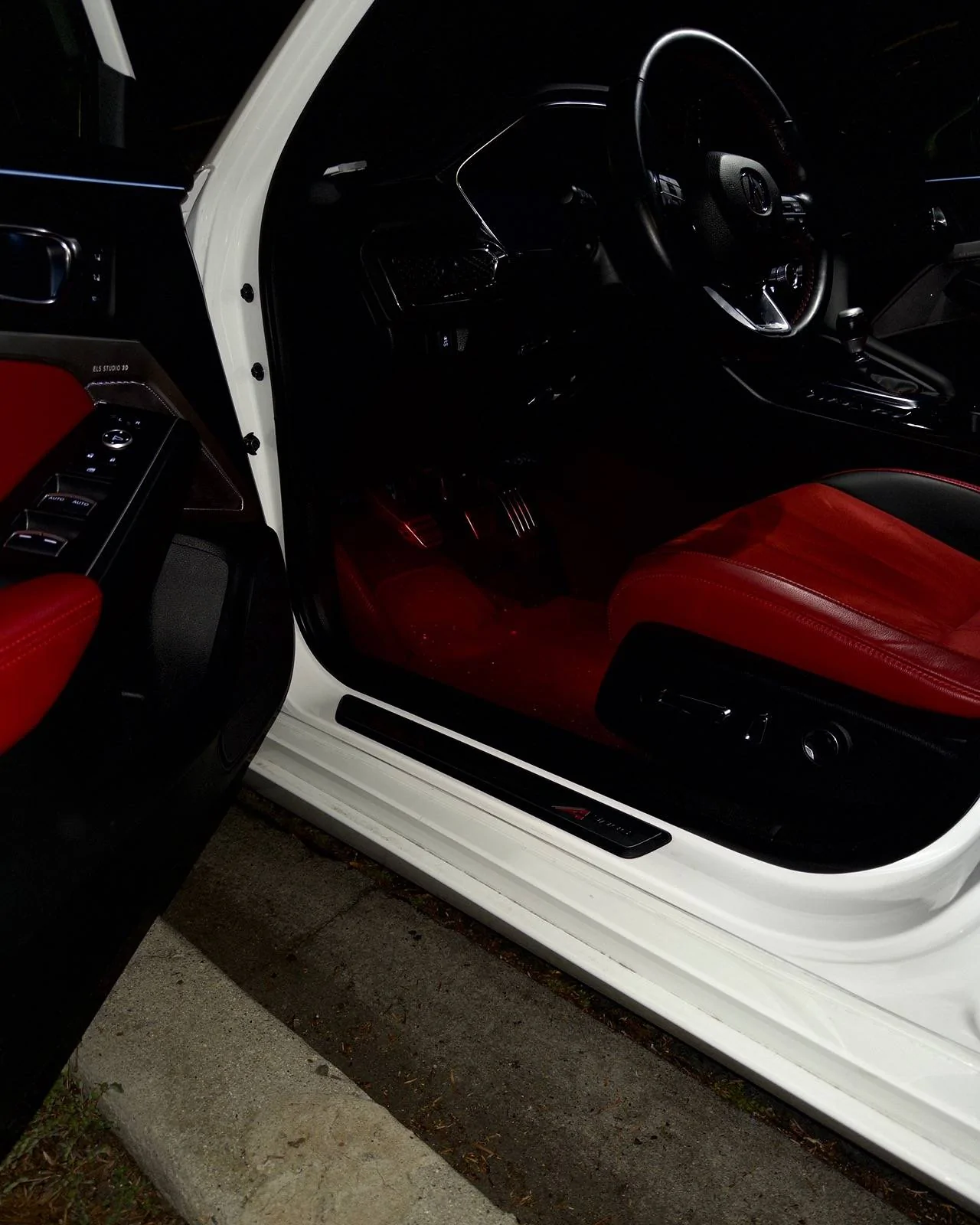

For those installing JDM Honda Access parts like the lighting, they may come with a wiring harness. I had to tap into my traction control switch for the floor footwell lights, including the one in front and an additional one under the seat.
Acura Integra Ambient Lighting IMG_0243
I started taking photos but gave up on the documentation partway through. The instructions were only in Japanese, and everything was for RHD! 😂

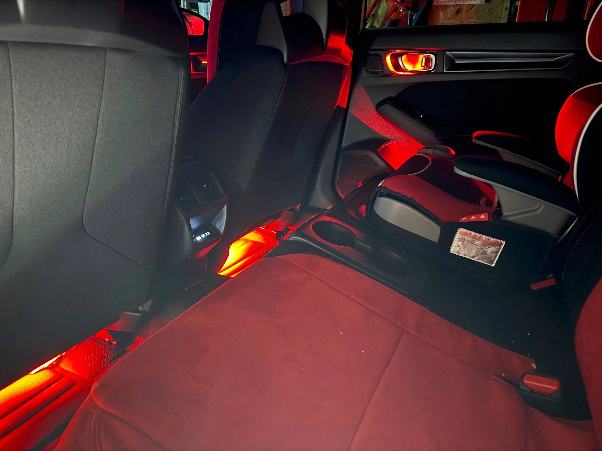

I love this! And thanks for sharing. I'd like to add some lighting in the rear as well. Did you share any photos or tips about it on here already? Or maybe it's on the CTR forum?
I'm good for photos and proof that it's doable, but I'm terrible about documenting problems/solutions as I go. 🤦‍♂️
Acura Integra Ambient Lighting Rear Lightin
1,473
1,169
Same here, but getting slightly better at it lol
That looks amazing!! So you basically order 2 sets of the door cup holder area and a set for the front handles and added them both to the rear as well? This looks really rad.
