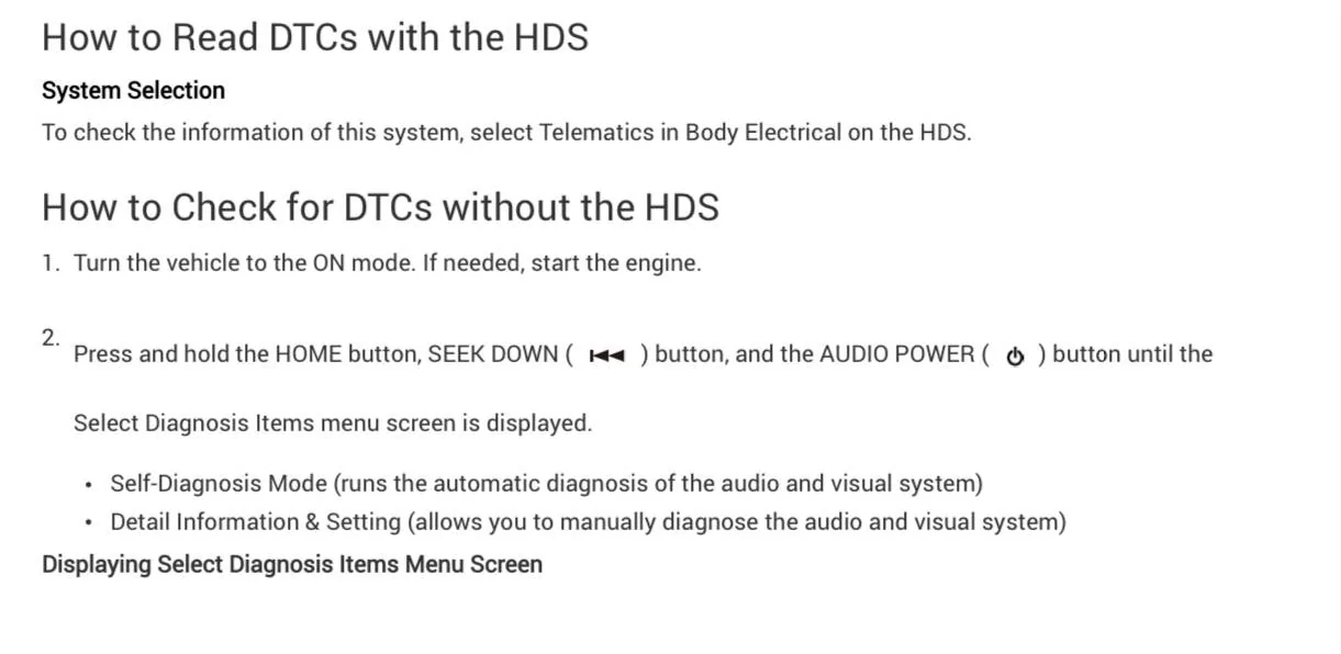

Not a full proof way of doing things but you can try running the test with the head unit, believe it tests the AC unit as well for codes. Run the self test. If none are present on the head unit I’d recommend getting yourself a good code reader to read codes before tearing stuff up. It will at least help guide you in a direction. This will read all module codes, does everything but bi-directional stuff.

Thank you for reading! I think what you’re describing is only available with the tech package? Mine is just A-spec. My head unit doesn’t show telematics or much beyond basic audio and rear camera settings. I agree with you on using a better scanner to track it down first. I’ll see what I can do. Thanks again for the advice everyone

Here's the A-Spec non-tech version.
View attachment Audio and Visual System Diagnostic Mode (Color Audio Type (7-inch Screen)) (Radio, Stereo, and...pdf

You’re the man! Thank you for this. Got a chance to try this. Went thru it all, everything shows green and “Result okay”. Noticed before the ambient temp reading was all over the place but always very low (20-30 degrees F), and now when the problem is gone and I do get a temp reading it’s always -40F, then the light comes on, no temp reading and I lose a/c

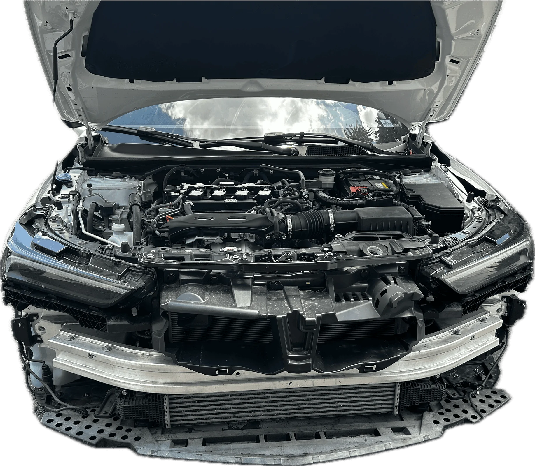

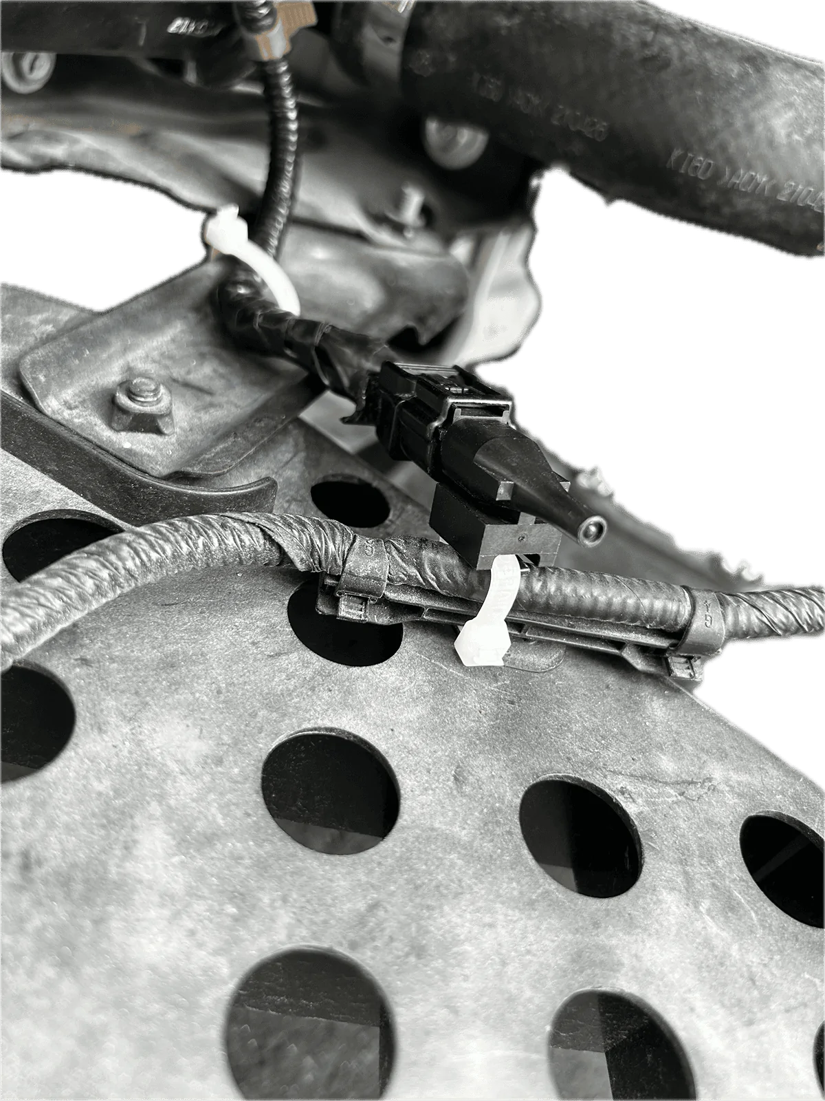

FIXED! Had to take the bumper off to get to it. Turned out to be a damaged wire to the ambient temp sensor on the connector side. Spliced them together and works like new again. Passed the test drive. No dash lights and a/c stays blowing ice cold. Also, outside temp is now accurate :) FYI the sensor is mounted on driver side behind bumper under the headlight. My mount was broken so it was just dangling around. I just zip tied it near where it would go and where I can access it easily without removing the whole bumper should the wiring not hold up. Thanks for your help everyone!

Hooray! Good job!
