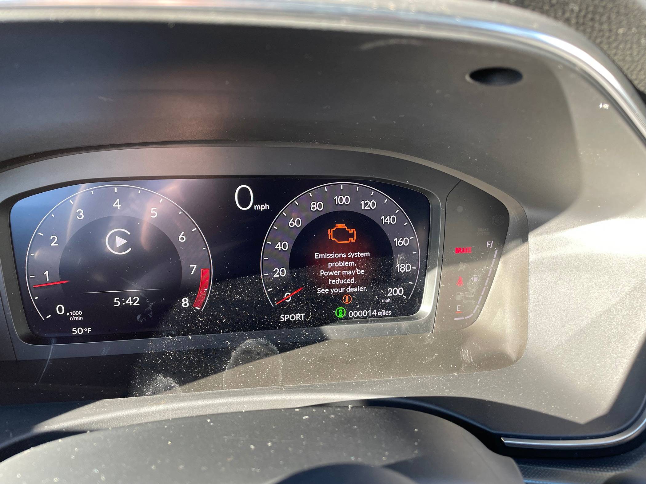

Went to dealer yesterday to finally pick up my black 2024 Type S that I ordered last July. After getting all the paperwork done and forking over a bunch of money, got in the car to go over the bells and whistles and look what I saw-the dreaded emissions system problem message. It also said something about rev matching initially and we took it for a short drive and it felt okay, but this message never went away.
They sent me home with a loaner car. What an incredible disappointment.

That’s actually disappointing on some high level coming that it’s an Acura. How come you just got your car since you ordered it back in July? The rev matching you can totally feel that it’s gone, at least from mine experience. My fix was a sensor and topped of with coolant
