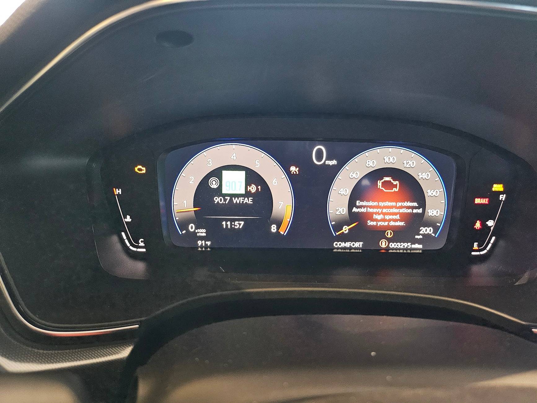

I was on the freeway today in my ITS and suddenly felt a shudder. I'd pretty much been driving steady state for an hour and a half with the cruise control on. The check engine light came on and all the driver aides shut off. Warnings started flashing on the cluster about emissions system issues, LKAS being unavailable, and Rev matching being disabled. I managed to drive the car an hour to my dealer in limp mode for them to diagnose.
About an hour later I got the bad news: fuel pump issue. It'd take them about a week to get the part in to do the work. They sent me on my way in a service loaner and would call me when they knew more.
