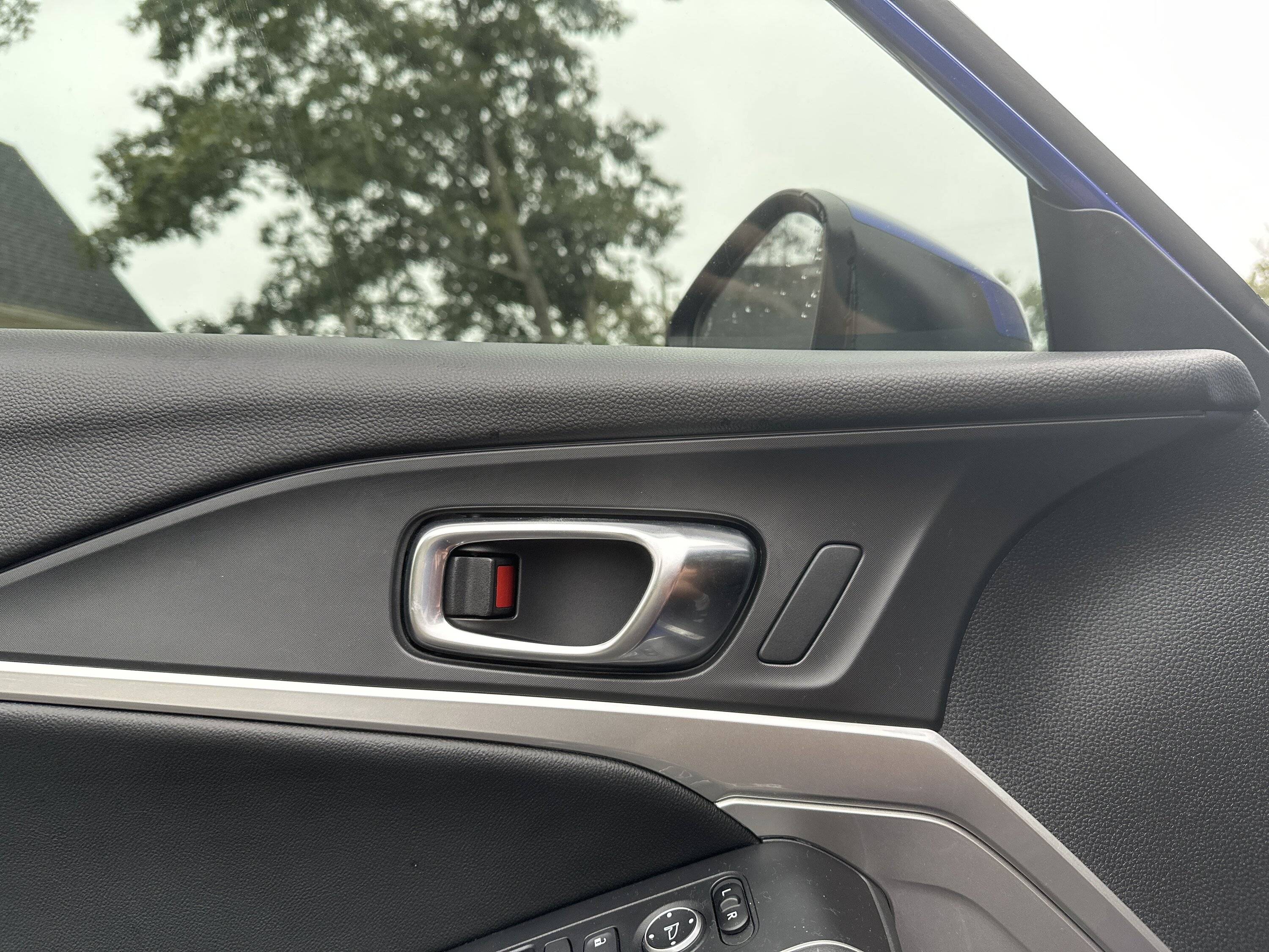

i think my aspec non tech might have the spot for it but it just does not have the lights installed

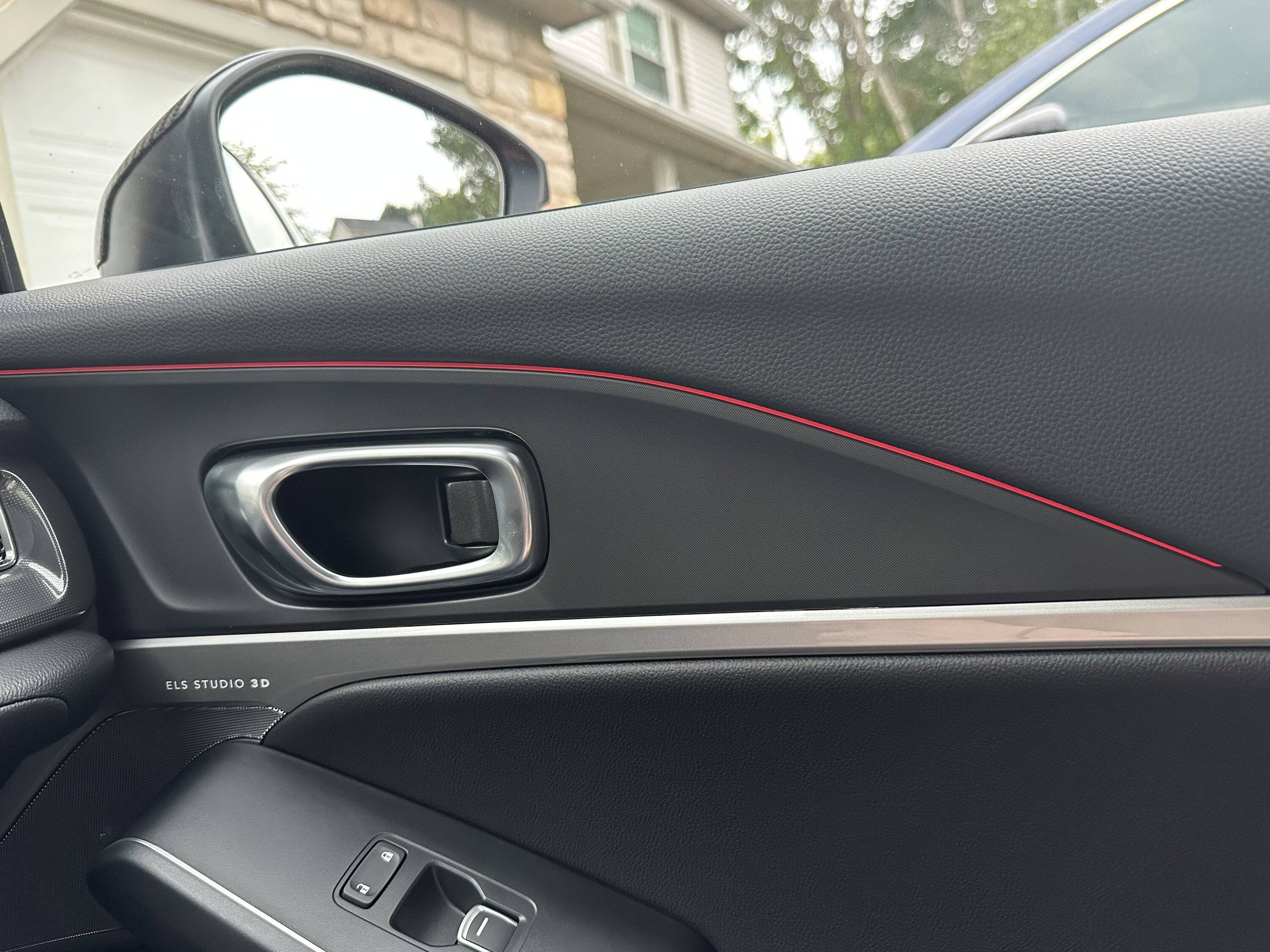

Just finished installing mine. Did 6 of them. The two foot wells, the two striping and two door handles. AHC video for removing the door panel was super helpful. The rest was pretty easy. Foot well lights were the easiest to swap.

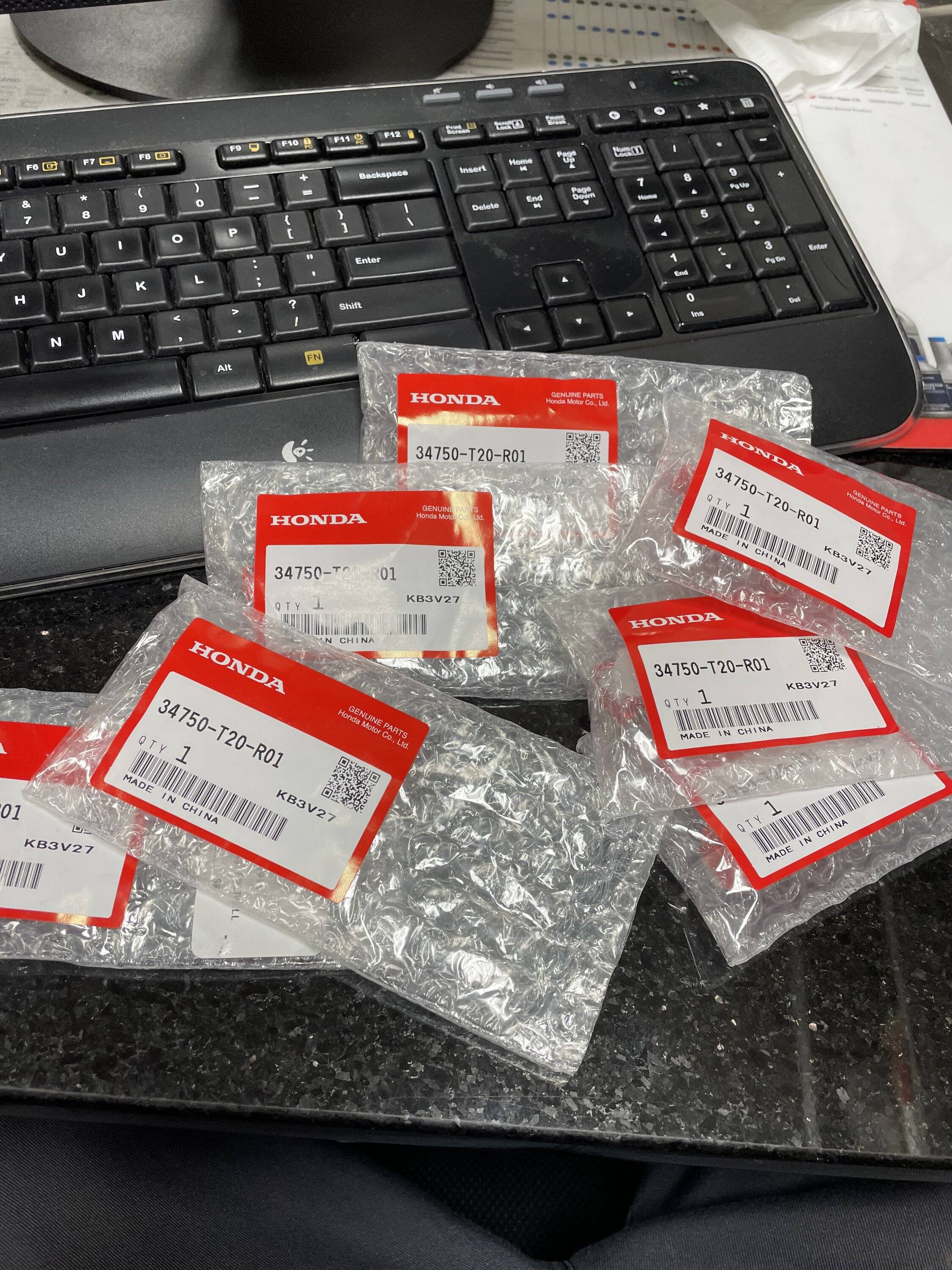

Stoked to have had these finally arrive after placing an order with my local Honda dealer back in early October....
Acura Integra Ambient Lighting TYPERREDBULBS
Genuine Honda parts for the Japanese built Civic Type-R outsourced from China....been this way for awhile but I digress...
I'll get the doors, footwells and wireless charger hooked up this weekend when I'm off.
