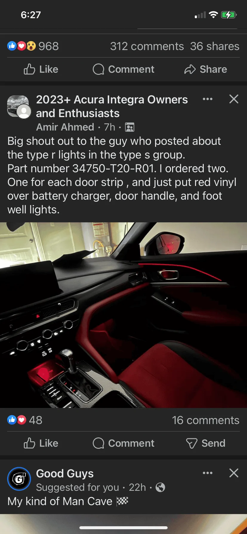

Just woke up to seeing this on an Acura FB page:

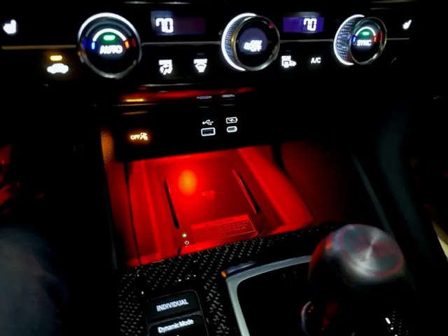

That’s so uncanny 😂 looks so good too. Looking at the charger light though, it may be too bright for my liking. I may opt to just disconnect the light there altogether. I really like the handle pockets red it looks so clean and will for sure help preserve night vision a bit
1,473
1,169
I hear you both there. I'm not a fan of even semi bright lights or the slightest glare - but I have super sensitive eyes. Red & green are the easiest on the eyes at night & I had red & amber in my Jeep. Way brighter than the Integra. They essentially stayed off until you manually turned them on or opened a door though, no ambient. It was a 2000.
I don't use the wireless charger anyway. He took a good pic to reflect what we are all talking about though! Think I'll order the red LED's minus whatever is a pain to do & just add the lamin-x in those areas.

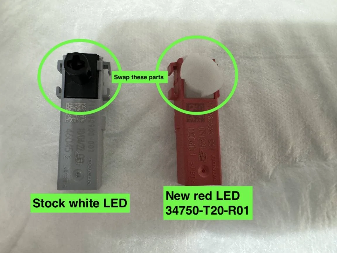

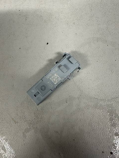

You mentioned the 34750-T20-A01 that is only $5. This is the white glovebox light from the CTR.
If you want Red lighting then you need the 34750-T20-R01 part.
The part is a LED module. It is a small rectangle. Basically all the lights on the Integra are the same module. All I am doing is swapping to the 34750-T20-R01 part. They are all plug and play.
The ambient strip is controlled by one LED and the door handle lights are a different LED. But both can be swapped with the 34750-T20-R01 part number. I honestly forgot about the door handle LED until today so I plan to buy two more parts to swap them out with.
Long story short, order 7 - 34750-T20-R01.
2 for the LET strips
2 for the door handles
2 for the footwell
1 for the above the wireless charger
Do the LED strips and door handles at the same time while the door liner is off
The footwells are super easy and take 30sec
The one above the wireless charger is a challenge. Id recommend watching the install video of the Idle Stopper () to show how to take the center console apart.

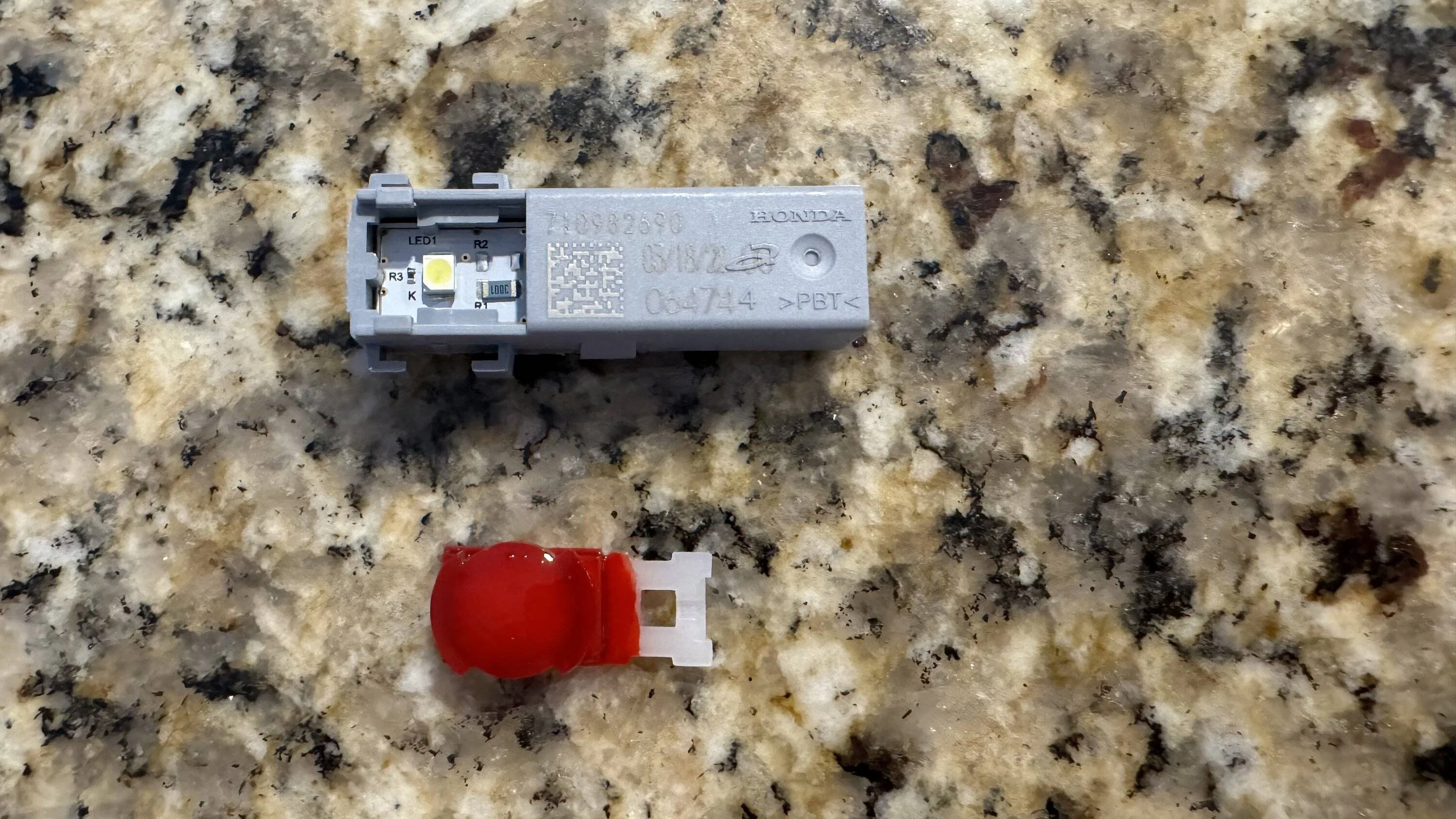

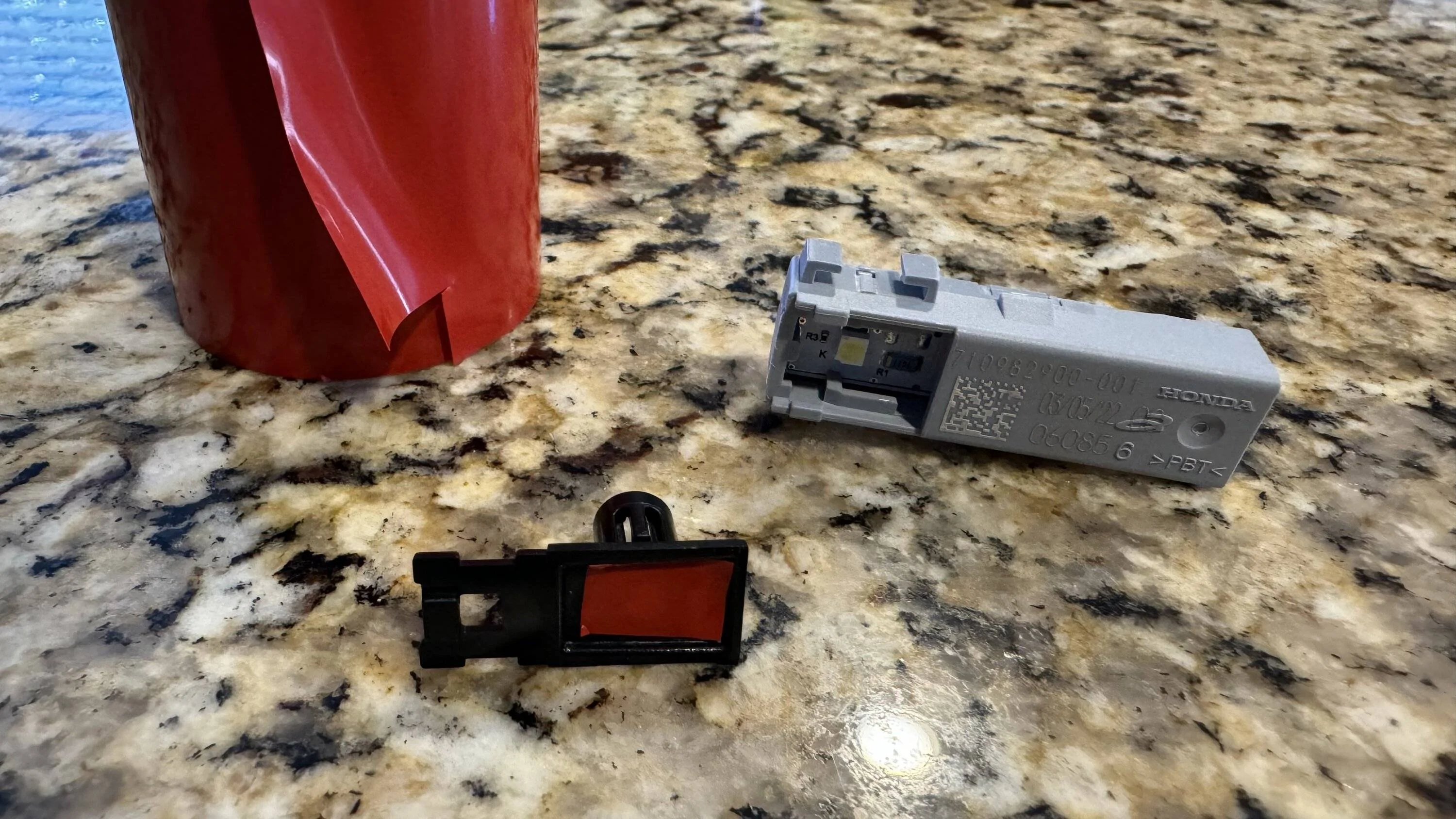

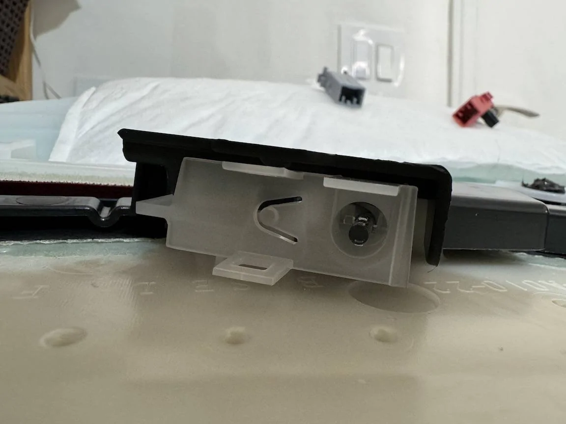

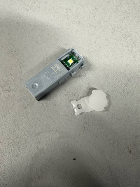

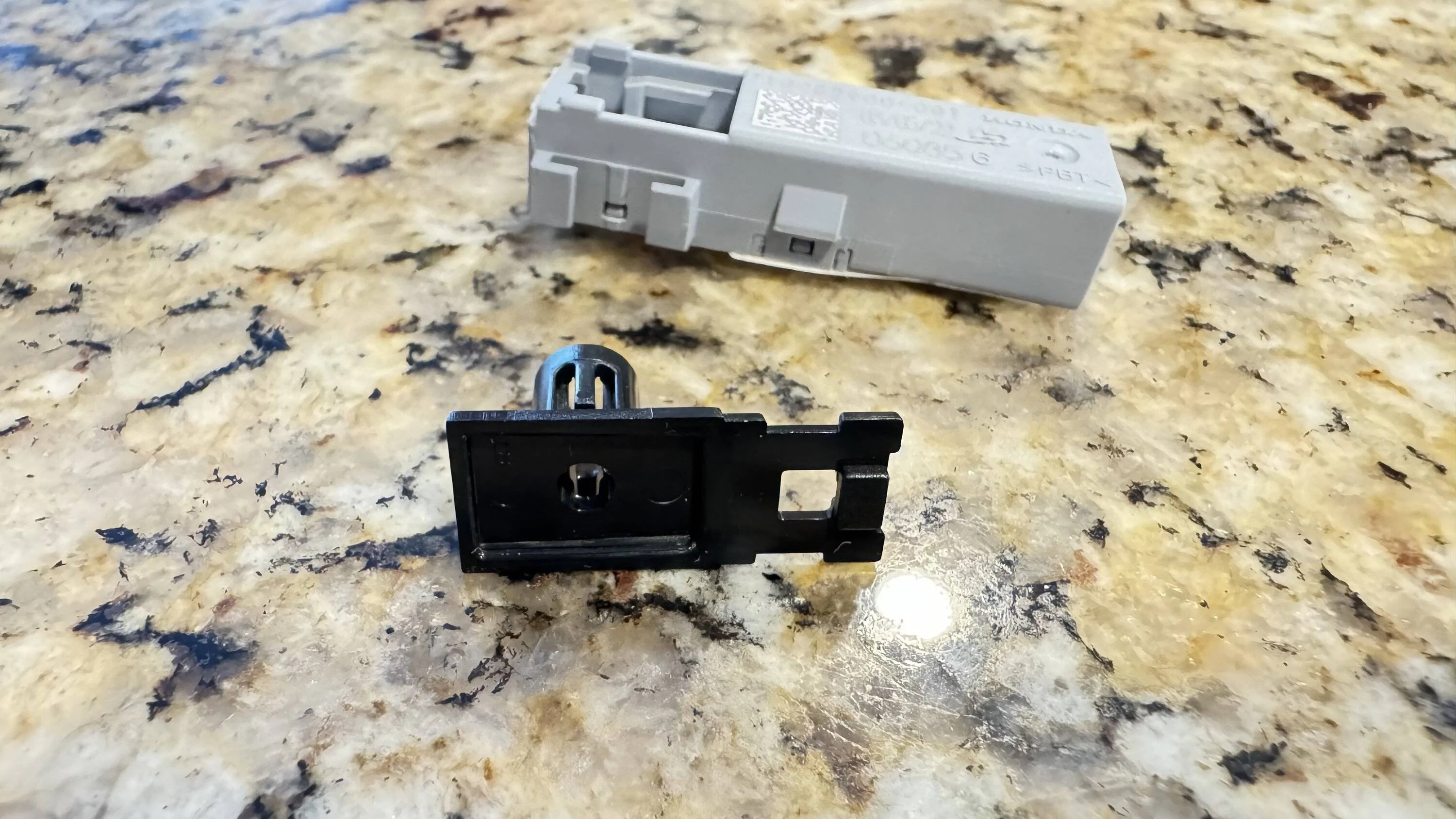

Please note that the lens on the LEDs are all a little bit different. But they pop off and swap very easy. The lens that comes with the 34750-T20-R01 will fit the footwells. I needed to swap out the lens for above the wireless charger the LED Strips and the the door pockets.
Fun fact, drill a hole in the lens of the footwell lights to make them brighter.

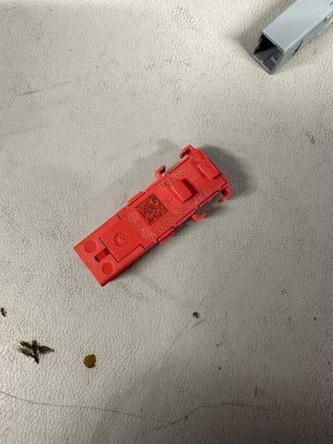

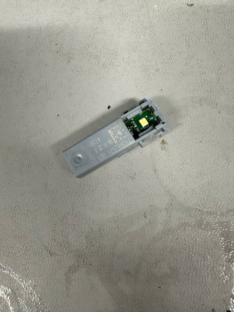

Question about the new red LED module: Is the actual LED exposed and easy to get to? Or is it more of an internal light
I’m wondering if I can just buy a few baseless red LEDs and solder them in place of the original white ones.
Any pics would be highly appreciated!

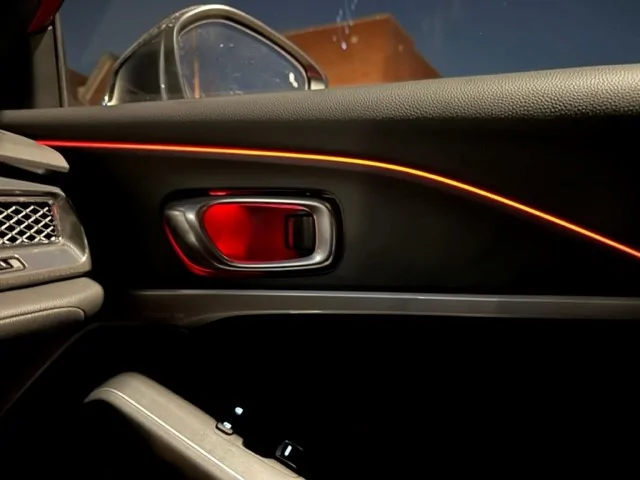

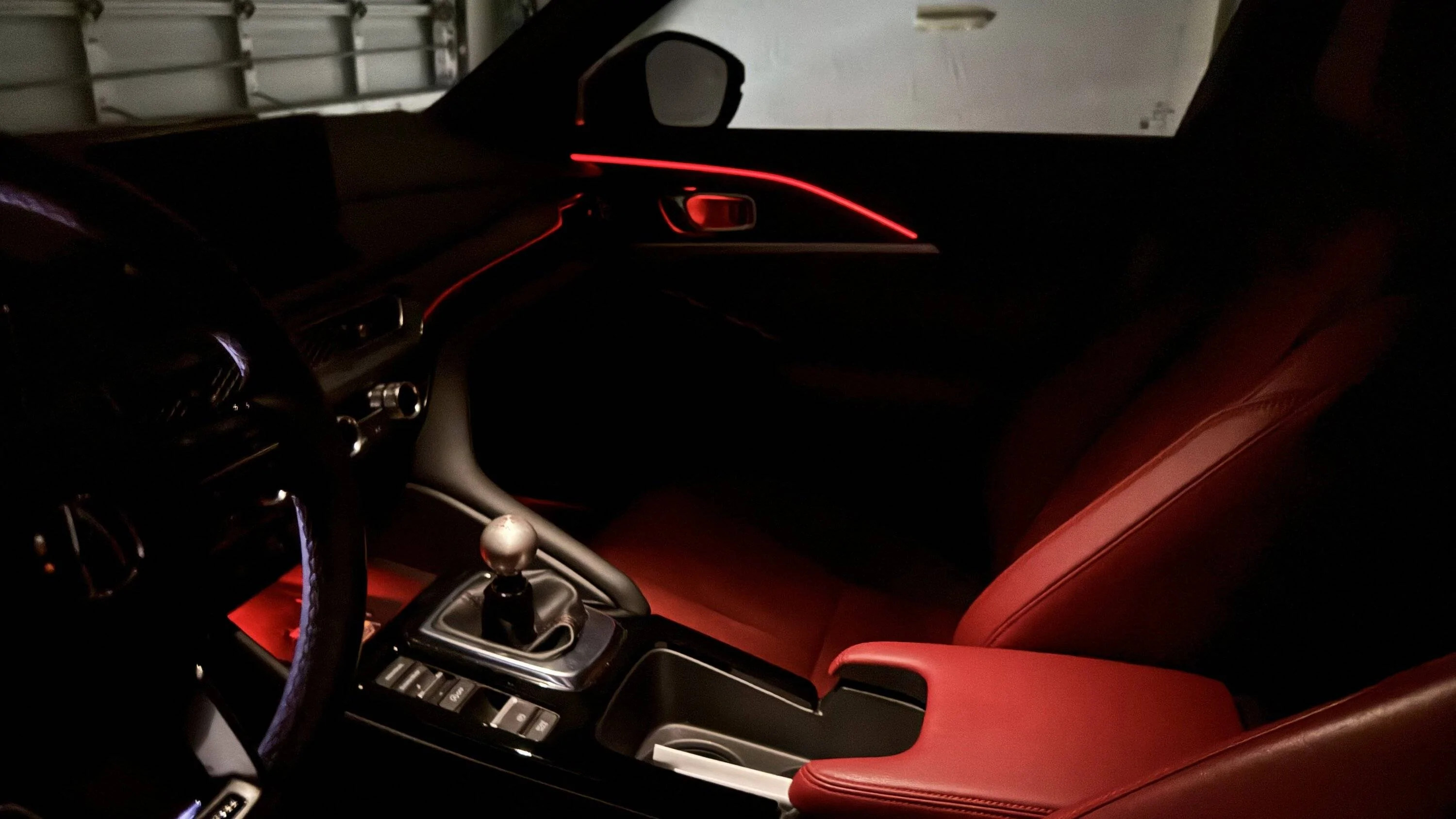

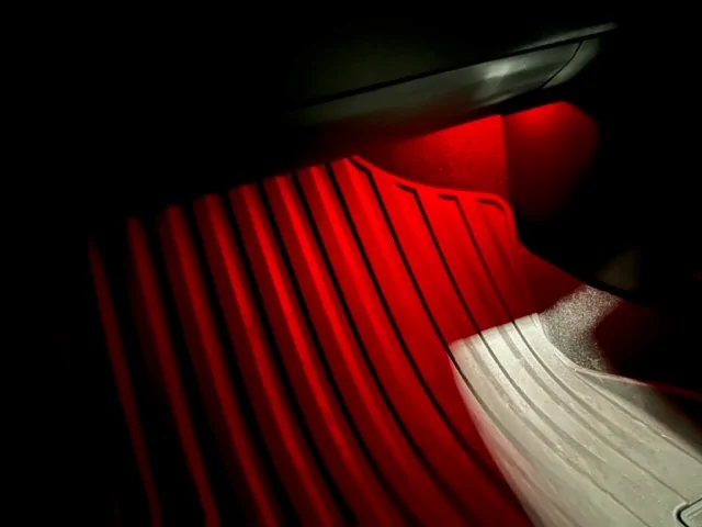

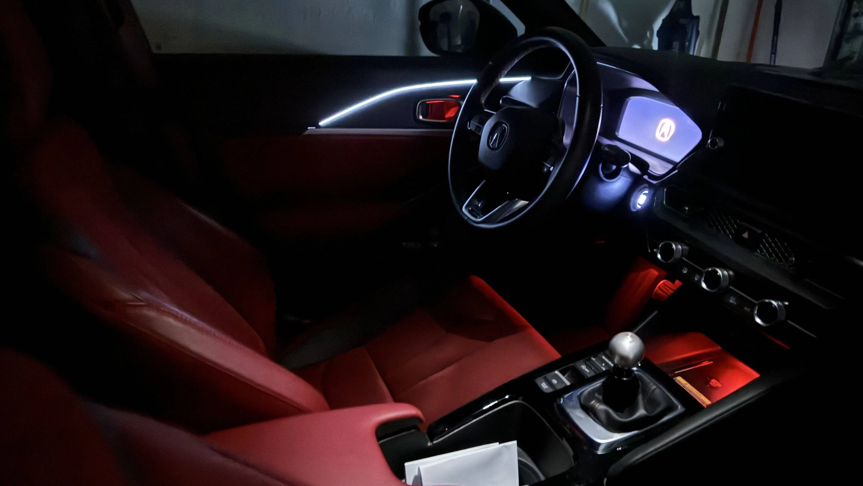

Finally got my door pocket LEDs swapped out. Here are some better night pics.
2 Door Pipe Lighting
2 Door handle pocket
2 footwell
1 above the wireless charger.
All swapped out with the 34750-T20-R01

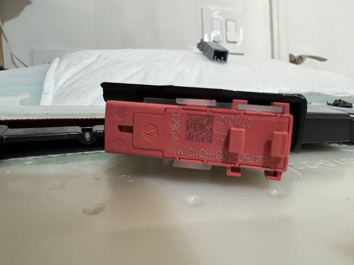

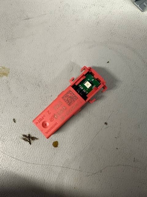

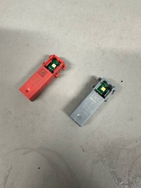

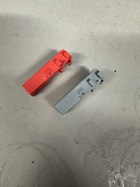

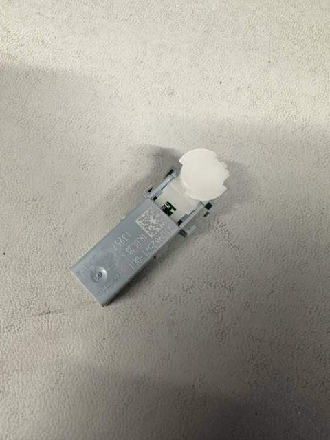

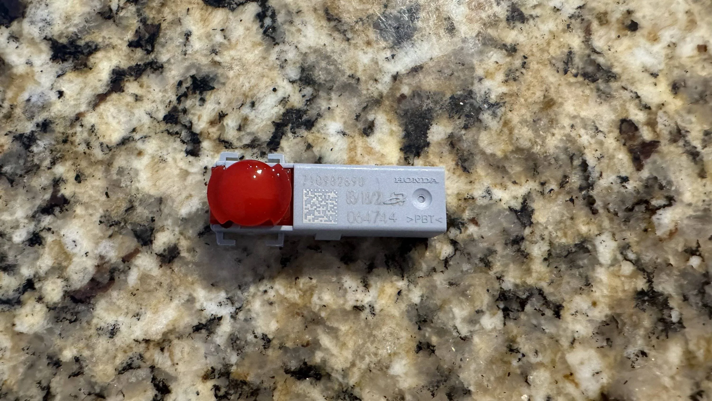

For those that have asked me about the LED modules.
Here are some pics of both the 34750-T20-R01 (Red case/Red LED) and the stock 34750-T20-A01 LED (Grey case/white LED) from the Integra.
Note that there is a white lens on all the LEDs. They can all be swapped out for where ever the LED is going.

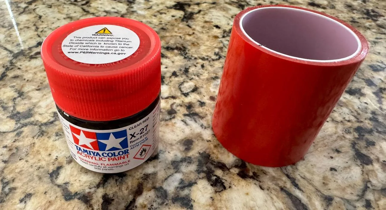

If someone made tinted lenses, there could be plenty of inexpensive color options keeping the stock white LEDs but at least we can swap them out for red.

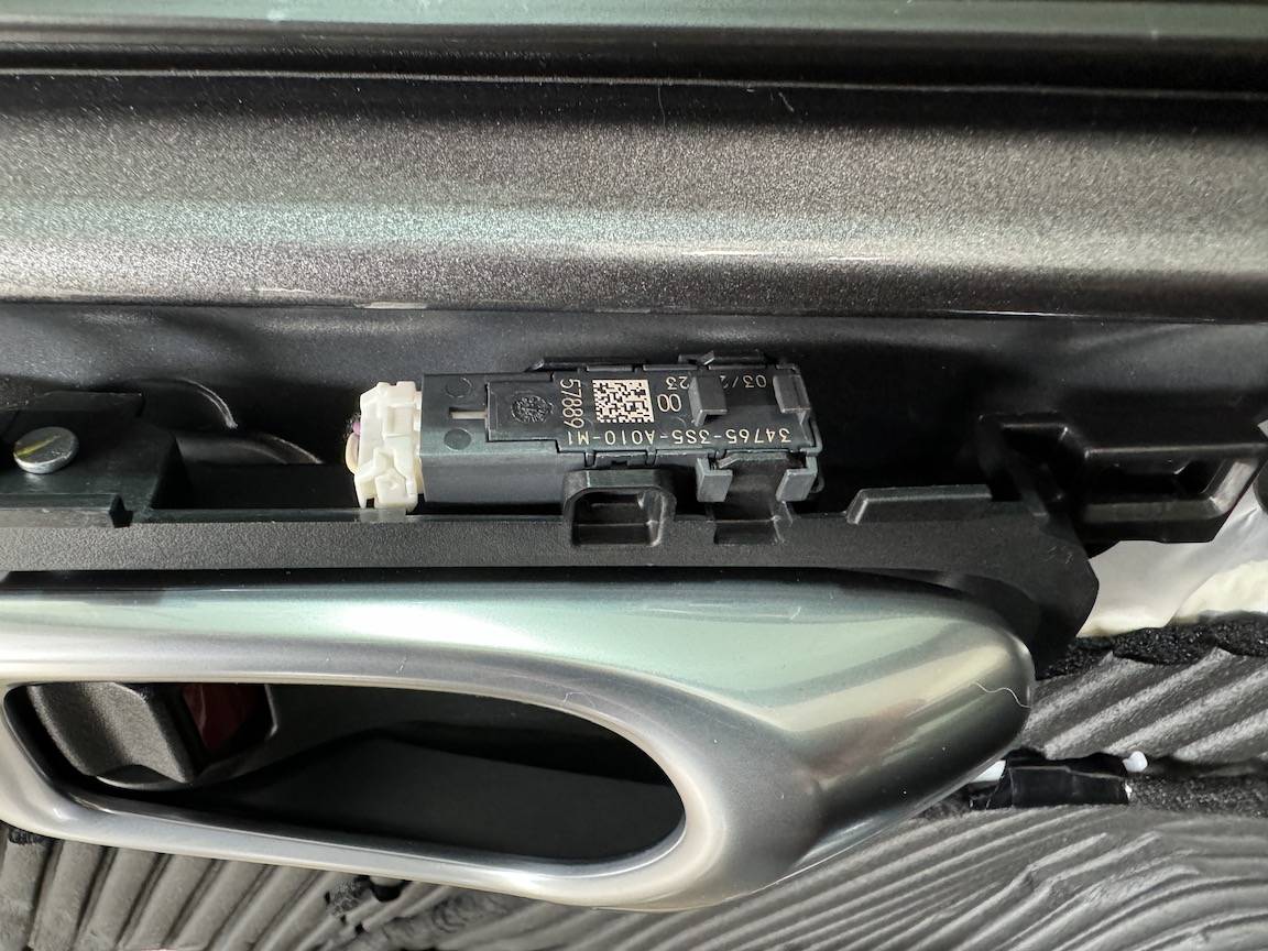

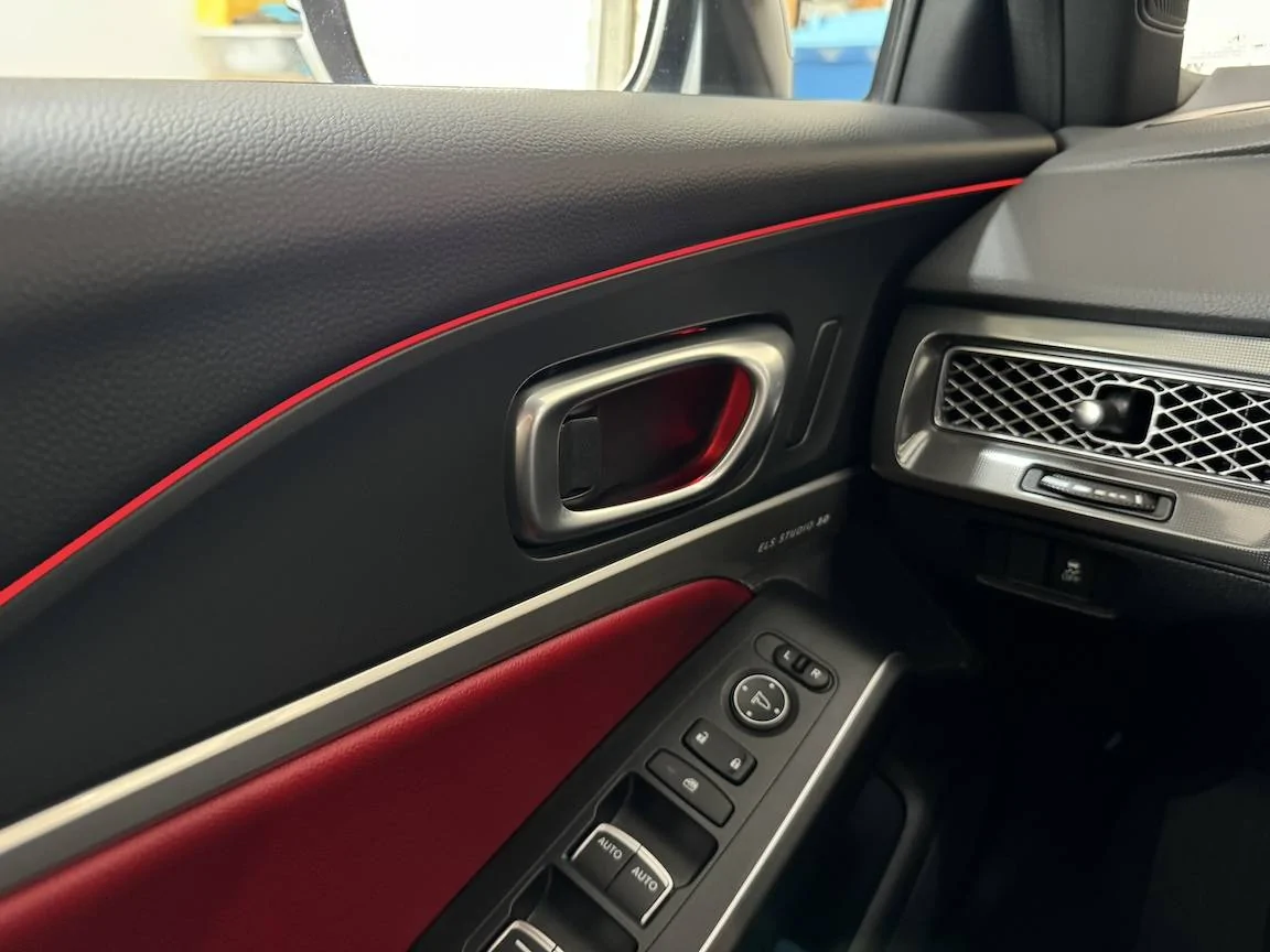

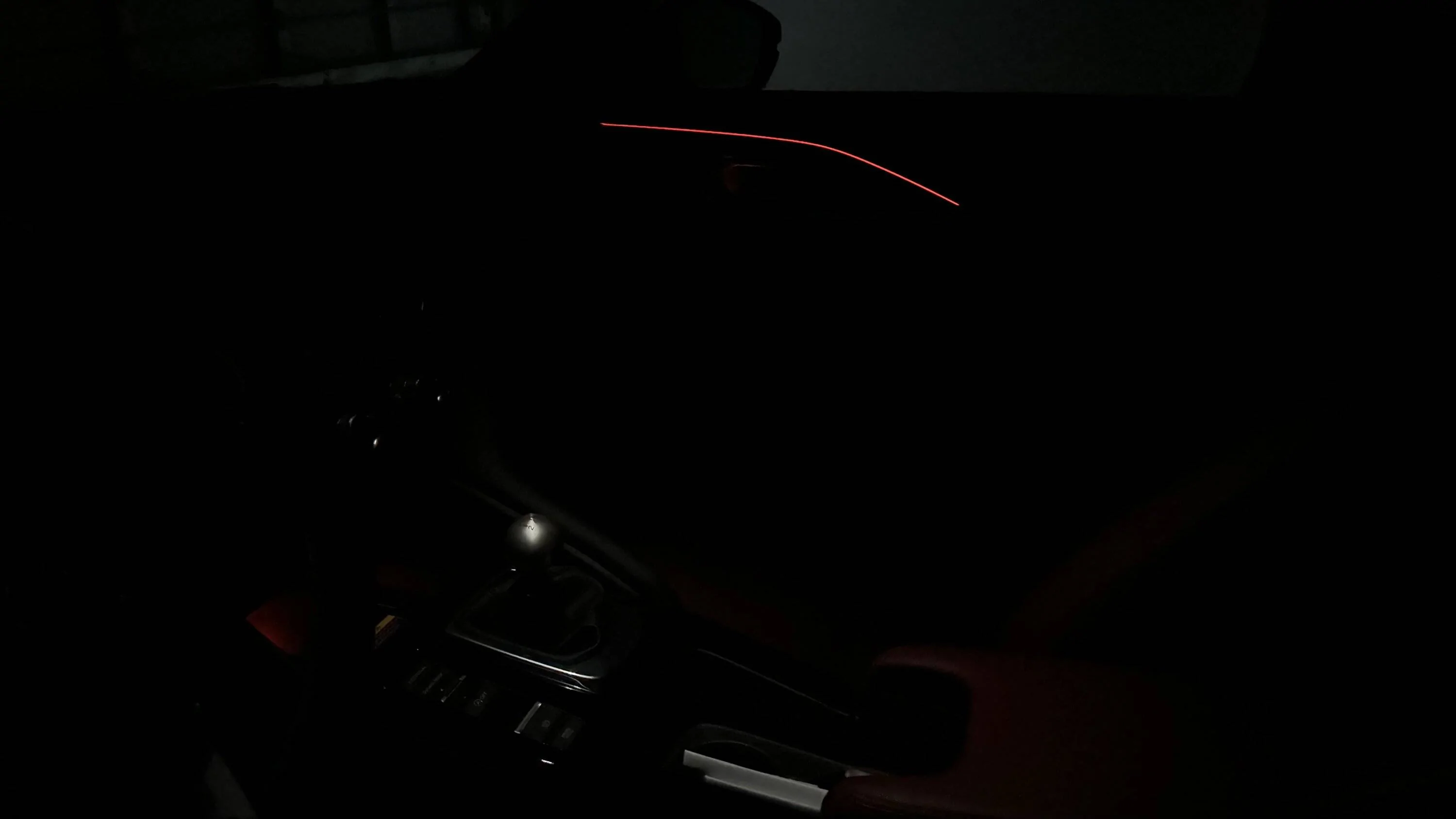

I originally posted this in another thread but it's more appropriate (and hopefully useful) here.
The only tools needed to replace the LEDs are a Philips screwdriver and some plastic trim tools to make it easier. Installing the pattern projectors will require 1/4 and 3/8 drill bits for the holes. Everything else is included in the kit.
The guys at AHC Garage have a great video showing how to remove the door panels and install the projector lights here.

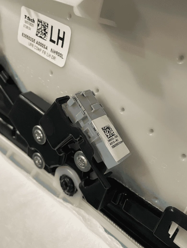

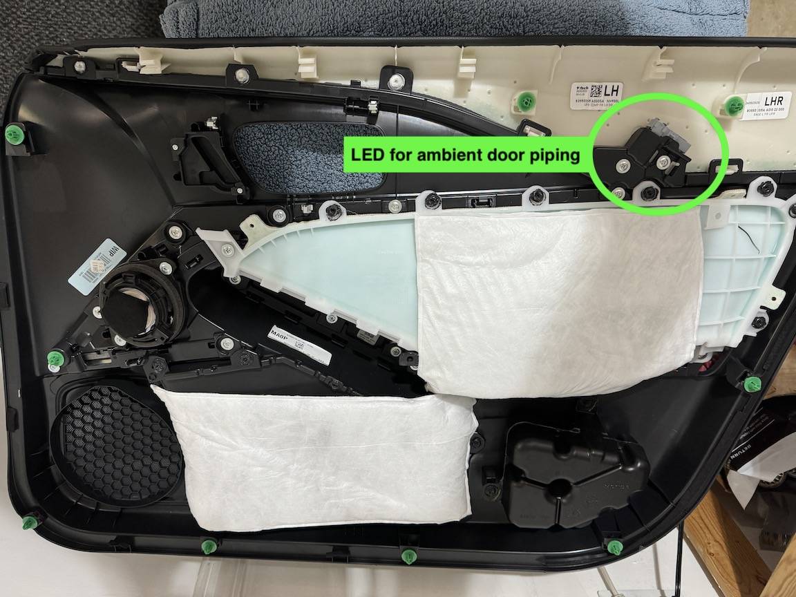

There are two LED modules in each front door that can be changed. One for the piping on the door panel and the other lights up the interior door handle. The red LED module is the same for both: "Light foot-well" part number 34750-T20-R01.
The LED for the door piping is on the top rear of the door panel. It's clipped in place and pops out easily with a trim tool.
Acura Integra Ambient Lighting img_0059-
Once removed, you need to swap the two connectors on the LED modules by sliding them up to remove then just slide them back in.
Acura Integra Ambient Lighting img_0062-
Then simply plug the new red LED module into the receptacle.
Acura Integra Ambient Lighting img_0066-
Acura Integra Ambient Lighting img_0067-

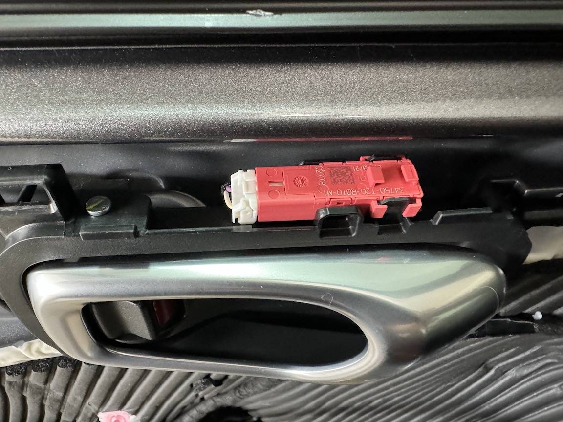

The LED module for the door handle is located above the handle itself.
Acura Integra Ambient Lighting img_0068-
Swap the connectors by sliding them up and out, same as before.
Acura Integra Ambient Lighting img_0070-
Then plug it back into the receptacle.
Acura Integra Ambient Lighting img_0072-
You now have some nice red ambient lights😎
Acura Integra Ambient Lighting img_0089-
Follow the AHC Garage video to install the "Logo Pattern Projector" part number 08V27-3S5-200.
I took my time and got both doors done in a couple of hours. I think the end result is quite nice.

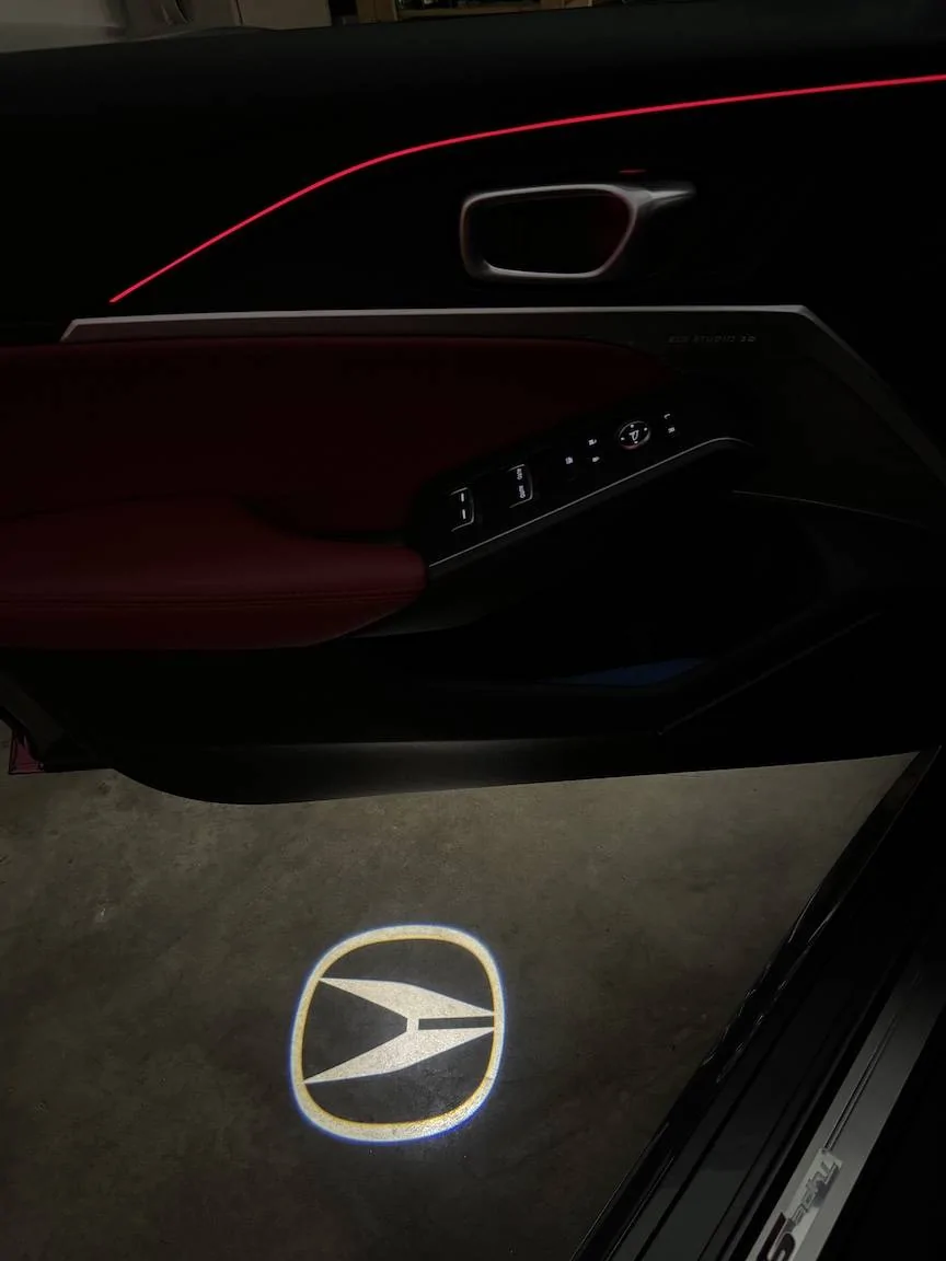

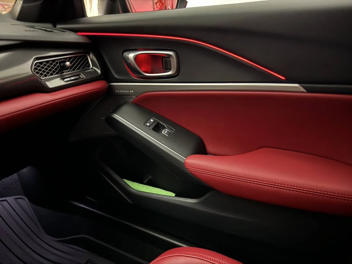

Thanks GTO. How accurate is your last pic in regards to red intensity? Did your camera exaggerate it a bit, or does it look closer to my 3rd to last pic?
Curious to know if the actual red LED is brighter than the semi-weak white that comes with the car.
GTO
Jun 27, 2023
66
144
NoVA
24 ITS, 17 BRZ
Thanks JC-RH!
I'd say the (iPhone) camera is accurate regarding the brightness/intensity but the shade of red is slightly darker in person. The red line illumination is even throughout the length of the pipe and is not washed out or distracting. These pictures are accurate with how it all looks to me during bright daylight and in the dark.
