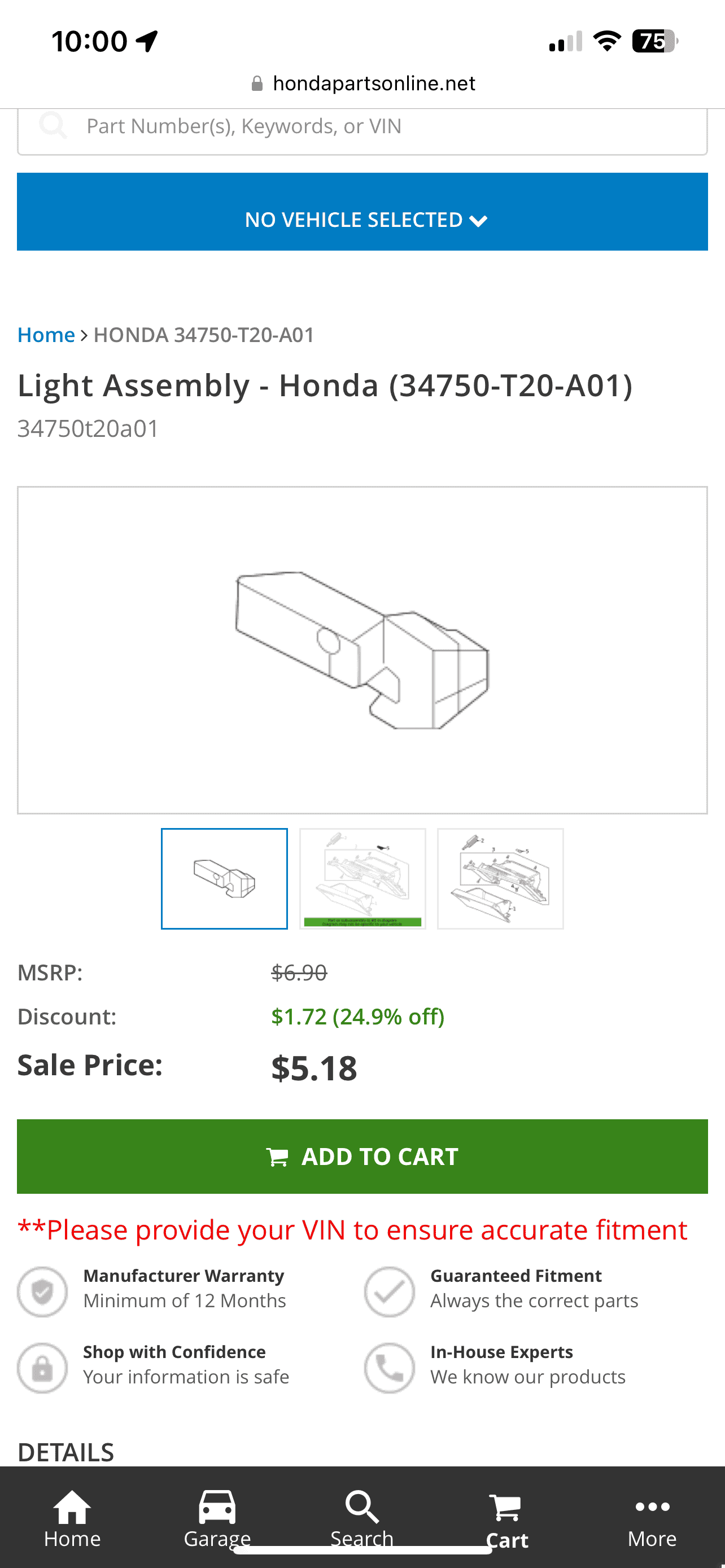

You posted the Type-R part number (34750-T20-R01). That’s coming up at around $20/light.
However, the part number posted by Necroflesh (34750-T20-A01) seems to be only $5.

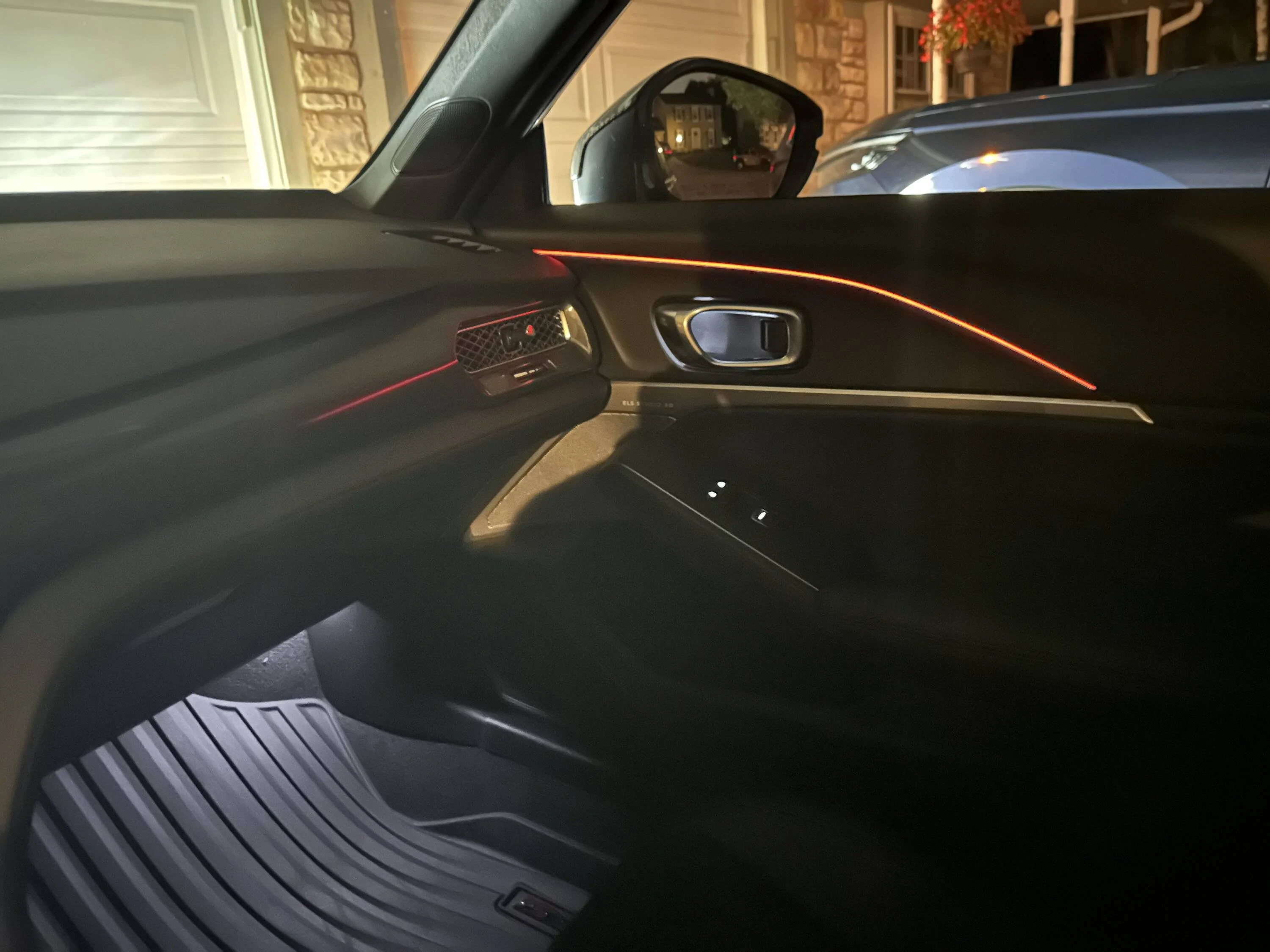

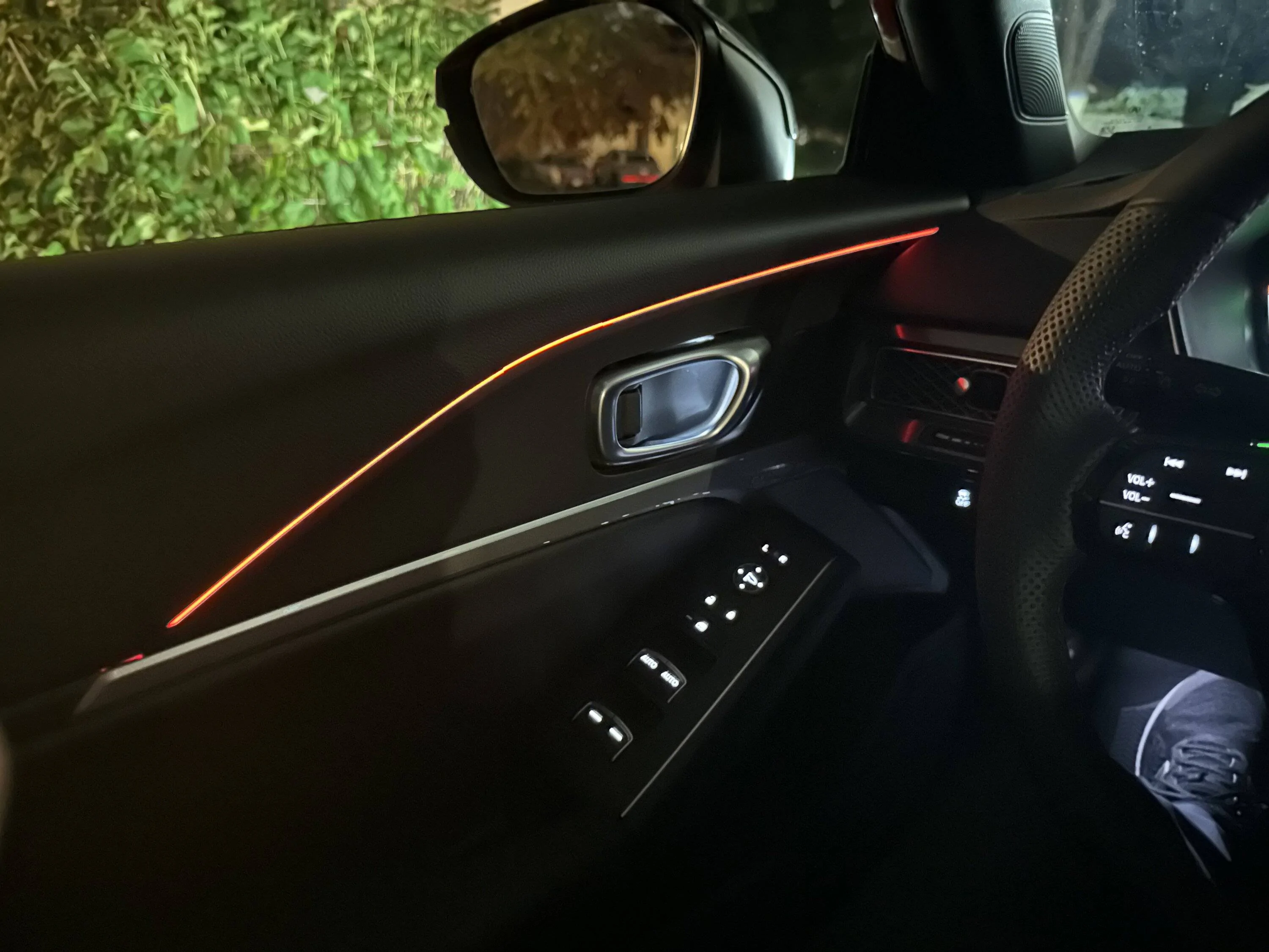

Do all the lights you installed look like this?
