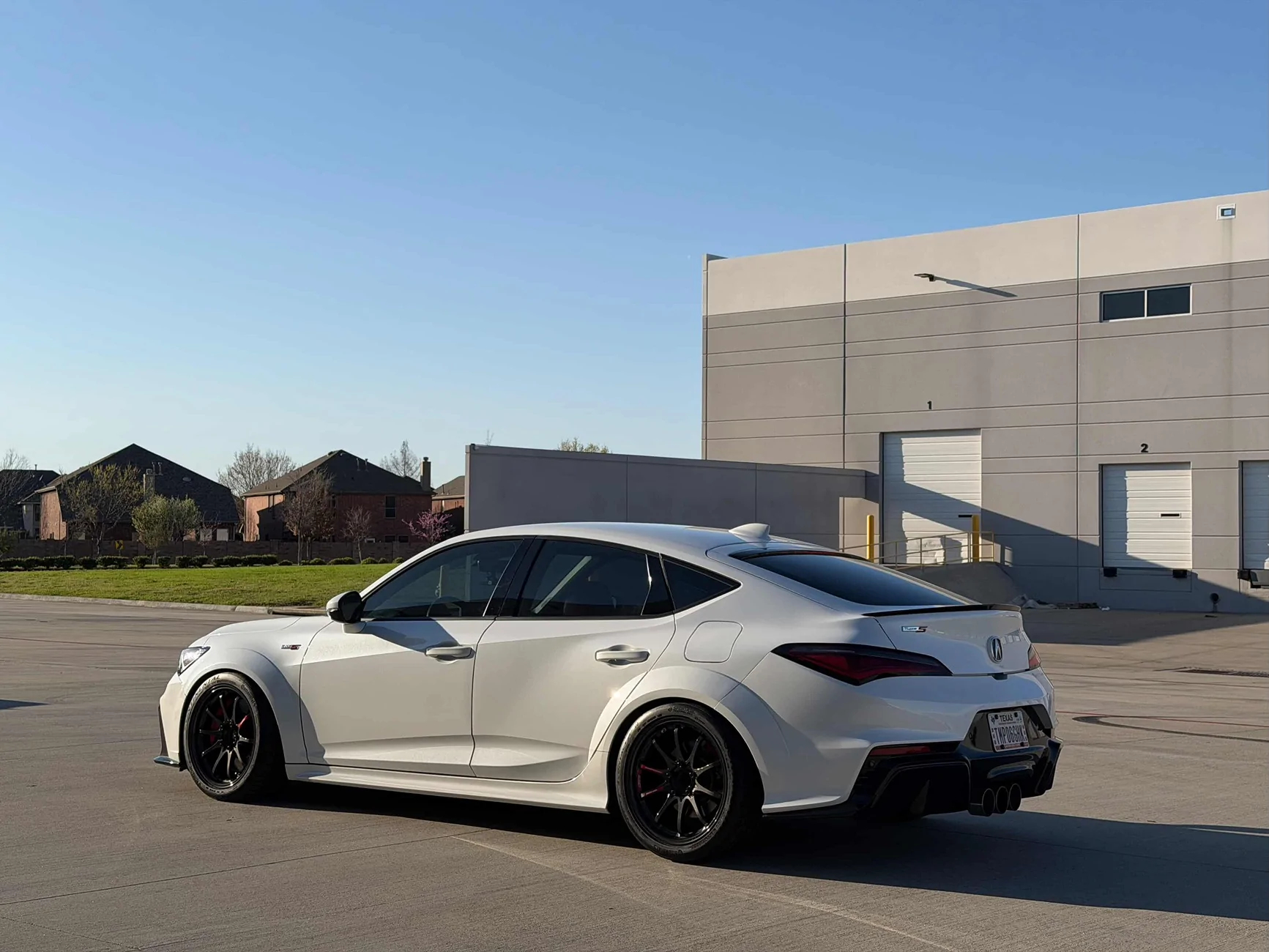

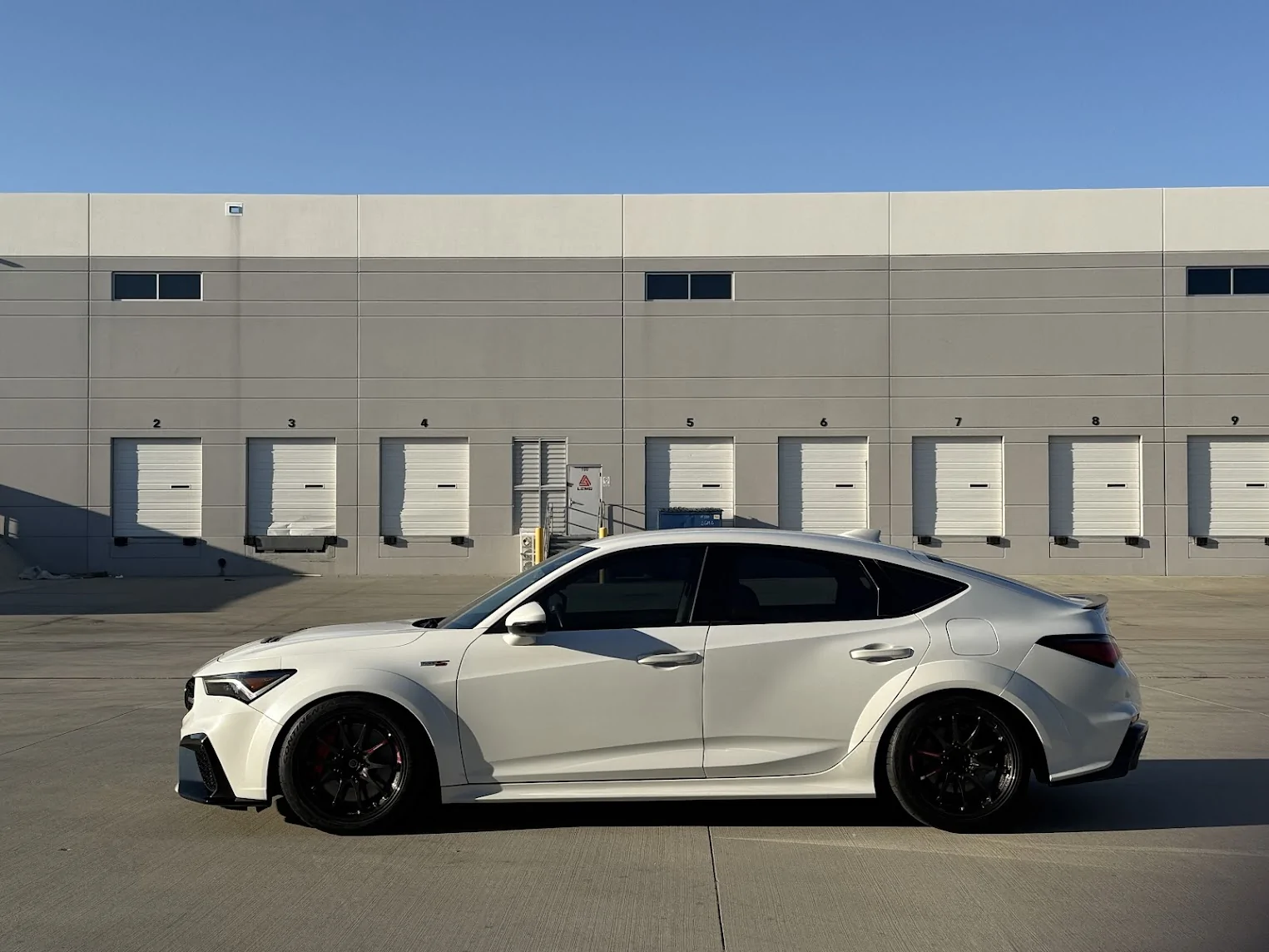

How’s the ride quality? Stiffness and bouncing?
Thinking about these for my ITS but I have the OEM 19” wheels
The ride quality isn’t the best to say the least. It definitely feels stiffer over OEM, but over time it’s felt like it’s gotten a tad bit better. Theres better options for ride quality that others have done with, such as Eibach Pro or H&R. Swift just gives the lowest drop all around. Here’s a pic on 19” wheels
