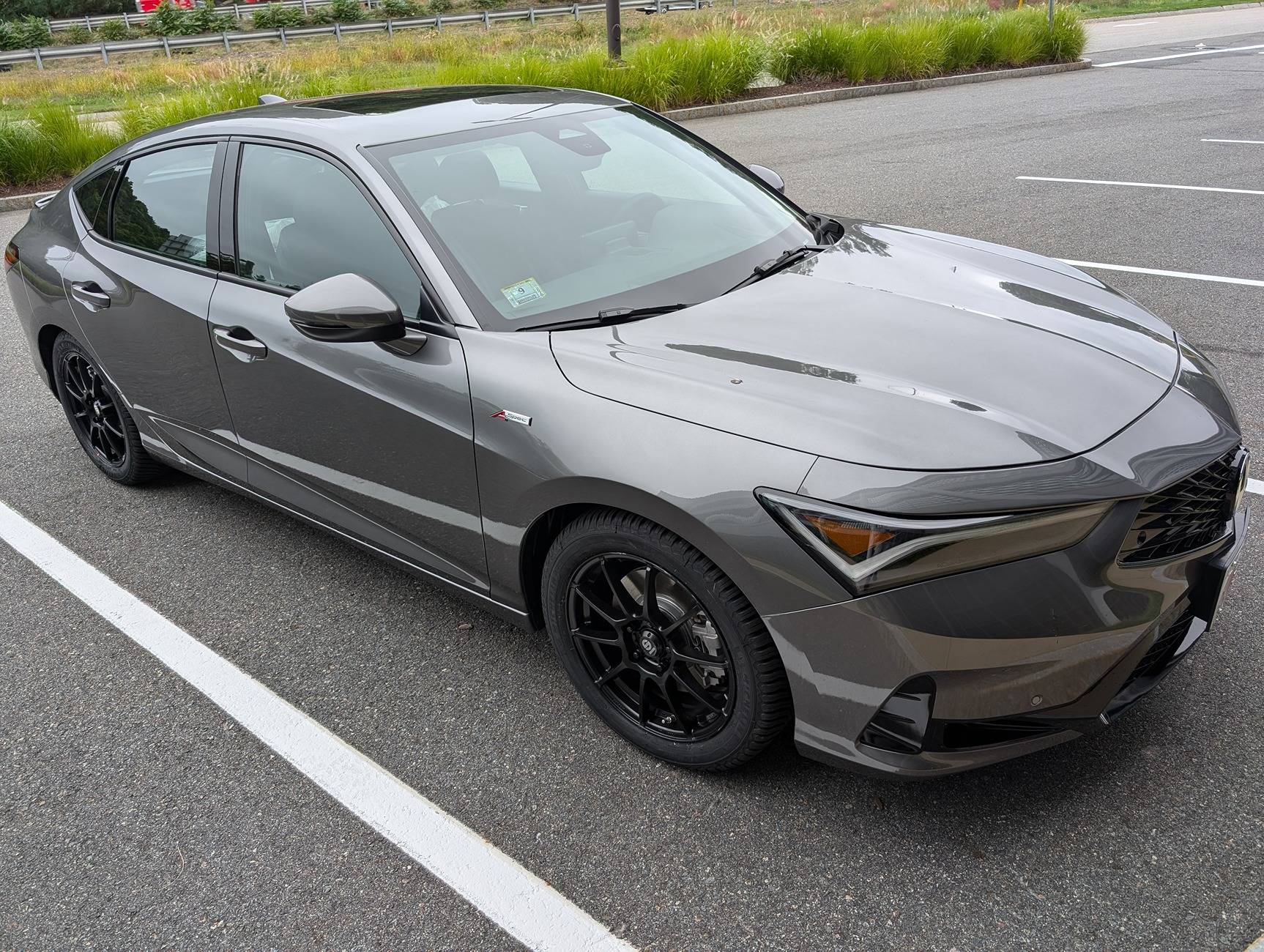

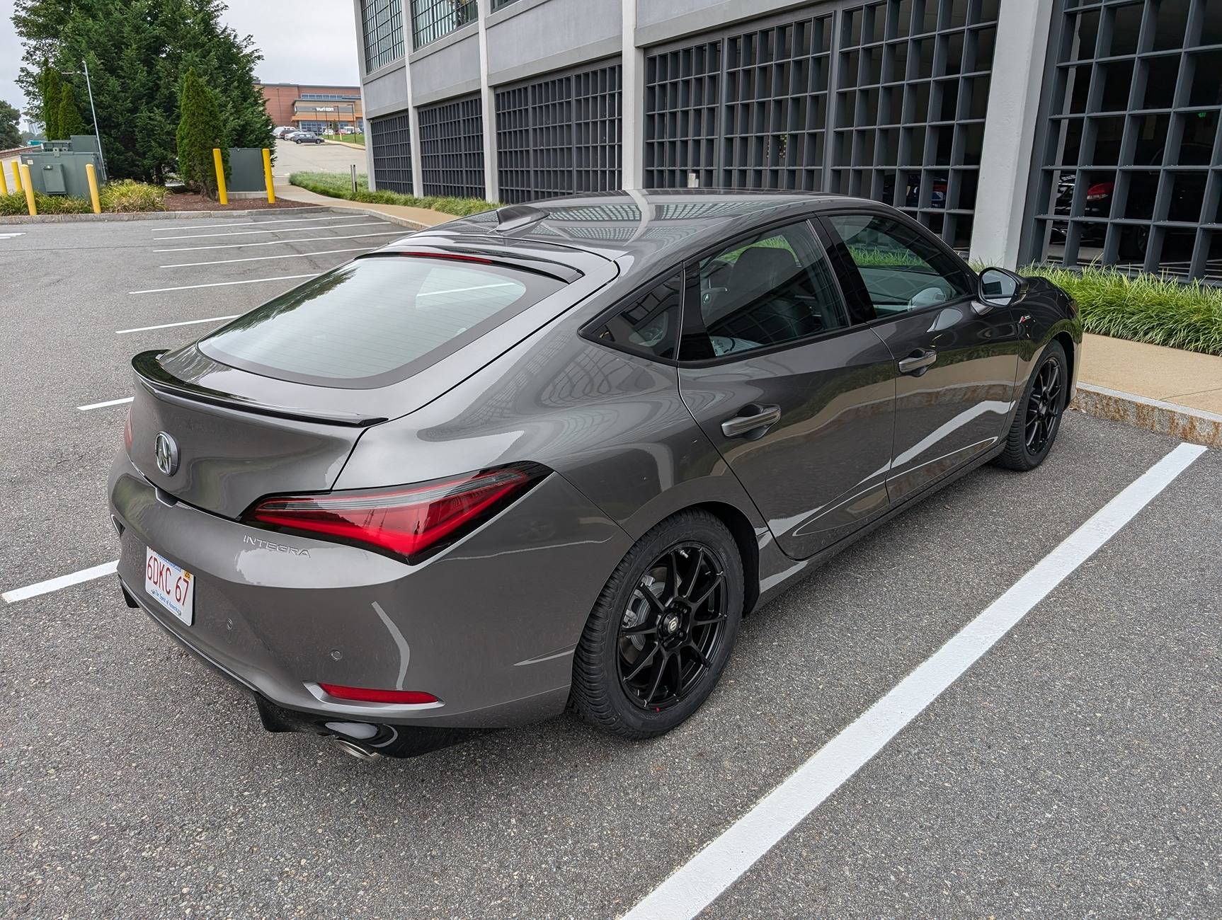

Just finished installing 17" wheels on my A-spec 6MT.
Sparco Assetto Gara rims (7" width, 45mm offset)
Michelin CrossClimate 2 tires (215/50)
There's about 3/8" clearance between the front brake calipers and the balancing weights on the front rims.
So far I am very happy with the ride and performance.

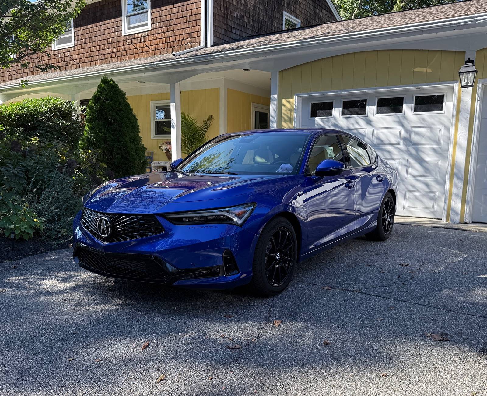

I am running 225/50/17 with some eBay Acura hub caps

Jacob, thank you for the update. Love the blue colour on this car. Your black wheels look good in the car. đźš™

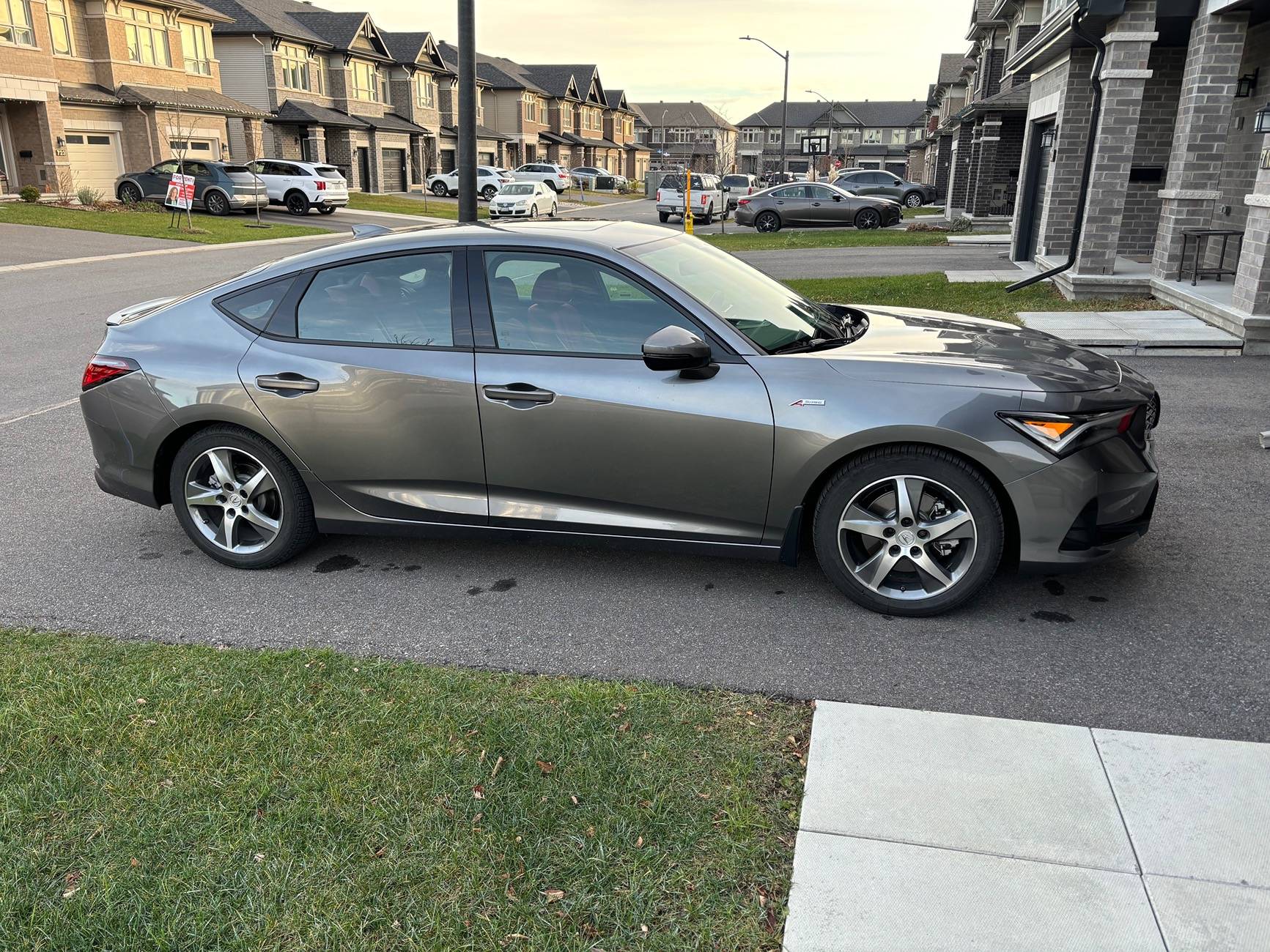

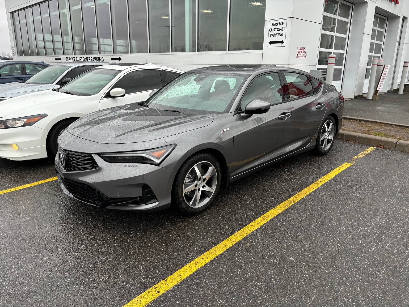

For those who may be wondering what a set of 2nd gen Acura TSX wheels look like on the Integra - here you go.
I put on a set of hem TSX wheels (17x7.5 with a +55 offset) with Michelin X-Ice 225/50R17 tires for the winter. They fit fine with no spacer required and no issues.
