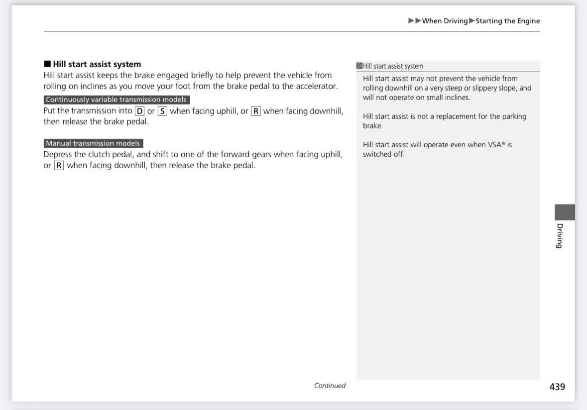

Could be hill start assist? I think it’s separate from brake hold. Pic below is from 2024 Integra Manual
I bet that is it! Thank you for that 🍻
