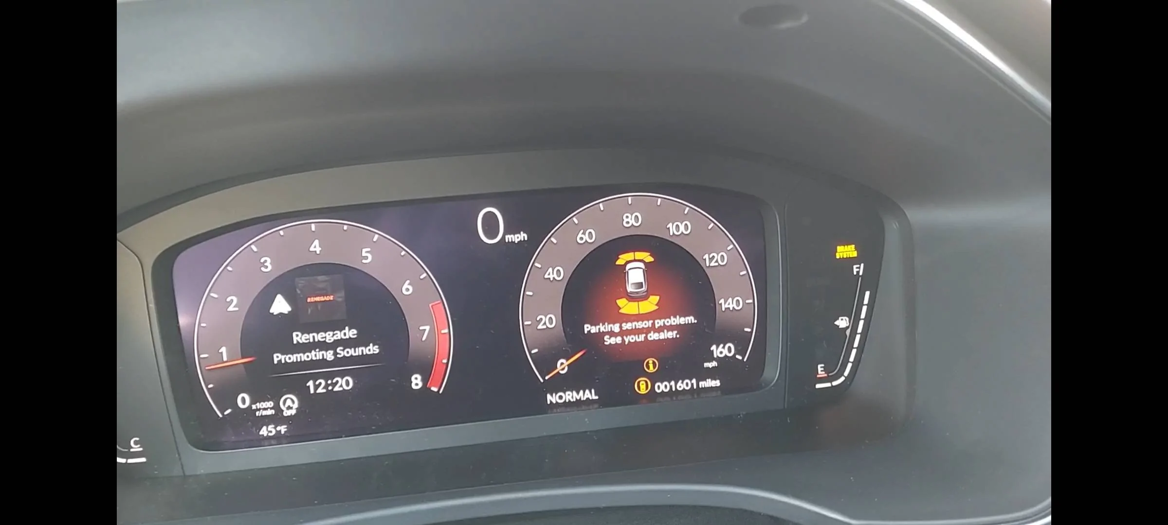

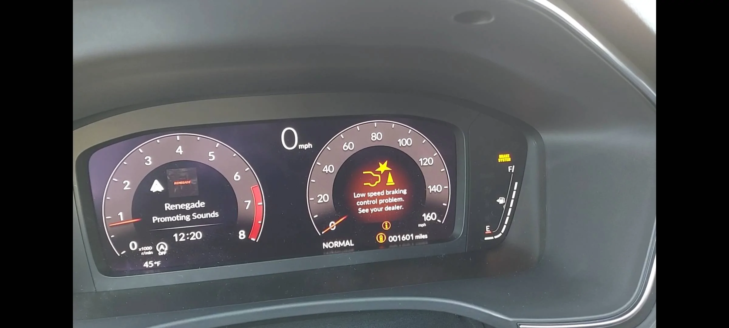

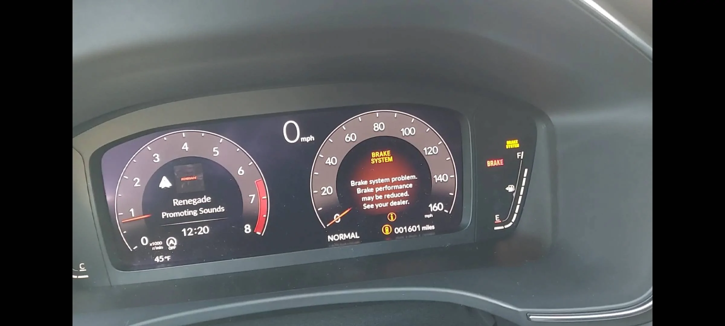

I am starting this thread to document the issues I experienced regarding the brake system and parking sensors. This also to stop high jacking jcombs91's thread.
On 11/21, when backing into my driveway, my car threw 3 errors along with a "brake system" warning light at 1601 miles. Pics of the errors are attached.
The next time I started the car, the errors were gone. About 1/4 mile from my house, while sitting at a stop light, the errors popped up again. At this point I called the dealer and scheduled an appointment for 11/25.
The errors did not occur at all 11/26 nor in my morning commute 11/27. At about 1:00pm 11/27, the errors reappeared. This time, power cycling the car no longer cleared the errors.
I showed up for my scheduled appointment with 1694 miles on the car to my closest dealer. I left the car running with the active warnings and errors to ensure they could see my complaint in its active state. They tried to get me a loaner and send me on my way immediately. I opted to wait 1 hour to see if this was something simple like a software update. I noted the odd behavior I sometimes have with the infotainment system to the service advisor as well citing I believe there is a software issue with the car. (Sometimes will not boot up when the car is started, taking 5-10 minutes before powering on & connectivity issues with Android auto forcing me to factory reset the unit.)
1 hour passed and the service advisor informed me the car was showing that the automatic emergency braking/parking system was not initialized. They tried to initialize the system and the car was not taking their inputs. Essentially the module was bricked.
I waited another 15 minutes because I truly do not want to drive a loaner and would prefer to drive the car I bought. Now, both service advisors that were on staff come to talk to me together stating that there is nothing they can do at the dealership and they need to contact the Acura (Honda?) Engineers to move forward. They also informed me that there were no available engineers until Monday 11/28 due to the holiday weekend.
After this, I got sent home in a 2022 RDX A-Spec loaner. I will update this thread once more information is available to me on what has failed. Hopefully this will help somebody else when this issue affects another car.

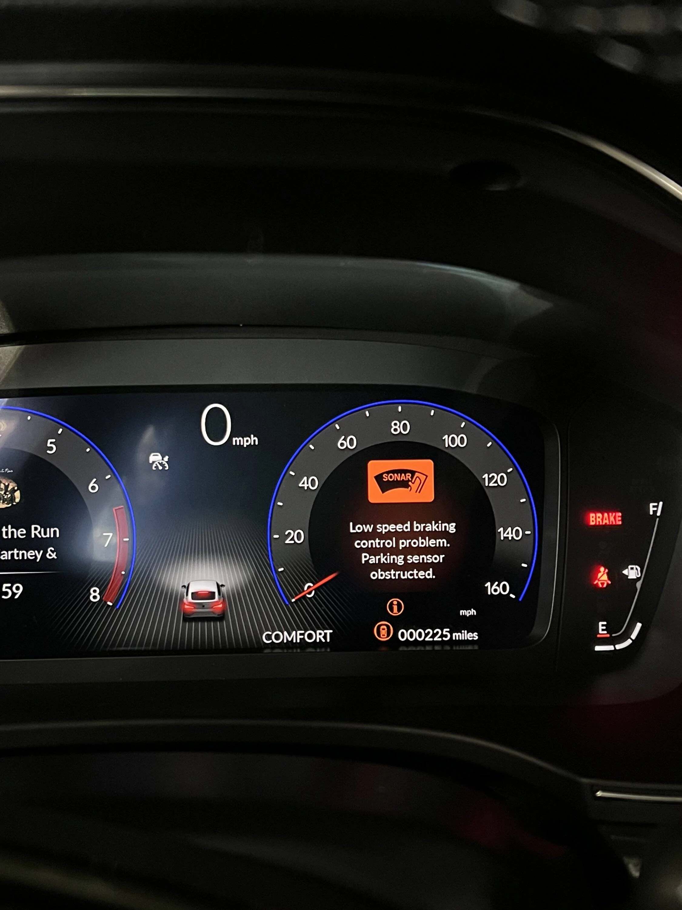

Interestingly, I got my integra on Monday. Every once and awhile, I get a “low speed braking” unavailable warning. It went away till today, I backed out of my driveway and as I went over the small lip, it triggered a bunch of braking warnings that have now went away…

Mine never said anything was unavailable besides the parking sensors when I was in reverse. I didn't take a picture of that error but it was always accompanied by the errors in my original post.

Finally had the ability to capture the errors I get! Dealership is looking into it on Thursday. Fingers crossed… lucky you got a loaner, they said it would be a month till I got a loaner.

Definitely different from mine. I didn't have any SONAR warnings.

Engineering first suggested replacing the brake control module. This was done and did not fix the issue. Now they are tracing wiring (again, they did this on Friday they said) at the direction of engineering. They stated I should receive a call tomorrow with an update. (I will be calling again tomorrow.)

Just got off the phone with the dealer. We are now waiting for a "parking sensor control unit" to arrive in 2-3 days. No commitment from the dealer on if that would actually fix the car or not, just that they "believe that to be the fix."

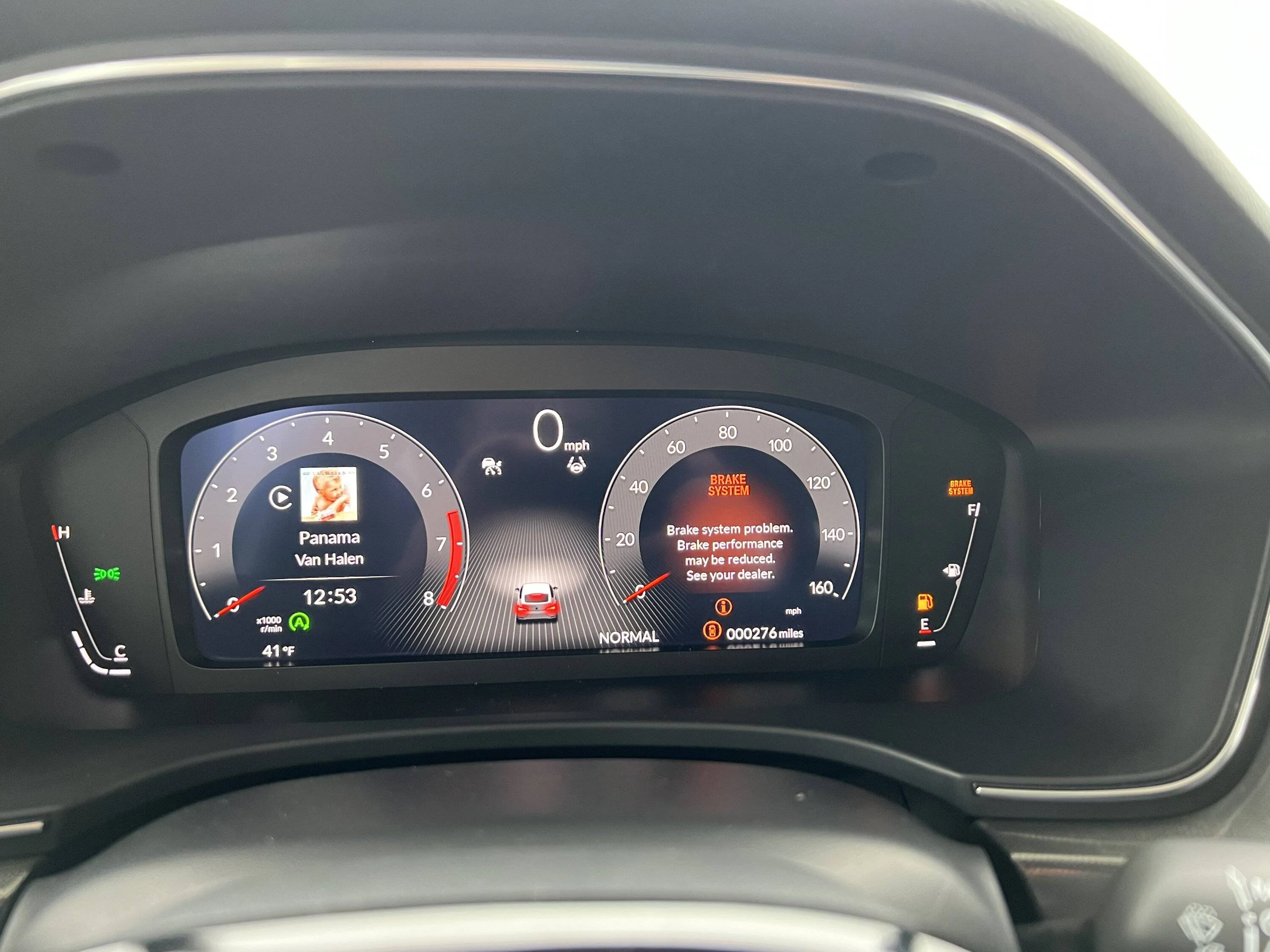

While driving through an intersection today my car gave the exact same errors as your's. :headbang: Power cycle "fixed" the error.
The dealer gets the car tomorrow. They have been top notch since the purchase, so hopefully I can get good service. You're not alone!

Hopefully your dealer knows more than mine. It appears as though my situation is the first being fed back to Acura at the moment. New brake control module. No Bueno. New parking sensor control module? We'll see the results before the weekend!
They don't know the problem and are throwing modules at my car currently. I get it, but at the same time if they spent the time/money doing a root cause analysis they could improve their product faster. Unfortunately, suits don't seem to understand this and here we are.
