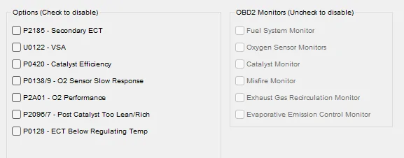

I know in ktuner and hondata (not sure about JB4) but it gives you an option to turn off O2 codes from popping up. Not sure if its any different for the ITS

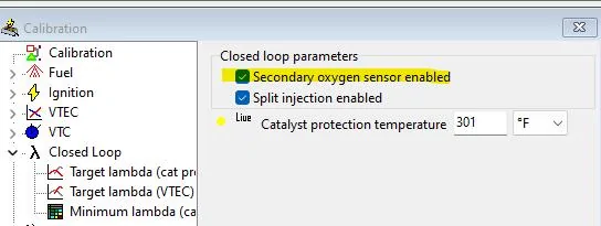

you dont need a "tune" but you do need your ECU unlocked and hondata management to be able to disable the 2nd o2 in your ECU..
disable this checkbox for catless DP's or for the catted RV6 throwing CEL.
