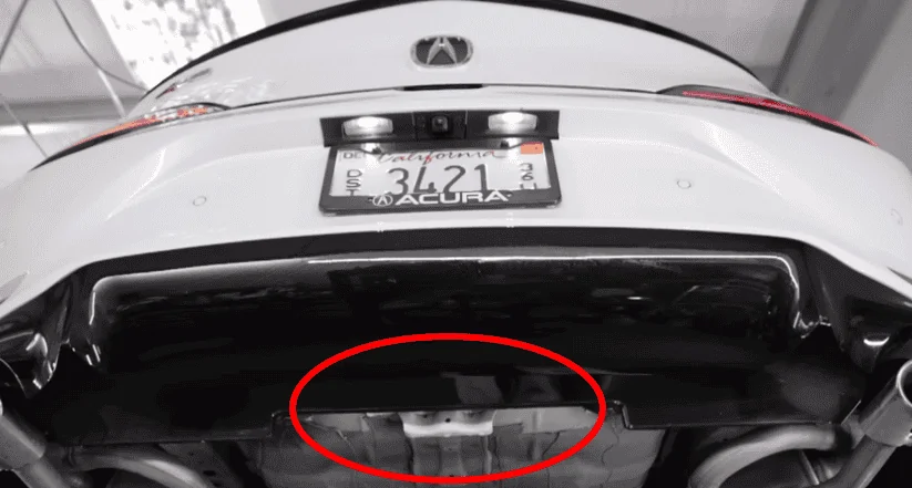

The exhaust is blocking access to the rear center point where the rear lower arm attach to the pivot point.

I'm fairly certain that this metal piece is the center rear jack point on the Integra (same as the 11th gen Civic). In older Honda products there was a tow hook in a similar location that was the jack point.
I jacked mine up here to install a rear sway bar. Definitely the spot.

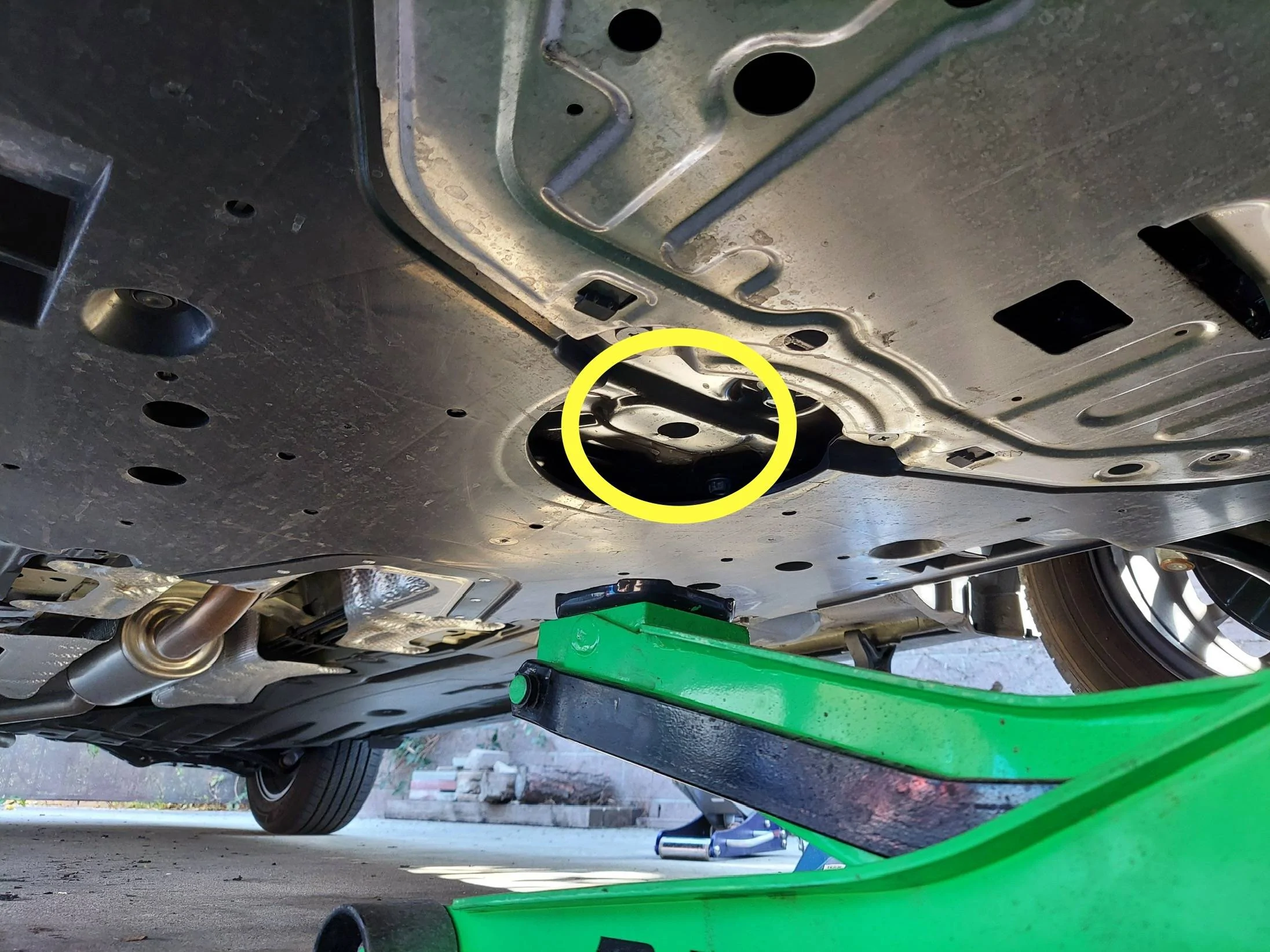

There is a front center jacking point. It’s behind the engine you’ll see a cross beam that is somewhat covered with the plastic undercarriage, right behind the metal shield that you remove when changing the oil/trans fluid. It’s extremely deep to get too, and if lowered you’ll need to get the car raised a bit (Ex. drive up on 2x4’s) and have a low profile Jack. It’s in the same position as the 10th & 11th gen Civic. (Not my photo but it shows the Jack point in front)
Thank you for this Photo!!! It helps, I also purchased the Megan racing ramps from Amazon, so this should be easy to reach

Check out race ramps. I have a set that gives 10" of lift when rolled up on the ramp.
