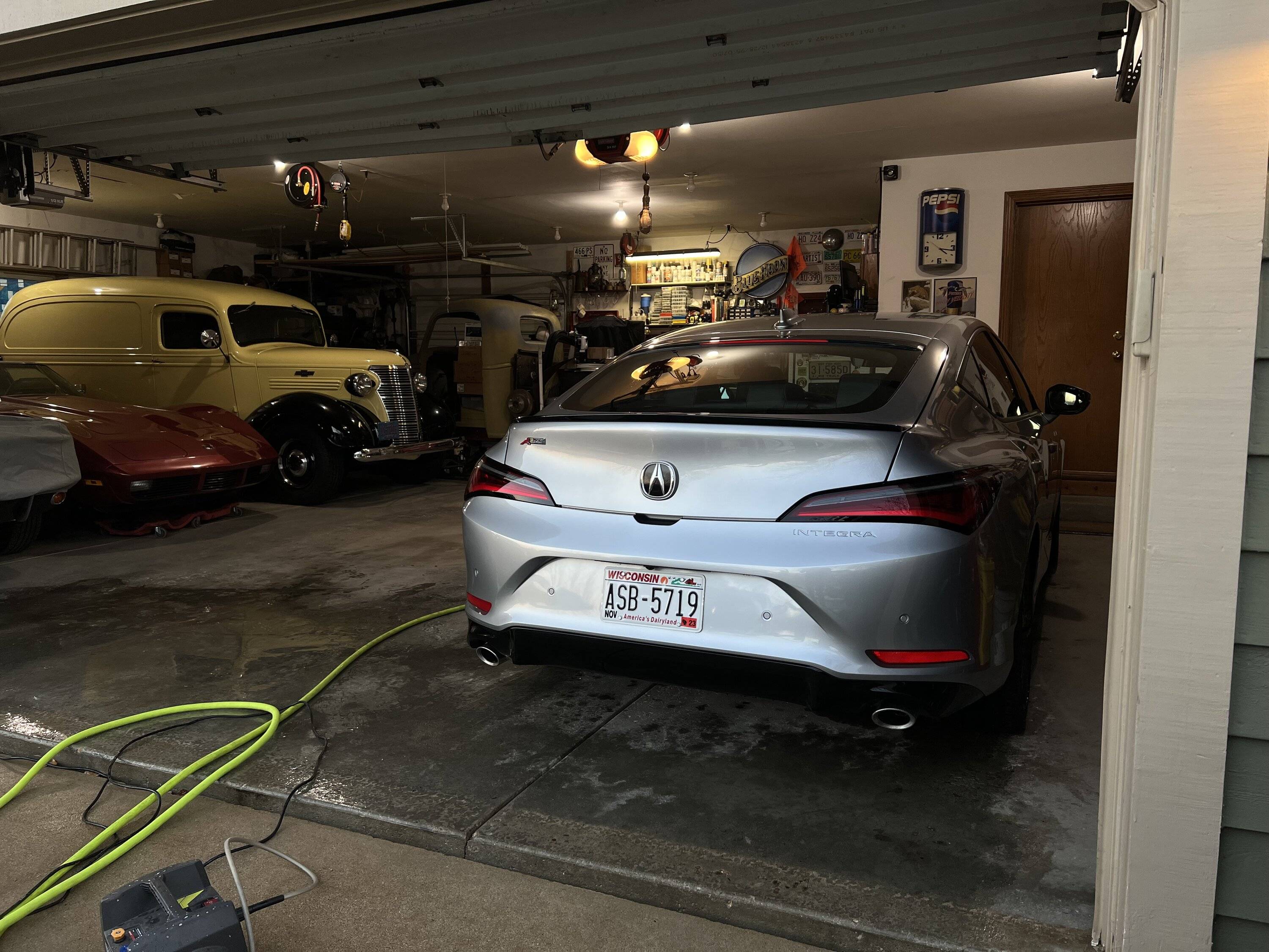

Hey all!
I received my Integra 6MT this past Monday and have been loving it! I notice when decelerating, there's a rattling sound that almost sounds like a clutch throwout bearing going bad. When pushing in the clutch, it seems to subdue the noise as well.
Has anyone experienced an issue like this yet?
