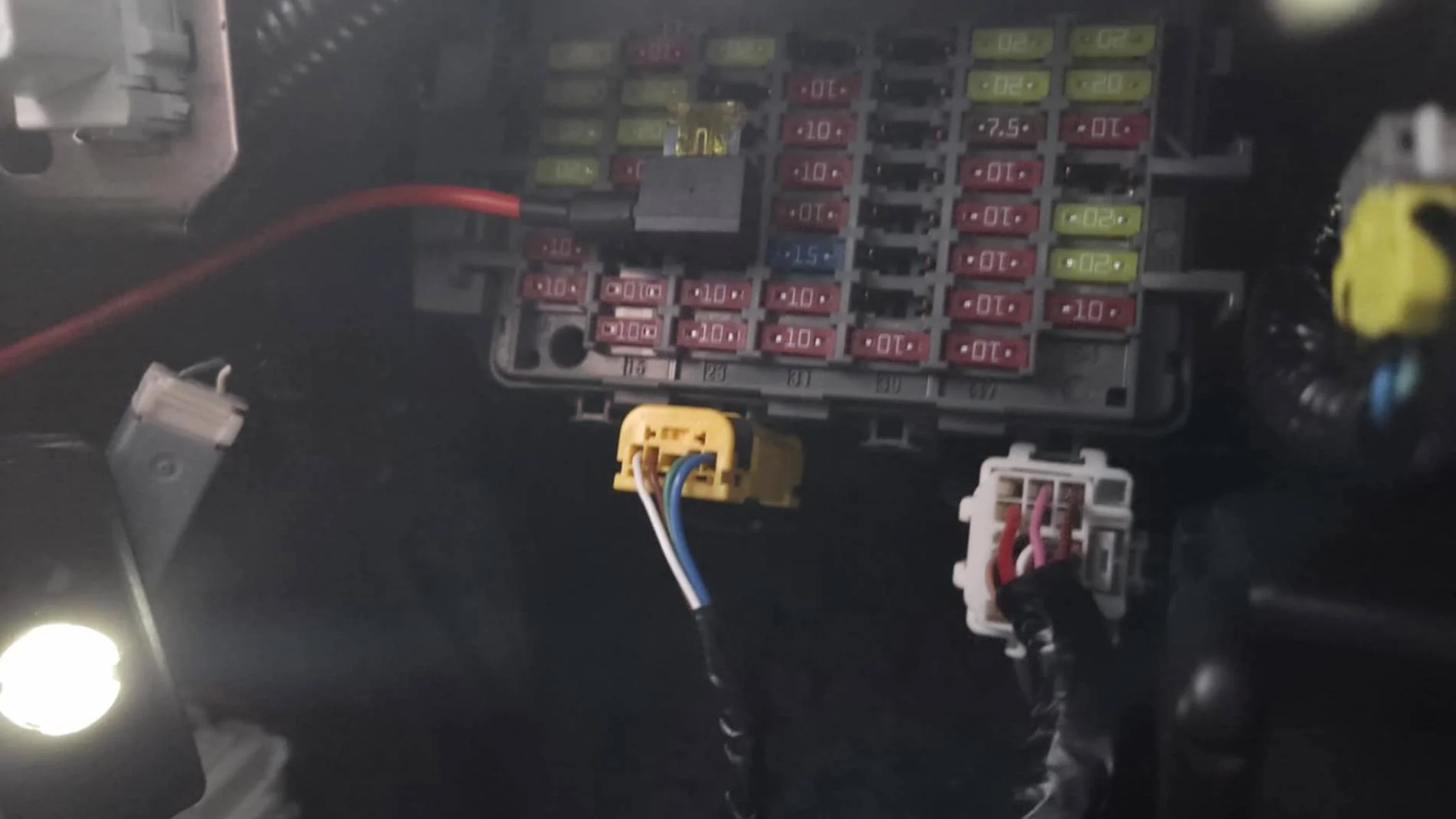

So I'll be installing a 2ch VIOFO A229 plus dashcam and Powercell Dash Cam Battery Pack into my ITS soon, still need to gather some parts. Blackboxmycar.com recently did an install into a 24 ITS and in their video they recommended to use either a 20 or 30 amp fuse with an add-a-fuse adapter. Here's a link to their YouTube video:

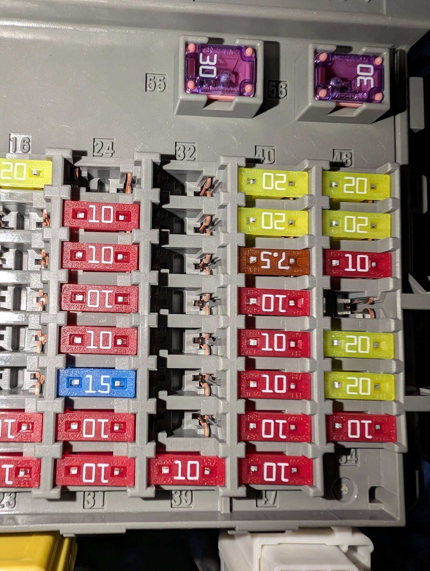

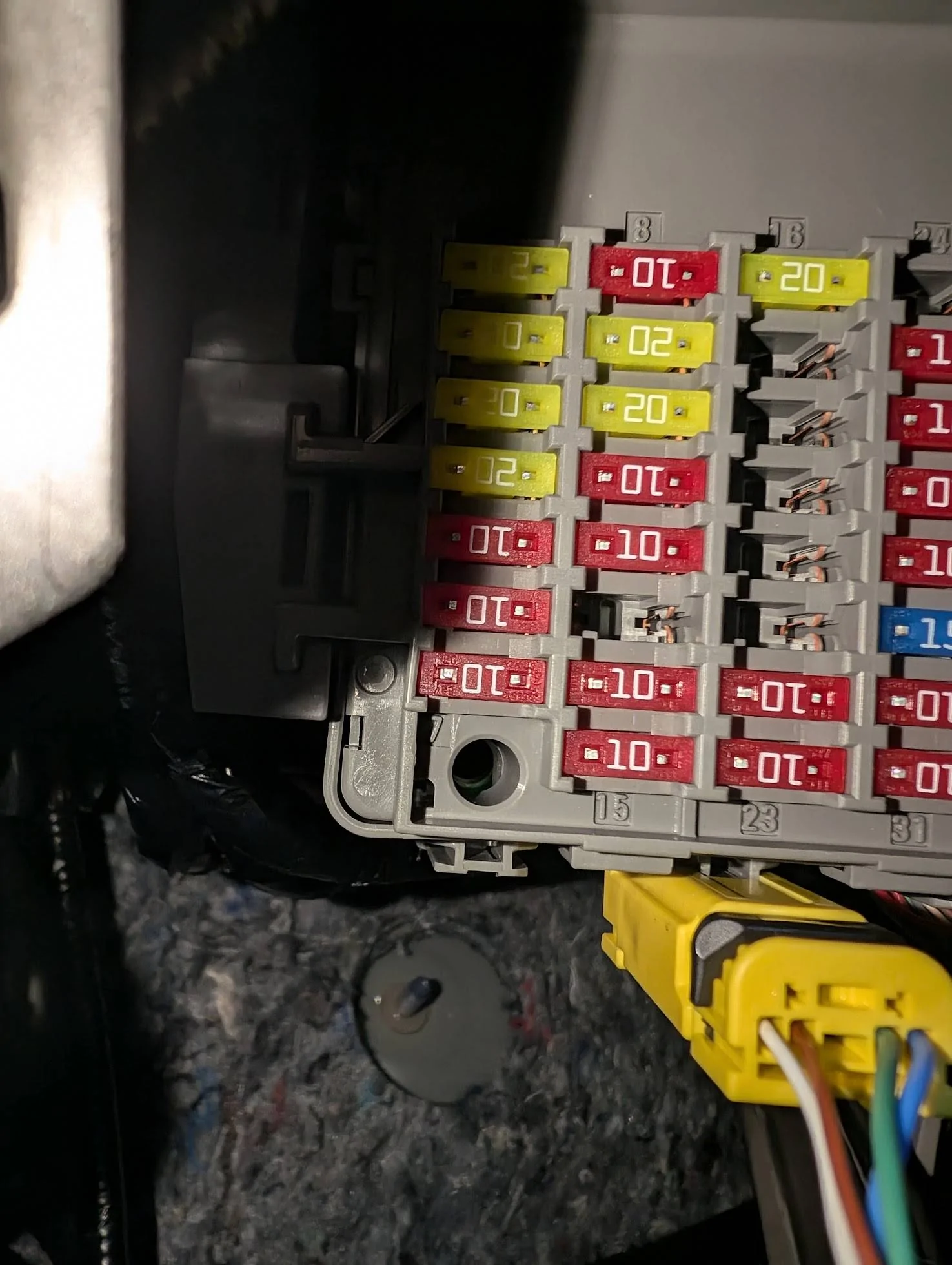

Looking at the fuse diagram in the car and at fuses themselves, I noticed that I have a 20 amp fuse installed in slot 16 which for a sunroof that our cars don't have. I know if we had a sunroof, it would only work while the car is turned on, so in essence I should be able to use this fuse for hardwiring the battery pack. Anyone see any reason why this would not be case?

Can you just test it with a volt-meter?
It might be helpful to look at the wiring harness/coupling for the sunroof cars and compare it to yours. Then you can figure out where you would have to wire it in.
