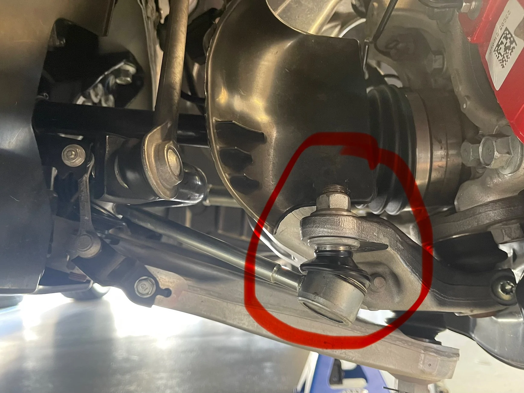

I installed Eibach Sportline springs on my DE5. Ever since, I have had clicking noises at low speeds while turning sharply (especially like entering my driveway). Seems like a fairly common topic, can find similar complaints even on FL5 forums. Have tried everything suggested that I can find (retorquing everything with suspension loaded, make sure springs seated right, top hat torque, sway bar end links, etc). Anyway, I am fairly certain the sound is from the springs themselves… just really hard to reproduce or pinpoint.
However, there is one thing that still bothers me… and this does not seem to be a common topic since i cannot find literally any info about it. After installing these springs, my “Front Stopper Links” are basically 100% maxxed out. The part I am referring to is item #14 in the attached exploded view.
Anyone that has lowered their DE5/FL5, what are you doing with this part? Is there some adjustable version out there and I am just horrible at searching?

What does it look like when the suspensions is loaded and not near the end of travel? Those are intended to articulate relatively extremely.
For your noise, did you have spring silencers on the springs? Are they well in position? Any signs of contact on the springs or any suspensions parts?

Even with suspension loaded it seems like the ball joints on the linkage are at their limit of articulation. As for the springs, it does have silencers installed. The springs seem to unclog the silencers over time from binding. I am likely going to switch to coilovers. When I called eibach tech support the guy I talked to was a total jackass and rude, said he had never heard of such an issue despite similar complaints all over fl5 forums.
un-click not unclog… like it unsnaps them off the springs over time

From the photo, that articulation looks normal. Both ends are tilted the same direction, so it's not "binding". If one was totally one way and the other pointing the other direction you'd be out of range.
Slide the silencer up and make sure it's pinched up into the progressive area as much as you possibly can. You can use some high strength glue under it to keep it in place.

Well, it seems the clicking/popping issue I had when turning at slow speeds and going over a bump (I.e entering my driveway at an angle) was definitely coming from the eibach Sportline springs.
These came with spring silencers already installed and glued in place when I got them. Since the last time I looked, I can now actually see the points of contact on the springs… and the silencer was not in the ideal location. I had to basically slide it down the spring about 3”… used a heat gun to remelt the glue to hold in place.
No more clicking/popping sounds, and no longer suspicious of the front stopper link. Thank you for the help!
