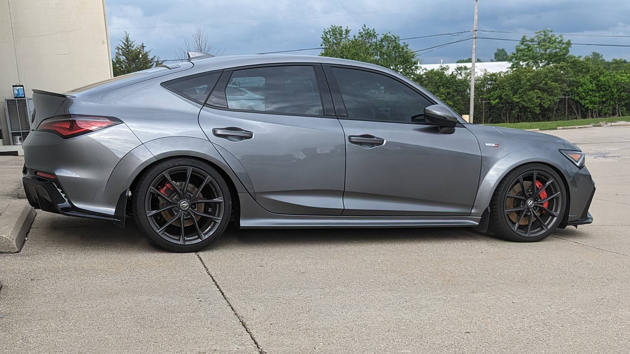

H&R lowering springs and Konig Ampliform 18x9.5 with 35 Offset
Kvtran21
Kevin
Nov 20, 2023
95
139
Texas
Are you on stock camber values? looks nice though :)
I believe I’m at -1.8 or -2.0 all around. I don’t have any additional suspension mods other than the springs and pulling the front strut pins when the springs were installed.

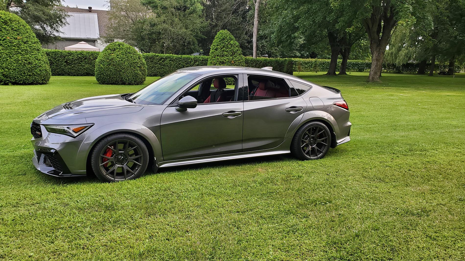

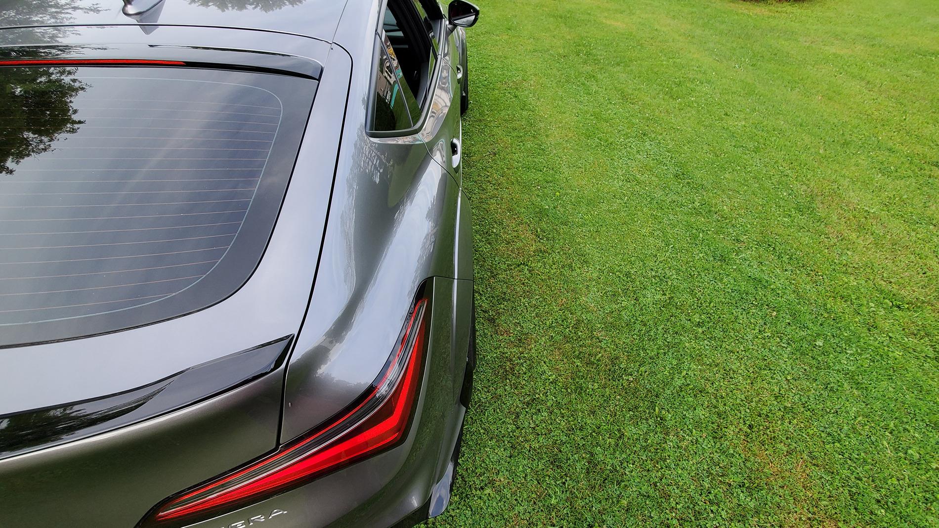

ok, alignment done, with the pins removed and shock bolted to maximum camber I was at -1.8 left and -2.2 right... brought the right side back to stock settings and now I have front L-1.8 and R-1.9 and both rear are at -2.2 witch is fine... also even at +35 I did not rub so far... this Friday I will go on a 3.5h road trip to my vacation house with the family, this will be the best ''rubbing'' test :)
DomGSR-T
May 6, 2024
Montreal
2024 ITS - 98 Integra GSR-T - 08 TL-S M6
ok I'm back from the big test and I can confirm that H&R lowering springs and Konig Ampliform 18x9.5 with 35 Offset does not rub at all... not even once I got a problem... so for those who wants to save 7lbs per wheels for a descent price, this is a great option :)
