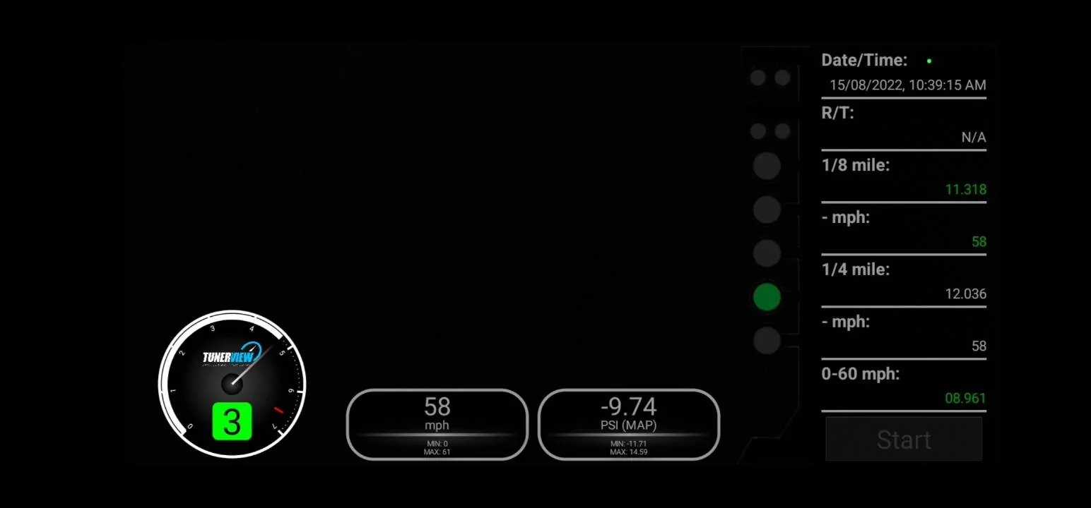

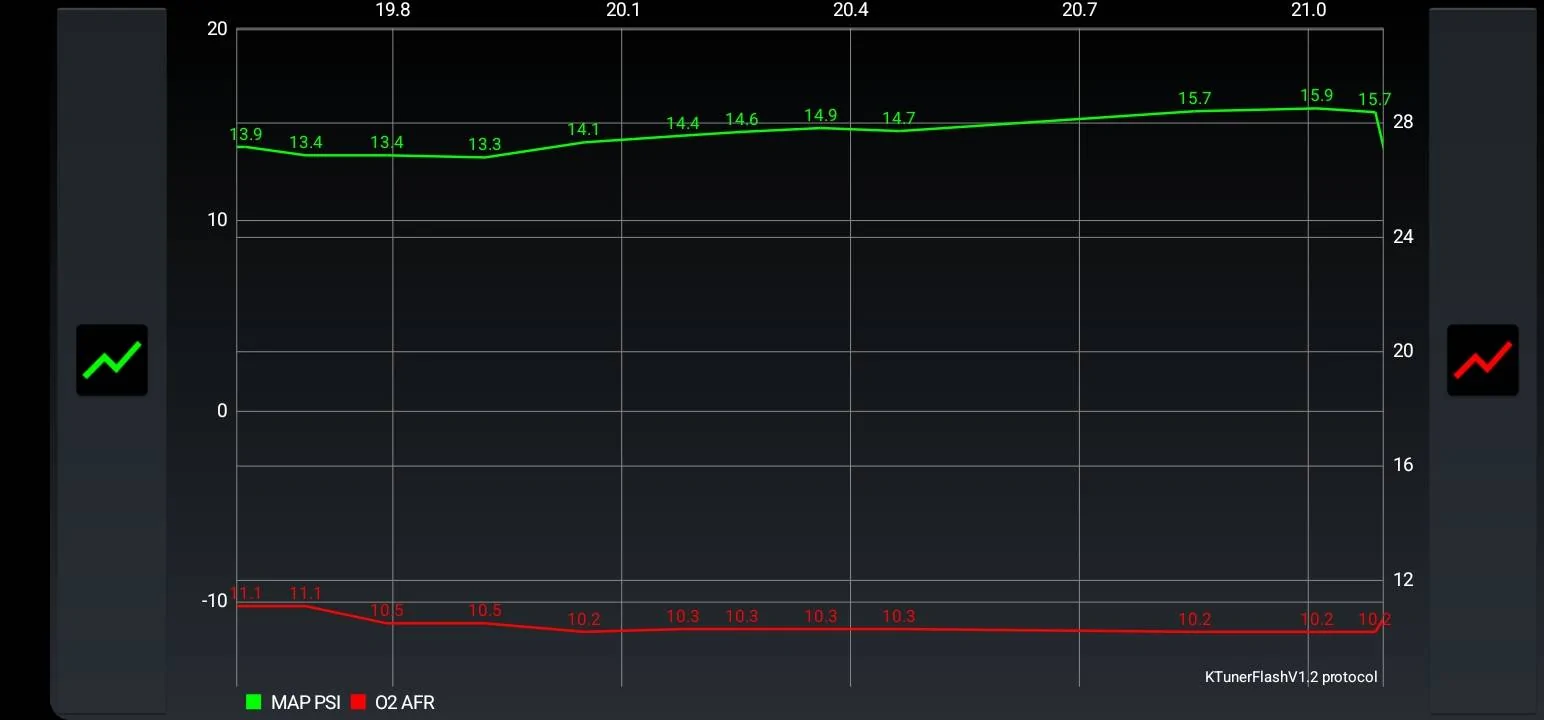

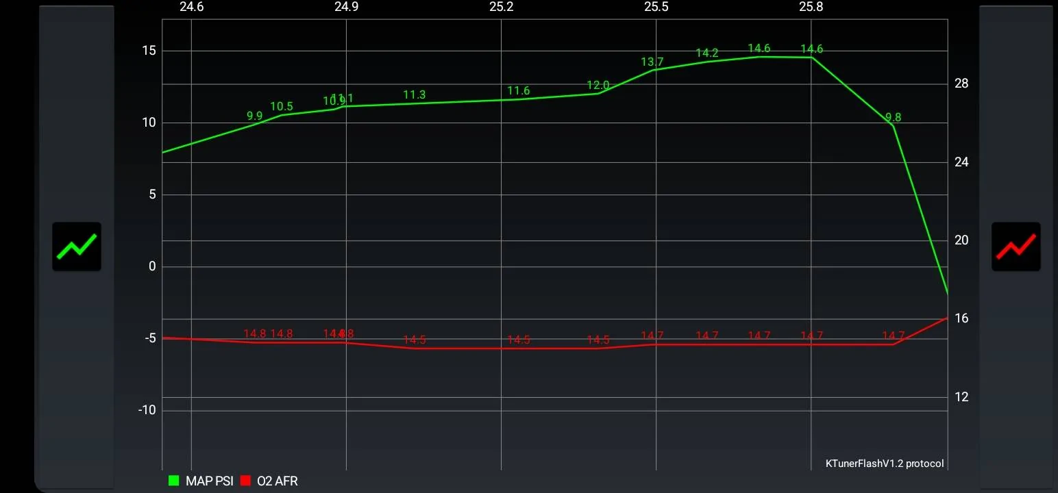

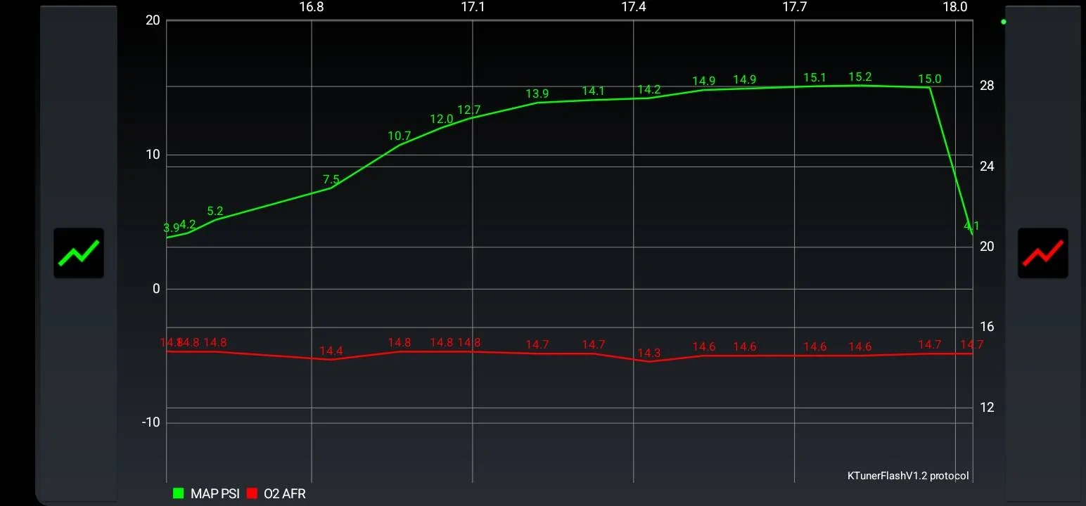

So back on stock tune here is the values. Pretty much same behavior. 1st gear stays in 14s with 2nd staying at 14s until the middle and then switching to 10s closer to the end. The stock tune honestly feels more aggressive but not smooth like the tune. On the tune its hard to tell where the power cut off but on stock you can feel the drop off, but the numbers tell me the tune is doing what its suppose do. A very different story. This is with traction control reduced, same road where all the previous tests done but temps are a little hotter. I couldn't save the better run because my phone decided to auto rotate and it erased the values but 0-60 in 7.9 secs in that run.
1st gear
Acura Integra Ktuner for 2023 Integra is live! Screenshot_20220815-122603_TunerView
2nd gear
Acura Integra Ktuner for 2023 Integra is live! Screenshot_20220815-123115_TunerView
0-60 1st run lol. Launching at 1500rpm. Traction reduced. Just for reference with the tune same road with traction normal the runs are usually in the 7.2 to 7.5 range.
Acura Integra Ktuner for 2023 Integra is live! Screenshot_20220815-123039_Gallery

You will not target WOT Enrichment values until the ECU goes into enrichment modes. If you analyze the behavior from the factory it will stay leaner much longer than with a tune.
There is no WOT VTEC activation on this application, so yes, it's right. It'll never engage at WOT with those factory settings, just as Honda/Acura intended it.

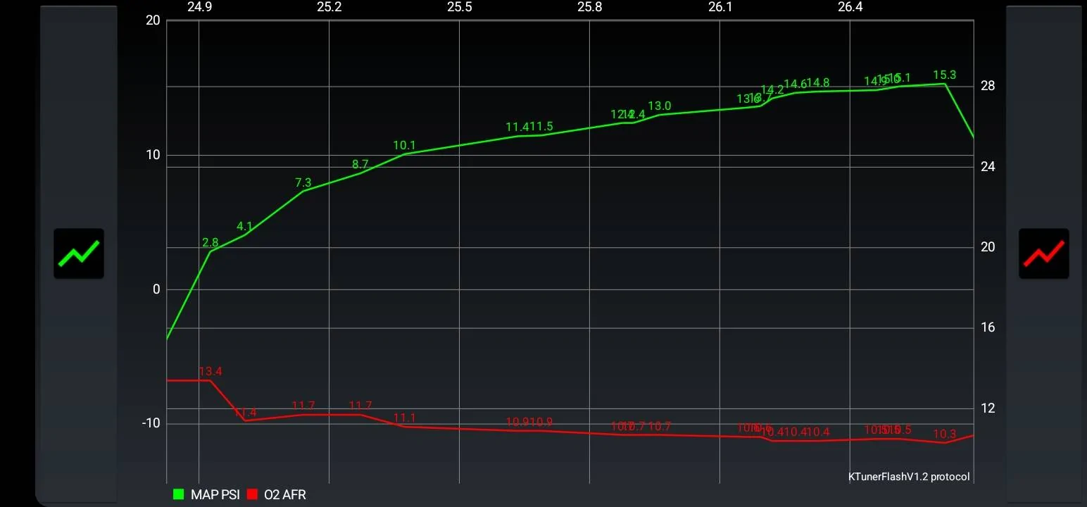

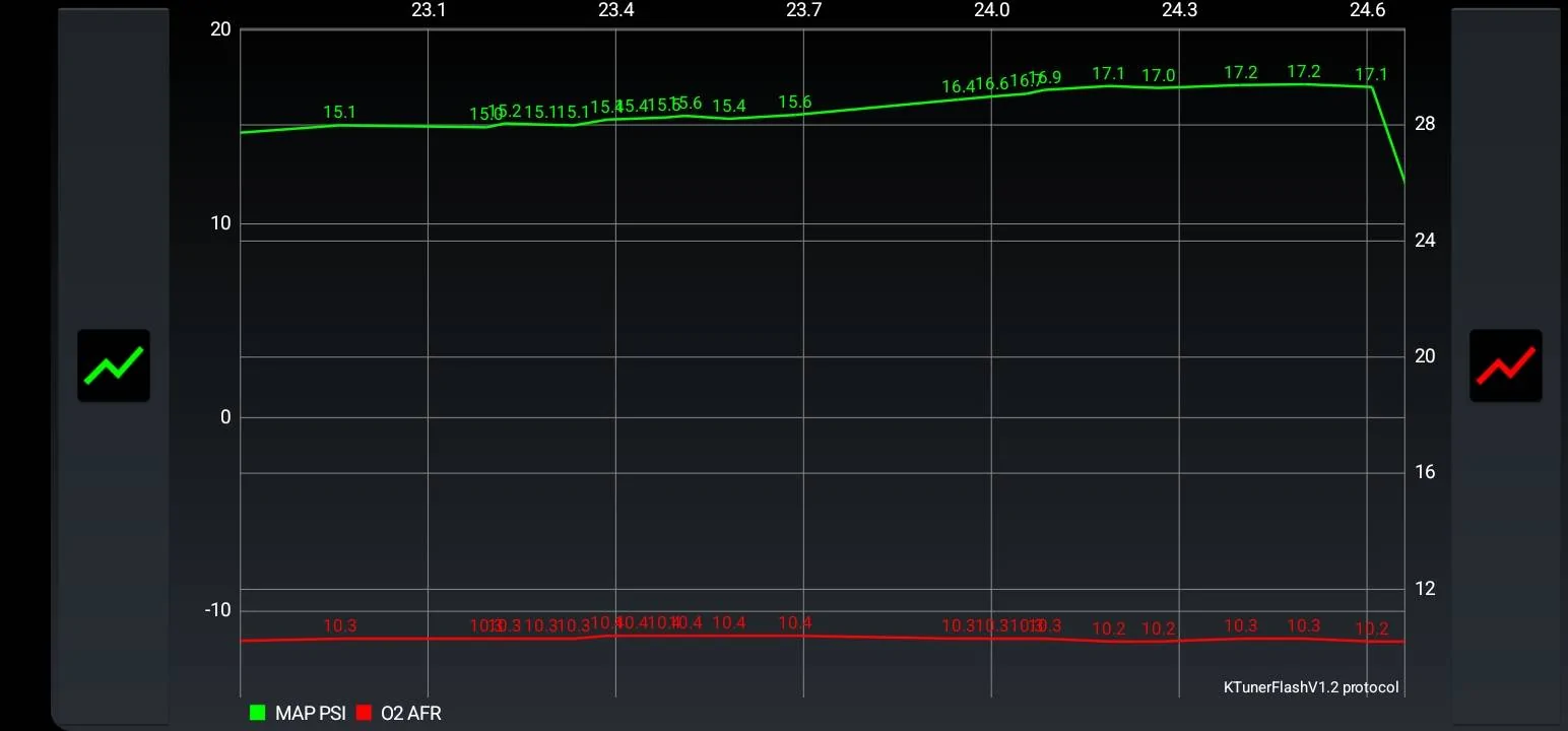

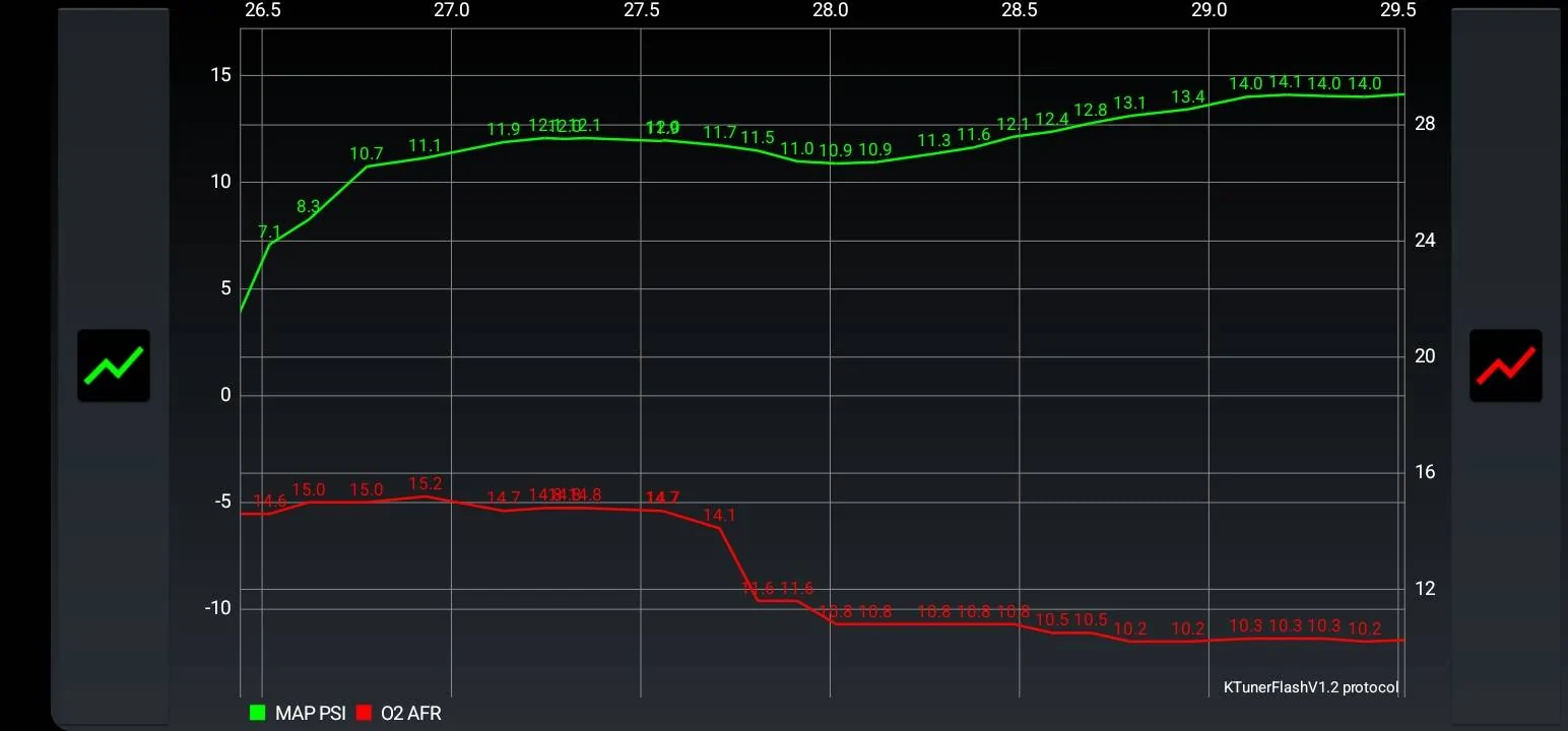

So is it normal for first gear to never trigger the enrichment table, and I mean ever? I'm only asking because then I'll stop doing runs from a dig. It seems like all the other gears are working normally and I'm not sure if it's just that first gear goes by so quick that by time the ecu triggers enrichment I'm already in 2nd.
1st gear

2nd
Acura Integra Ktuner for 2023 Integra is live! Screenshot_20220815-195930_TunerView
3rd
Acura Integra Ktuner for 2023 Integra is live! Screenshot_20220815-200002_TunerView
4th
Acura Integra Ktuner for 2023 Integra is live! Screenshot_20220815-200013_TunerView
As soon as conditions are met it will go into enrichment mode. First gear does go by extremely quickly, so you're likely correct on that notion.

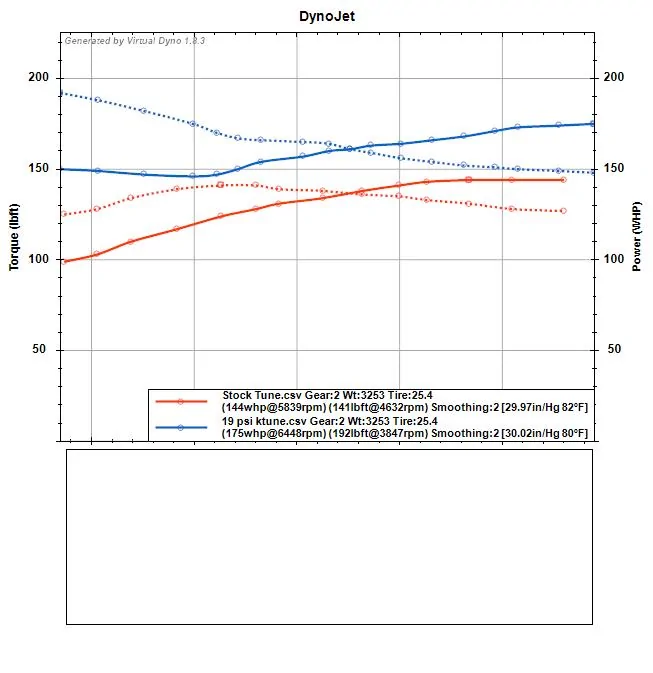

Quick side by side video showing stock run vs ktuner if anybody wanted to see a difference. Same road with similar launch points. You can see the difference in 2nd gear, it pulls harder and boost is higher(obviously) but boost comes on quicker with ktuner.
