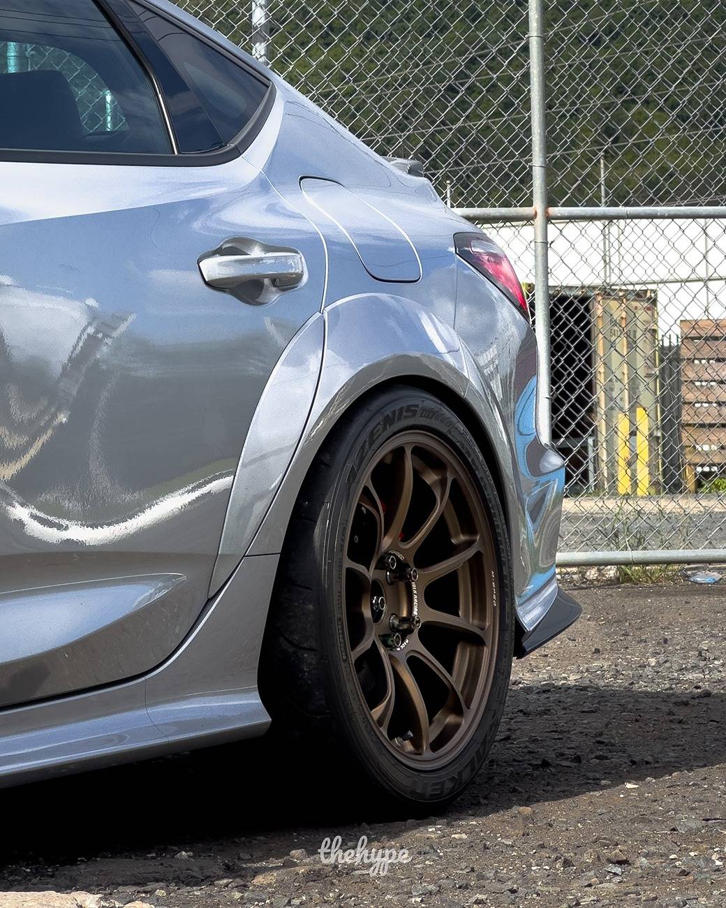

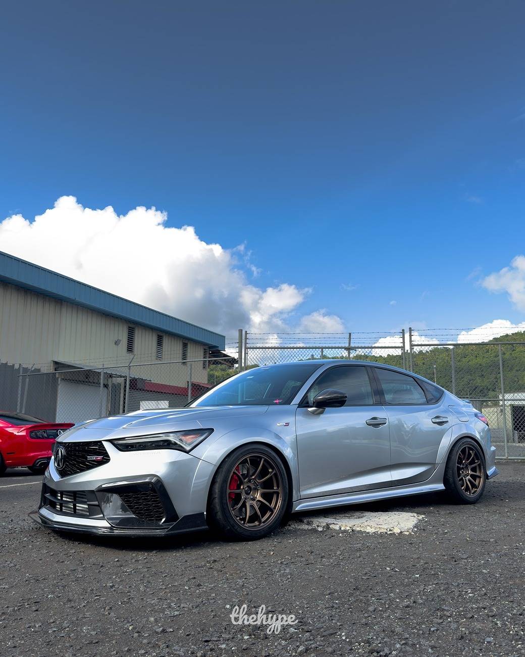

I never updated this post with my wheels to help out .. I ended up getting apex vs5rs 19x10.5 +45 and tires conti 285/30/19 no rubbing lowered on H&R ..out mot of pics so you can see different angles hope this helps someone
