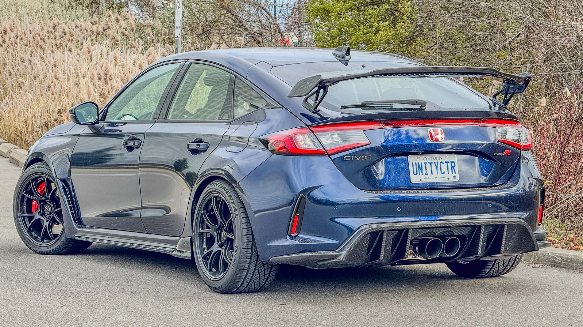

Nice to see it can fit, and we have even more room in the fender than the civic sisters. I'll have to stick to a 275 for classing, but most super 200 275s measure as wide or wider than 300tw 285s...
That type r needs a splitter and a fence with that much front poke to match the aero of that wing, though😅

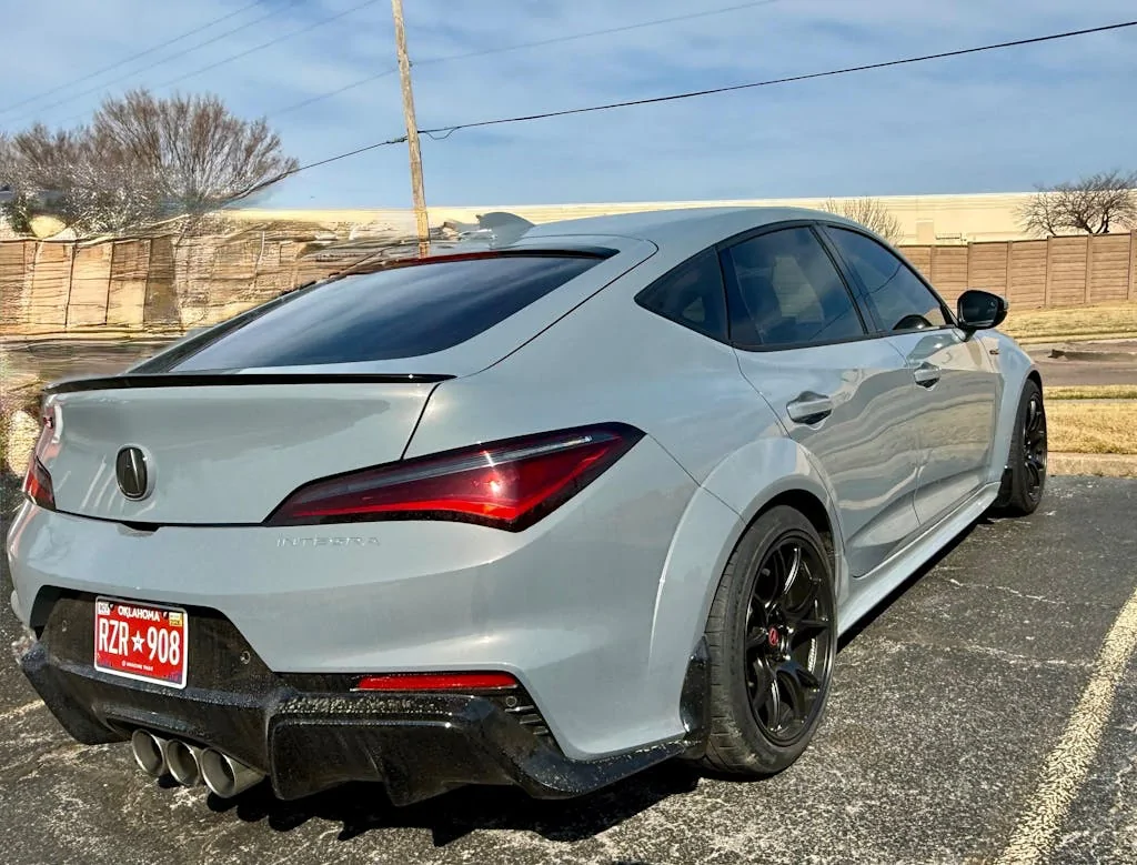

Just received these pictures back from our customer, he took my advice on the 18x10.5 +47 size for his 76RR, and ordered two sets simultaneously.
This current winter setup will run 275/35 Conti DWS06+, and the summer setup will have 275/35 Conti ECS 02. Lots of space for more tire

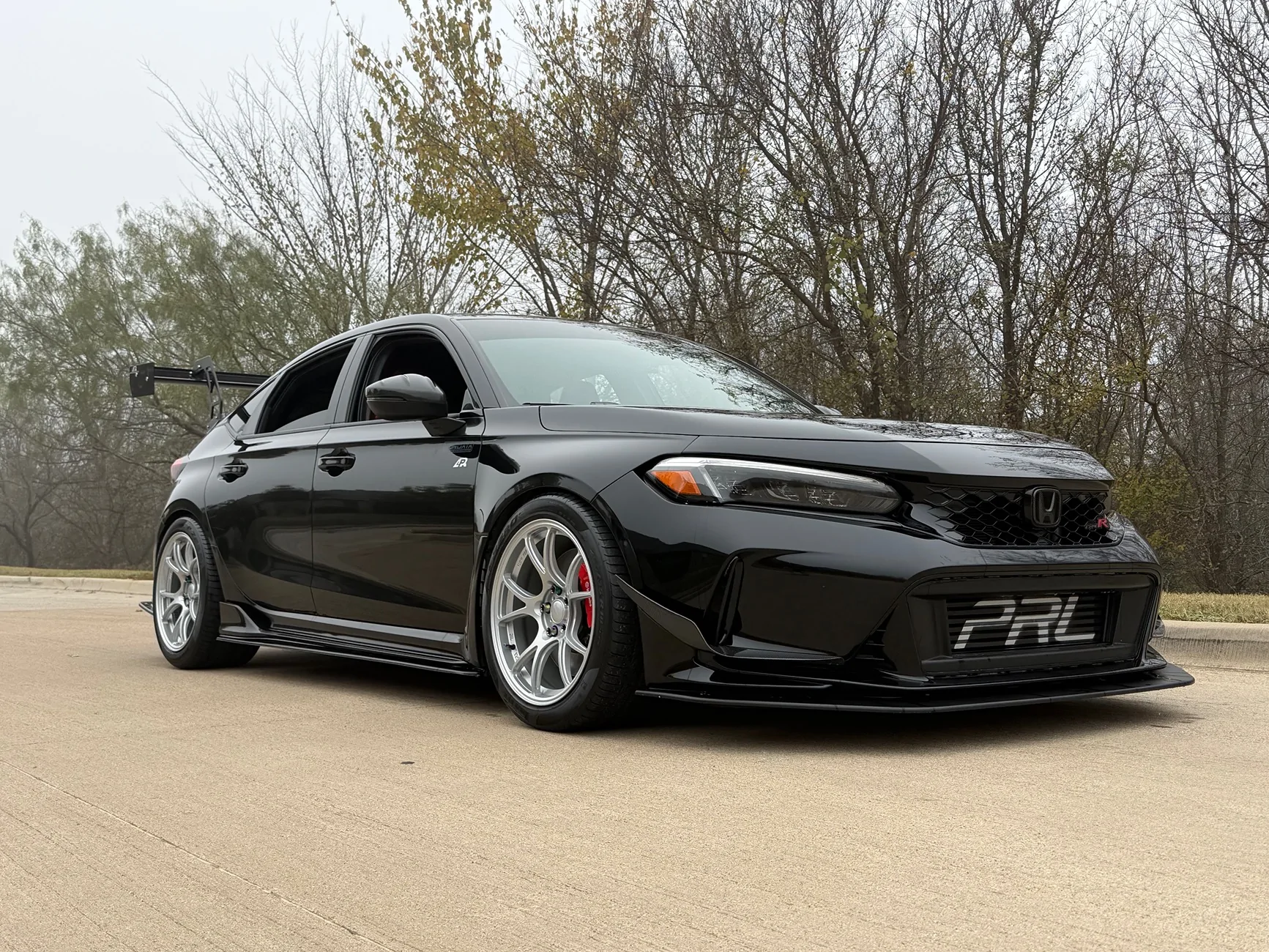

My FK8 was the original demo car for these, and since that car sold, my set of 76RR now lives on the FL5
18x10.5 +47 with 285/35 Conti DWS06+. Lowered on H&R’s currently, and also confirmed no rub with the more aggressive Swift Springs.
295/30 is doable as-is, and with Coilovers 305/30 is possible if someone wants to go crazy
