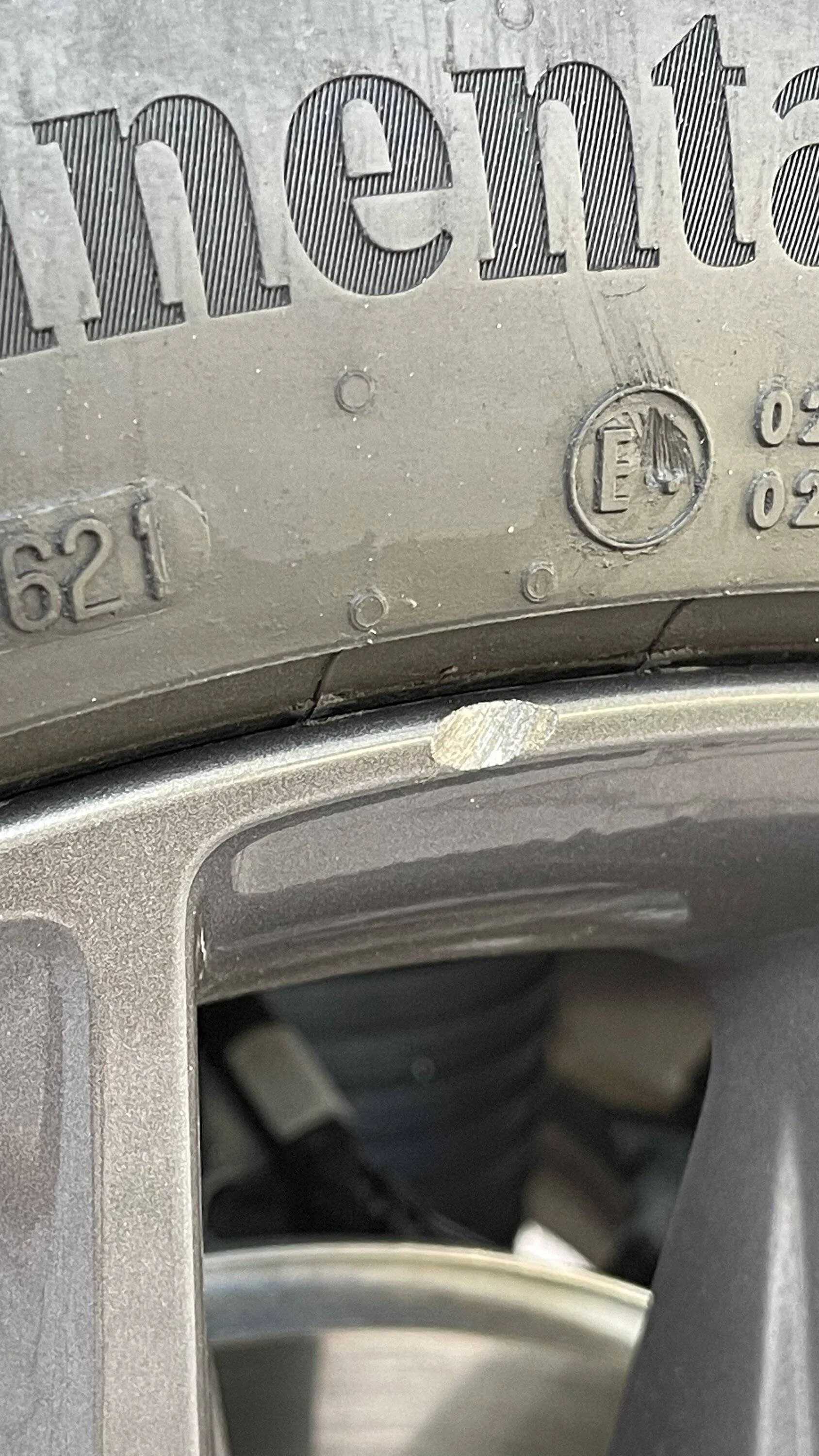

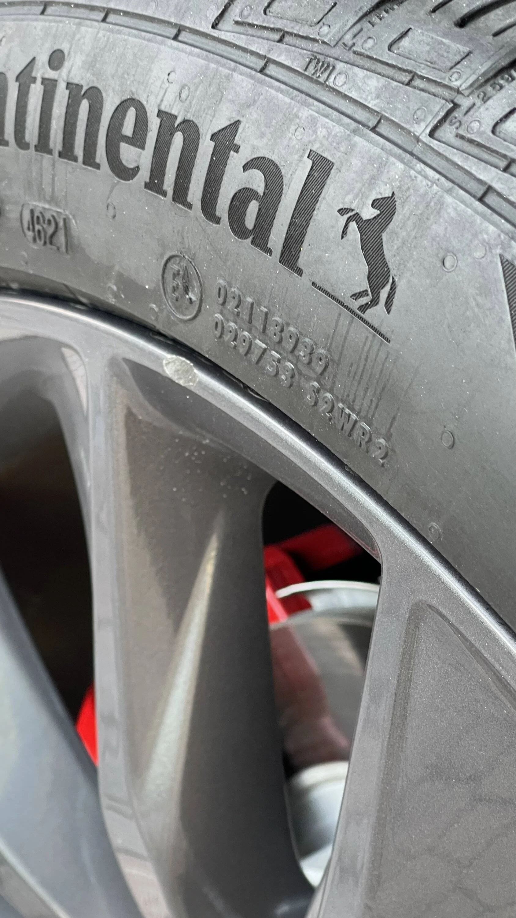

Would anyone happen to know the paint code for the shark gray wheels, or something that would match fairly well? Trying to fix a little spot of curb rash :confused:

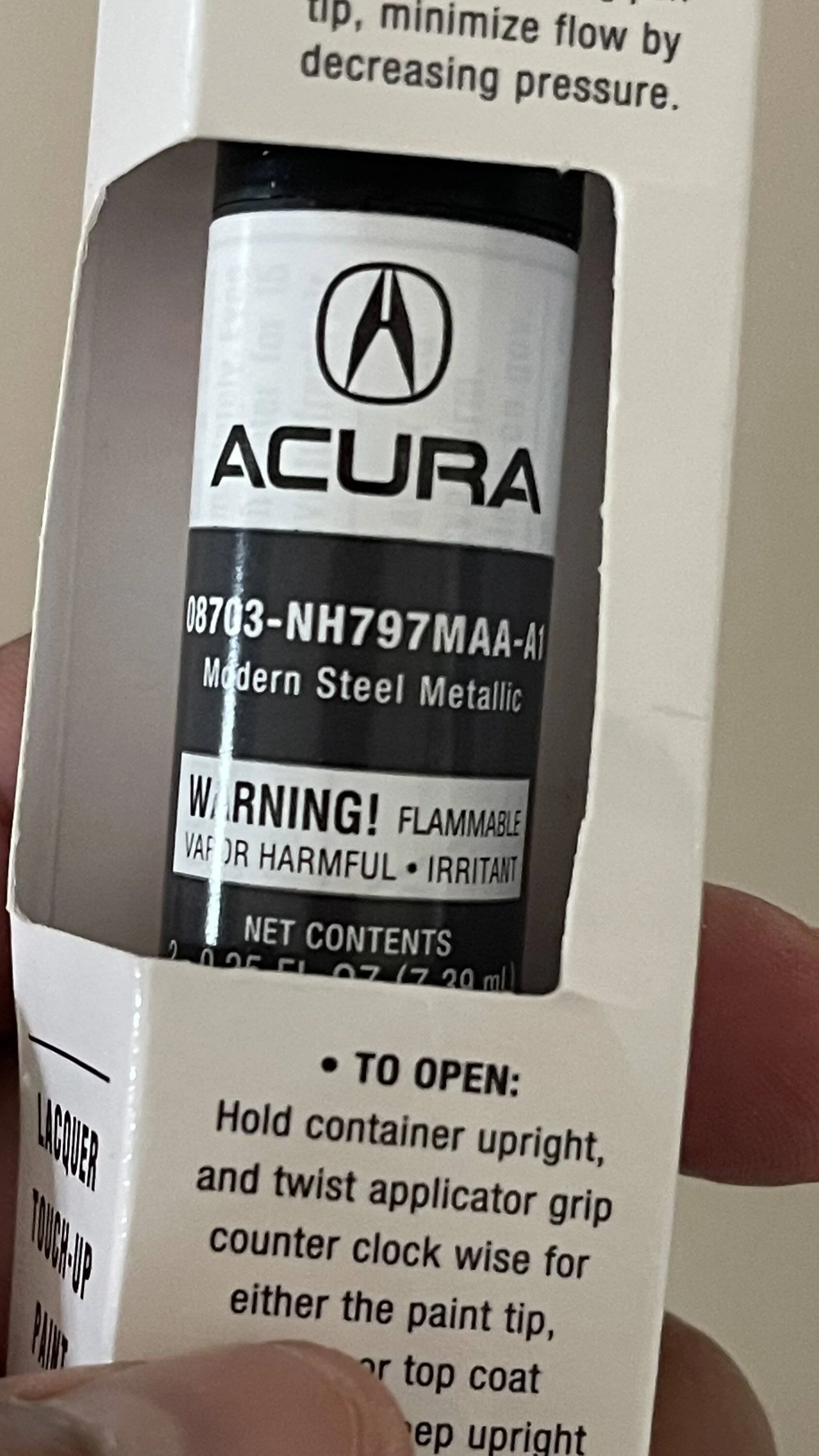

My wife nicked the wheel on her MDX Type-S with shark grey wheels. We got some OEM Acura touch up paint in the Modern Steel Metallic, and it matched pretty well. The guy at the dealer said they don’t have anything specific for the wheels, but that’s the best match they have to offer.
Part #:
08703-NH797MAA-A1

I scraped a wheel on a very tight corner in my Integra a couple weeks ago - I had to get between the curb and a police motorcycle. The good news is I didn't hit the motorcycle. I found this thread and bought the modern steel metallic touch-up paint. I ended up with the honda part (08703-NH797MAH-A1) but it's the same paint code NH797M.
I just applied it. Looks to be a pretty good match for the shark gray wheels on the A-Spec, and for $20 I can't complain.
