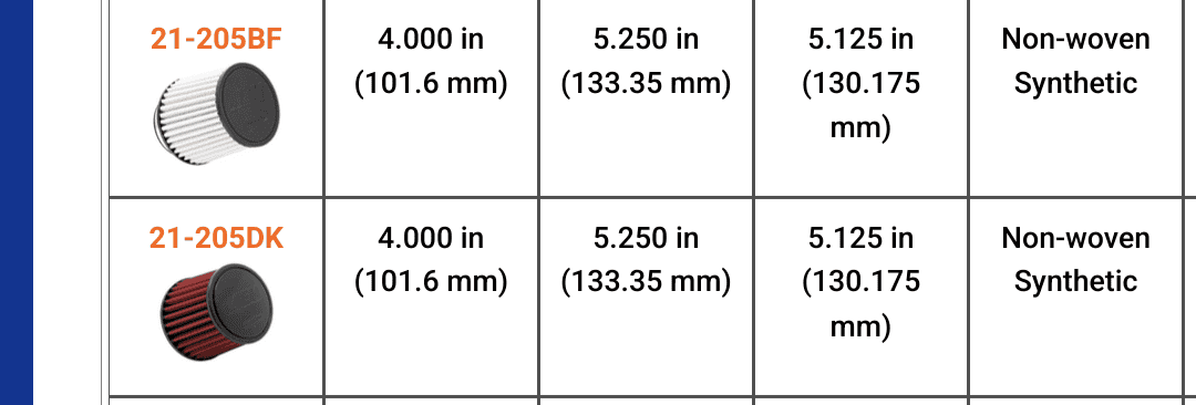

Hi. Can you confirm what the largest cone filter dimension that would be compatible with this intake?
Would one of these below fit?
Those 2 have a 6” base. The Injen one is 5.5”. Closer to the included filters size.
