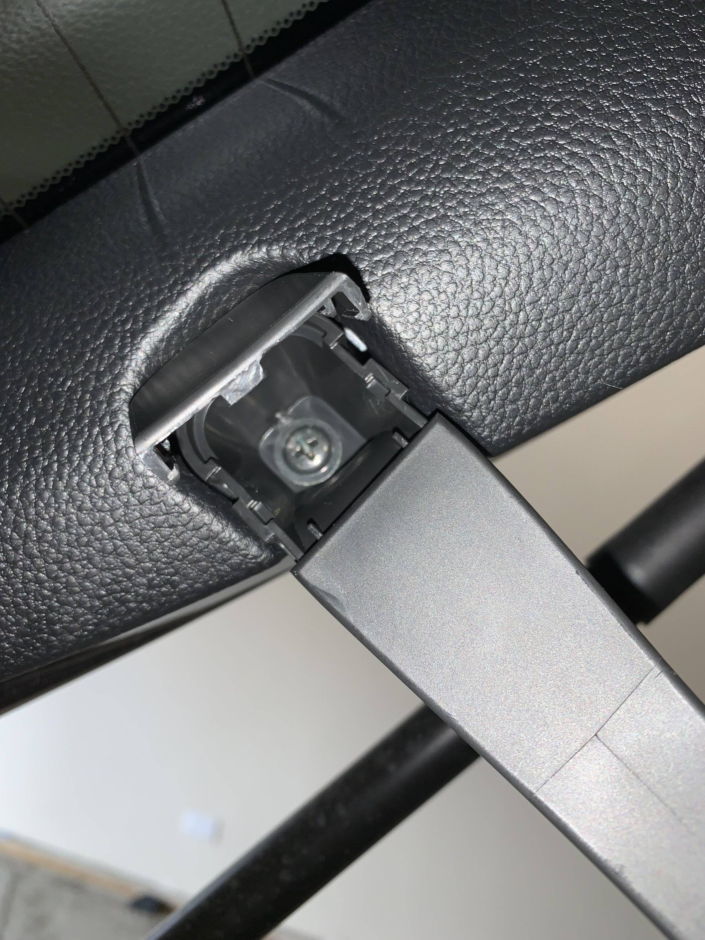

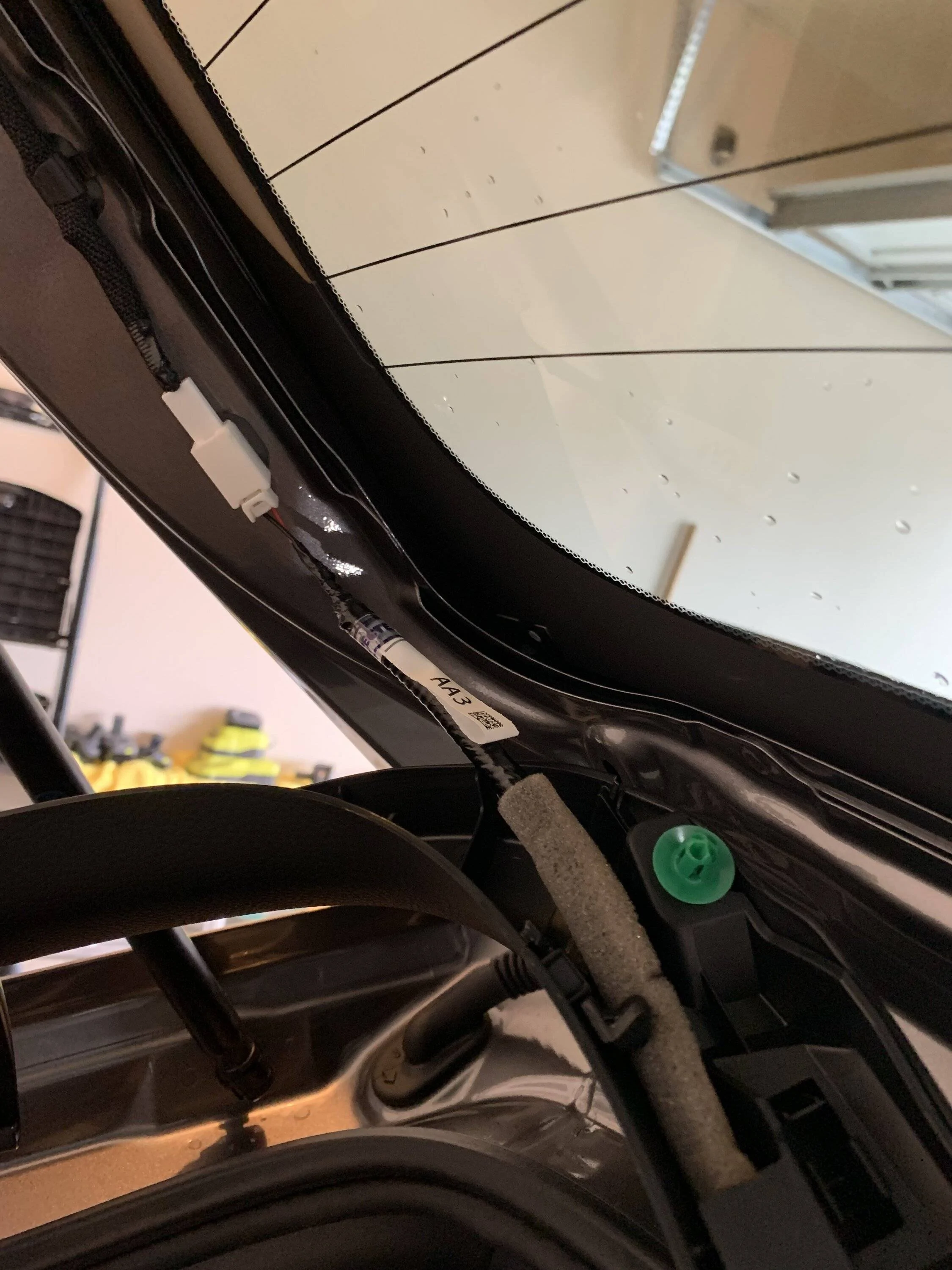

You should prep by removing the rear trunk liner. It's held in by 2 screws behind the cargo cover bracket, rest of it is held in by clips so pull gently. To get to those 2 screws, they'll be under a little door where your cargo cover bracket is located (trim removal tool is recommended here). Chances are all 3 pieces pop out in one big piece so be careful of the wire hooked onto the plastic that I showed in the pictures (the 3rd picture with the grey insulation)

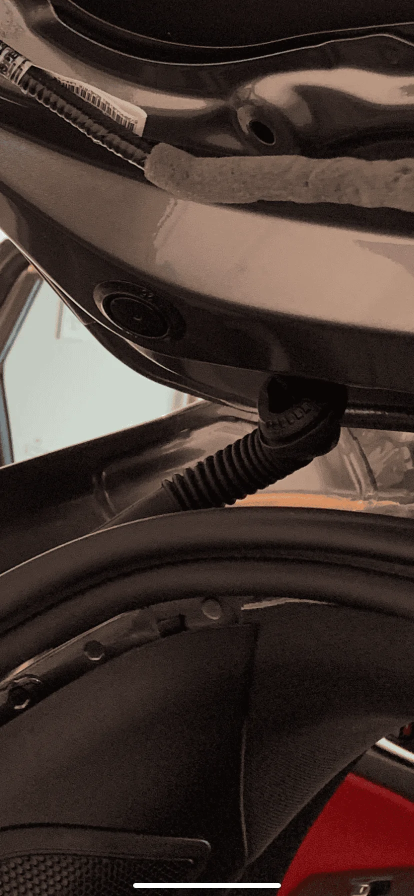

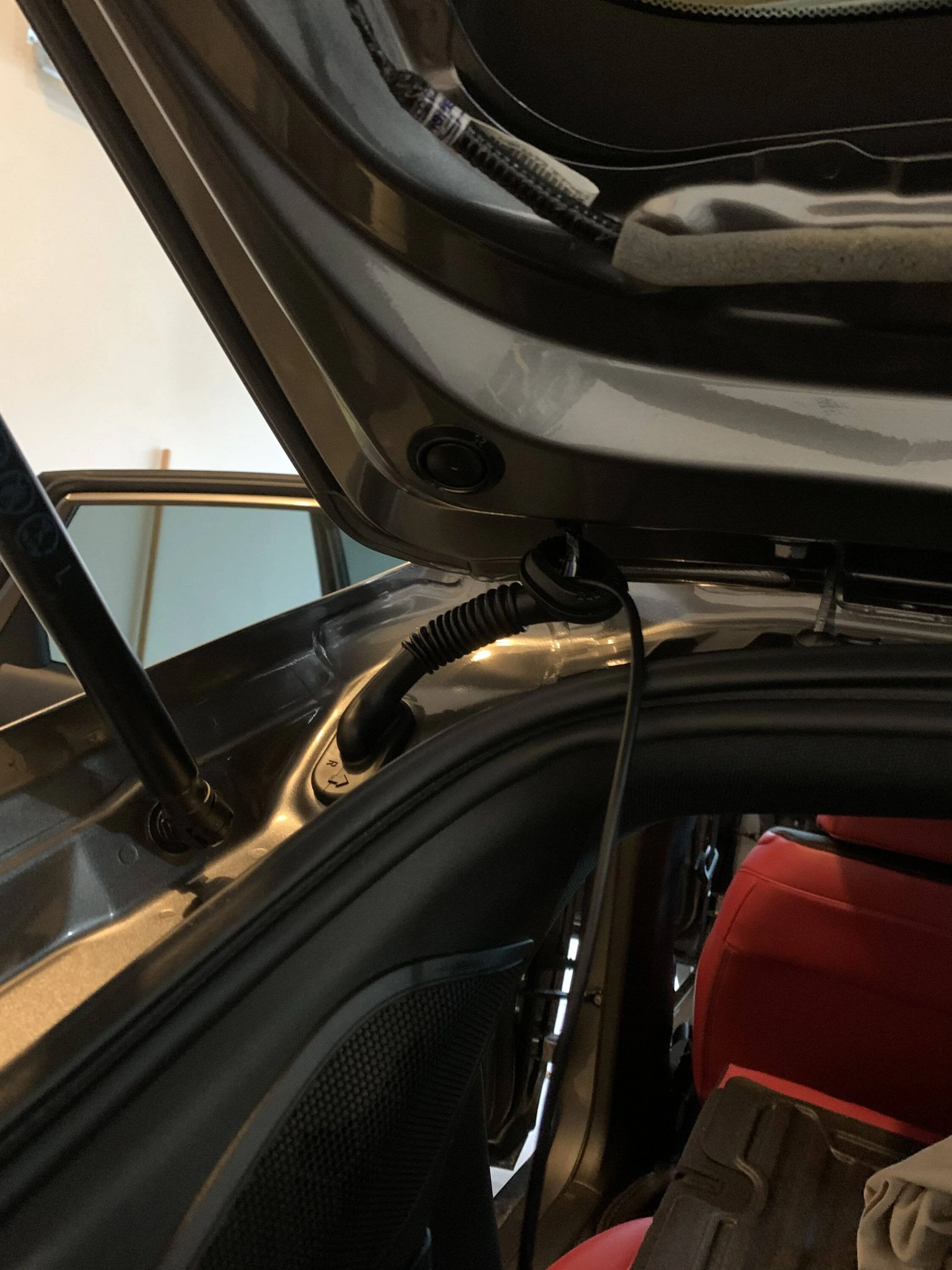

Next, assuming you've got your wire routed to the rear, locate the rubber grommet on the driver side and lift up both top and bottom.

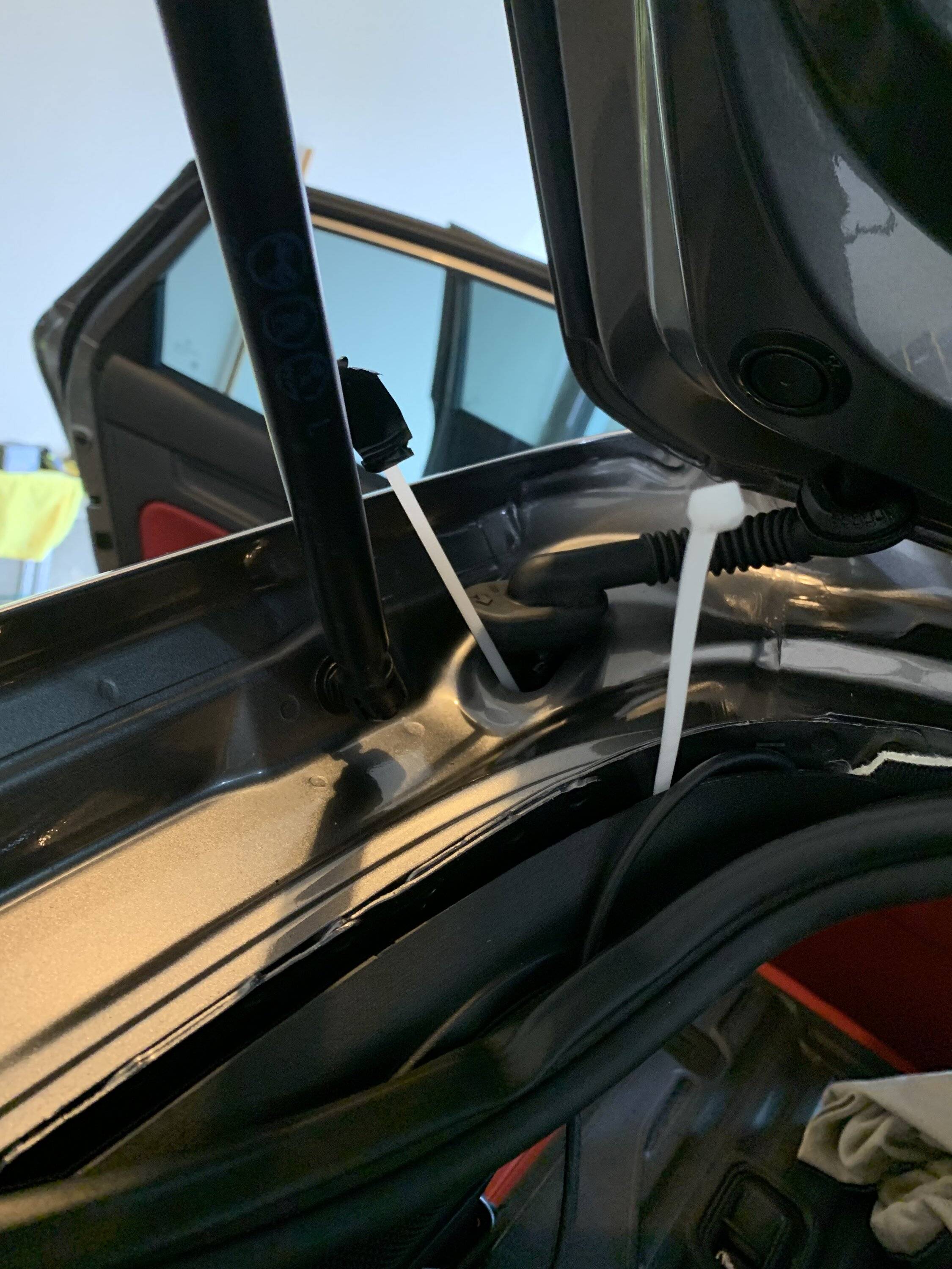

Now with a zip tie, from the interior out, slide it in and through to the other side. This may take a bit of time if you have short or wide fingers as it was a tight fit. I ended up getting some tape on the end for me to try and grab or grip onto for a little extra leverage.
Acura Integra Rear Dashcam Install on 23+ Integra (DE4/DE5) 2921904B-6D59-4F70-ABFA-B4FD256E8E66
After you managed to fish the other side of the zip tie out...get some more tape and stick it onto the end of the rear cam cable with the zip tie and feed it through.
Now, use a zip tie only and feed or slide it through the rubber grommet. After you manage to get the zip tie to the other size, wrap up a few inches of the end of the dashcam cable tightly with the end of the zip tie (make sure your cable isn't looped around the hatch struts) and I HIGH RECOMMEND using or applying some type of lubracant on the tape that you put over the cable before you attempt to pull it through to the other side. You'll save quite a bunch of time!
I initially fed it through the rubber grommet without any lube and it took ages as it was very difficult (lots of triction) to pull through which led to the zip tie pulling off from the cable. I tried to see if I could somehow grab it or pull it again since it was 95% through but I couldn't so I pulled the cable back out (which took a bit of time), used some grease over the tape that's over the cable and it went through like butter. I couldn't believe it.

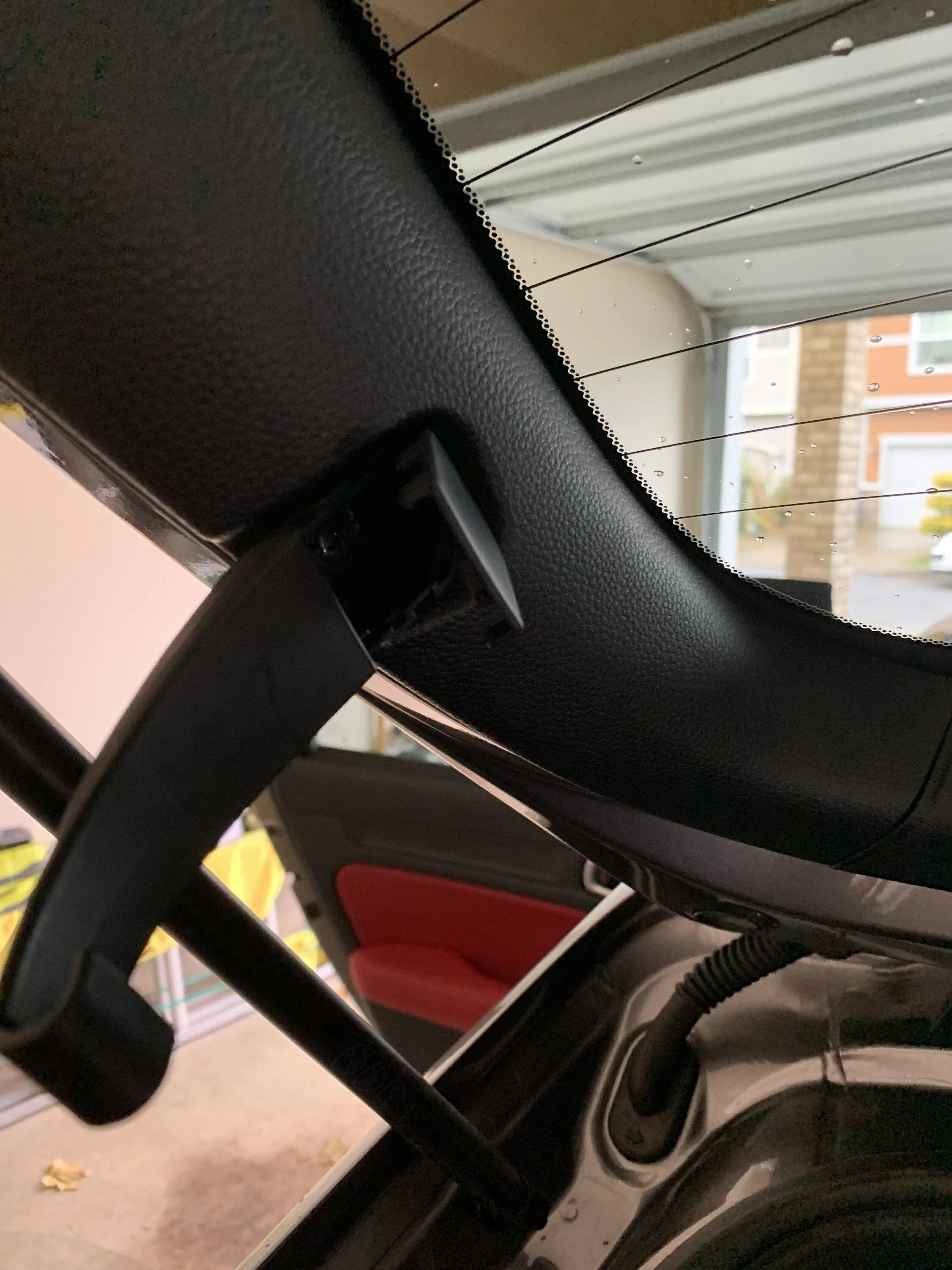

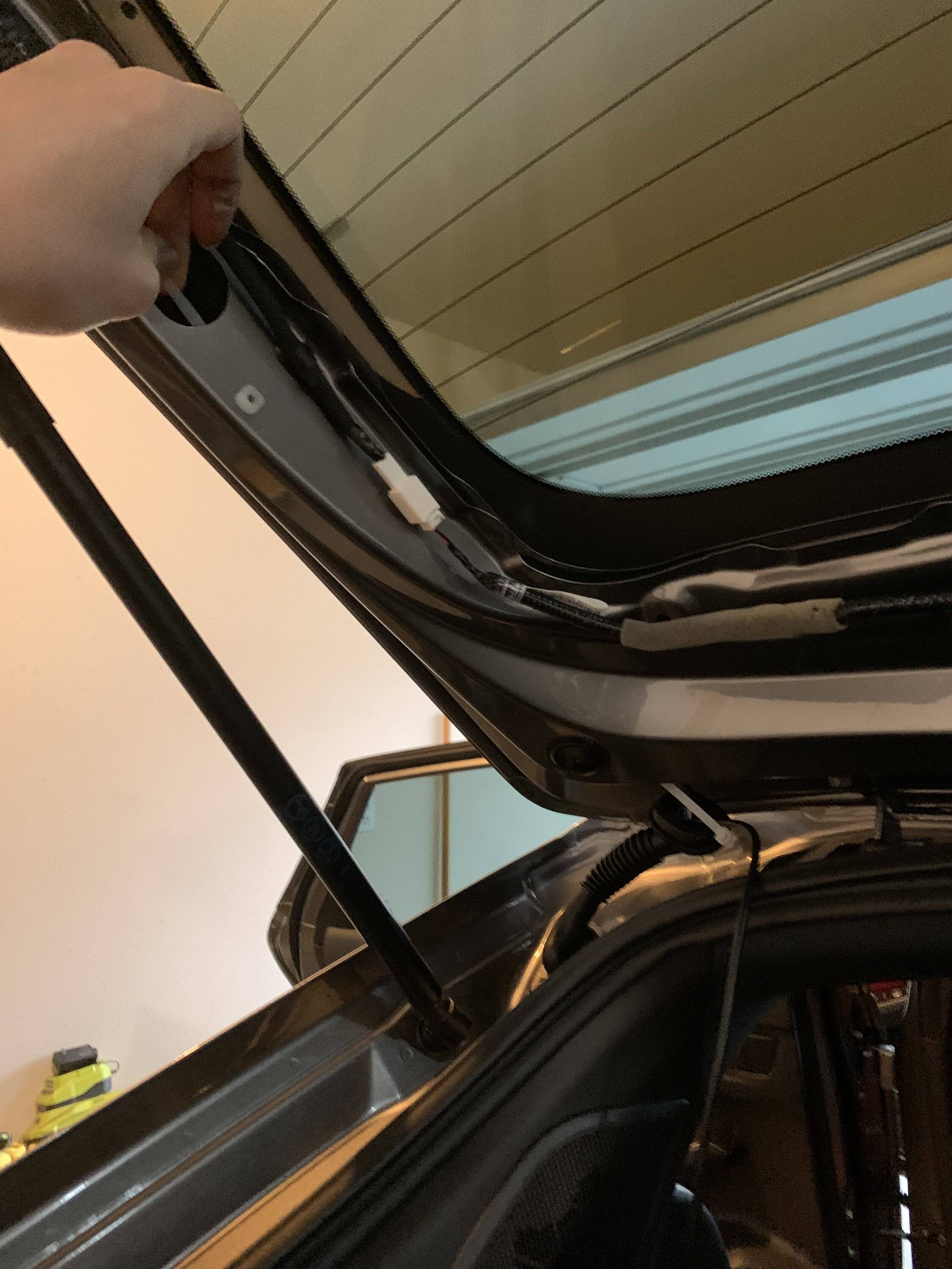

After you get the cable through the rubber grommet you'll have to fish and feed the wire up the hatch since that's the closest access hole.
Acura Integra Rear Dashcam Install on 23+ Integra (DE4/DE5) F2999890-FB19-46B4-B942-805BA4B70B39
Then you can route the wire to the rear windshield. I had a bit of wire left so I just tucked it into the hatch. You can use zip ties for a cleaner install but I was about done that day so I opted not to.

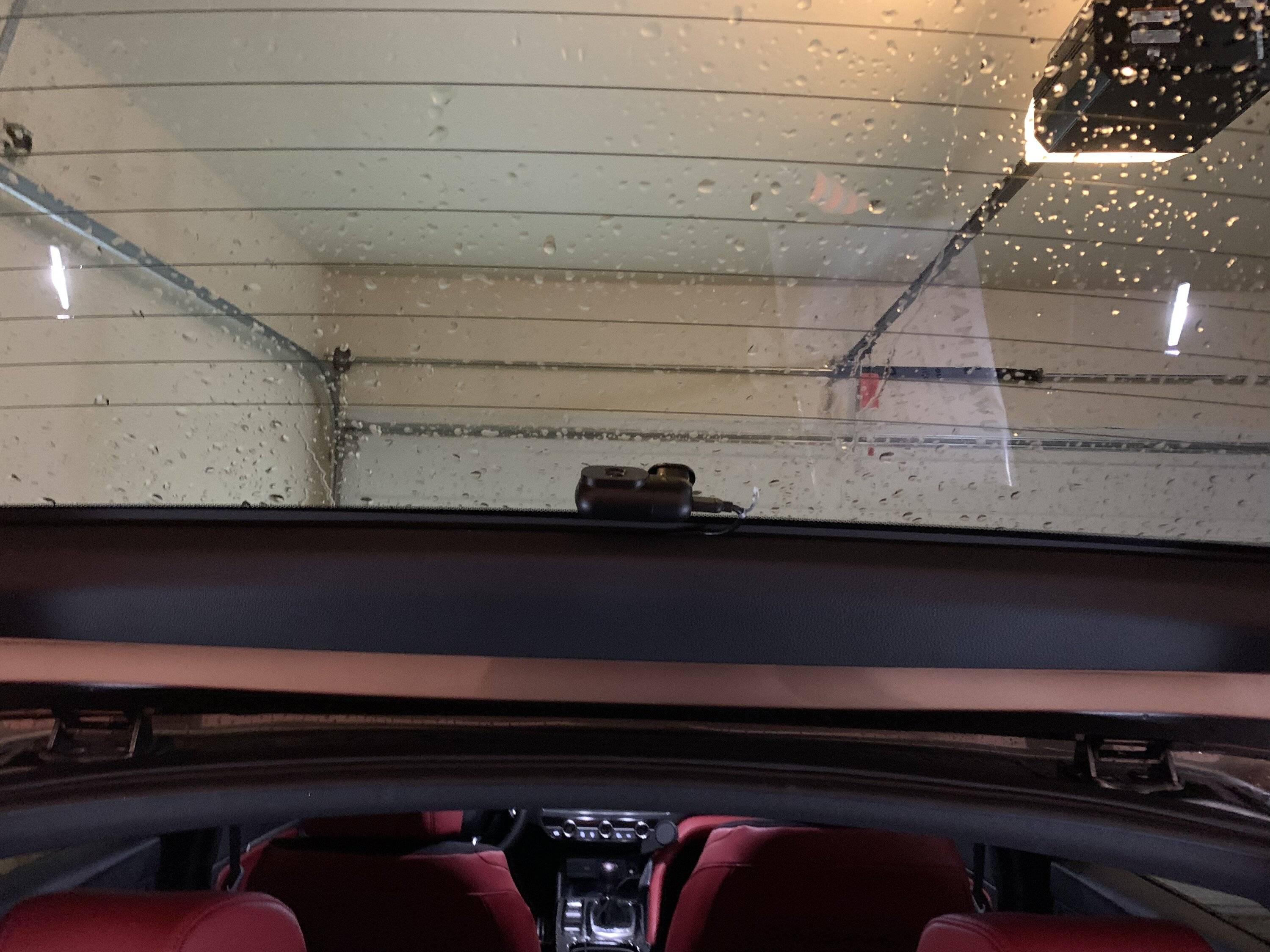

Re attach the trunk cover and 2 screws, mount the cam and you're done.

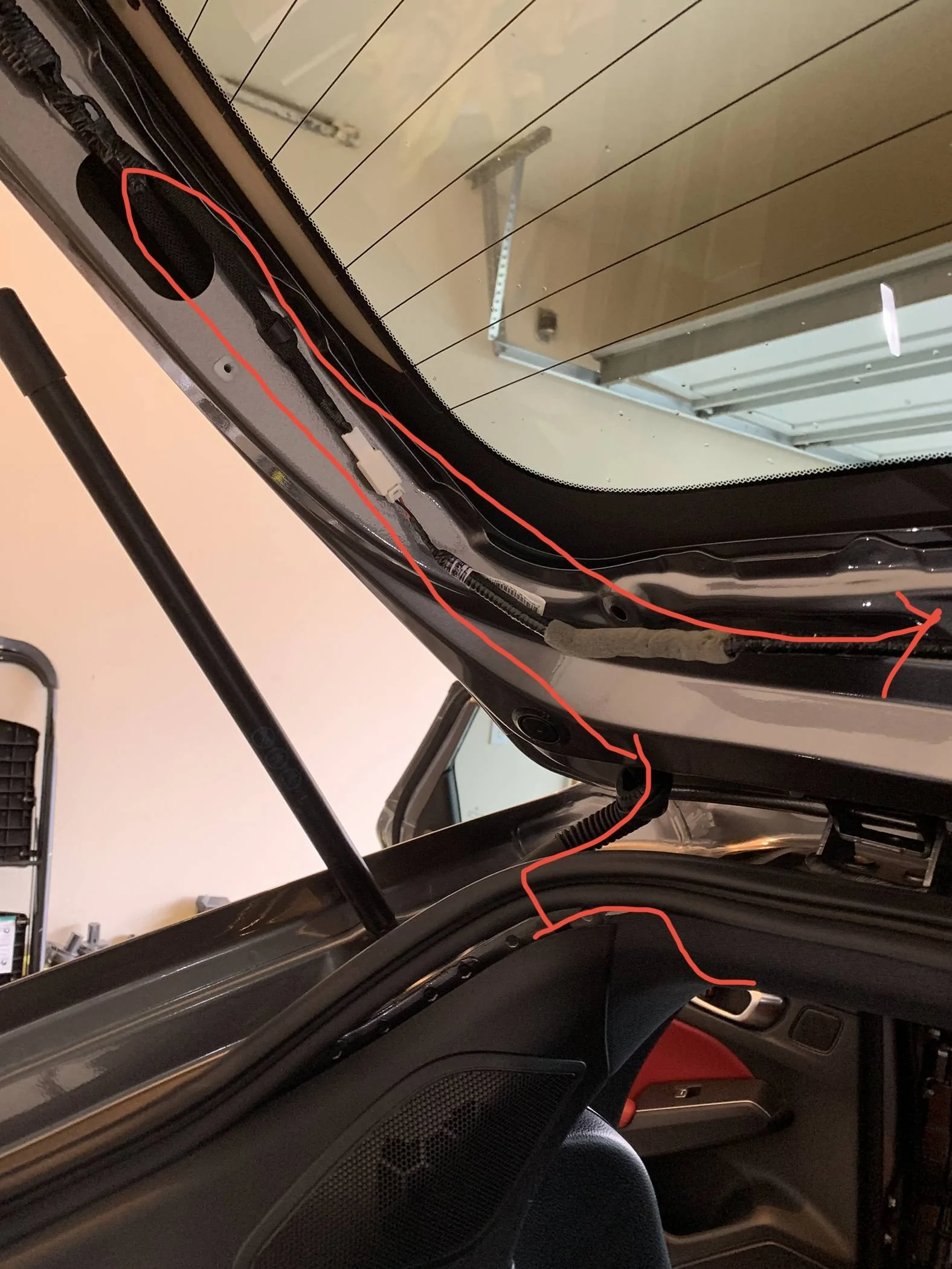

For reference, this is the route I took to wire up the rear camera.
Acura Integra Rear Dashcam Install on 23+ Integra (DE4/DE5) 444FAF46-1CF8-4856-B272-3E445AB948EC
90% of the wiring route is easy since it's just tucking into the A/B/C pillars and behind the weather stripping.

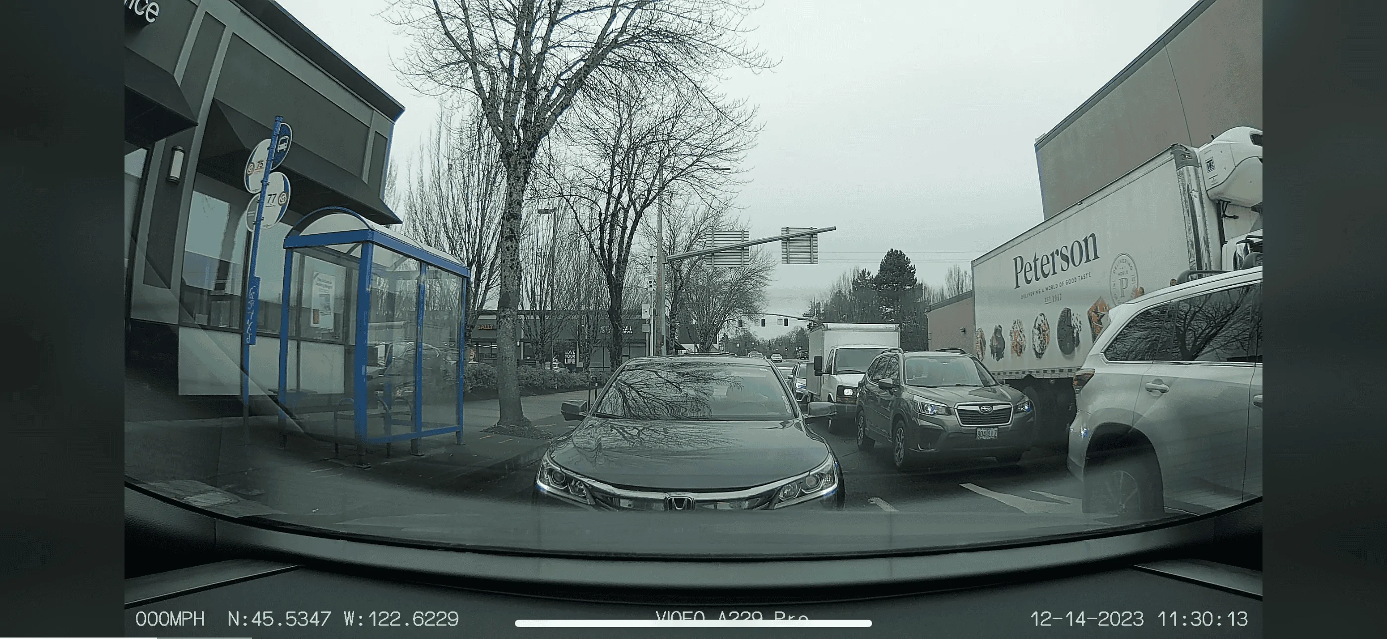

Nice guide. What camera kit are you using, and how is the image quality from that location?

Finally remembered to get some footage. Here's a screenshot of how it looks out the rear with 20% tint
