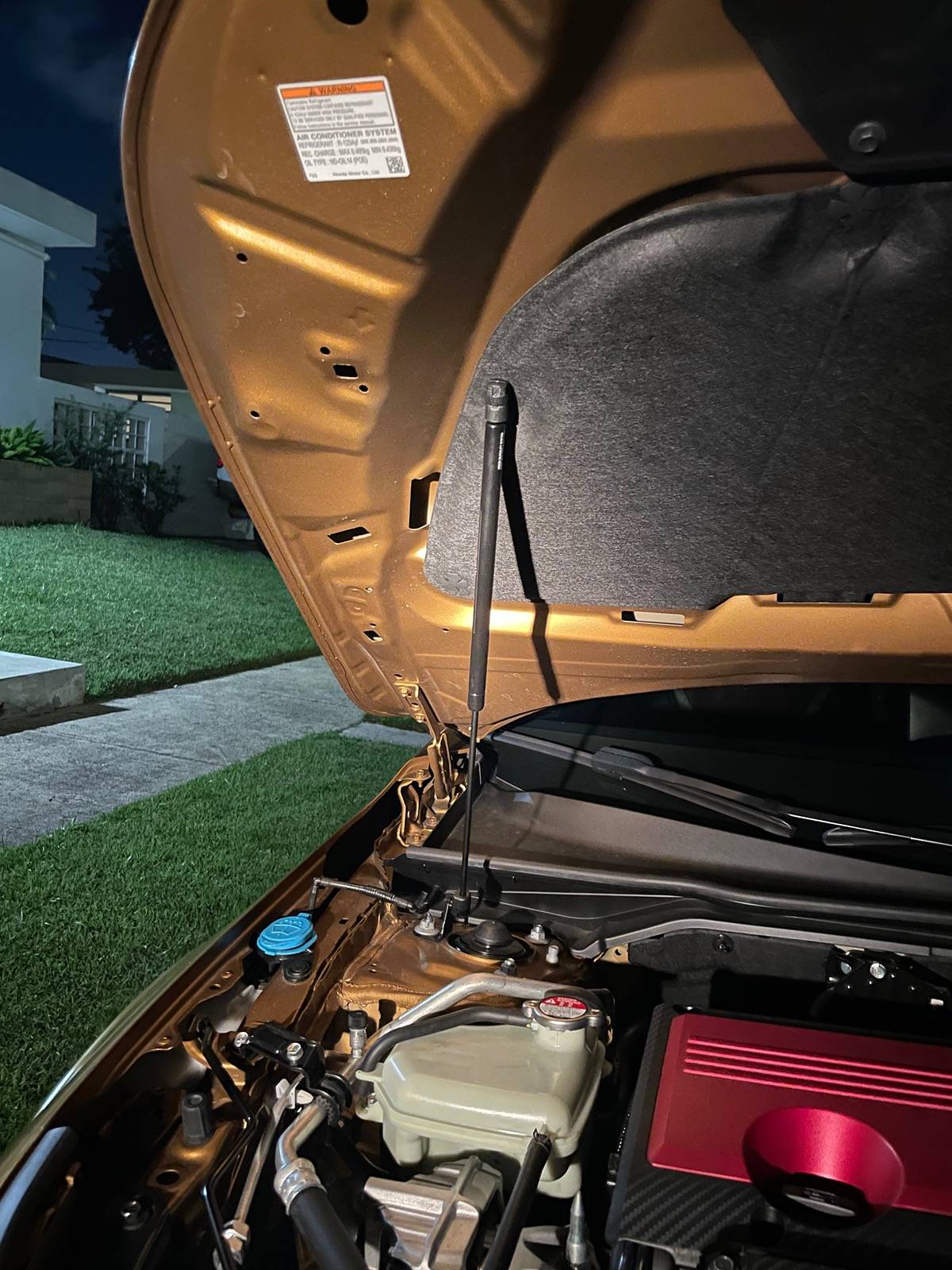

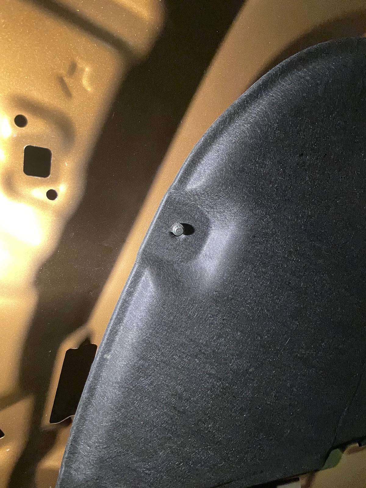

Hello Guys:
I have a Type S and found a work around. Look at my picts. Took off the upper left and right plastic rivets that hold the hood insulation and used the same hole to put the hood screw insert and washer. You have to put some pressure to "make" the screw thread. Don't over tight.
Regards.
