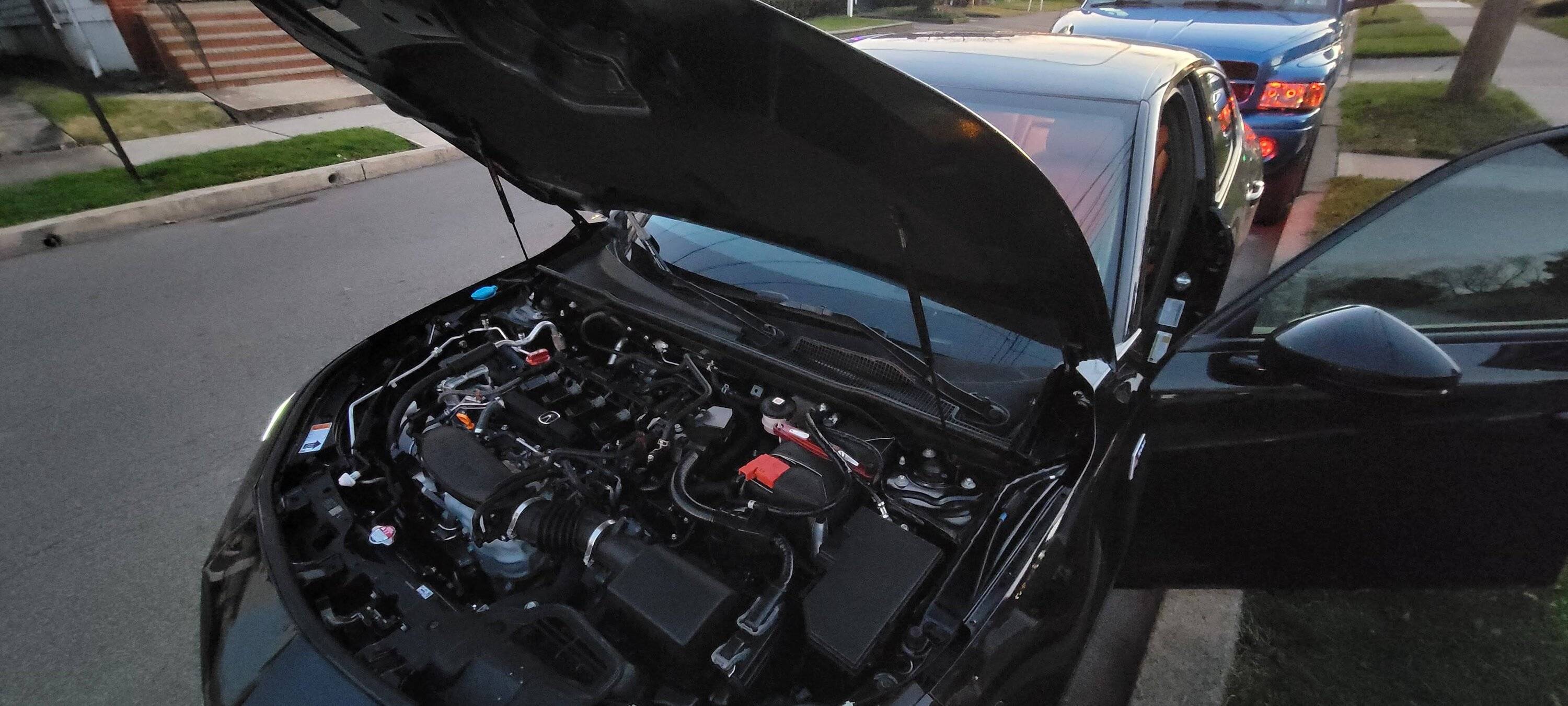

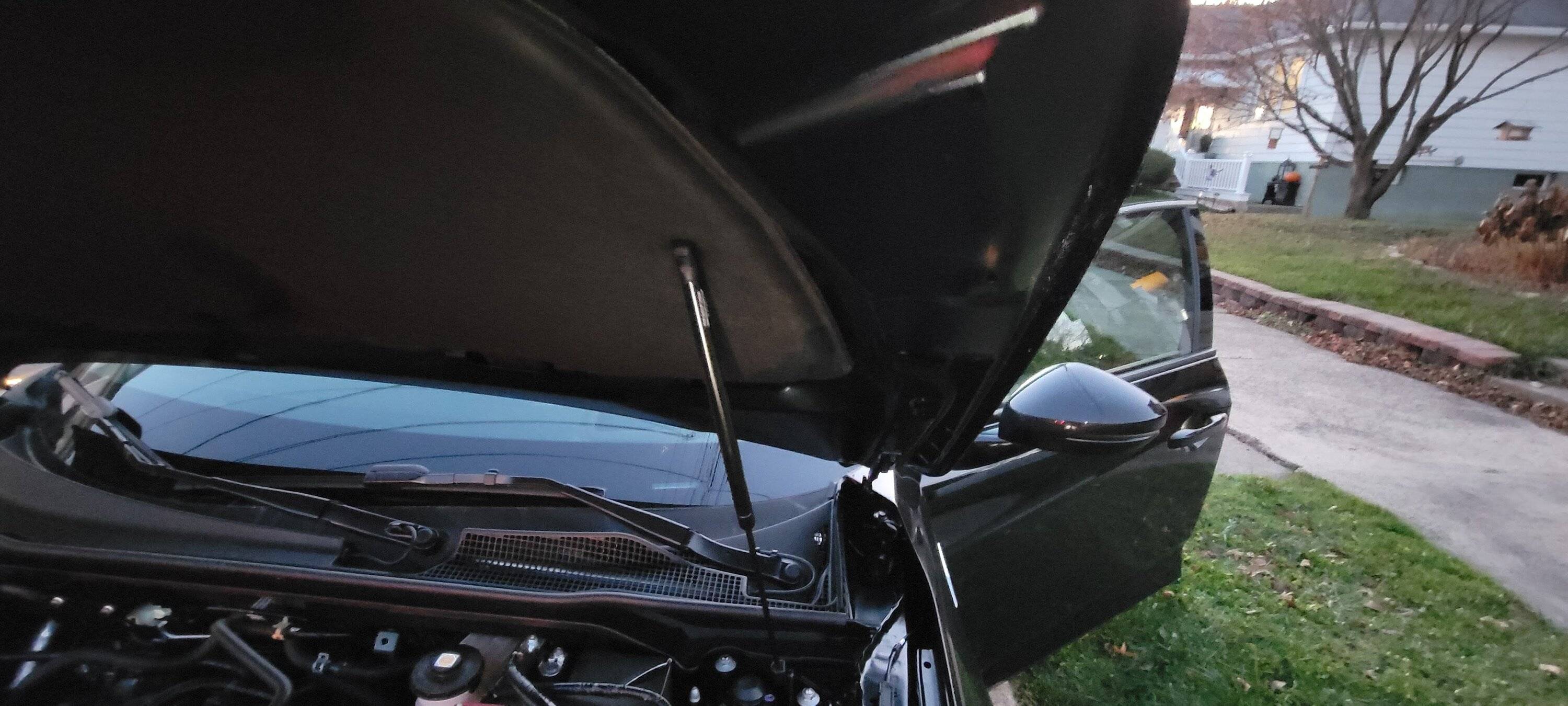

Thanks. I’ve seen other aftermarket hood struts but they all use some sort fishing line for that blind nut on the 11th green Civic. Redline’s solution for the blind nut in the hood is so much better imo.
I know many people hate the factory hood prop but that high service position is great when working in the engine bay. That’s the only thing preventing me from installing these.
They're solid. Also had them on previous vehicles. Gravity won't close the hood. You'll need to push on center hood to close.

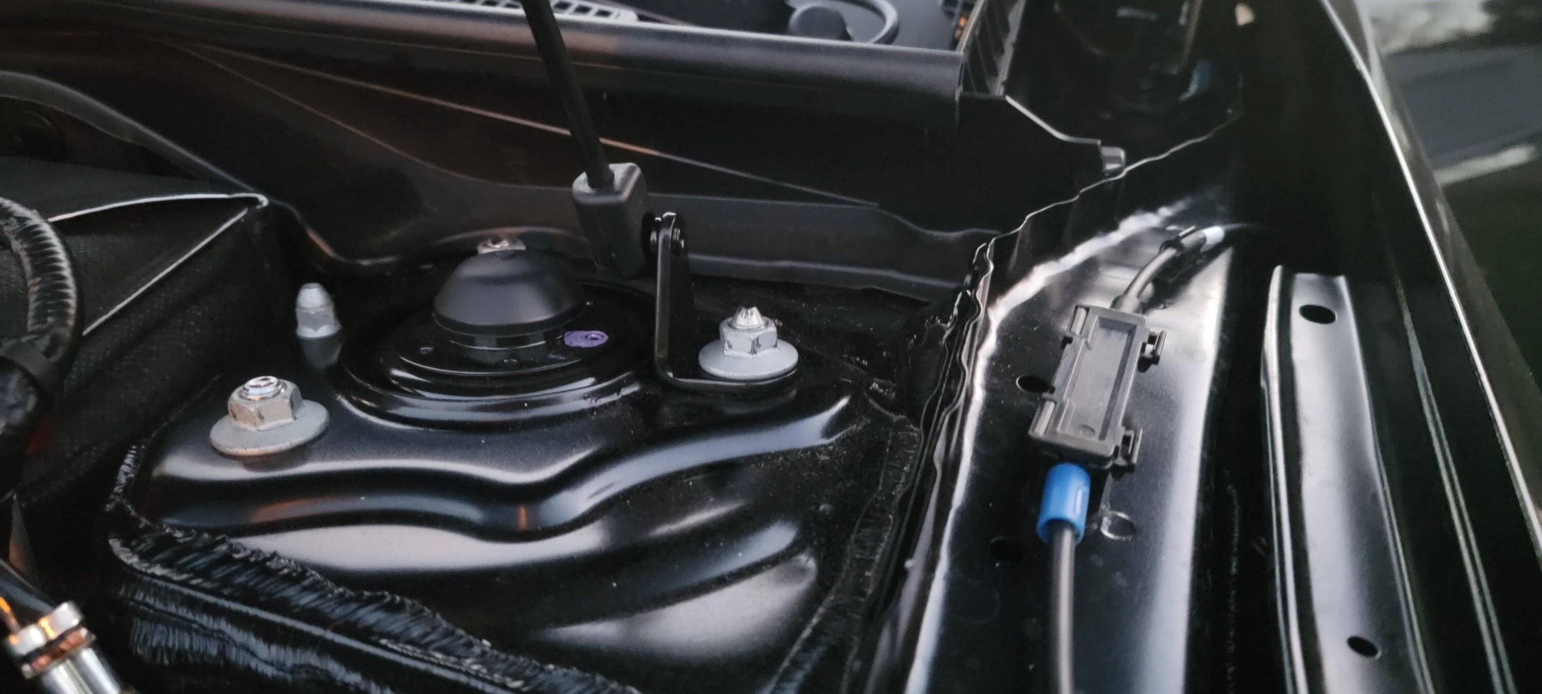

I assume this would prevent you from adding a front strut tower bar? Can anyone confirm?

Yes, I don't think the strut tower bolts would be long enough. Typically want to catch 3 threads as a good practice.

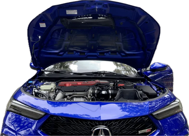

Thanks. This is what the underside of the Type S hood looks like, unless I am mistaken there is no slot that matches what the Civic instructions show.
I could be tempted to try to make it work with one of the other slots although i worry about bending the rod or deforming the hood if it turns out this puts the rod at the incorrect length once compressed.
Your install was on a non S integra, right? Or did your hood look the same as this?

I have a non-S Integra. Underside of hood is stamped totally different. The slots I see in your snippet are way too far in towards the center of the hood for these to work.

Thanks, I had figured as much but figured the picture would confirm. Great upgrade for the non-S cars though.
The mechanic who installed my PRL Throwback strut tower bar was concerned about the short length of the bolts on the strut towers, so adding this would give me fewer threads and I will have to pass on these….I had them installed on my other vehicles and they are great.
