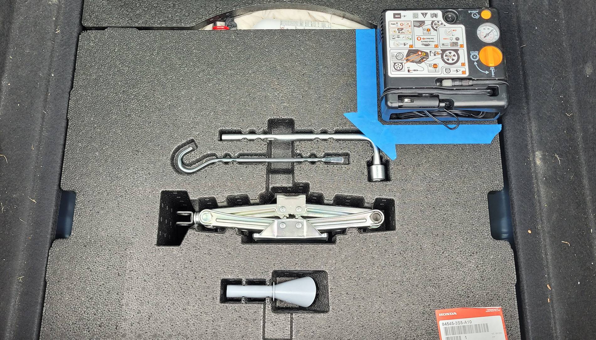

It turns out that I could cut out the corner of the foam that goes above the spare and the fix-a-flat fits there nicely.
So, as I was getting in the back to vacuum my car out, I decided to go ahead and make a spot for the pump.

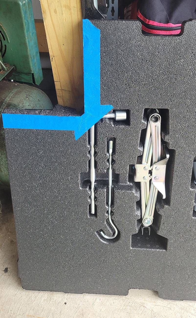

First I marked off where I wanted the kit to go.

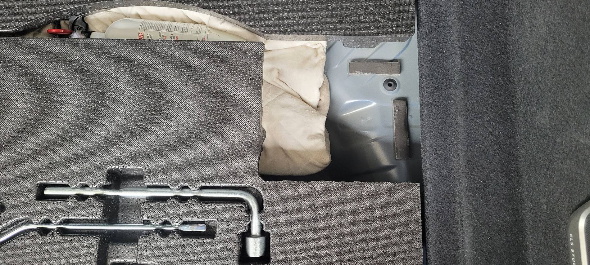

Then, I cut out the space with a hot wire knife.

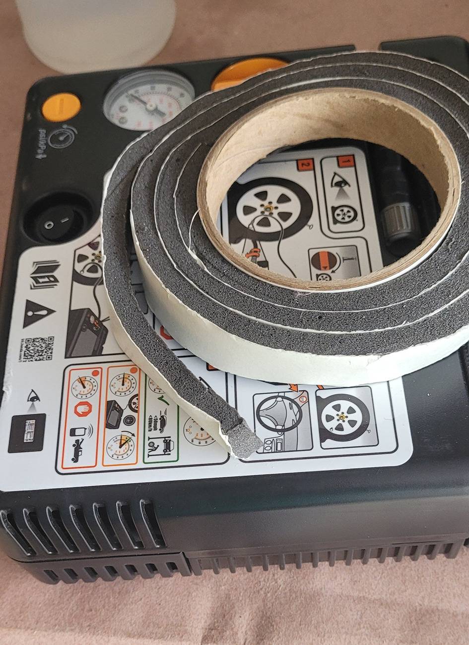

Next I used some weather-strip foam I had laying around to create a buffer so the kit won't rub.

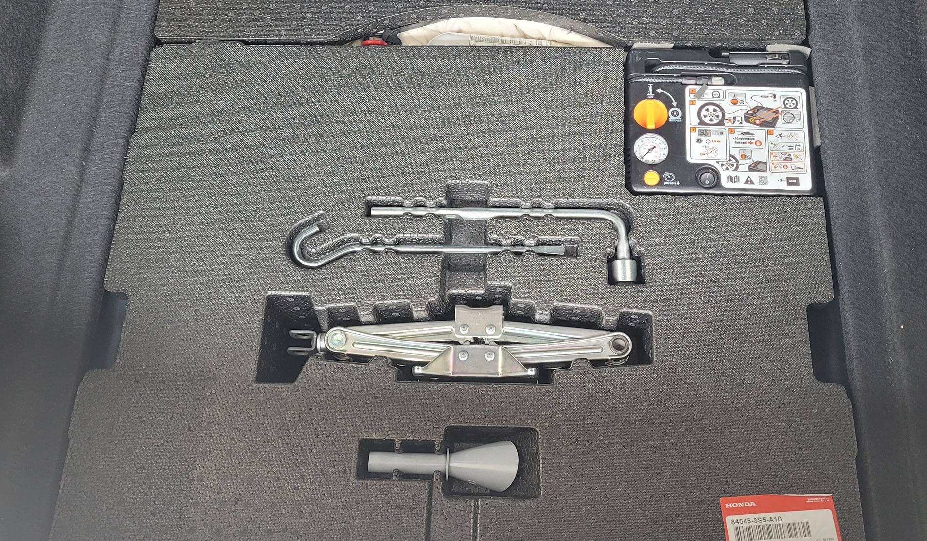

You can see the foam I put beneath the kit in the picture above and the foam on the sides and the kit in the picture below.
The floor lays perfectly flat and now I don't have the kit bouncing around in the back. Yay!
