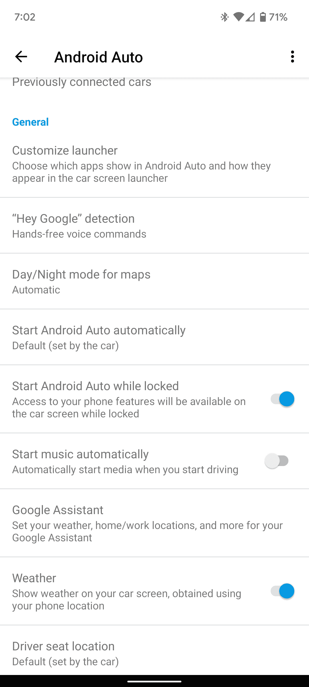

I did find this option in the Android auto settings..
Acura Integra Unlock phone with HandsFreeLink Screenshot_20220629-070213
I was not aware of this setting, but I haven't had an android auto compatible stereo for over a year now ... I always used smart lock so that it would unlock itself in the car, but if someone else is in the car with me I'd prefer my phone remain locked while using android auto
Unrelated, getting an iPhone since I've got an unused phone line and want tinker with my own to be able to help my brother's family with issues on their's ... planning to finally compare carplay vs auto myself

Thanks for posting this. Another one of those settings you have to hunt for.
Yeah. There used to be an actual Android auto app but the last few OS version have it integrated into the OS. If you don't have the app like me then go to the system settings and search for Android Auto. You will find it that way
Got it. Thanks.
