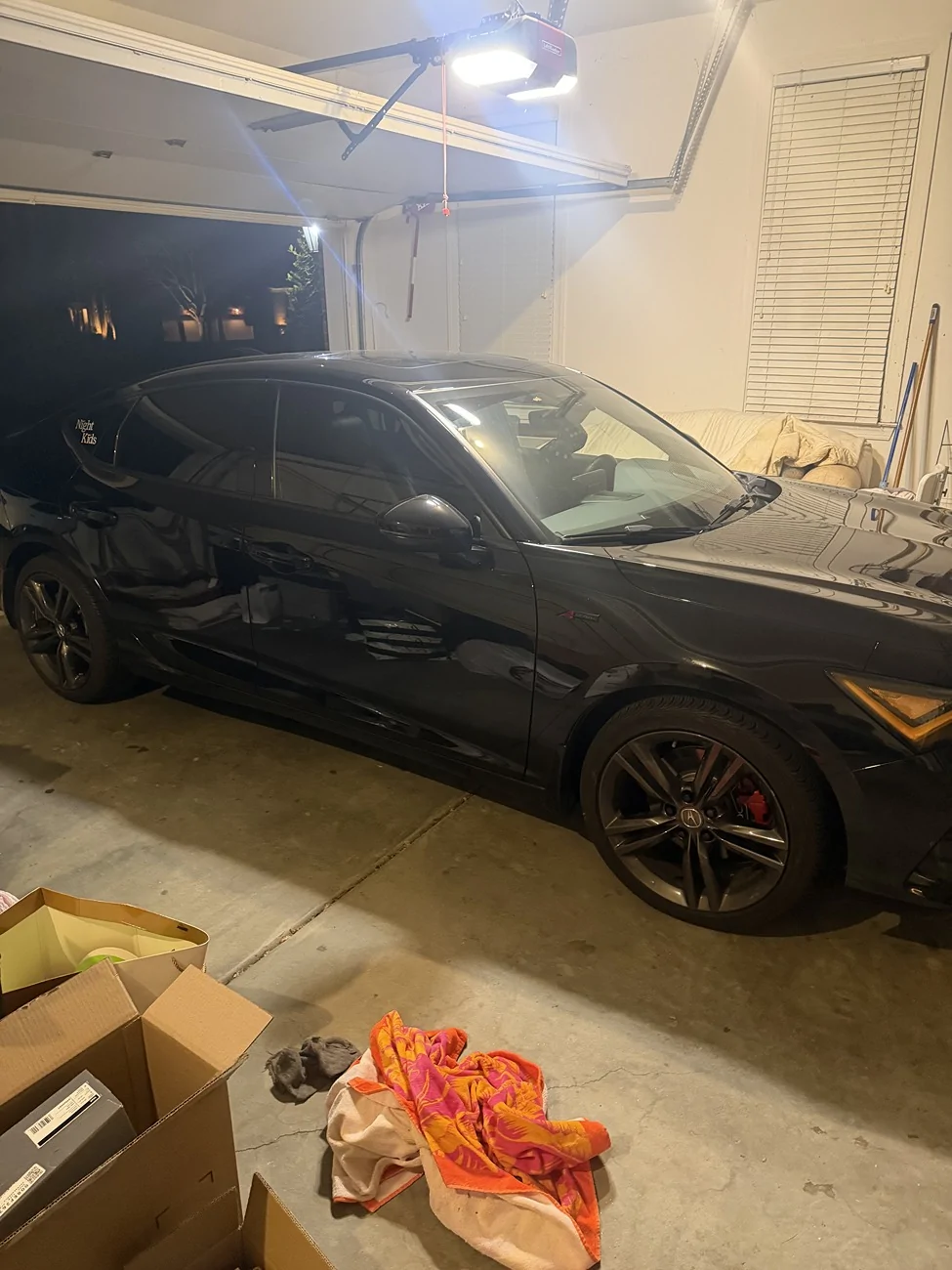

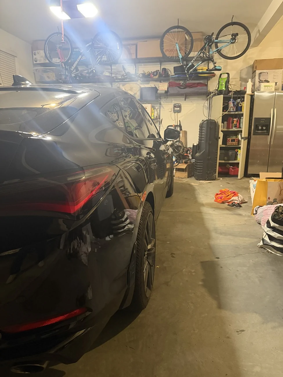

15mm spacers with oem wheels is nearly fender flush. If I buy wheels, the offset willl have to be 38 or 35mm.
That's a beautiful look!
For my A-Spec, I'm not sure yet HOW flush I can go with the fenders and still have enough clearance for the front wheels to turn, etc. I'm still looking around other threads to see what other A-Spec'ers have done.
I'll take anything better than stock, though!

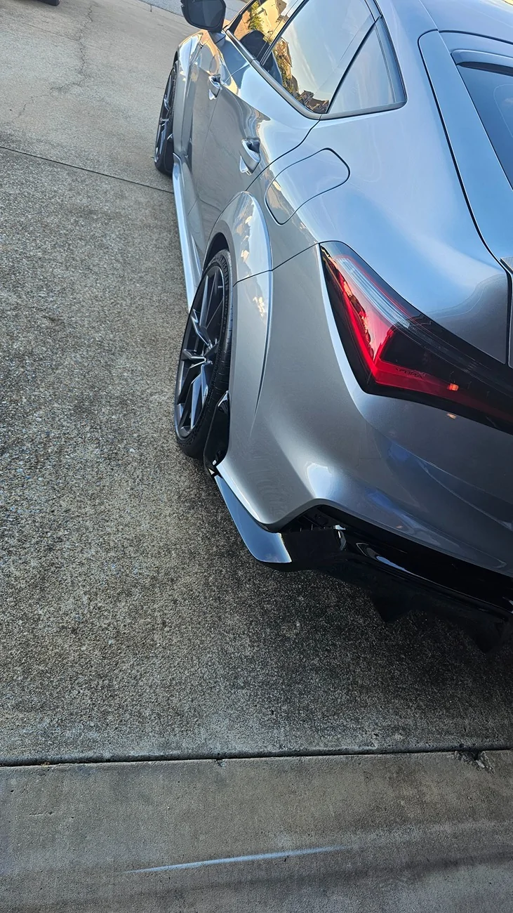

I put pictures (please excuse the quality) of my Aspec after we put 25mm spacers on the stock wheels. No rubbing or anything, but now the fitment has a bit of poke , it's nothing crazy while I save up/decide the wheels I want. The photos are also stock suspension still, I have the eibach pros in my closet waiting to go on, should have much less gap after that. I found that once the wheels have the right offset the 18s don't look nearly as undersized and I personally didn't think the extra expense of the 19s would be worth it aesthetically. The Audi I was driving before this had 19s and they were kind of a PITA to maintain, but thats mostly due to the shitty roads in my area.

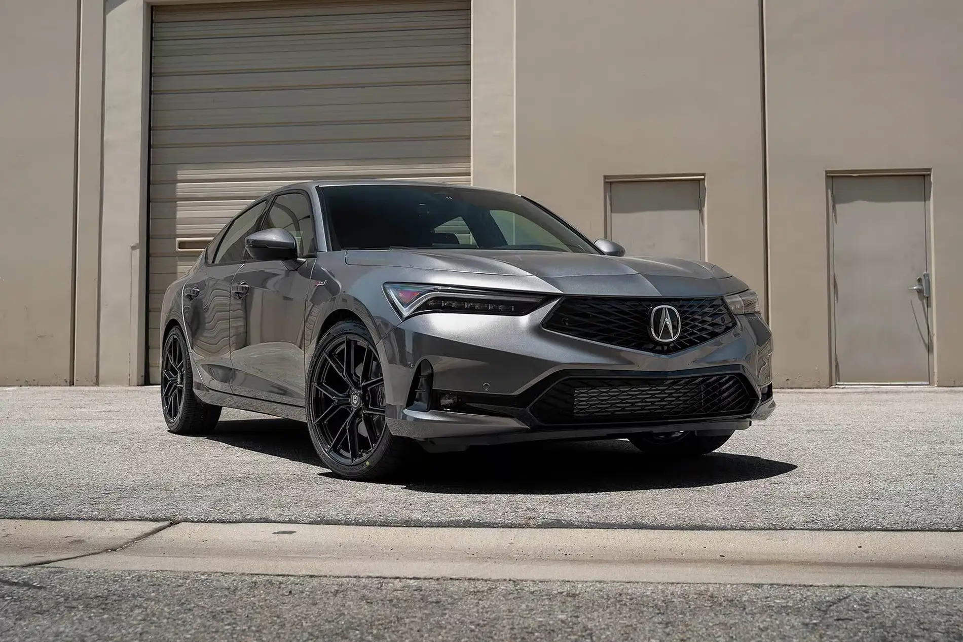

Ok, I came across another thread that mentioned Curva Concept wheels, and found this:
DC6 Integra Wheels | 19×8.5 +35 | Curva Concepts CFF70
Acura Integra Using offset to make the wheels more flush with the body? 1774005909767-ll
This seems to be exactly the look I'm going for, including the wheel design itself (Type S vibe). From what I'm reading, this near-flush look was accomplished just by going with a wider wheel and smaller offset (these wheels are 19" x 8.5", +35 offset). I'm going to e-mail Curva and ask if any spacers were used, but I doubt it. Also can't quite tell if the suspension is lowered or if it's stock.
Great look, nonetheless!
However, I went to the threepiece.us blog that @nightkid3 mentioned above, and I totally see the point now about staying with an 18" diameter but going wider... those cars with wider 18s in that blog look badass, and they retain some "meatiness" to the sidewalls by staying with 18".... so it's gonna be a tough decision for me, ha!
Example: Curva 18" x 9.5", +35 offset, with 265/35-18 tires... that's very, very close to the OEM diameter. Is 265 too much tire for the A-Spec, I wonder....
