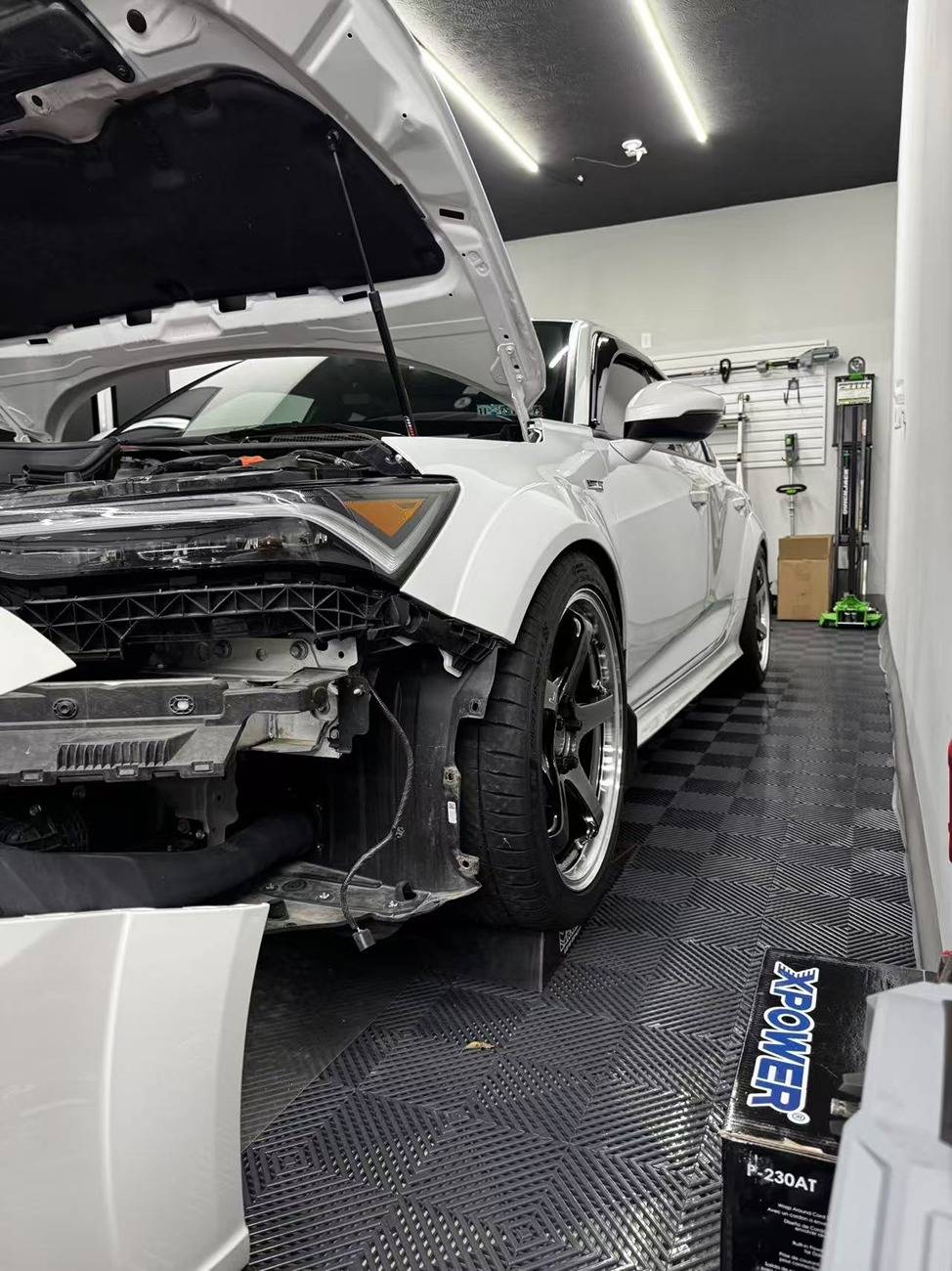

Took my bumper off to install the following.
RSplitter
PRL Intercooler
PRL Charge Pipe
PRL HVI
Acuity Shifter Bushings

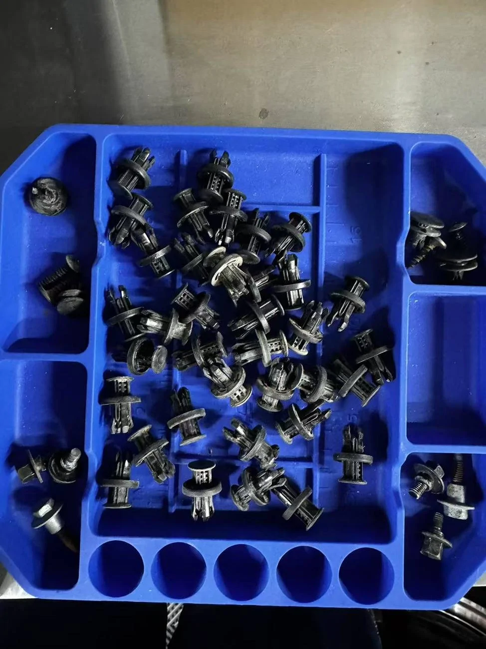

So many clips!!
How was the bumper removal? You still able to go up ramps after the splitter install?
Its not hard just too many clips to remove. Should be able to, I'm only on H&R which is a mild drop.

You removed a lot more clips than you needed to remove haha. This got me my first time too but then I played around and figured it out next time I took it off. The piece that attaches the air dam to the car only needs the left most and right most clips removed. I believe I removed close to 10 clips total from the underside.
Any tips for removing the pieces by the headlights I’m paranoid about scratching or breaking clips there
I did what they did and it worked great. Semi-carefully just pull on each part, slide your hand closer to the next part to release and repeat. I was able to get my hand behind the bumper to push as well after getting the sides to release. You should probably mask off the headlights or at least a portion of them because once you get it released you have to deal with the sensors and the bumper will be sorta floppy.
The most commonly broken part is the painted piece of the bumper above the headlights. Remove all of the clips at the top and then the painted part of the bumper slides out of a plastic bracket that is mounted to the fender. You just push down and in towards the center of the car and it should slide out. Common mistake is people getting frustrated/not knowing how it works and breaking the bumper section.
The part underneath the headlights is fairly easy to remove, it will feel a little scary but just give it some tugs and it will give. You can also use a plastic trim tool to push down on the bumper tabs for them to slide out. I prefer just giving it tugs. Have two people for this job, one person holding the bumper as it comes out and the other person pulling, don't forget to disconnect the parking sensors and the harness that is mounted to the bumper.

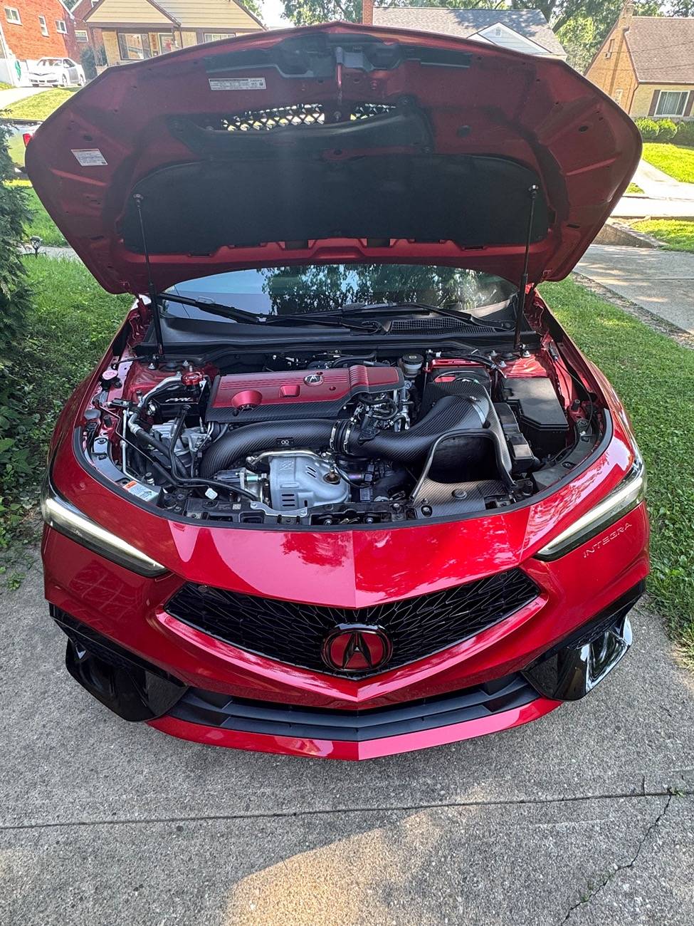

Add another to the list of people that did the Infinity Design intake and inlet tube. It’s absolutely gorgeous. Couple little Chasing J’s pieces inbound and I’ll then call the engine bay β€œgood to go” lol
Acura Integra What did you do to your Integra Type S today? πŸ™‹πŸ»β€β™‚οΈ IMG_7639

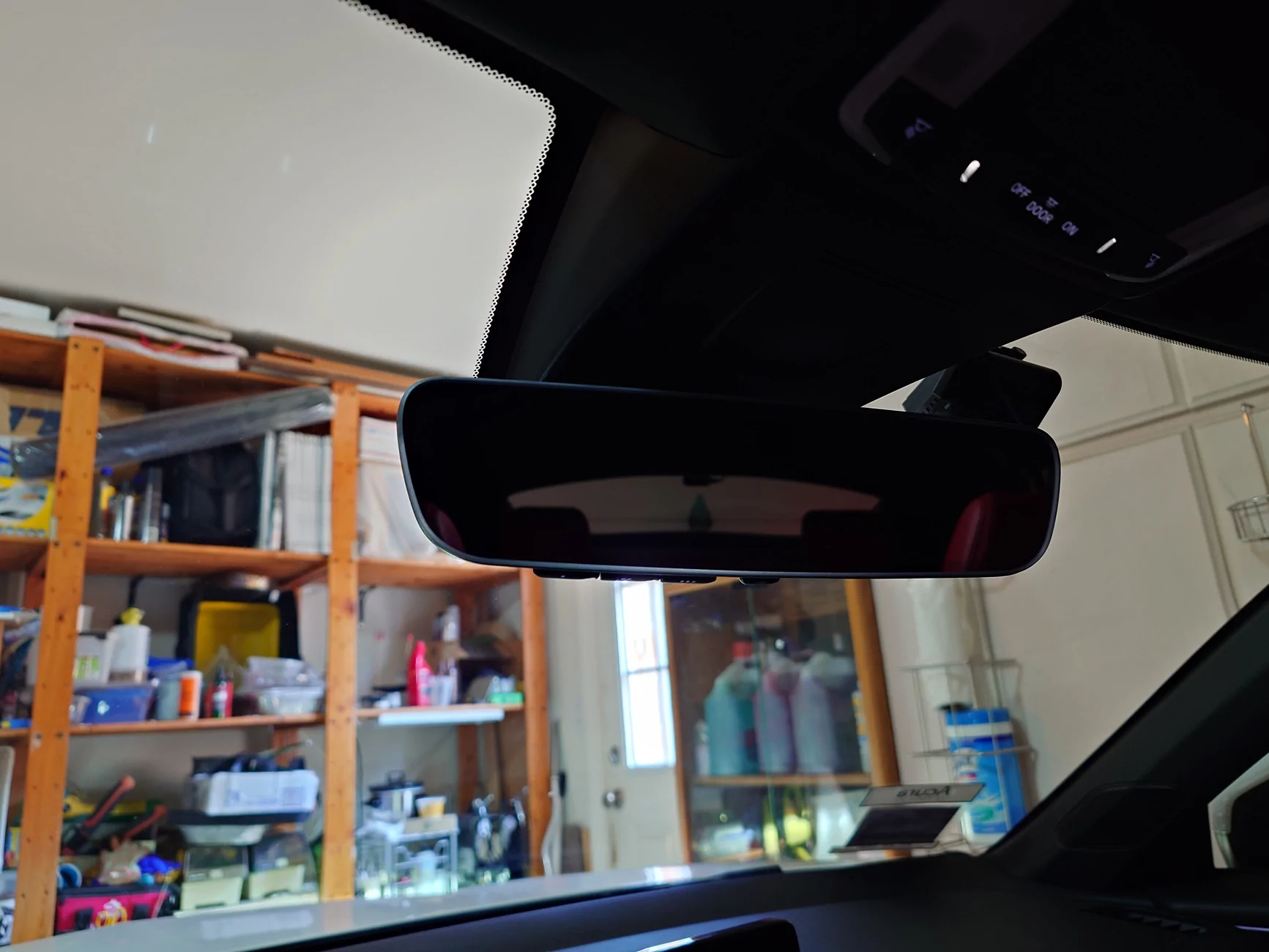

The forum being down forced me to actually go through my backlog of projects instead of endlessly scrolling the site for ideas (aka new shiny stuff to buy). I knocked out a few interior creature comforts over the weekend:
  • Accord HomeLink mirror
    Acura Integra What did you do to your Integra Type S today? πŸ™‹πŸ»β€β™‚οΈ 20250728_154153

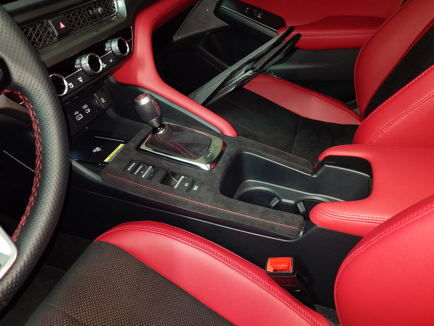

  • Overland Designs Alcantara center console trim
    Acura Integra What did you do to your Integra Type S today? πŸ™‹πŸ»β€β™‚οΈ 20250727_200440

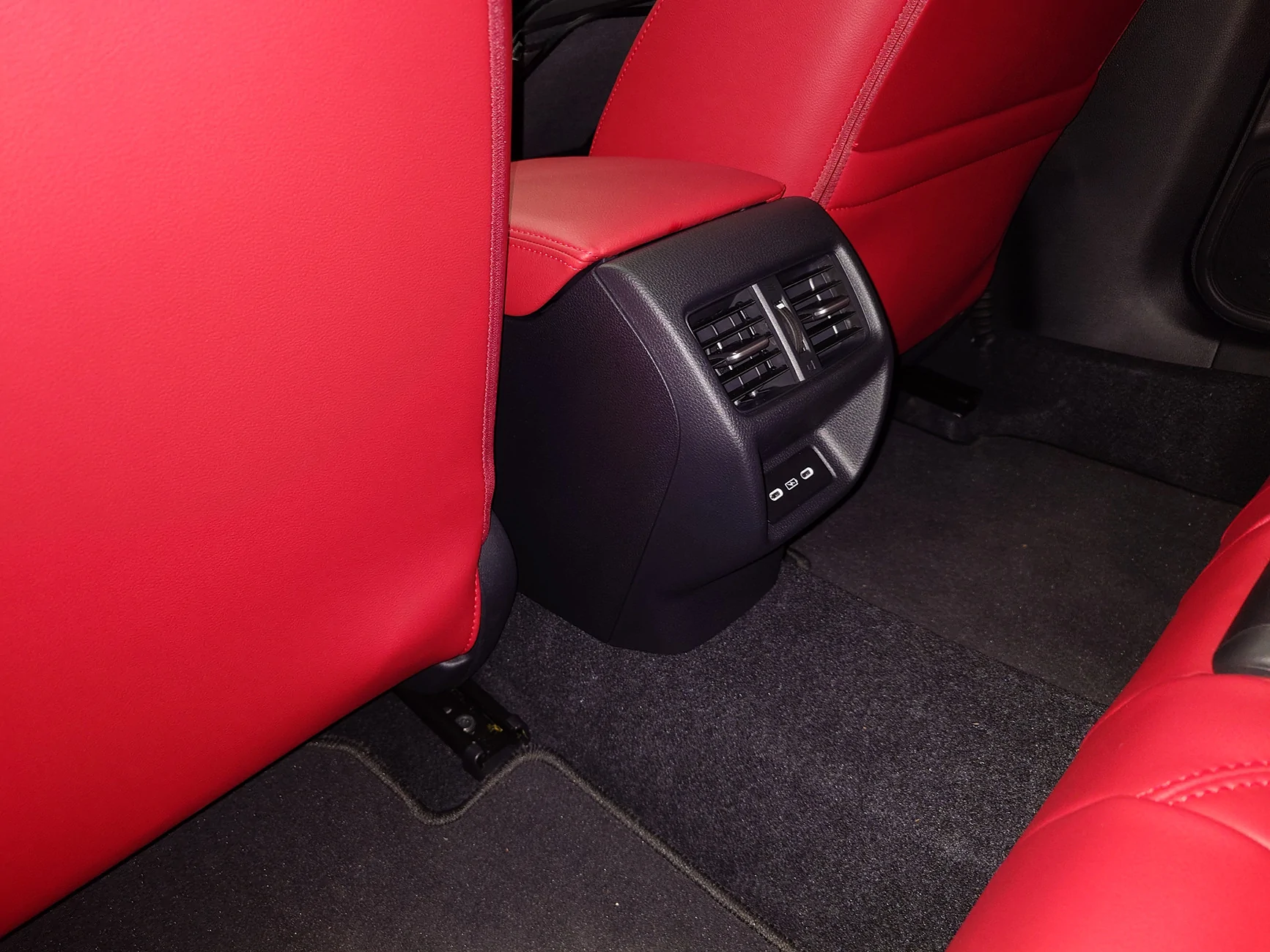

  • Rear HVAC vents with USB-C
    Acura Integra What did you do to your Integra Type S today? πŸ™‹πŸ»β€β™‚οΈ 20250727_200457
