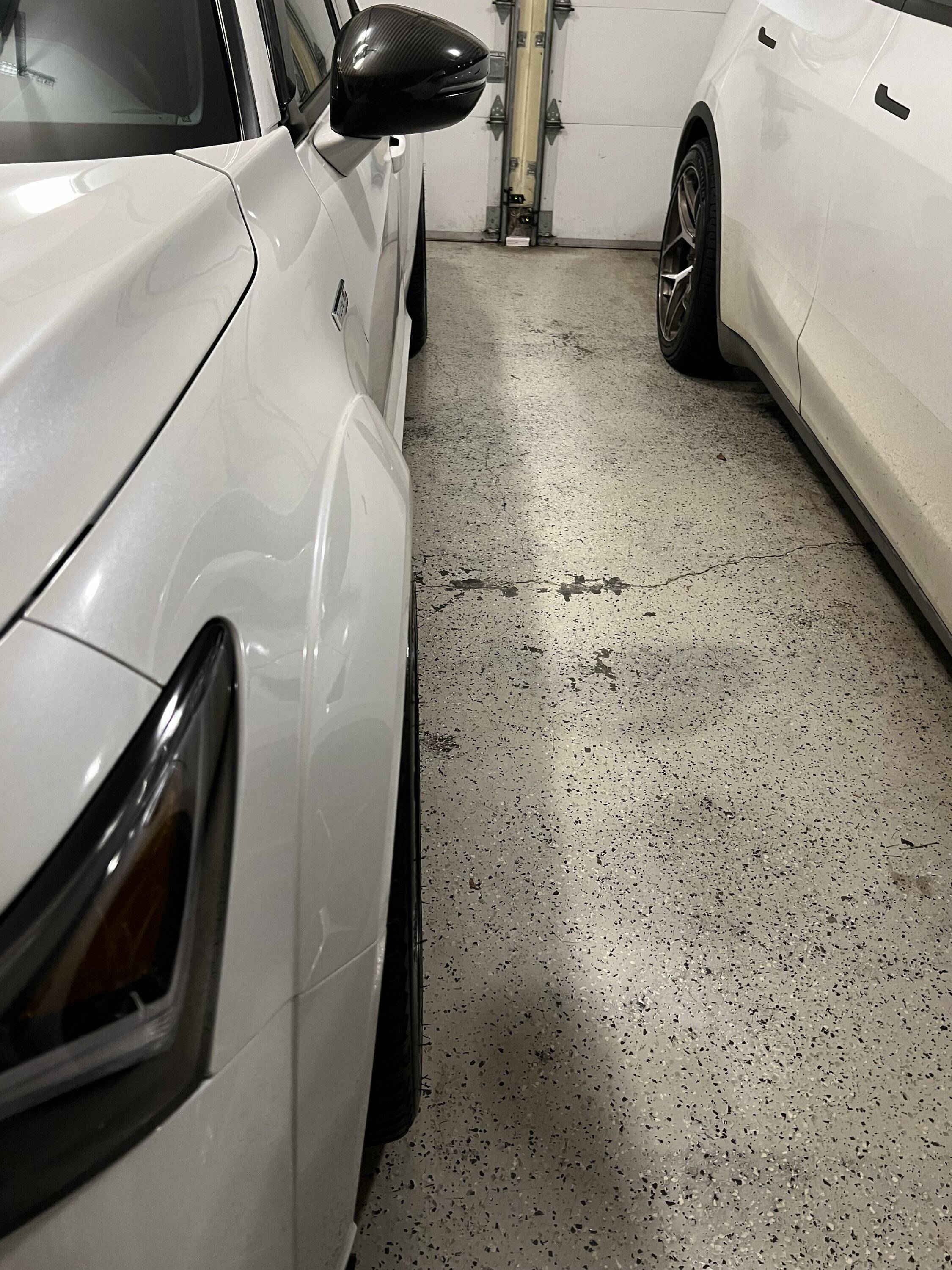

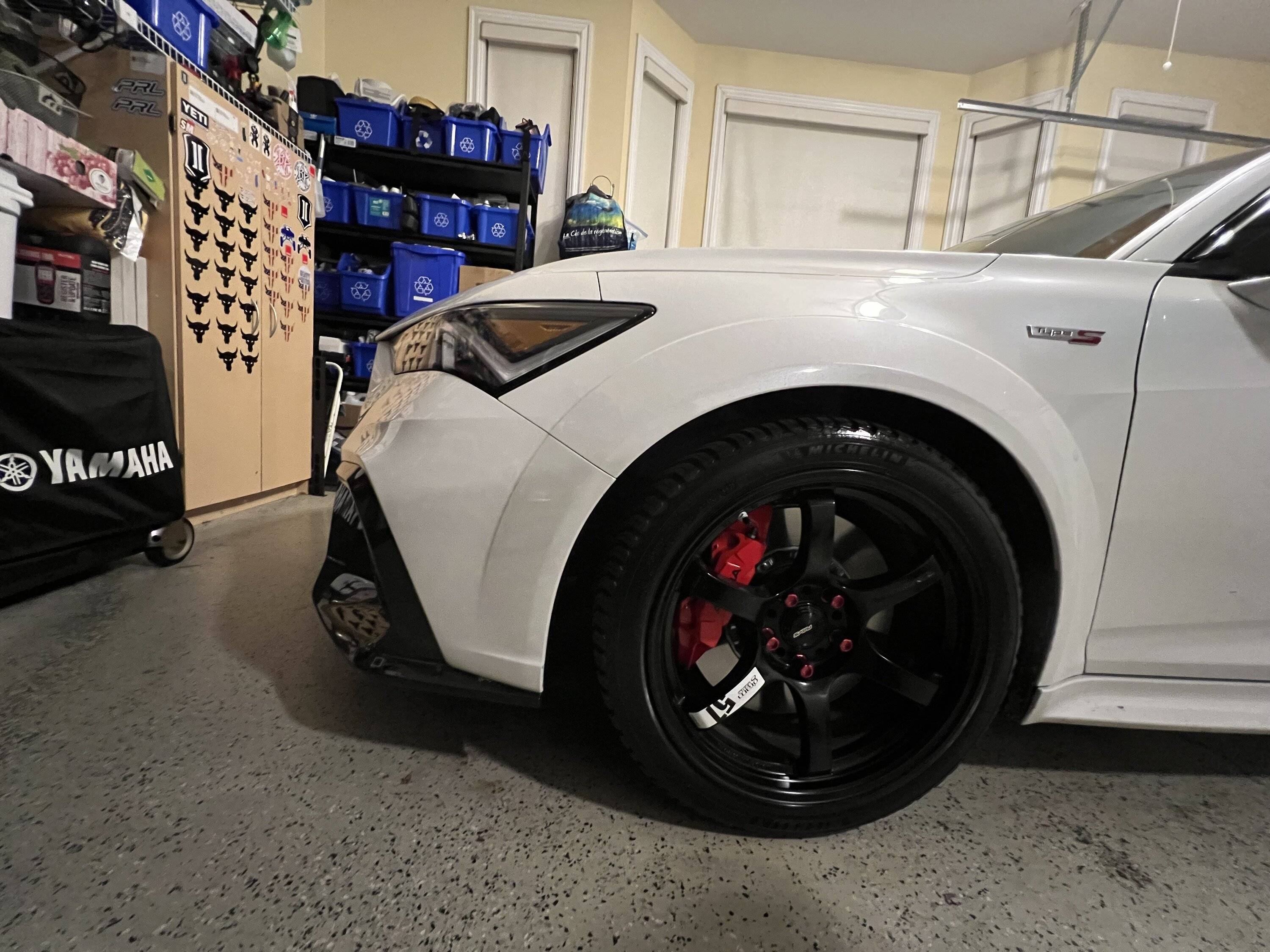

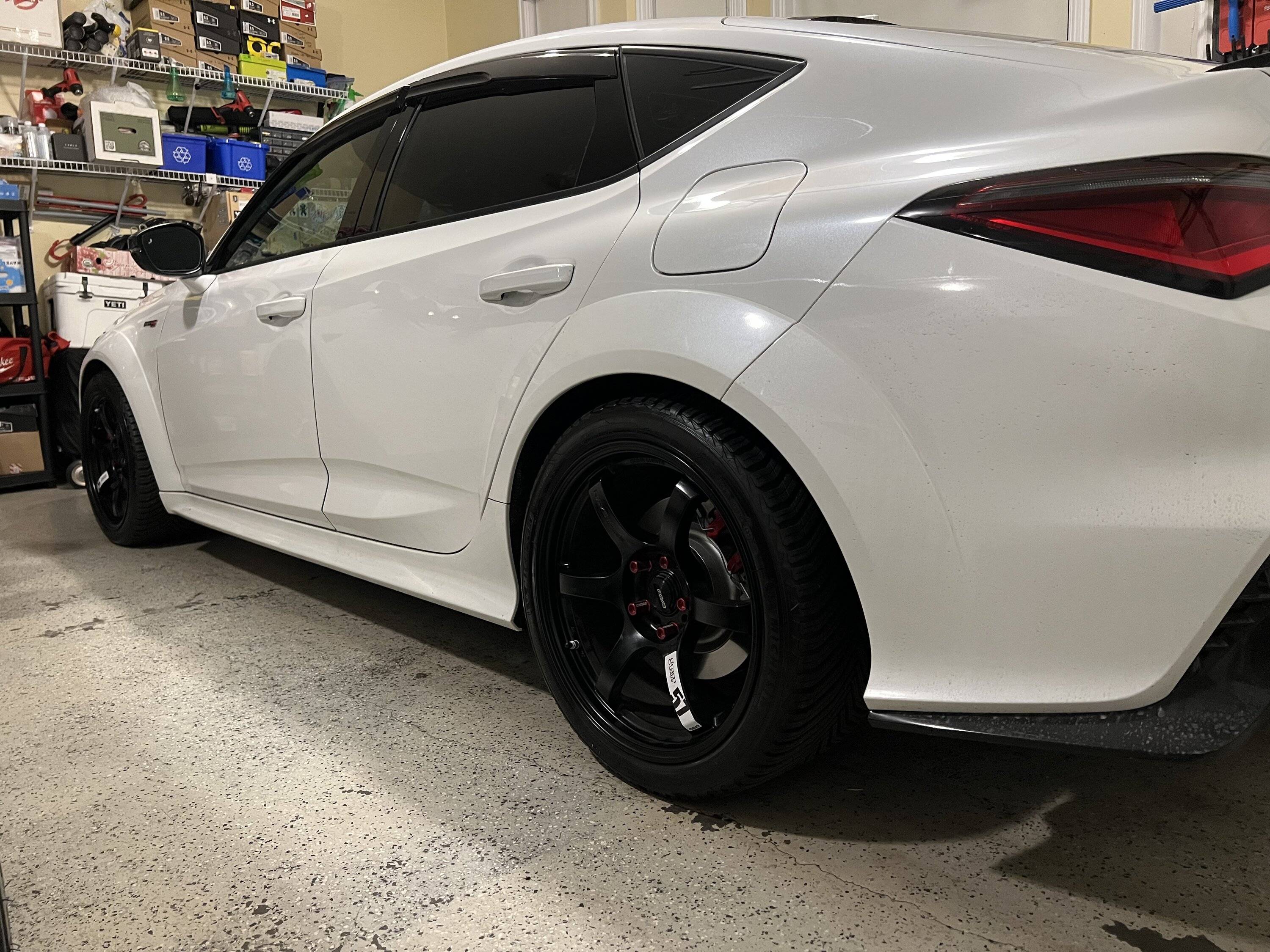

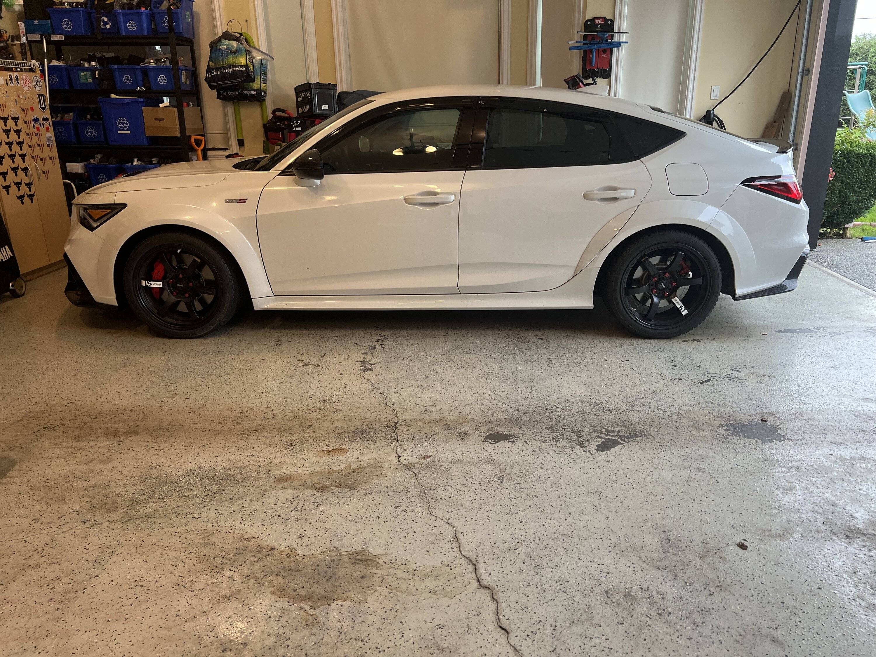

A 18x9.5 et+45 will be tucked into the fender. I just swapped out to my set of 57DR Gramlights in 18x9.5 et+38 with 255/35/18 Michelin Cross Climate 2’s tonight. They are dead on flush with the top fender as seen in my photos.
If you want more sidewall, you are safe to even go to a 255/40/18 in the 18x9.5 et+45 if staying at stock suspension height and this will close up the wheel/fender gap too.
Thanks for this! I was also considering the same tire in 265 vs. 255 as it fits on the 9.5 Wheel too. Would it then be outside the wheel fender causing sling? Curious of your opinion on that. Your wheel design is great looking.
I’ve run flush setups in my previous vehicles and yes there will be some sling and stuff kicked up against the lower doors and rocker panels. Can mitigate from sandblasting your paint with mud flaps or PPF. Doesn’t need to be full PPF, just the sideskirts and lower 10 or 12 inches of the doors and fenders. I have full XPEL PPF so am not worried about stuff getting kicked up.
